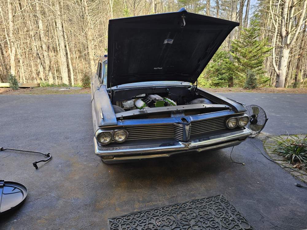

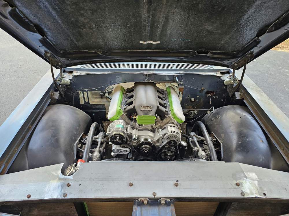

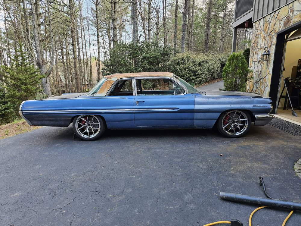

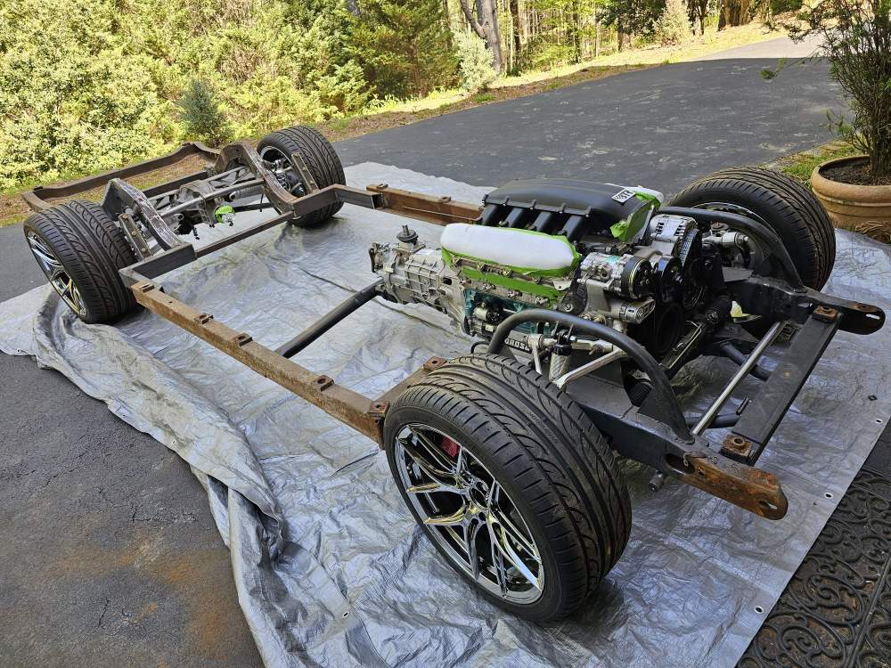

Here are a few. This is a single car garage home build endeavor.

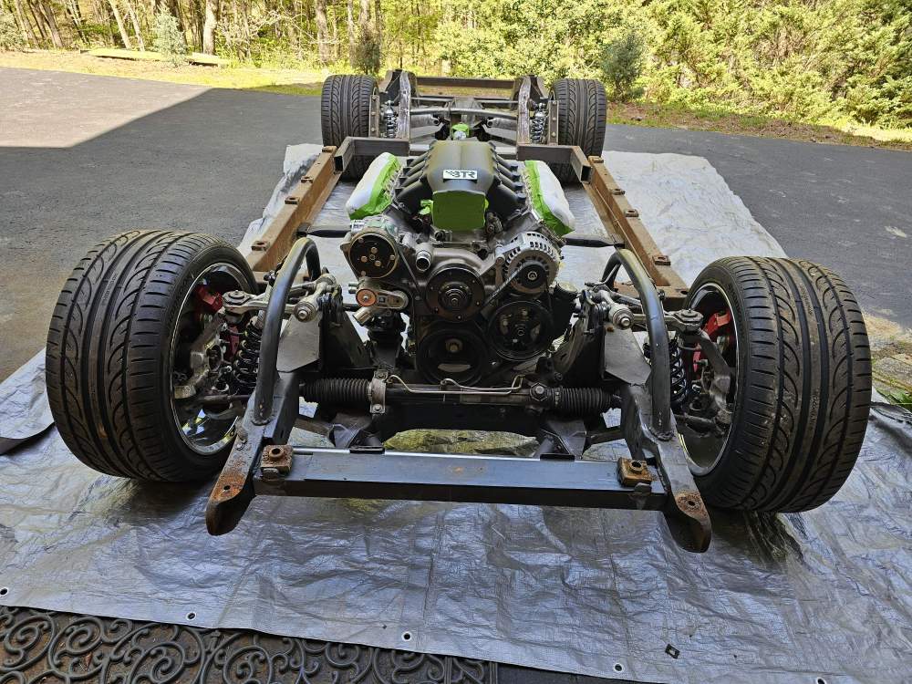

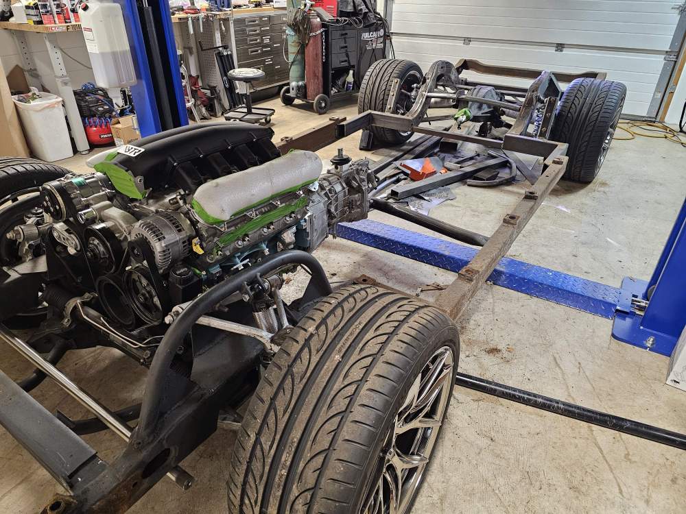

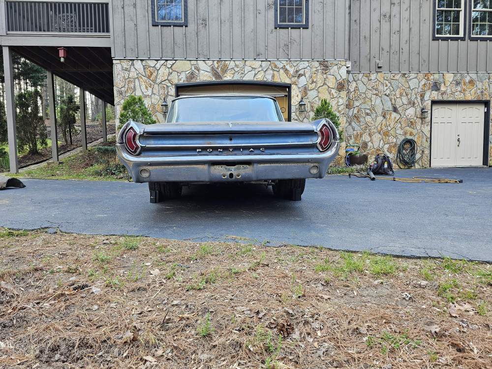

A few more.
All of what is seen on the chassis is initial mock-up. I have quite a bit more gusseting, grinding, and (re) welding to do.
Looks like a fabulous beginning from here.
Rick
Wow! Nice work!

I have lots of questions as I have a c4 front and rear ready to go into my 57 chieftain …
First question is …
Have you widened the track for your b body ? As your using a c4 set up. ?
C4 is way narrower
I see you have deleted the mono springs how have you set up your coil spring mounts onto the live axle mounts ?
64, Regarding the track; I made it all up in the wheel offset. I had a set of wheels made for the car. I hopenthat answered the question.
Regarding to coilover mounts in the rear; I used tge lower shock mount on the outer housing for the bottom, then welded on a new off-the-shelf mount for the top.

Tom, did you have to modify anything to get the c6 brakes to fit on the c4 ?
64, Yes, I did. I bought a set of brackets from Kore3 Brakes. Tobin is extremely knowledgeable and easy to work with. He stocks the C4 to C6 brackets. I don't remember the exact price but do remember it was very reasonable. The C6 has an internal brake-shoe type parking brake. In order to use them I had to purchase a.set of billet adapter hubs that include the full parking brake assembly. I don't remember, off the top of my head, who i got those through, but could figure it out if you decide to go that route. I do remember that they were pricey @around $800. FWIW, I plan on running manual brakes with a Willwood 7/8" piston m/c.
