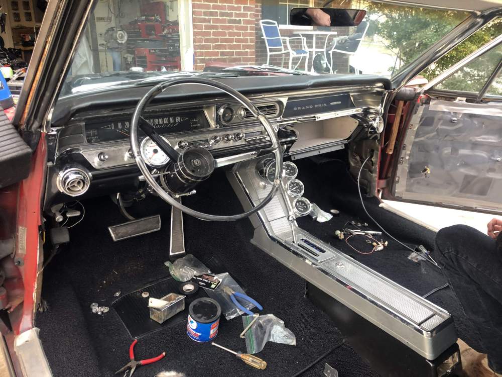

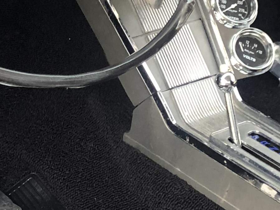

Hey Sam, so I'm not sure if your 63 Bonniville used the same center console as my 63 Grand Prix. I did a quick internet search, and it said it did, but I'm still not sure. But here is my console from my 63 Grand Prix. There was no trim where the console meets the carpet on mine. The only plastic was at the rear underside of the console on the hump, I painted mine black to match the new carpet as you can see in the picture. If yours is the same I can get you more pictures if you need them buddy.
as far as the front bolts, there was nothing covering them except for the factory carpet on mine when I got it. Some changes had been made mechanically to mine before I got her, but the inside was still all stock. I hope this helps you Sam, can't wait to see pictures of her.

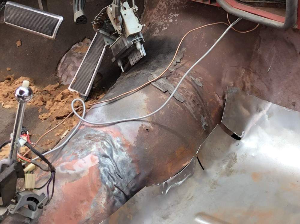

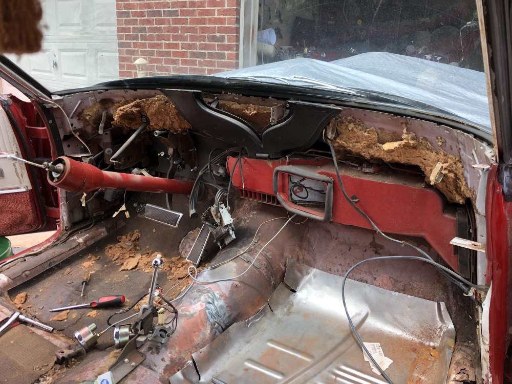

I went through my build pictures last night hoping to find a picture of my console out of the car. I wasn't able to find one. but I did find this picture of the tunnel while I was redoing the inside. It's the same picture one is justa blown up Sam. If you look at the front of the tunnel you can see there is no bolt holes where your bracket is. Hope this helps buddy.
