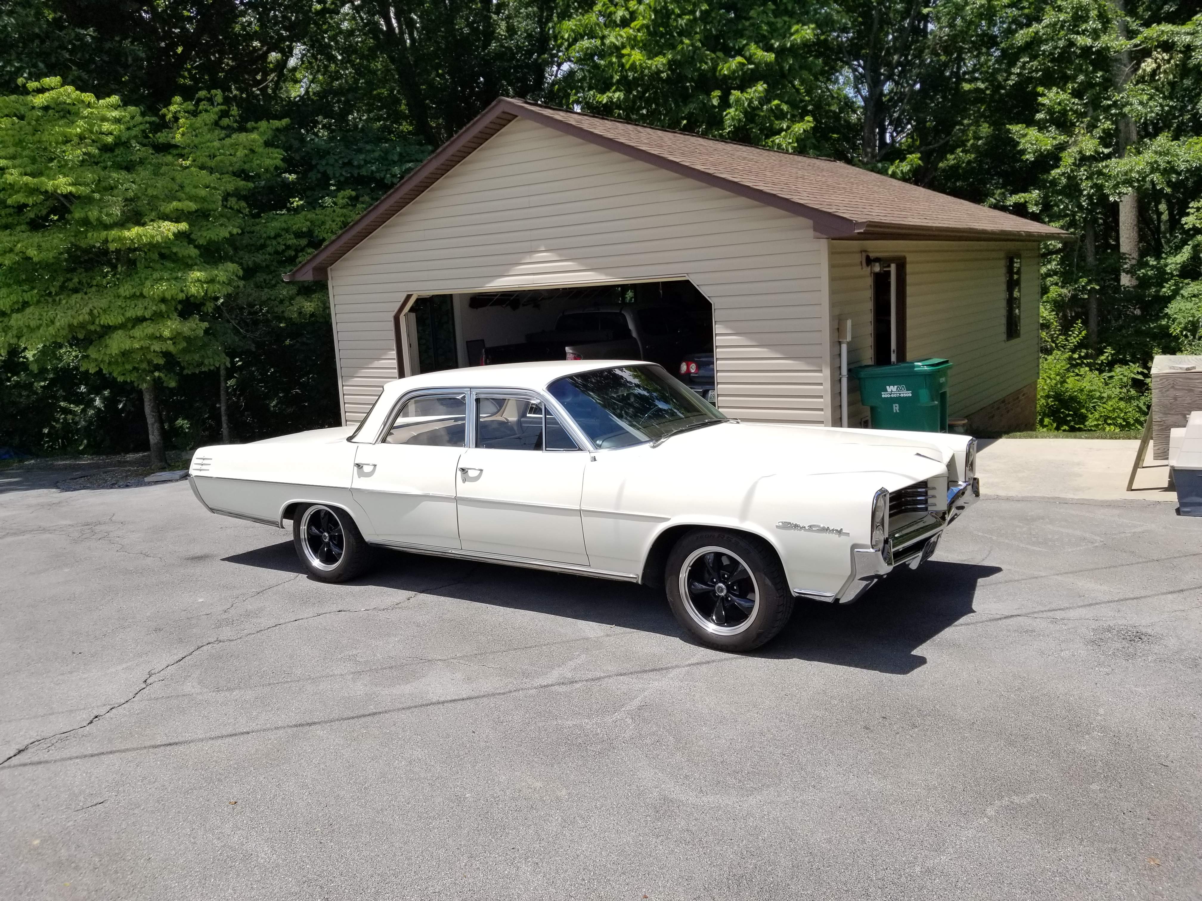

Howdy.  I got my license in this car in 1968.  Bought it from my grandfather.  Have driven it many miles and now I need to consider engine work or replacement.  It has a 389 rebuilt in 1985, bored 30 thousanths over.  Now have oil consumption many years later.  It is not a hot rod but road car.  Excellent driver.  Many modifications.  Currently a restored.
Trying to decide whether to get engine work or just replace engine and transmission.  Currently looking at  GM 383 small  block or LS3 kits.  Although I have done most of the work on the car up till now, I will need mechanic help either way.  Any suggestions or advice would be appreciated.
