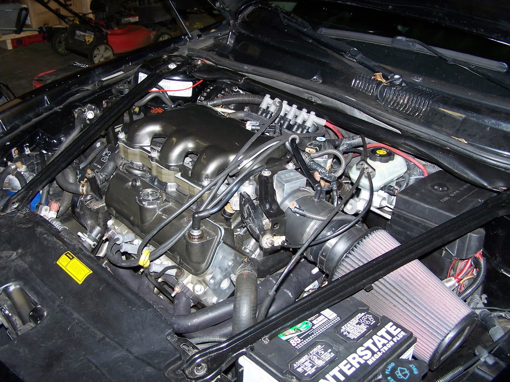

everything minus the engine has a little over 100k on it. the engine started out like as a stock replacement that had 300 miles on it when i got it in Jan of 07 now it has around 10k on it and is a completely different beast.
little background into whats done to the car.
3400 bottom end which is from the 300 mile 3400 i started with which now has about 10k on it
3500 ported lim from WOT-tech store
3500 heads from silvergtrad which came from wot-tech store and are ported
went with the 99 timing chain, cam sprocket and crank gear.
ported and shave 3400 upper
custom ground cam with custom pushrods
cam specs--intake 230 exhaust 236 515 int 515 exh lift pic below
65mm t-body upper ported to 65mm
modded 3400 lifters with LT1 springs inside
Comp Cams 26986 Valve Springs
comp cams locks and keeps
TOG headers with high flow cat
SLP cat back with an OEM camaro muffler for now

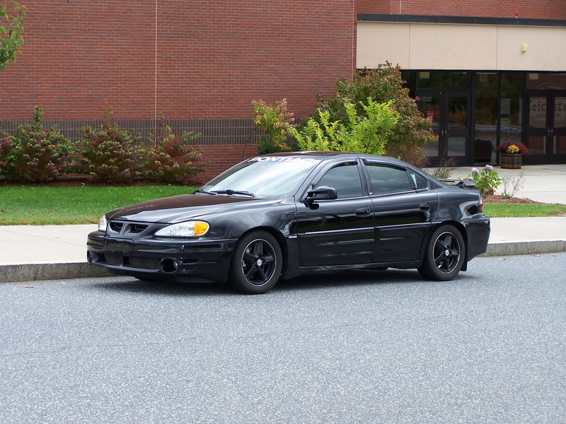

H&R springs
halo projector headlights (need new pics for these)
carbon fiber SC/T hood should be here in a few days.

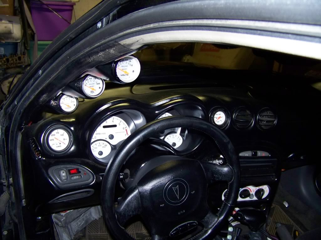

Damn cuz. Gauges everywhere!!!
I like what you did with the stock wheels. :woot:
