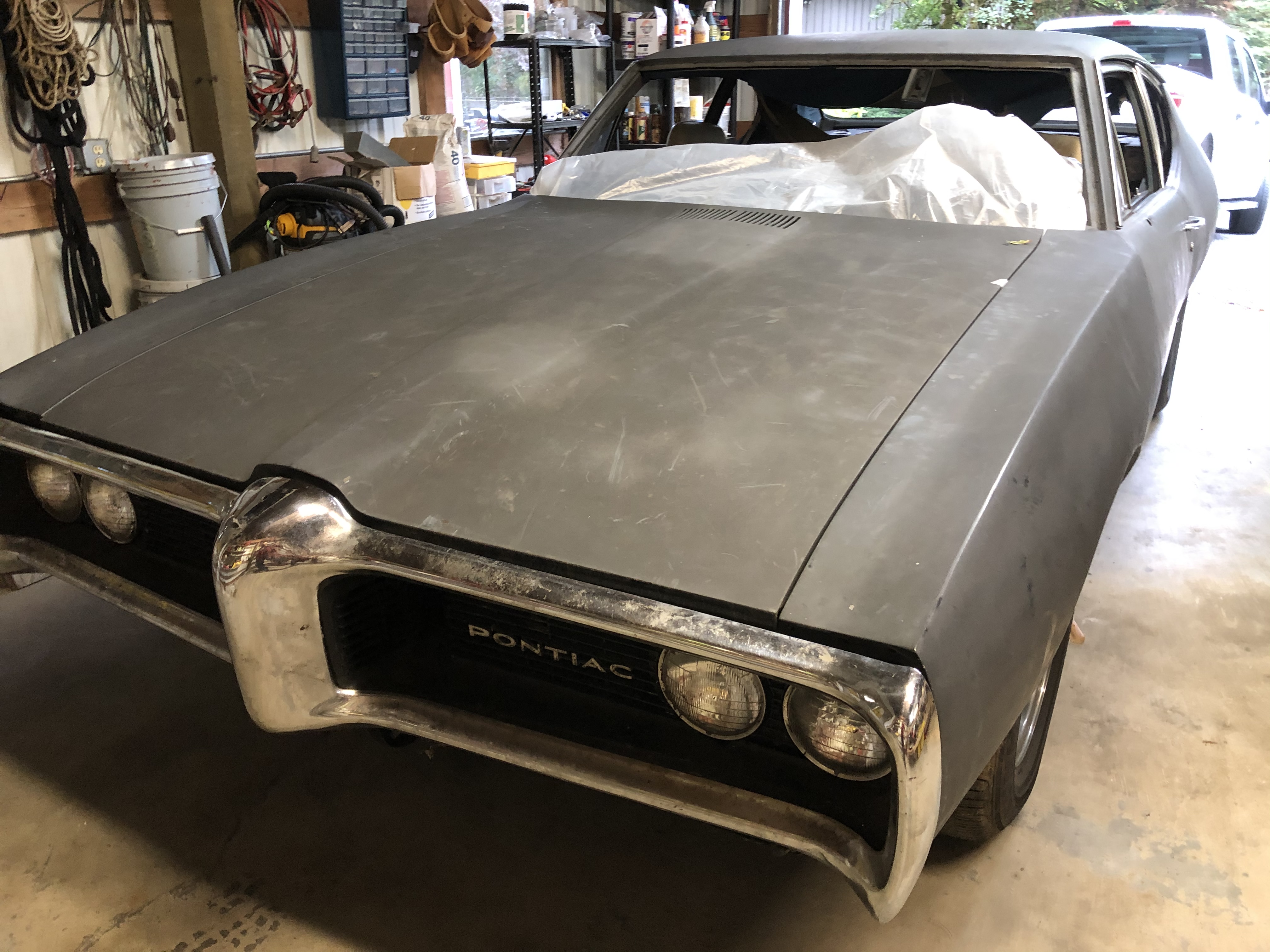

I recently picked up a 1968 GTO clone, based on a Tempest. I’ve worked on cars as a young lad, picking it back up as I now have a little more cash than I did then!
looking for advice on a few thing which are probably common knowledge to most of you, but is above my pay grade!

Looks like you got some work cut out for you on the body but not bad! How's it doing mechanically?
Definitely in the right place to get advice! Look forward to seeing you around and this beauty progress!
Welcome to the group.  Whats your plan?  Body, mechanical, drivetrain?  Where to start?:indian:

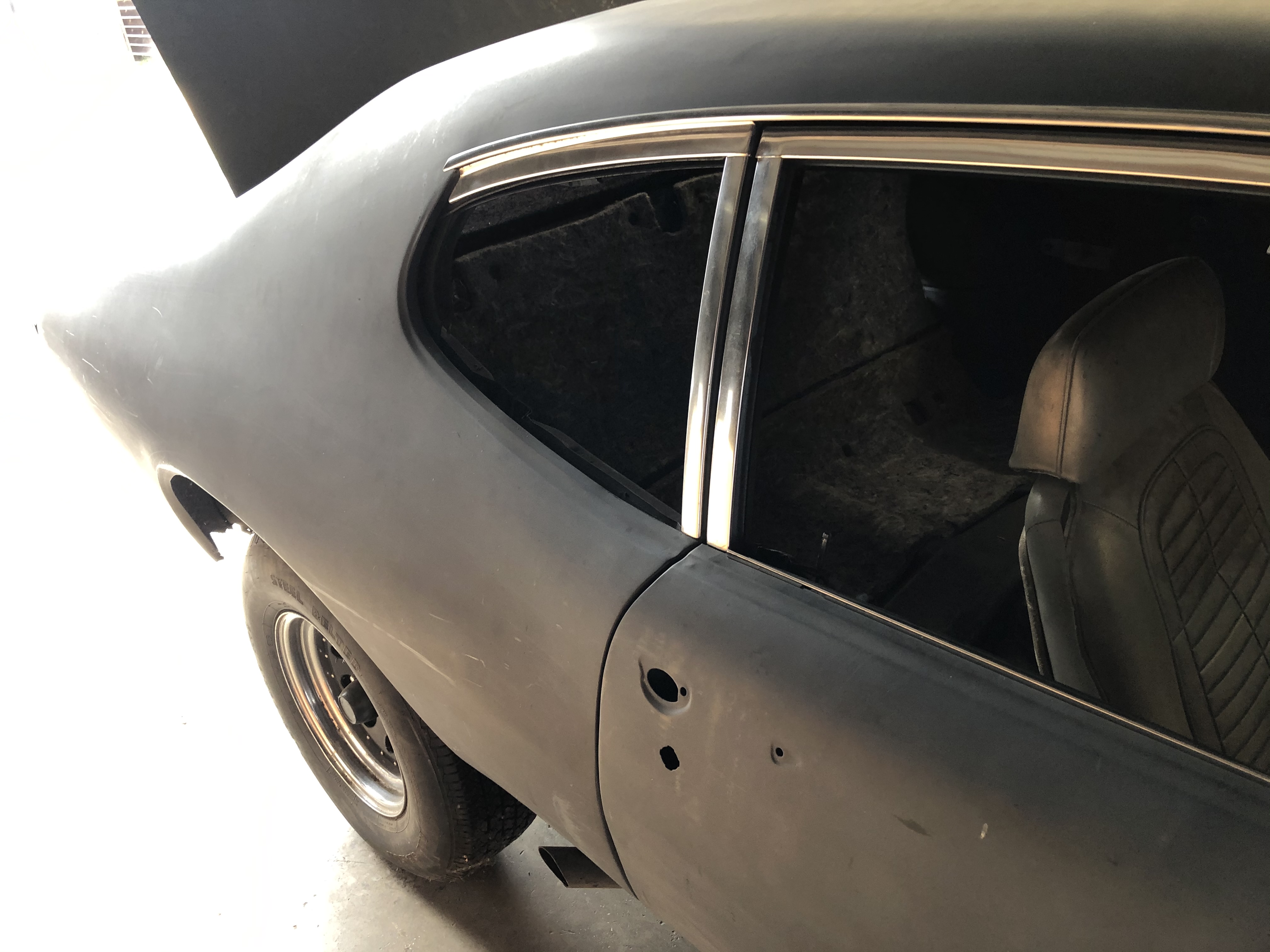

The body is structurally in great condition, rust in the foot wells and a little in the trunk but that seems to be it. The guy I bought it off has EVERYTHING and more. Boxes and boxes of fittings. 3 hoods, an extra set of pillarless doors and a second grill/bumper assembly.
I'll drop the chrome tempest bumper and find an Endura bumper.
So thats the plan I have so far!
