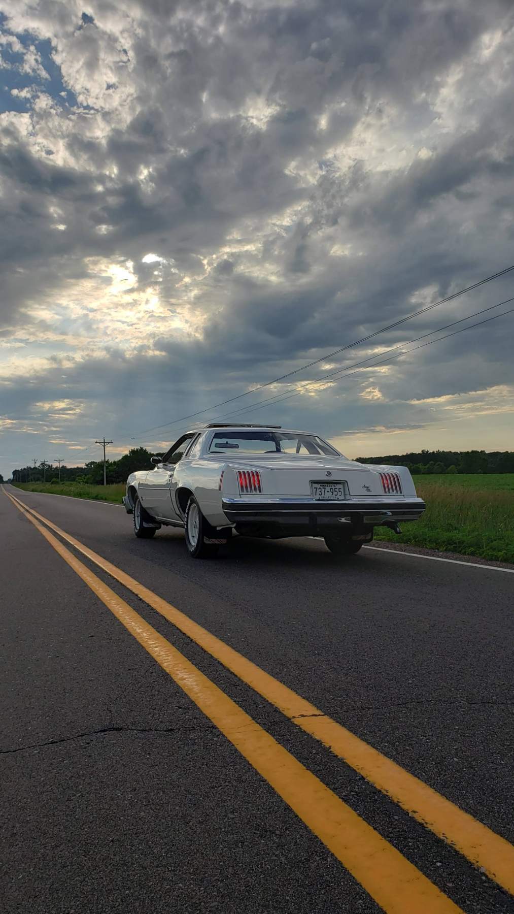

Hello and thankyou for allowing me to join the forum. I was given my grandfathers 75 Grand Prix after he had passed. Ive had the car for 3 years now and want to start some upgrades and give her some much needed tlc.

Sorry to hear about your grandpa. Good it’s kept in the family 👍
