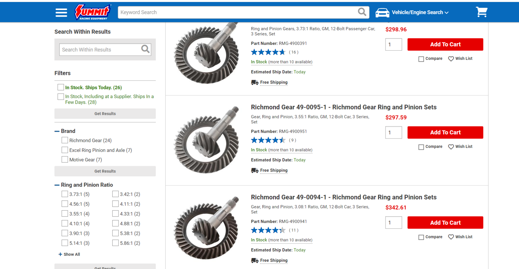

I did a quick search on Summit Racing for kicks and grins. They list the 8.875 as the GM 12-bolt. However, it lists a bunch of Richmond Gears fitting the 8.875. Here is my screen shot. So if the 8.875 is more commonly known as the GM 12-bolt, then there is a ton of gear ratio options available for you. So double check your diff case and see if you have 12 bolts.
No this isn't the chev rear end, quite different.  It has a 10 bolt cover and 12 bolts on the ring gear.  considerably bigger than the chev rear end.
