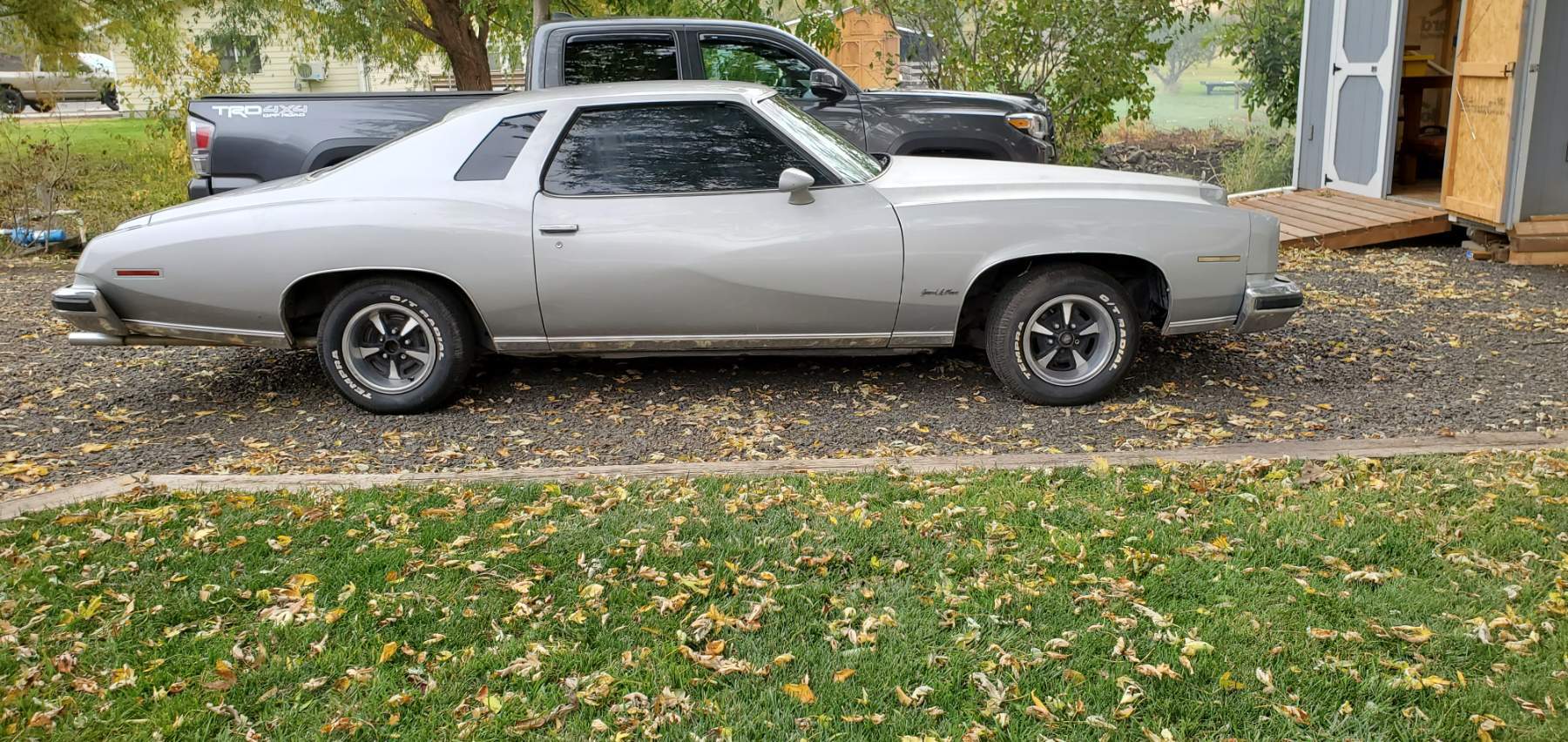

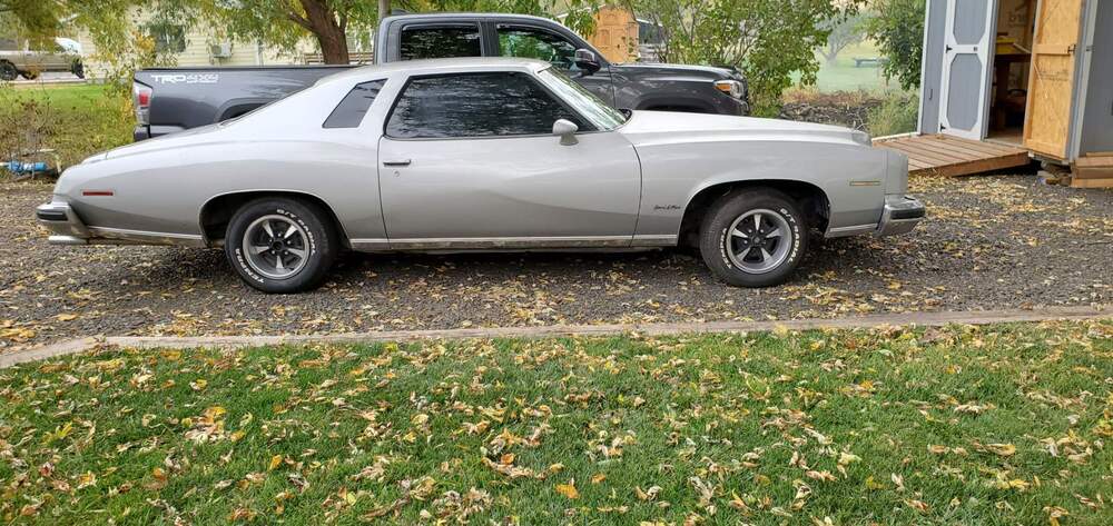

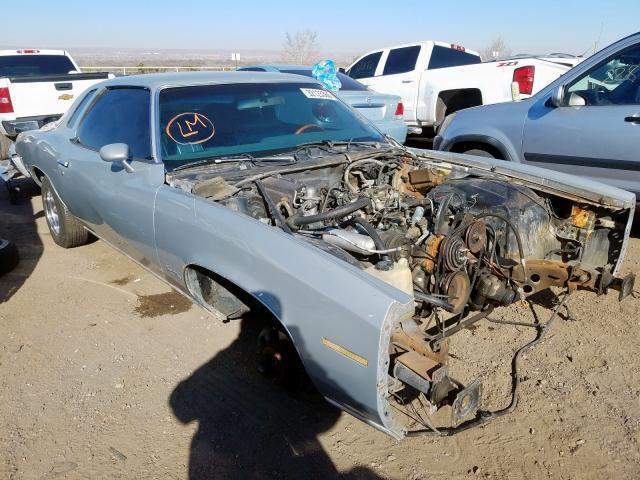

Had a few Pontiacs in my younger years, found a lemans similar to one I had in the 70s and starting a resurrection of the car. Car was stolen and half torn apart. A friend in N. M. found it at auction, bought it started reassembly and now it's mine to finish. Lots of questions need answered, never brought a older car back to life..... but what is retirement 4!!

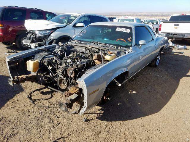

that looks like a super clean car, to me it looks that its been robed of the front panels ...whats the story behind it sitting there ?
The car currently looks like the 1st pic, one with the Tacoma behind it, the vehicle was stolen a couple years ago from someone in the southwestern part of the USA. It was recovered by the police in the conditions where the front end was torn off (pics 2&3) the car is apparently a southern Cali car as it has a car club sticker from that area. She has great bones but she's missing a few. No horn and I'm not even sure of placement of the Horn. Also need wheel center caps, 1 wheel chrome ring 14", door pull straps A pillar trim driver side etc. To many parts to list

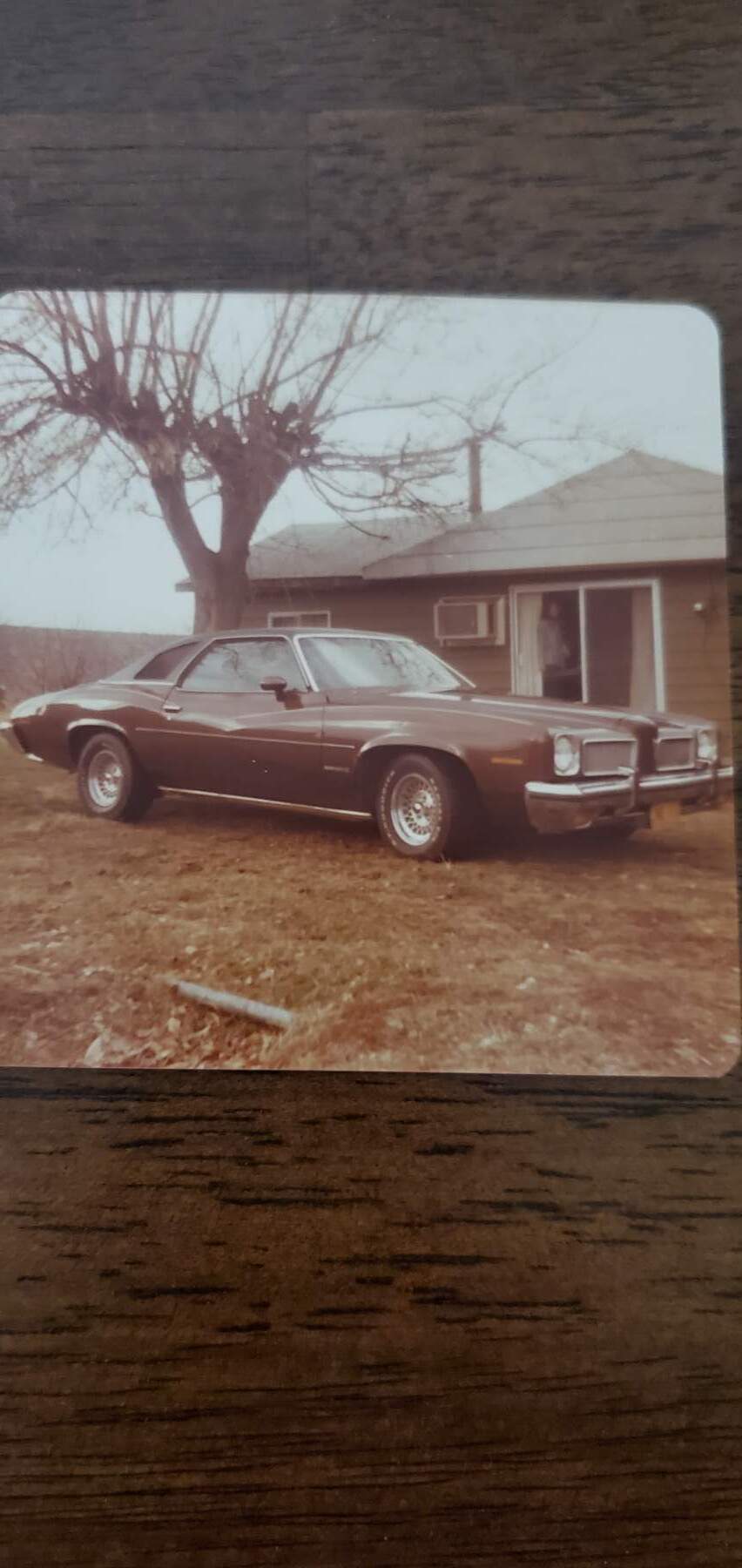

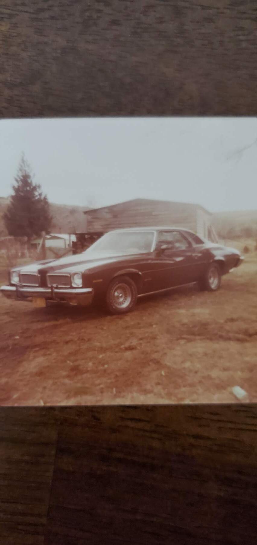

My first Pontiac also was a 1973 Lemans sport coupe. Thanks for the info, pic of my 73 included

Thanks for sharing the photos of your '73 as well. What was the '73 and '75 optioned with?

My 73, well it was 40 years ago, I don't remember a lot about the options. I, for some reason, back then had pulled the build sheet out of it and kept it. Ran across it earlier this year, really the only good info I have on it. I will post a pic of it.

My '73 had AC, power steering and brakes, white vinyl interior and bucket seats, white vinyl roof and louvered side windows, 350 V8 2-bbl with a 375 TH automatic transmission (ask me how I know it had a 375TH sometime), a 3.23 open diff, rally gages and clock, AM/FM radio and a console shift. I later found out that the radiator in the 350 V8 with AC was larger than the 400 or 455 in the GTOs. I'm not sure why that was, but it was a 4-core radiator. I later purchased a Trans Am formula steering wheel for it. I still have that steering wheel, it is now on my '72 Lemans Sport Convertible.
