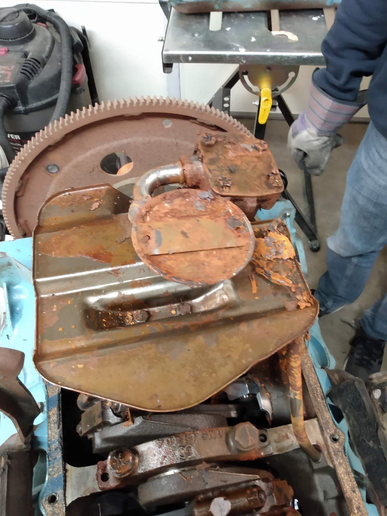

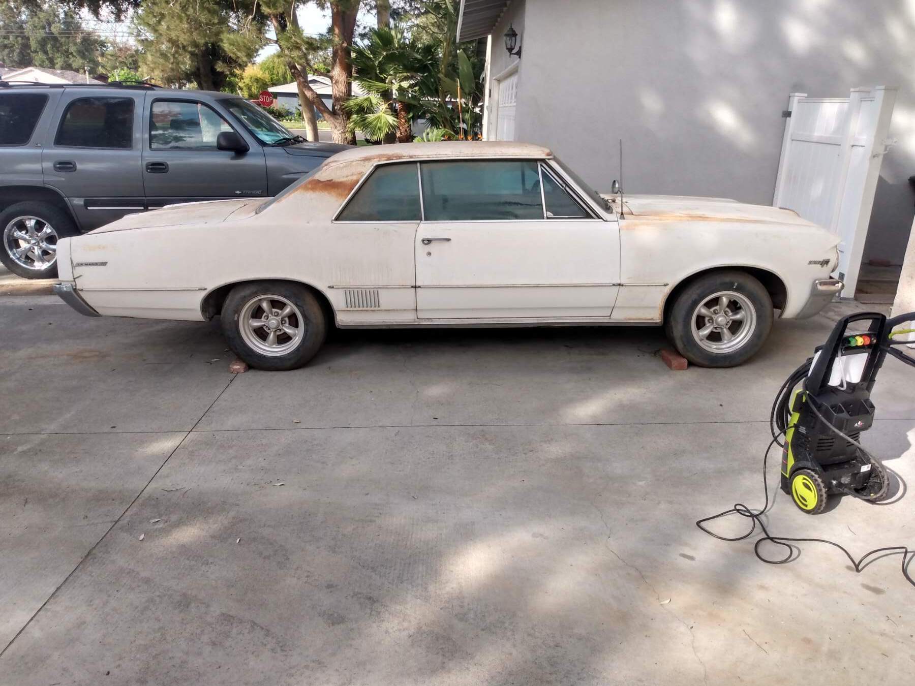

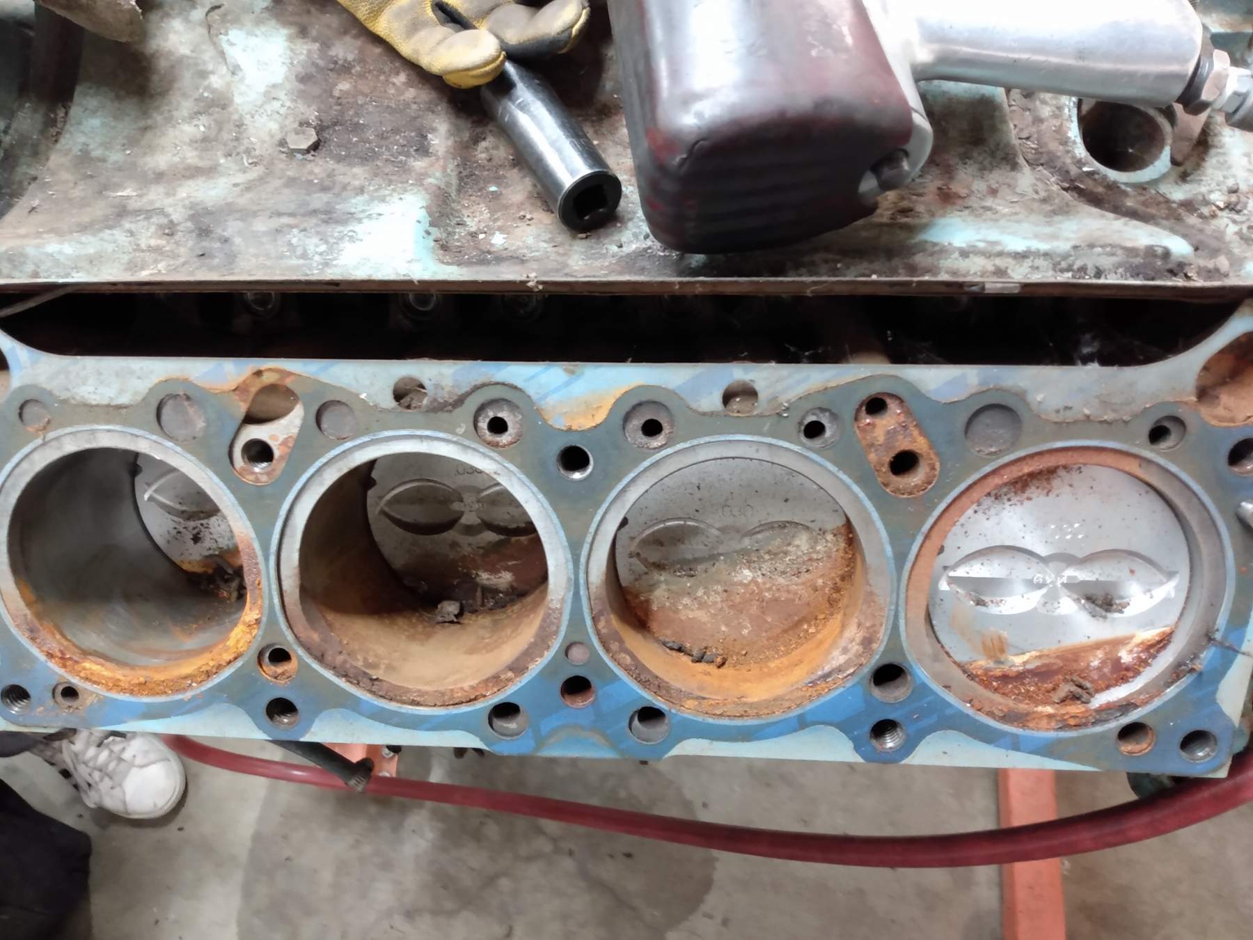

Just got a 64 Lemans that had been sitting in my coworkers backyard for 20years it was bought by his dad from the original owner, it had the 326 engine rebuilt 20 years ago and never completely reinstalled or because of this never started, sat with intake off and no spark plugs so lots of rust in the cylinders and probably a total loss.
Another coworker gave me a 350 engine and transmission and are currently working on getting that engine pieced together.

Andy really neat score Mate👍, i have a mate here in nz  with a white one, with black interior, they are a super sexy shape:dancingpontiac:
Bloody shame about that 326, i bet it will cost more to bore and rebuild that motor than just buying a brand new one🙄

The 326 would probably have required sleeves on all cylinders so i´m going to see if i can use the 350 i got and put the front cover and all the rest of the sheet metal so that my accessory drives fit. The 350 need one sleeve and i might have to go to 040 over if the adjoining cylinders get to much distorted when they put the sleeve in (its 030 over now)
I may want to try to find some other cylinder heads since the 350 heads cc´ed at 92cc and i like to bump the compression up a few notches.
