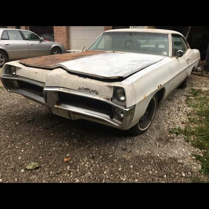

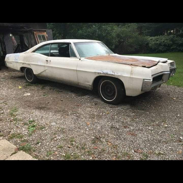

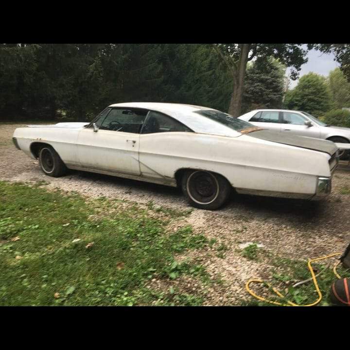

Hello Im new here. I just bought a 67 Pontiac Bonneville it is my first pontiac. Im restoring it to it former glory . I'm just looking advice, or tips. When it comes to them.
Sounds like a great project. What are your restoration plans? Stock, resto-mod, wild/custom?

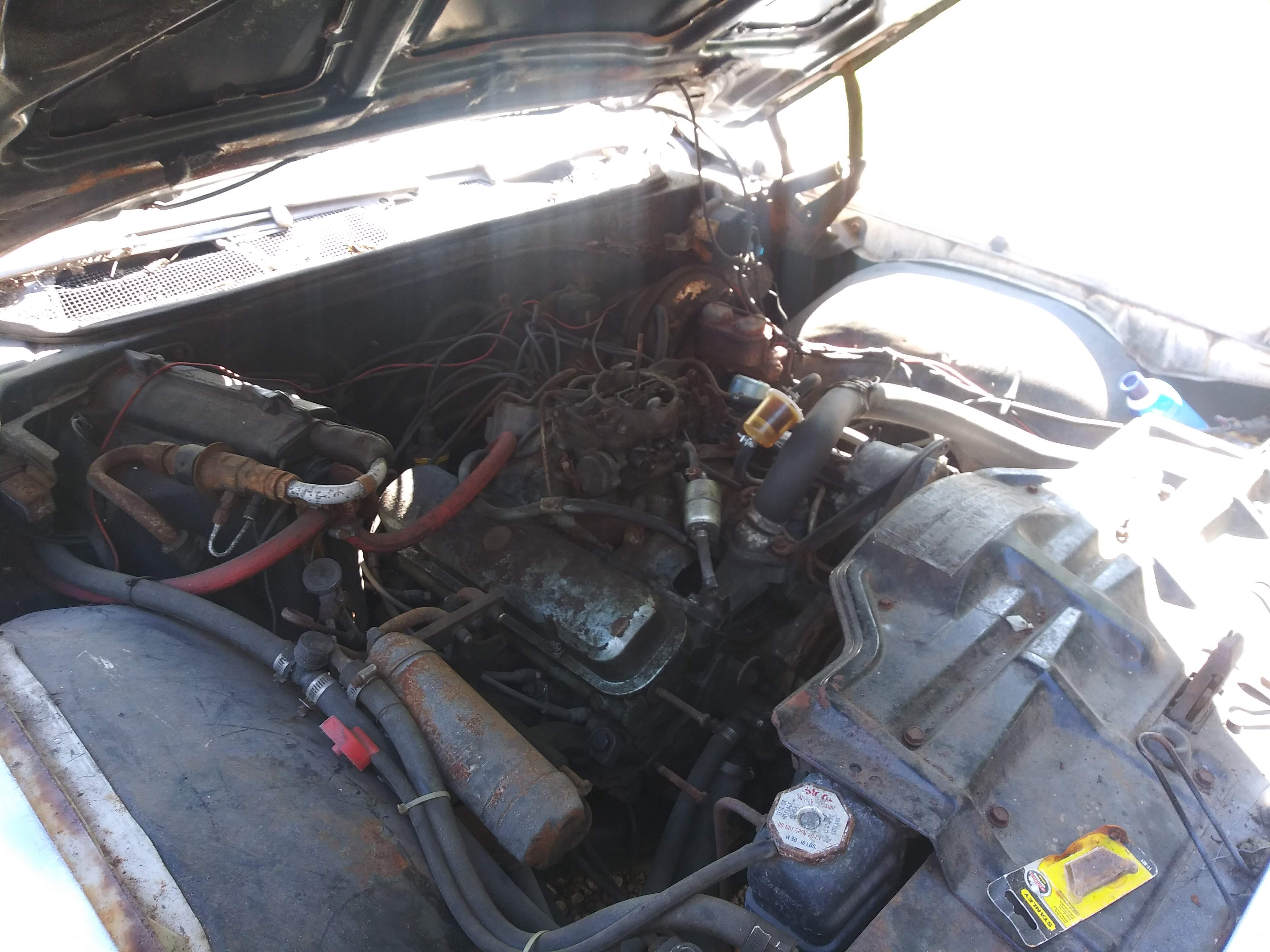

Looks pretty solid. What engine?    Here's a good place to start with what ya need.

Numbers matching 400 and 3 speed

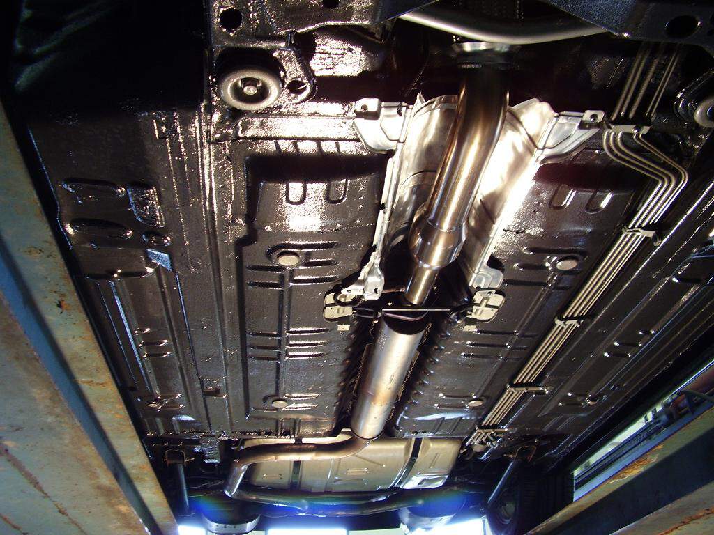

If I may, I would suggest you might also consider Hammerite rust cap paint. While LineX is a great paint and a good choice for a frame, I would tell you Hammerite is a better choice. The main difference between the two is dirt particulate adhesion. Hammerite is 30% glass particles. Which makes it very hard and durable, after currying and very slick. This makes it very easy to keep clean.
i would highly recommend Hammerite as I have used it for 50 years.

Good choice, but just be careful! It is a product that carries potential risk. The toluene and other aromatics are both breathing and skin absorption issues. Wear gloves and a mask if you work in a confined space, not outside space. At least wear gloves if ventilation isn’t an issue. And if you spray, which I don’t recommend, all the above plus protective clothing.
Believe it or not the whole underneath of the Indian, car in the picture, was painted with a 1/2 high quality brush, 3 coats! The first coat will look a little hit and miss. The second starts to build volume and you’ll think you’re painting contact cement & the third goes on fairly nice.
