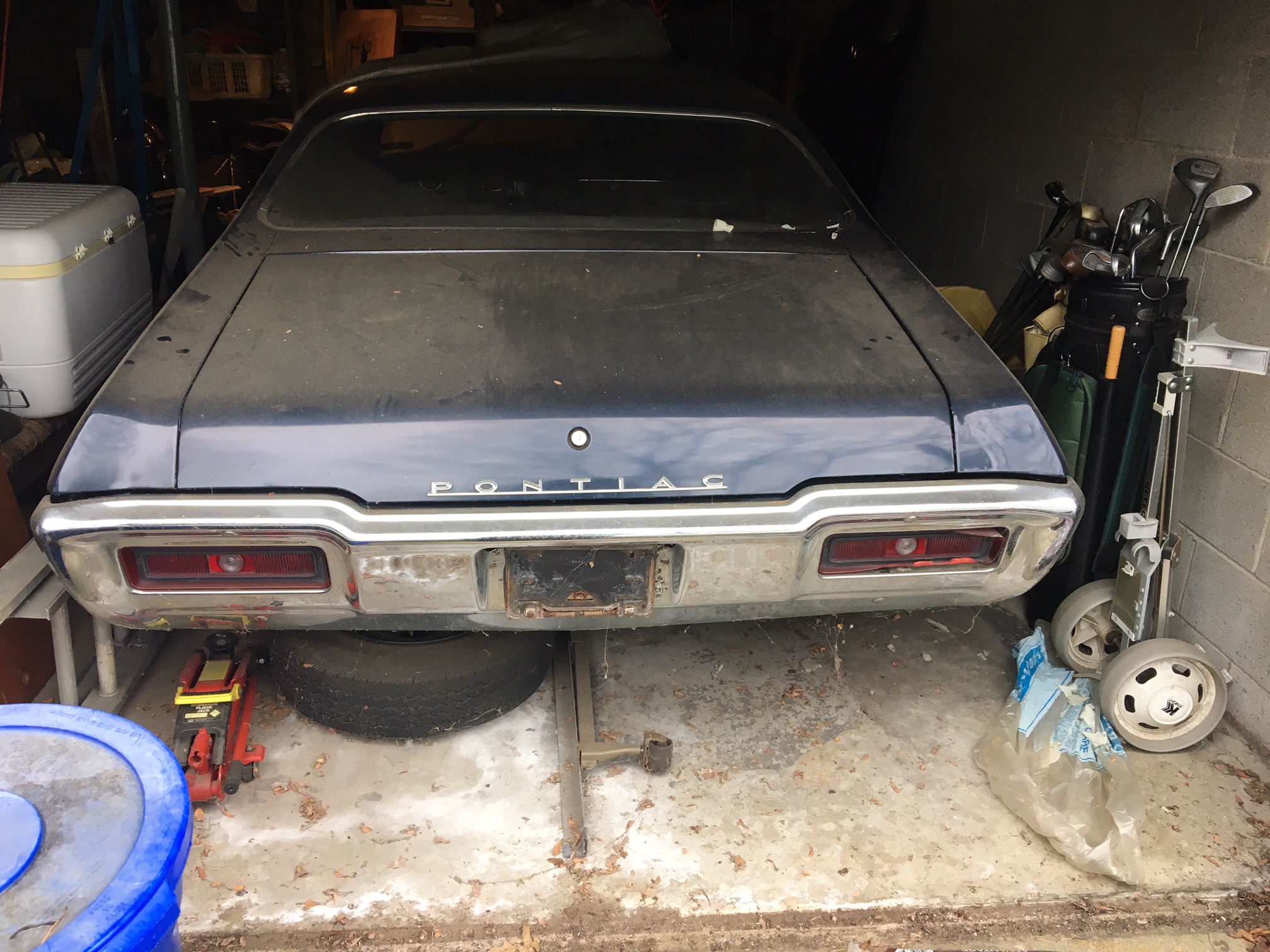

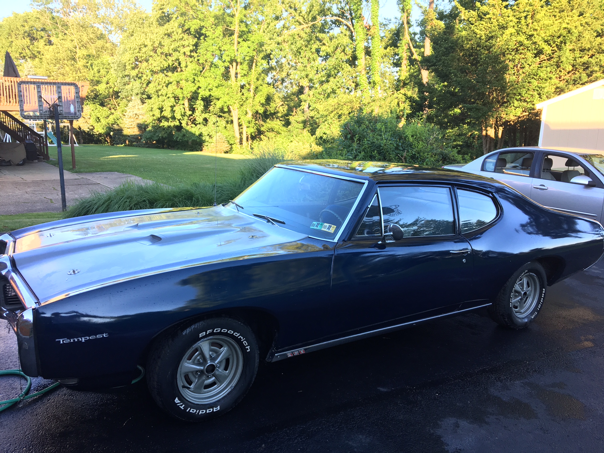

Hi everyone. A few months ago, I came into possession of a '68 Tempest Sport Coupe. This car is very special to my family because it was bought new by my wife's grandfather. It ended up sitting covered and unmoved for the last 27 years. My in-laws were kind enough to let me have it. I did a few weeks of prep work and got it running. It moves & stops under its own power, though I have more work to do before it's road worthy. Looking forward to interacting with the group. I'll share what little knowledge I have, and I'll be asking some questions.  Here are two shots -- one is the car right before I started working on it, and the second is how it looks now.

Nice looking Tempest. It's amazing what a simple bath can do to a car.  At this point, I don't see a whole lot of rust or rot - on the outside.  I see this is also a post-car and not a coupe.

Amazing....Looks in great shape overall.  Good Luck N have fun with it.
Great looking survivor! keep the glass packs! Still have the q-jet it came with? Nice car.
