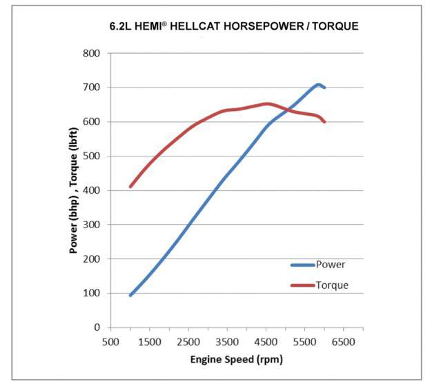

Back to Berra’s theorem, torque is the capacity to do work, while power is how quickly some strenuous task can be accomplished. In other words, power is the rate of completing work (or applying torque) in a given amount of time. Mathematically, horsepower equals torque multiplied by rpm. H = T x rpm/5252, where H is horsepower, T is pound-feet, rpm is how fast the engine is spinning, and 5252 is a constant that makes the units jive. So, to make more power an engine needs to generate more torque, operate at higher rpm, or both.
While thumbnail definitions are great for textbooks, applying them to real engines is another matter. One concern is that every car engine has an idle-to-redline operating range. For example, the Dodge Challenger’s 6.2-liter Hellcat V-8 produces 707 horsepower ONLY at 6000 rpm. It makes substantially less power at idle (only enough to spin engine-driven accessories) and a bit less than 700 horsepower at the 6200 rpm redline. And it delivers its maximum 650 pound-feet of torque ONLY at 4000 rpm.
