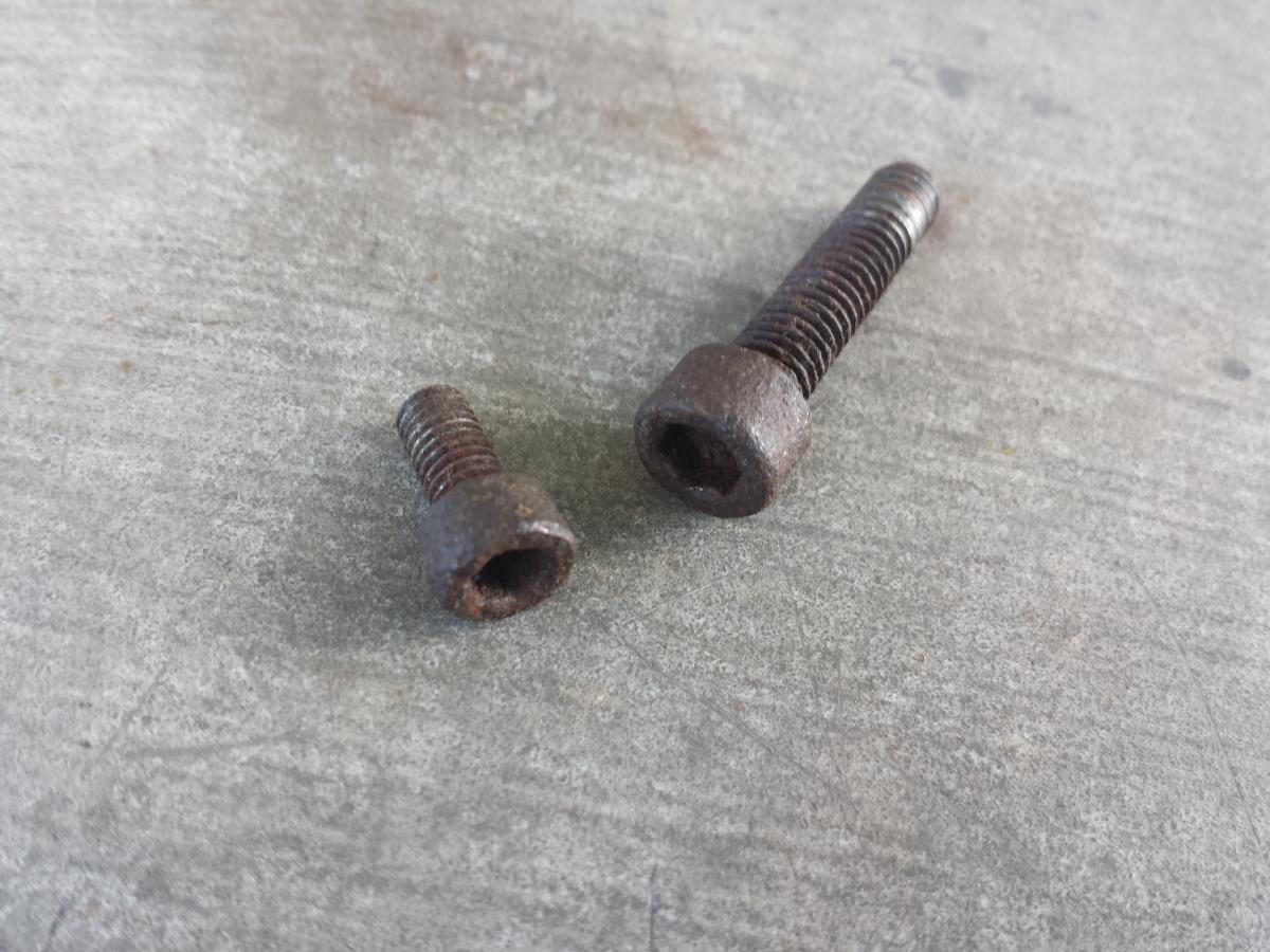

its been rather sunny lately and i thought id put the 20s back on and give the chrome one last ride, besides, the Toyos only have 20-25k miles on them anyways. chrome has started going bad but its not too noticeable. but the center cap bolts/screws are rusted and ill need new ones. first, whats the proper name for these? second, where to get them at an affordable price and possibly color choices? and rust resistant?
My local hardware store has a good assortment of them.No colors other than black and chrome.Hex head cap screws i think is what they call them.
Yup hex head screws. Lowes, home depot in the hardware section. or a local fastners store like fastenal
cool. but would those be a problem being that they are from a hardware store? and thanks!
Nope? Just get the proper threading and you will be fine. Just holds the center cap on correct?
im going to look around tomorrow. and yup but i meant heat and rust. sorry i should have been clear on that. thanks.
Get some stainless steel ones and you will be fine
alrighty. thanks.

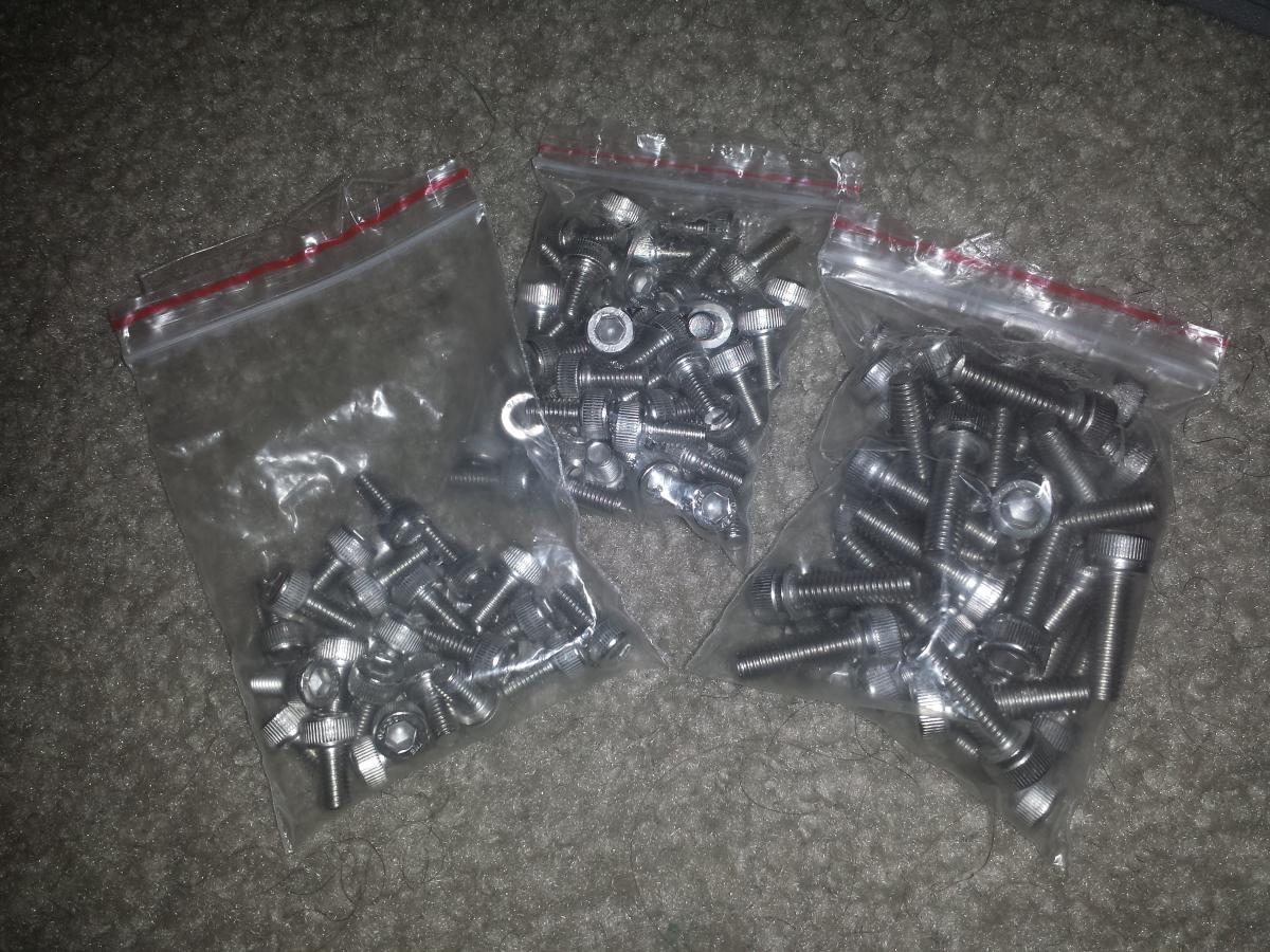

had some bolts come in some time ago. already used half of the left bottom baggy on the center cap itself on the back side. the other left one is for the rim, front of cap. and the right one is for the center.

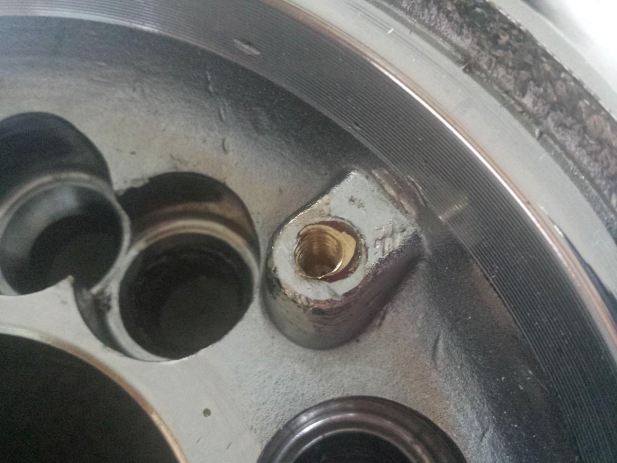

finally got the seized bolt and broken easy-out tip out of the rim. redrilled bigger and inserted threaded brass with loctite. redrilled proper size and tapped.
Very nice! Now fix the wheel studs
uh, dont remind me. ill roll with four for now. i cleaned most of them with a wire brush. are there any that dont rust?
Very very small amount of antisieze on the threads. Mine dont have any rust on them but I also remove them multiple times though out the year, I would venture to say upwards of 5 times. Twice to swap from winter to summer set up.
