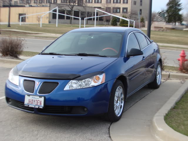

My ROH's are 17x8's, on 235/45 R17 tires, I have no spacers, or hub rings, and I have no rubbing issues.

I chose stock but I LOVE mine and they are so much better for my stock 17's! I have 215/55R 17 98W Yokohama S.drive Tires.
