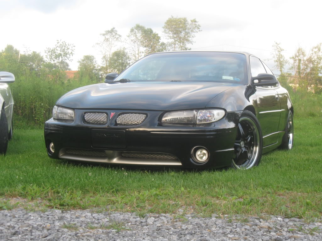

I have koni adjustables with eibach springs. I had to put trans and motor mount spacers in tho for the vibration.
GP looks good and low, nice job
