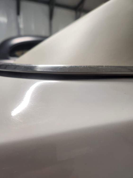

chrome trim for convertible at back near trunk
20260620_111007.jpgon the convertible there is a chrome piece that goes around the rear section of body, when you put the top down that a cover goes on to go over the top. the chrome piece is loose on one side I grab it and pull it back but it doesn't stay. was thinking of giving it a tap with a rubber hammer to get it on better, is there a clip or something under it that's missing or is it just my luck.

On my 70 B-body Catalina, its a screw up front on both sides of that trim and it is only reachable very easily with the rear door panel removed. Elsewhere on that trim, it does appear to be clips with screws and nuts.
A 1970 Factory Assembly Manual for your Lemans would tell you exactly how your car is put together including parts numbers for those clips, nuts and screws. And most likely, those pieces of hardware are still available from AMK Products Inc.
