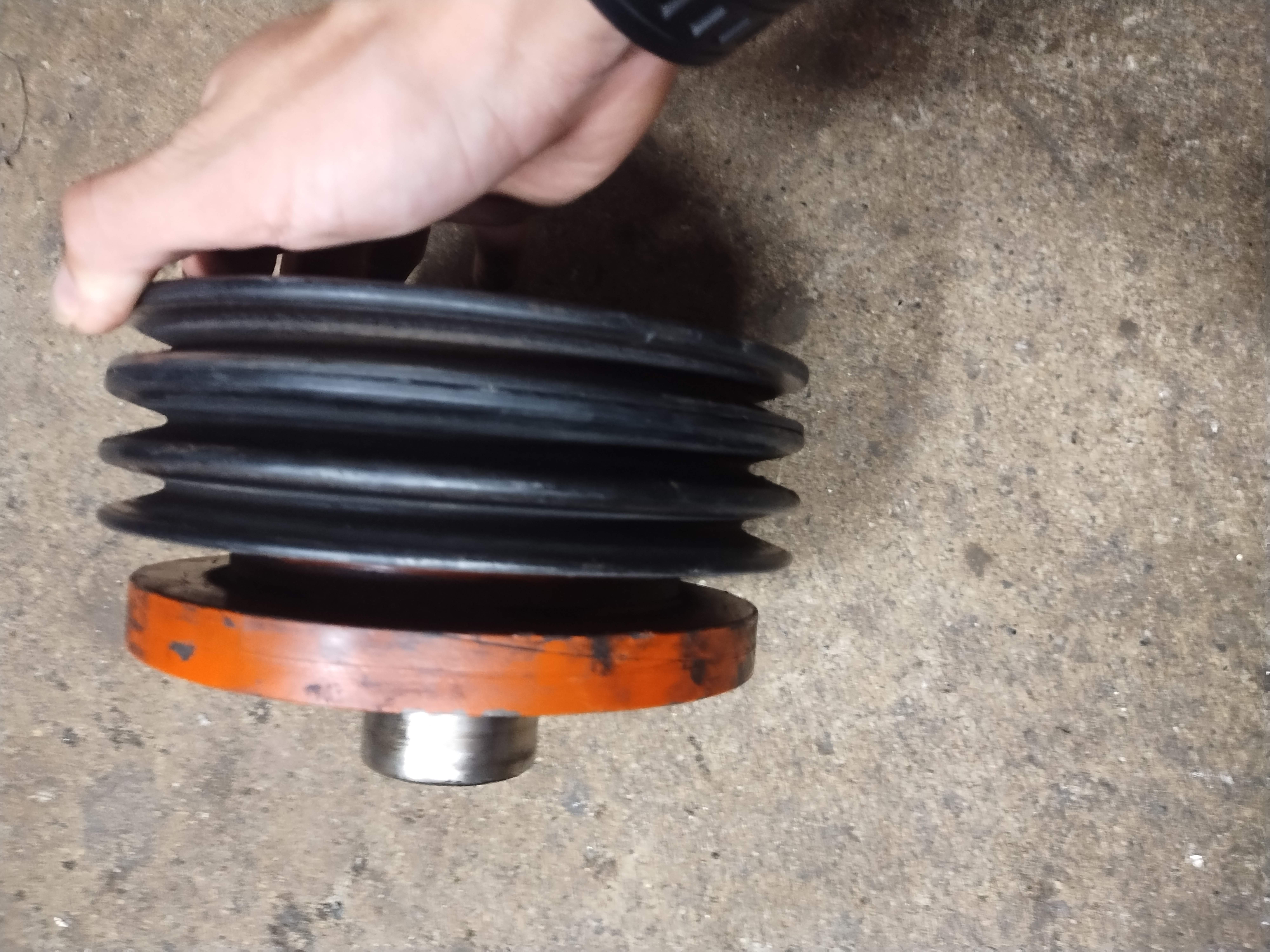

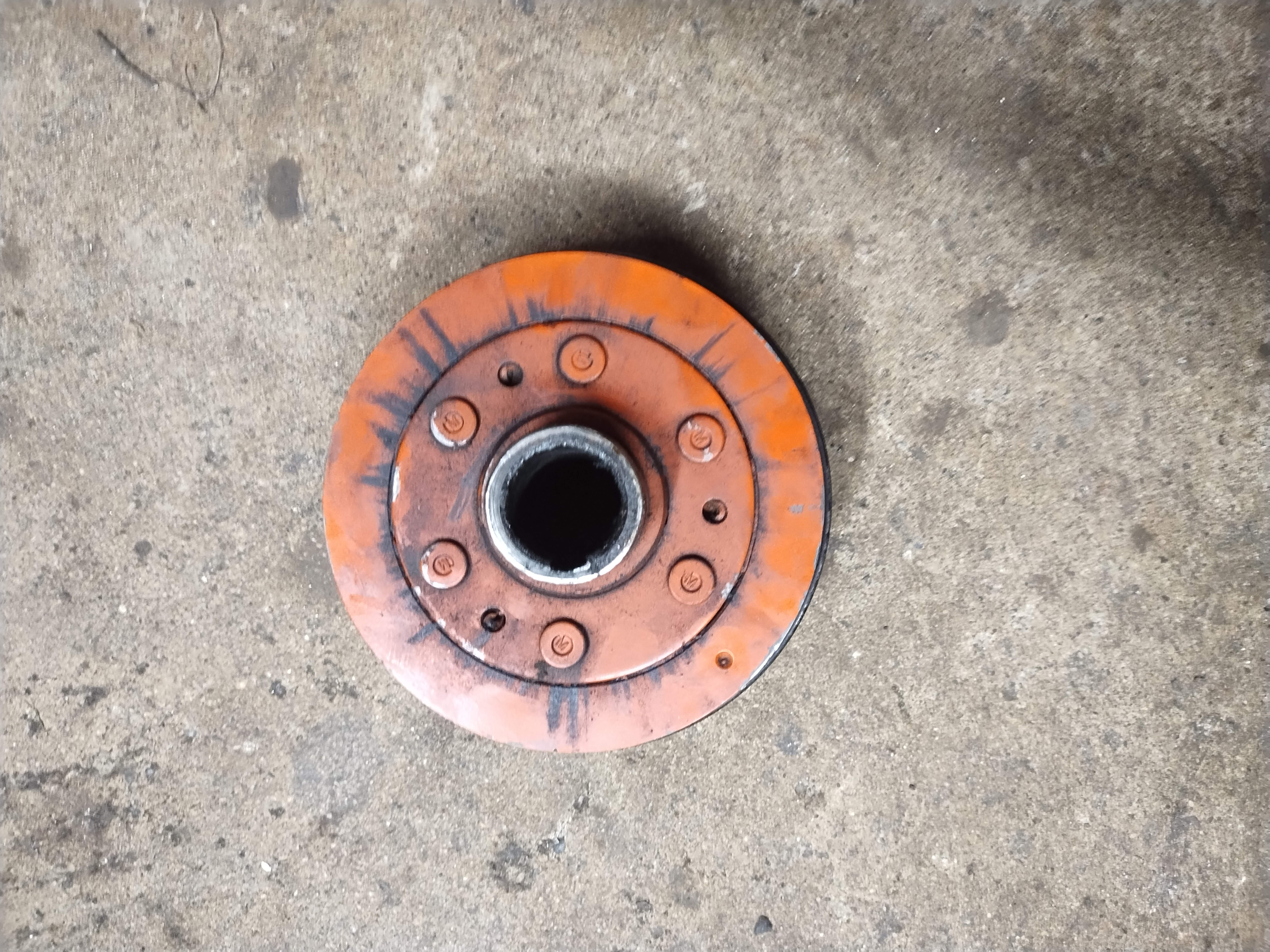

Now I'm trying to find a new balancer as the old one is junk the keyway is twice as wide as it should be on the end of the balancer. The crank is fine.
My question is this is friction fit can I get a new 6" balancer that is friction fit or do I need to get a used one that matches mine. There are no new ones that look identical to mine. See picture.

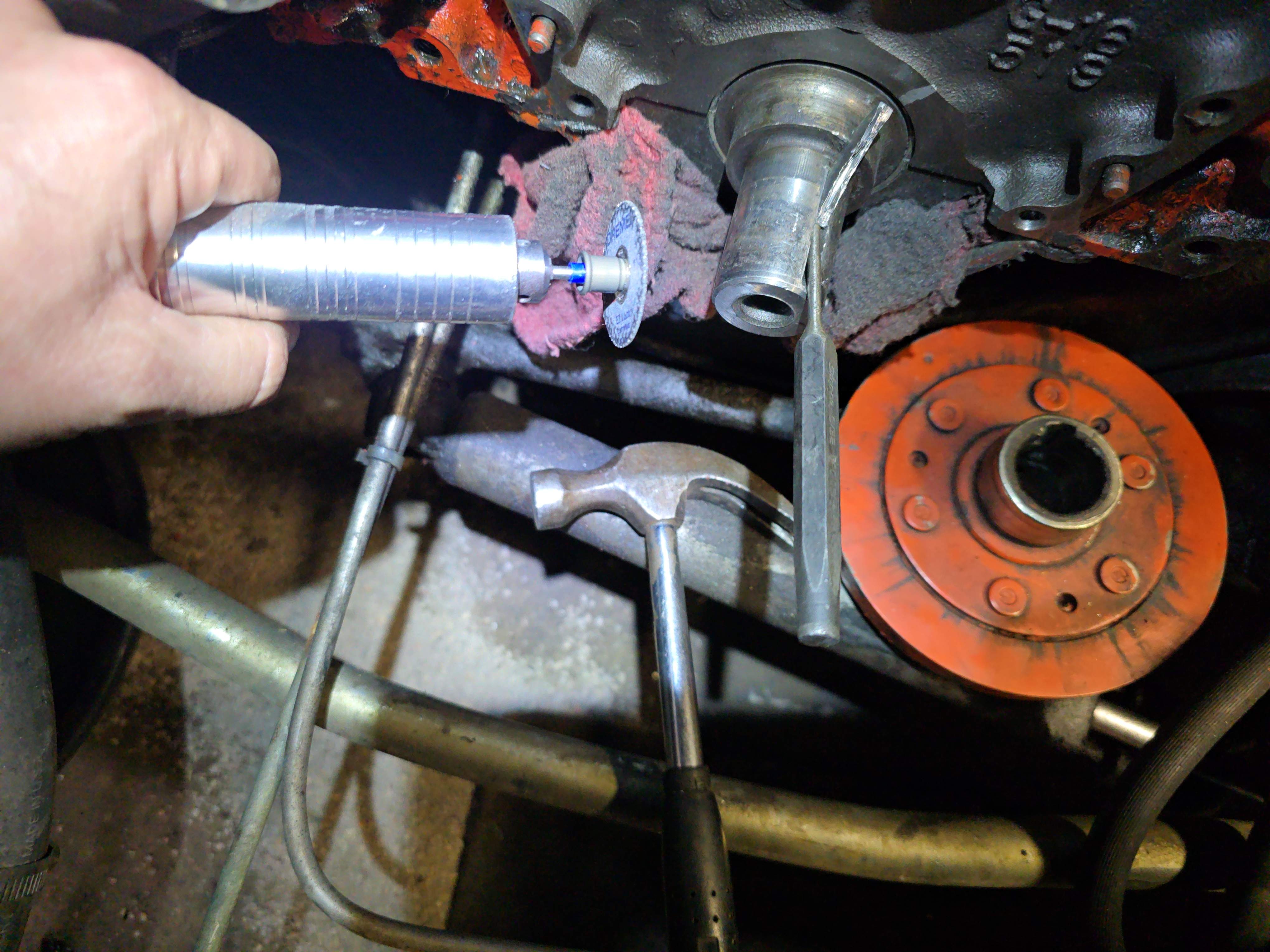

Well that was an epic battle. The woodruff key refused to let go of the crankshaft. But it was too badly damaged and needed replaced. I got it out but I need to find a replacement. If anyone has an idea what part number I need I'dappreciate the help.
Is off a 1960 chevy 283. I know its 3/16" thick. And its long i think with a flat top of some sort.

Its deceiving I ground the entire top half of my key off before I got it out.
So i bet thats close
