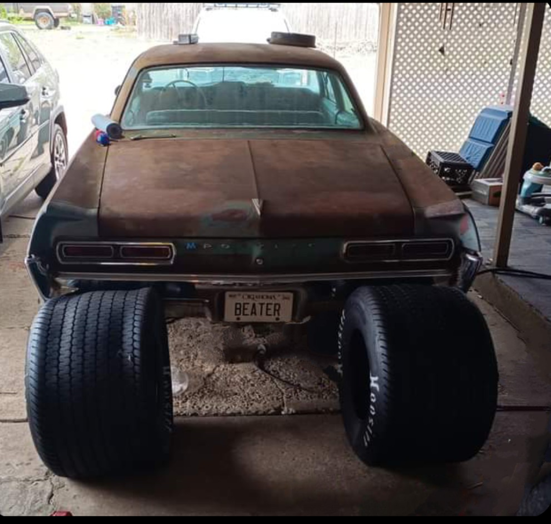

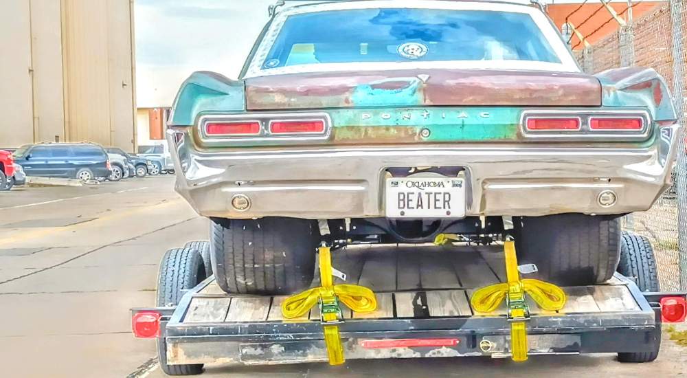

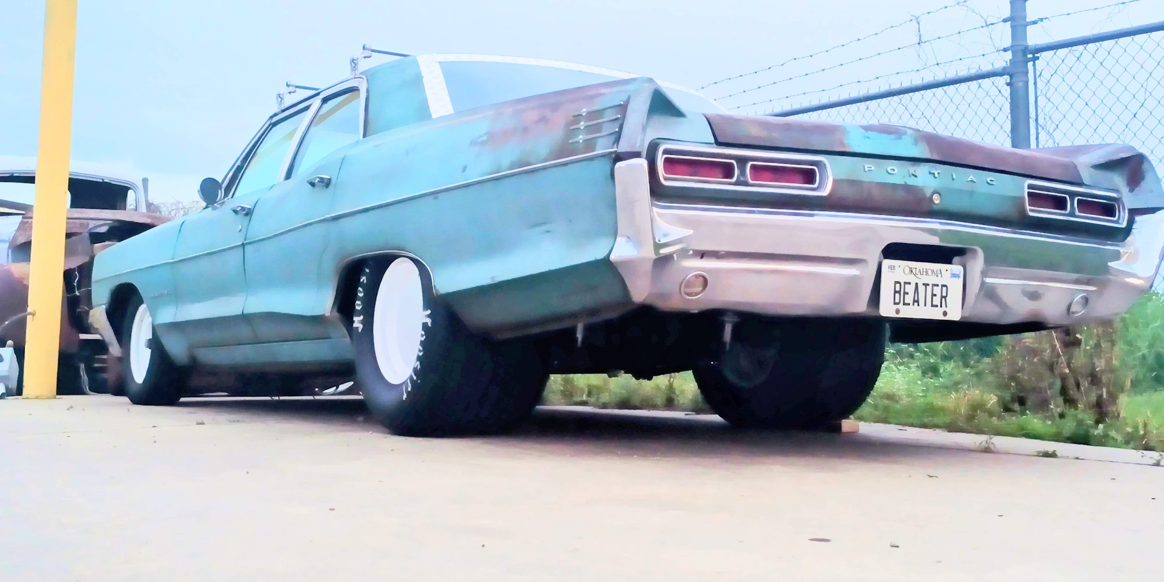

I'm actually currently building a 4L80E to swap in that way I can run some 4.11 - 4.30 ish rear gears and be able to cruise at highway (not Autobahn) speeds and not have 5000 RPMs sucking fuel.   My rear tires are 31” tall and that much rear gear will help turn them ....
Edited by TheOldBeater

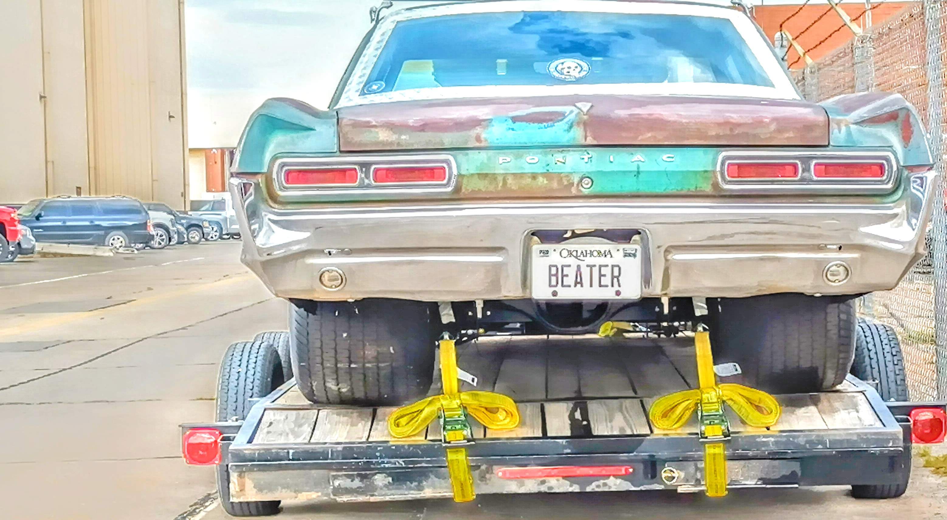

..... Yeah the rear tires are 31” tall ... 31”tall and 18.5" WIDE!!!!
31x18.5-15 to be exact
#wideload #steamroller #thiccboi #meatyScreenshot_20241213-2042132.thumb.png.098eb19421f50f7d4b19d998c8c29b23.png
As Trump would say ... YUGE!!!IMG_20230719_0851033.thumb.jpg.96f579ab4b1803e83cedc68a76470600.jpg

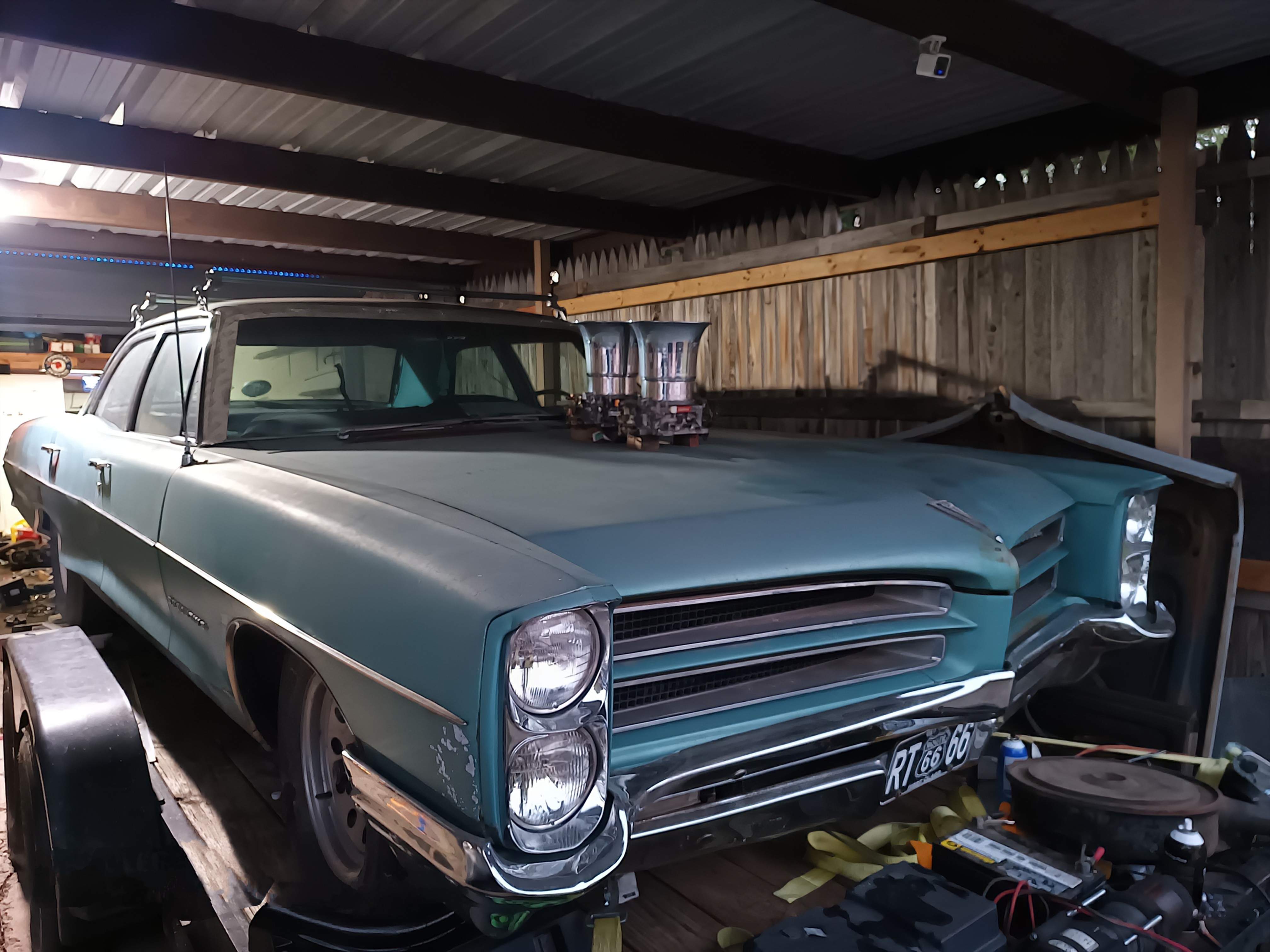

Tucked in their nicely IMG_20230623_1243492.thumb.jpg.213620f8c0ce86c2db2f224105e2dd24.jpg
awwwwwww! nice :cheers:

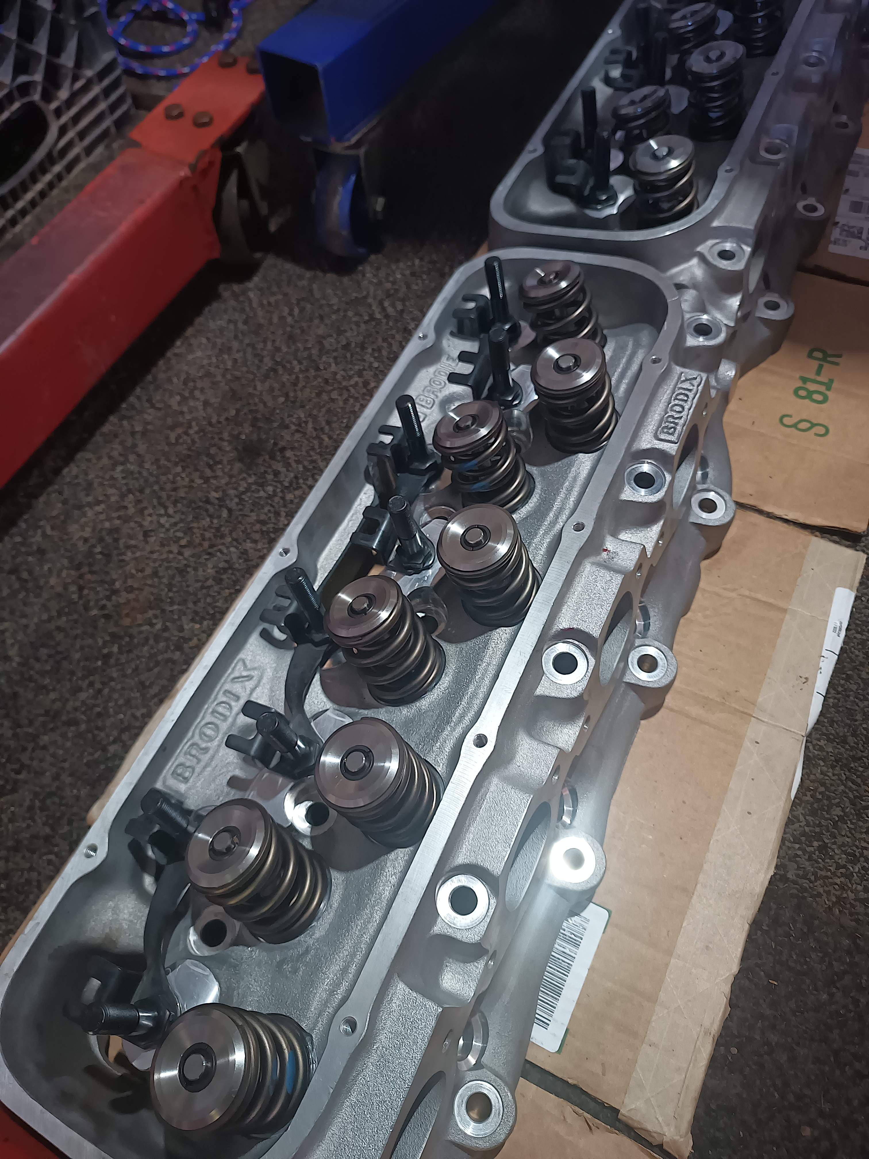

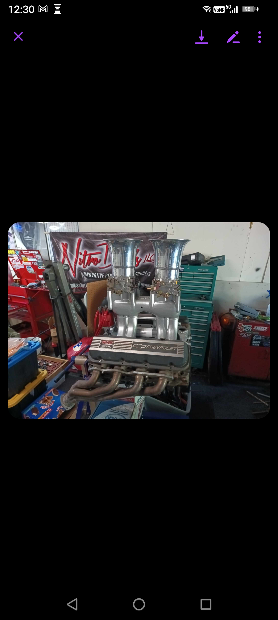

I'm currently building a 540 big block Chevy to go in my car.  Not a race car engine but more of a focus on mid to low range torque production.  ... I'm not getting hung up on certain power numbers that I want to make but from what I'm reading the combination I'm putting together should make a round 750 horsepower and around 700 ft lb of torque at the flywheel.  Maybe just a little more depending on camshaft selection.
And if for some reason this torque monster power plant doesn't make this land yacht coot around quick enough and it's still feels lethargic I'm going to leave enough piston Ring gap in the for a 300-400 shot of nitrous.  I can't wait to see the shock on the face that new Corvette Camaro or mustang that pulls up next to me wanting a taste of the action.  IMG_20240904_200439_915.thumb.jpg.837f2b7a6fd97cc3037390e2094b331b.jpg
