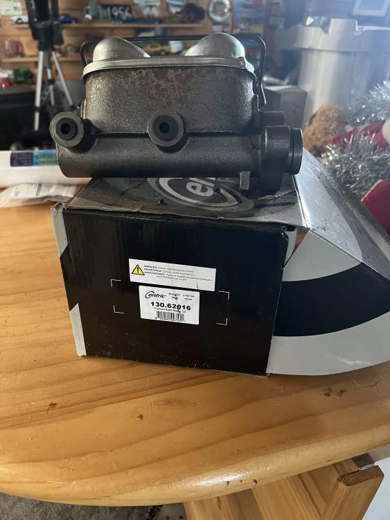

straight swap to bolt in the booster and up grade the master cylinder to one of these ….
Rock auto have them and brand new boosters as well
you will not need a proportioning valve with this master cylinder as its a drum drum unit
