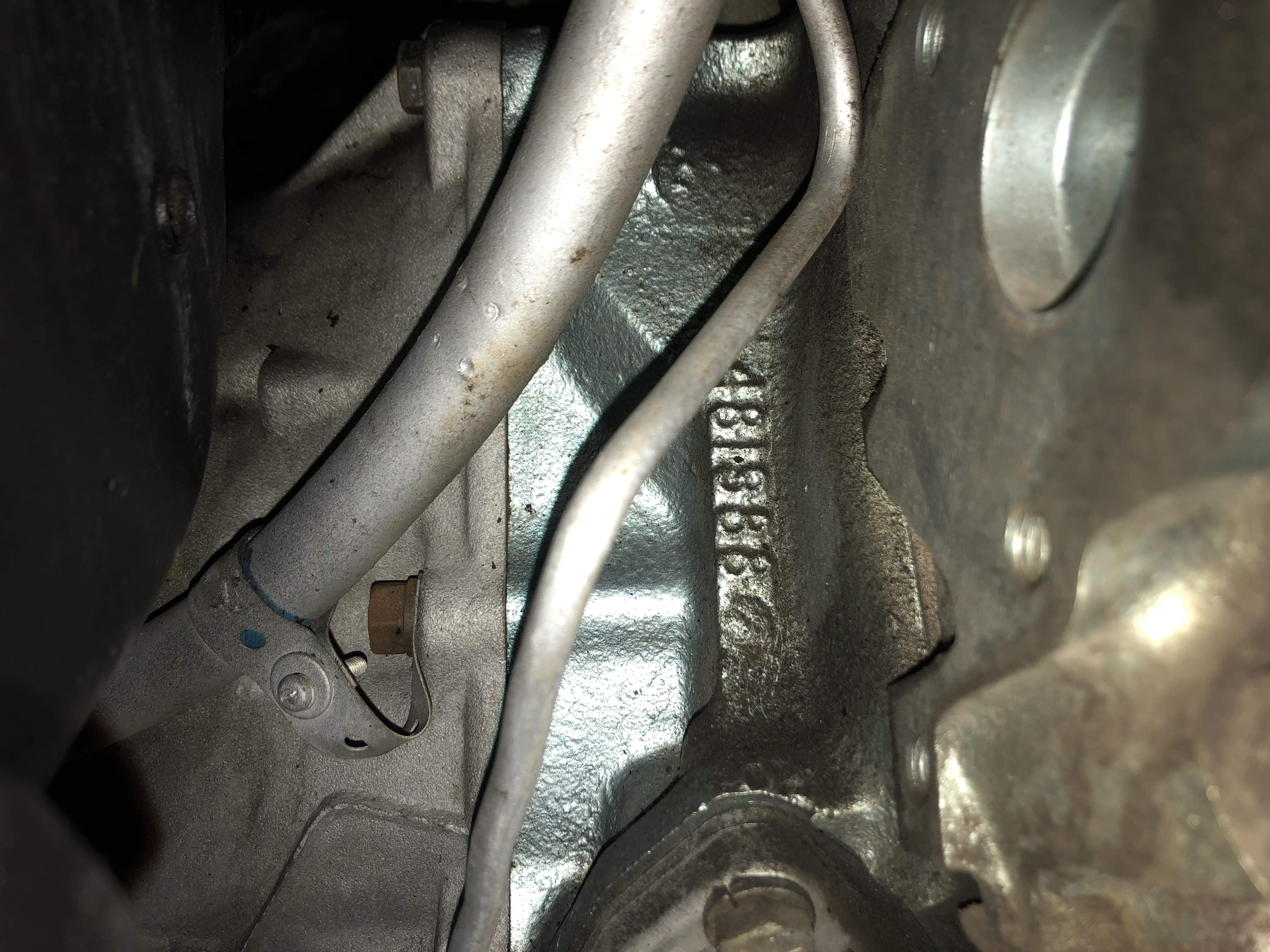

Hey I think I have an early 70 - 75 block here but it has a 8 bolt water pump. photo is of the stamp at the bell housing
This has probably been covered before so apologies but I’ve searched a bit an 8 bolt was 68 maybe 69, then 11 bolt onwards.
my question is why would an 8 bolt be on later block ? Is it just because the 8 bolt timing cover fits on the later blocks ?

You have more ID #'s on the front of the block next to water pump on  Pass side.  Worth keeping the link for future ref.                 https://wowmusclecars.com/pontiac-engine-codes-specs/
I can think of a couple of reasons.
The water pump cover is not original to the engine and it was replaced by an earlier model cover using the 8-bolt pump. This suggest that the original cover was damaged and replaced for some reason.
Second scenario is the the engine itself it not original to the car and the engine came with the older style water pump.
Thanks for that link it’s really good justa6.
frosty I did not know the earlier timing covers could be used on later blocks so cheers for that.
Yes. For the longest time, water pump/timing chain covers were not reproduced. So you had to scrounge around for a good used replacement , 8 or 11 bolt. Now they are being re-popped so getting a new one is a lot easier.
