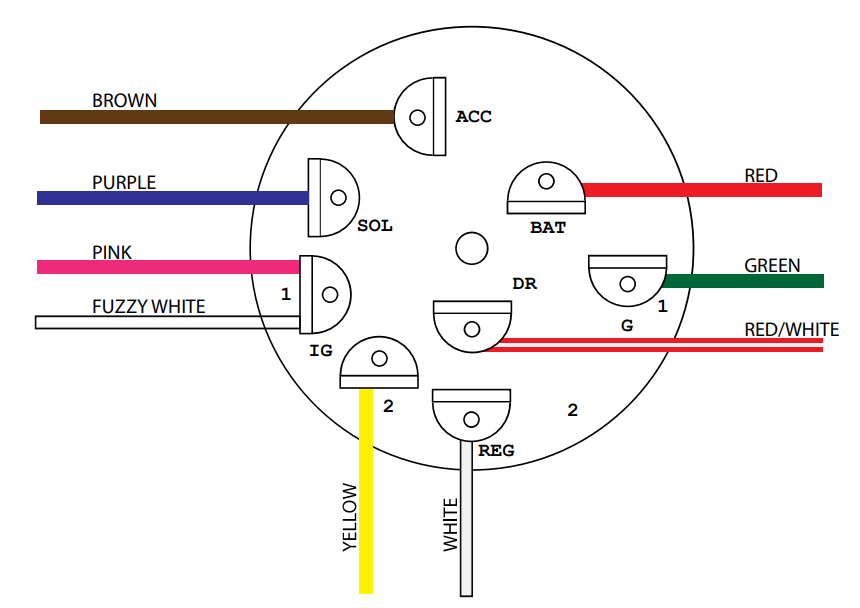

I am rewiring my 1966 Pontiac Catalina and am trying to figure out how to properly wire the ignition switch. I am using the original 8-contact ignition switch but have modified the vehicle:
Dakota Digital HDX gauges
MSD 6AL ignition box with MSD 8563 distributor and HEI coil.
Holley Sniper EFI
American Autowire Highway 22 wiring with trunk mounted fuse panel
I am not using the included American Autowire ignition switch because it does not fit my dash.
The original switch configuration is like this (see attachment):
I *think* have figured out this part using the American Autowire instructions as a guide:
The BROWN (accessory) wire goes to the FUSE PANEL and will distribute power to the accessories via the fuse panel.
The PURPLE wire goes to the NEUTRAL SAFETY SWITCH, which then passes to the starter solenoid on the starter.
The RED wire goes to (comes from) the FUSE PANEL and provides power to the ignition switch.
The PINK wire also goes to the FUSE PANEL to provide switched power to the ignition circuit on the panel, but is also accompanied by a fuzzy white wire shown in the schematics as a RESISTOR wire, which originally joined the YELLOW wire mentioned next at the fuse box.
The YELLOW wire is the original COIL wire and will go to the MSD 6AL box. Per the MSD instructions this wire only draws .250 mA and is the trigger wire for the MSD box. Power for the MSD box is drawn from the hot side of the starter solenoid.
The GREEN wire connected to the G terminal appears to have originally gone to the temperature indicator and the temperature sensor. Can I eliminate this wire since I have the Dakota Digital HDX gauges?
The WHITE wire originally would have gone to the voltage regulator. Given that I am now using an internally regulated alternator, do I need this wire? If so, where should it connect to?
The RED/WHITE wire (red with white stripe) is soldered into the main RED power wires providing power to the two bus bars in the fuse panel. What is the function of this wire? Do I need a secondary power source to this terminal on the ignition switch?
Can I eliminate the resistor wire completely since I’m not running points?
So, to reiterate my questions:
Can I eliminate the white wire from the ignition switch that used to go to the voltage regulator?
What is the function of the red/white wire – do I need a secondary power input to this ignition switch?
Can I eliminate the fuzzy white resistor wire?
Can I eliminate the green wire?

I did not "eliminate" any of these wires when I did the American Auto Wire Classic Update harness with the Dakota Digital HDX gauges in my 70 Chevy El Camino - I simply taped and insulated them off and hidden.  You never know when at some point in the future they might come in handy.
  The red / white wire is a little more puzzling and I would not eliminate it.  For testing purposes, I'd leave it disconnected and see what doesn't turn on with the vehicle.  However, my prediction is that you will need it connected to power up accessories coming out of the fuse panel.

So, what I've learned is the red/white wire is a secondary power wire to prevent overload on the switch. Probably a good idea to keep that so I'll wire it up using a 14ga red -- can't seem to find a 14ga red with white stripe.
