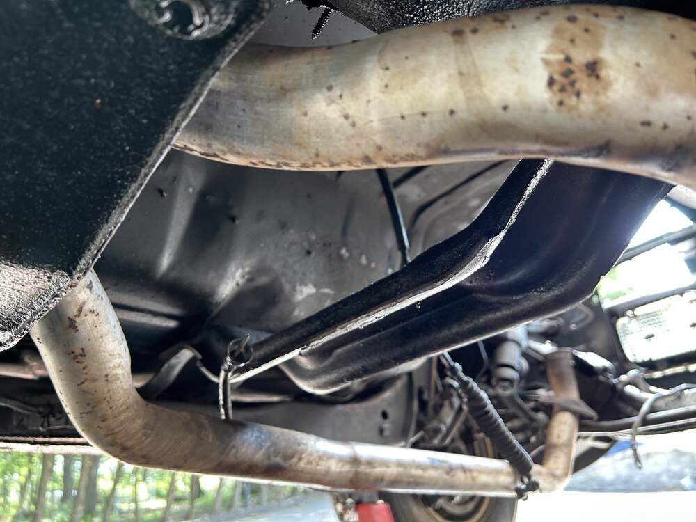

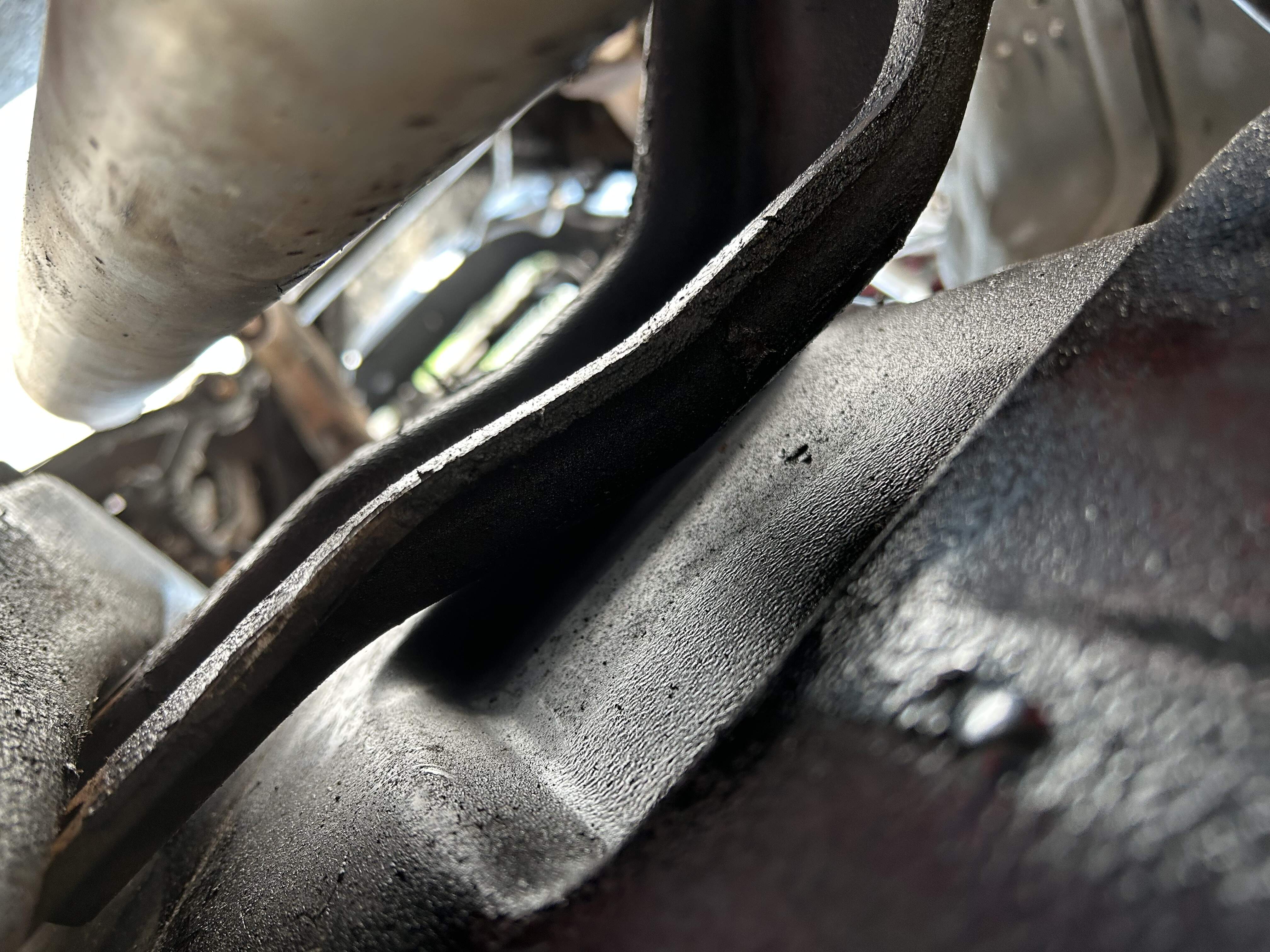

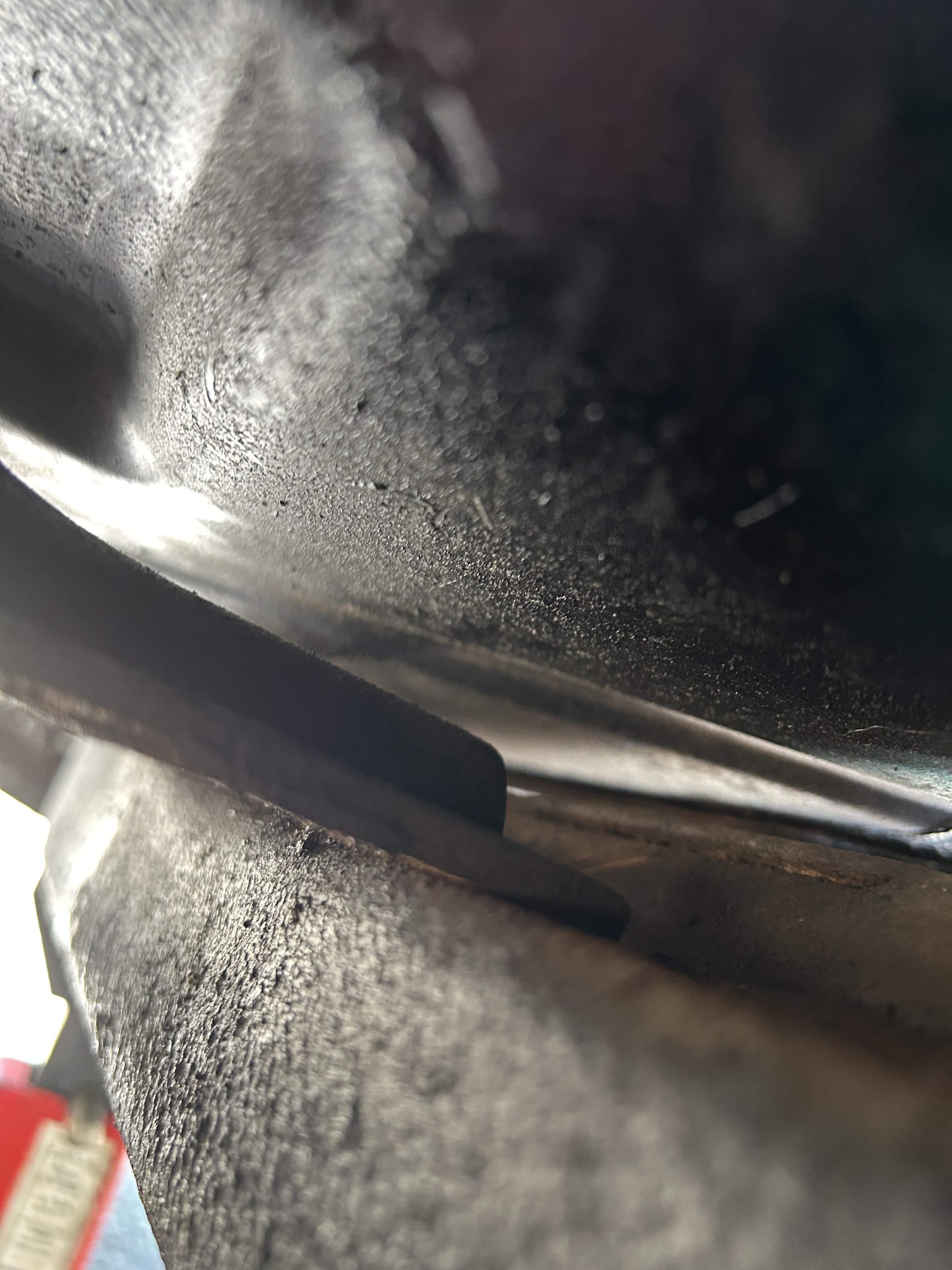

Trying to swap in a 200r4 trans but can’t seem to get existing crossmember to move back enough or removed. It hits the floor body. It seems to  trapped in the grove for the crossmember. Has anyone had this problem and how was it resolved

I think they twist to come out ? Been years since I pulled the trans on my gen 2 camaro
You may need to undo your body to front chassis to get the space between floor and frame …. Good time to fit new mount bushes too 👍
Thanks I had to loosen the body mounts to get it out
