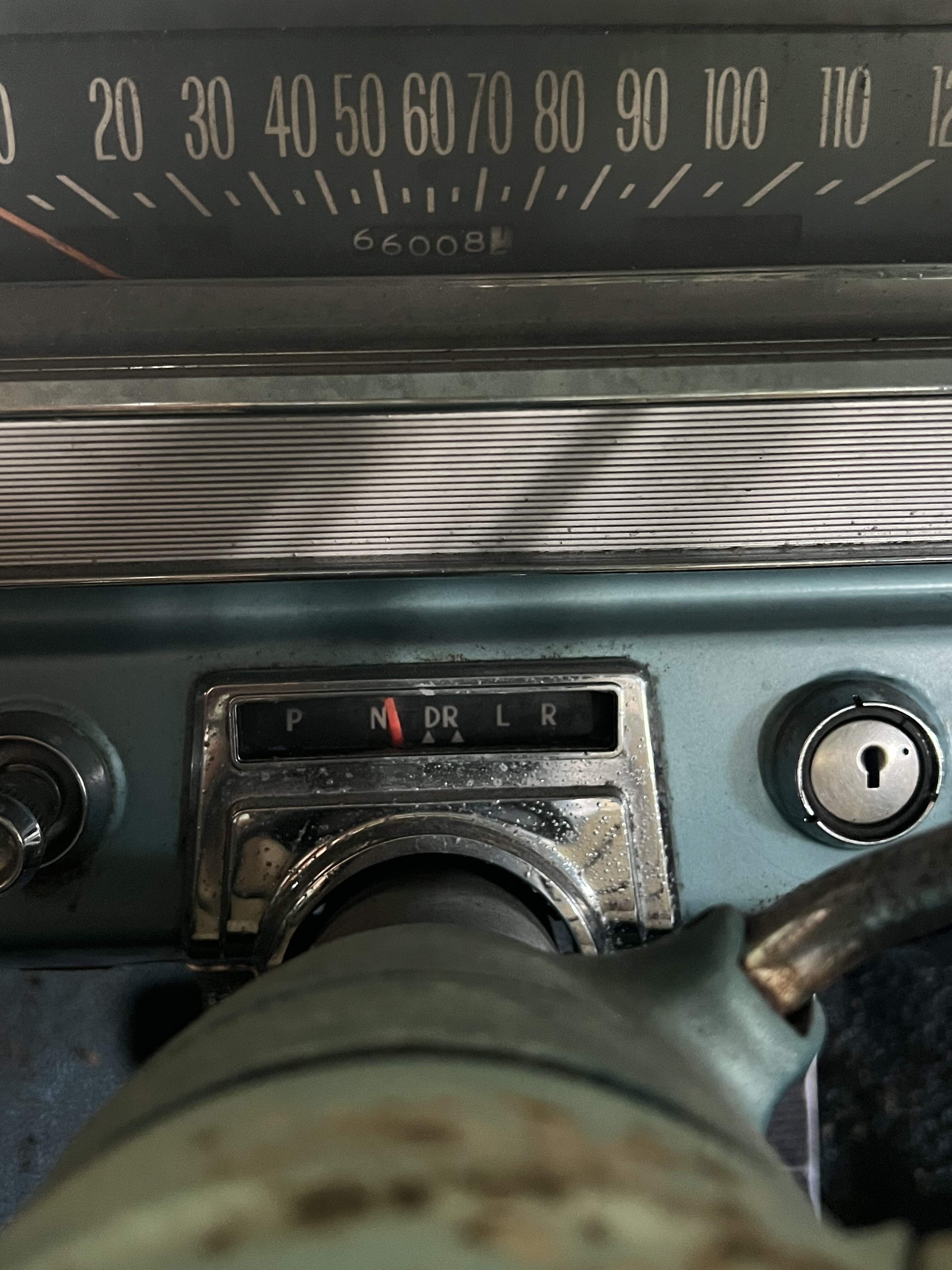

Thank You 64 Kiwi Boni! I have had a couple exchanges back and forth with Butler and they have pointed me in the direction of their adapter plate. I have just always wanted a manual. I grew up watching my dad work on and show his 64 Goat with a 421 and it is a 4spd car. Just want to feel that Poncho power when I shred throw the gears. I’m just having trouble figuring out what type of transmission I have in the car now. I believe everything to be stock..? I’ll attach a picture. Maybe you could help me identify? IMG_4014.thumb.jpeg.ed5f4b56aab1bd9051cad1d59f8b8ac3.jpeg

Thank you Justa6! Can you by any chance tell me what transmission I have based off of the picture of my selector gauge?IMG_4014.thumb.jpeg.87640ccfc8faa460b6468eb95bc70b54.jpeg
   Feaster22, I believe your transmission is the infamous RotoHydramatic a.k.a the Slim Jim.  In the late ‘80s I had a ‘61 Catalina with the same transmission and converted it to a 4-speed ( with a lot of help from a friend). Don’t remember all of the details but if you go factory original, the pedal assembly and clutch linkage must be from a 1961 or 1962 full-size Pontiac.  I think the transmission rear crossmember is different than the automatic and I don’t remember if the driveshaft length was different. I had a bell housing that fit the pre-‘65 block. I used a Muncie  4-speed from a ‘69 Firebird.

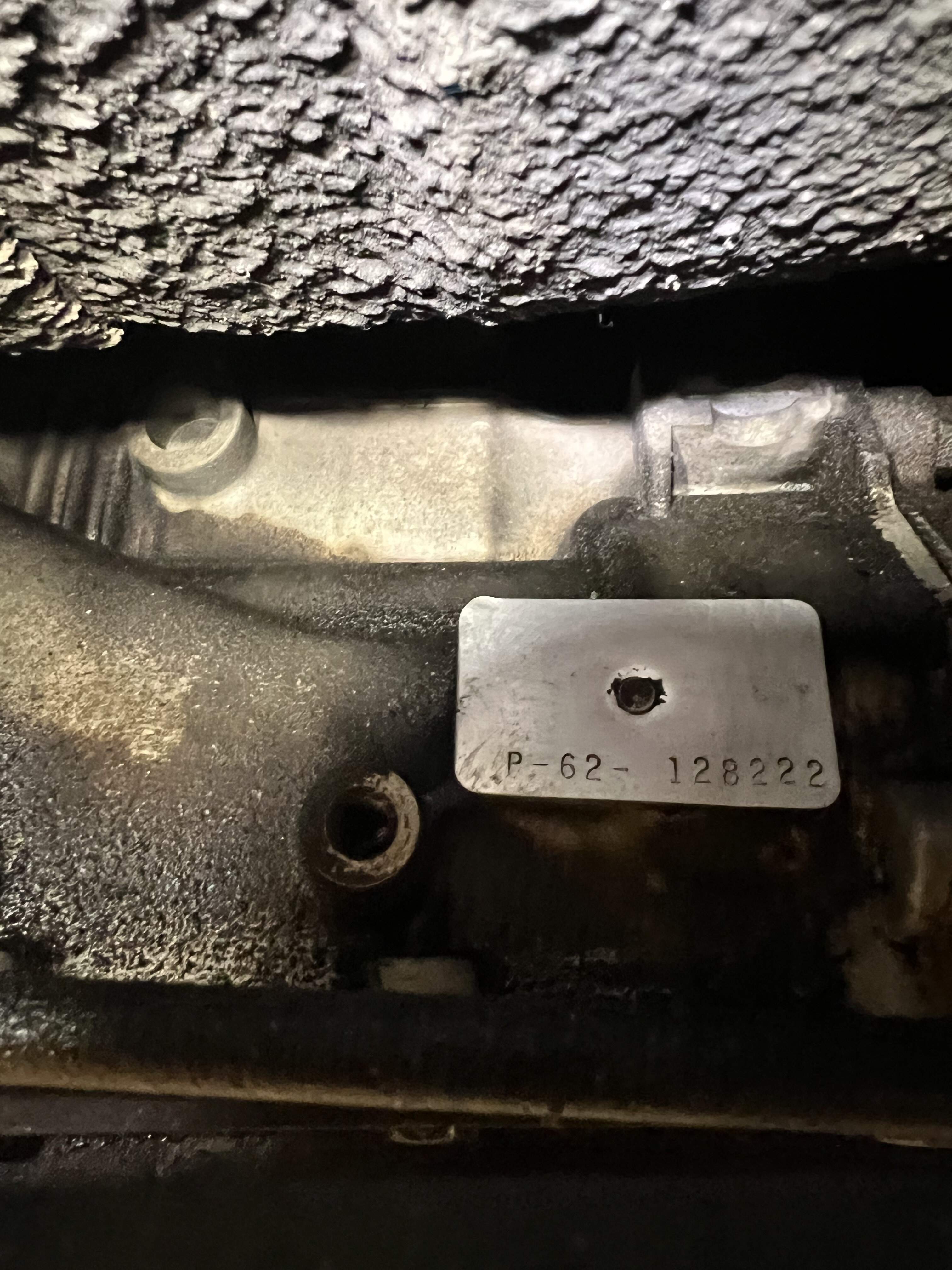

Hey welcome Feaster22, a picture of the trans pan would make identification a lot easier buddy.
Yes true
like Tim said the slim Jim was a pos trans .. but also easy to Id if you post some pictures  it’s of it … and like wise if it’s a super hydromatic … I have stared at my one for hours !!! Hahaha :rofl:
Sorry, my Pontiac knowledge goes back to 66.  Don't think to many could identify from the shifter.:indian:
