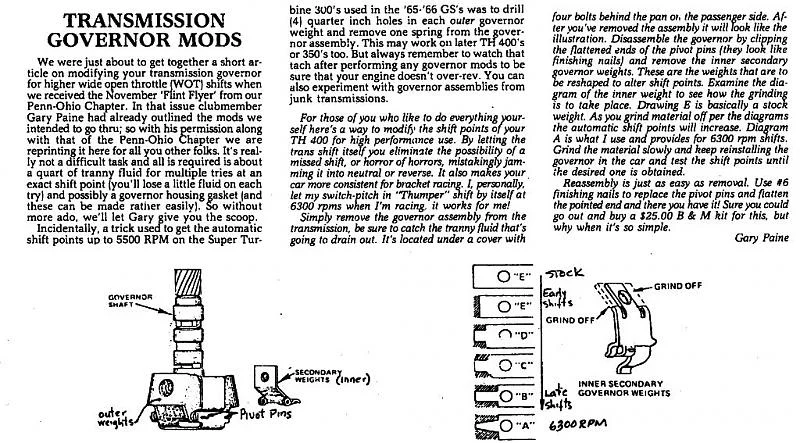

So today i spent the day pulling the Governor and modifying the inner weights by removeing some metal alittle at a time
removing cutting some metal off reinstalling checking pulling it again and again...
after removing 2 grams of metal equally off each weight i was finally where i want to be!!
WOT didnt change alot but it shifts alot better around town etc..Very Happy!
Then i found this article...Thanks Mr Paine!
I ended up with roughly B in the article below.
2nd to 3 is right at 5k rpms
