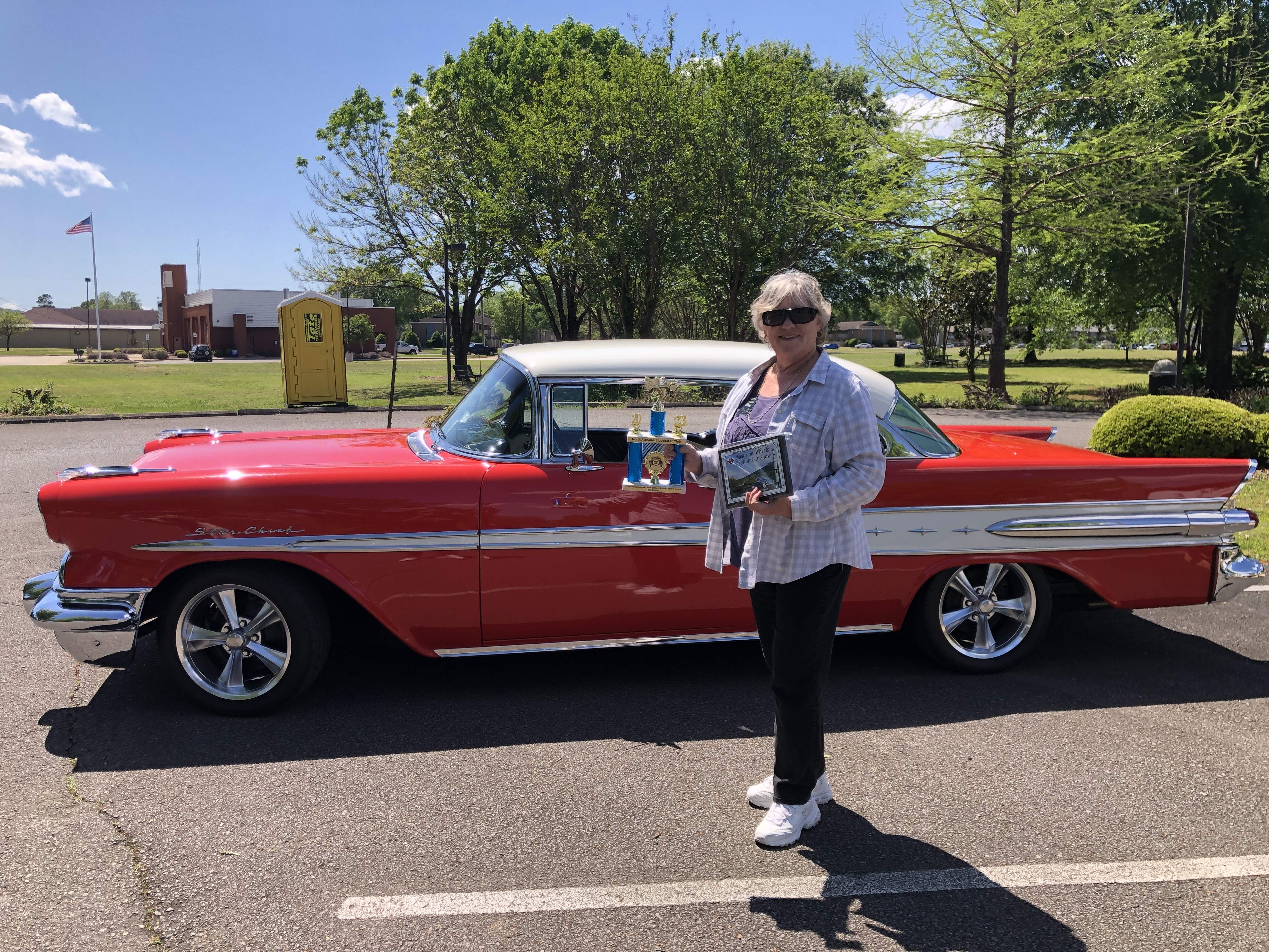

Linkage is fine.  Guess I'll do a change of fluid.  Thanks for the suggestions.  Pic from last weekend car show.  That's Mama!IMG_4927.thumb.jpeg.75a1b12150dcc2e22f28730490203880.jpeg
Congrat's on the well deserved bling!
So very cool washtub:dancingpontiac:
Maybe I should be painting my one red !!!
Sweet ride! Congrats bro.
