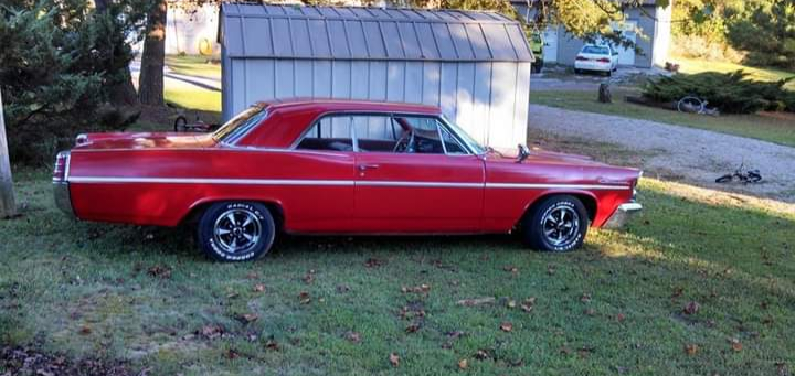

Looking for headers that will fit my 63 catalina 389. Any info would be great.

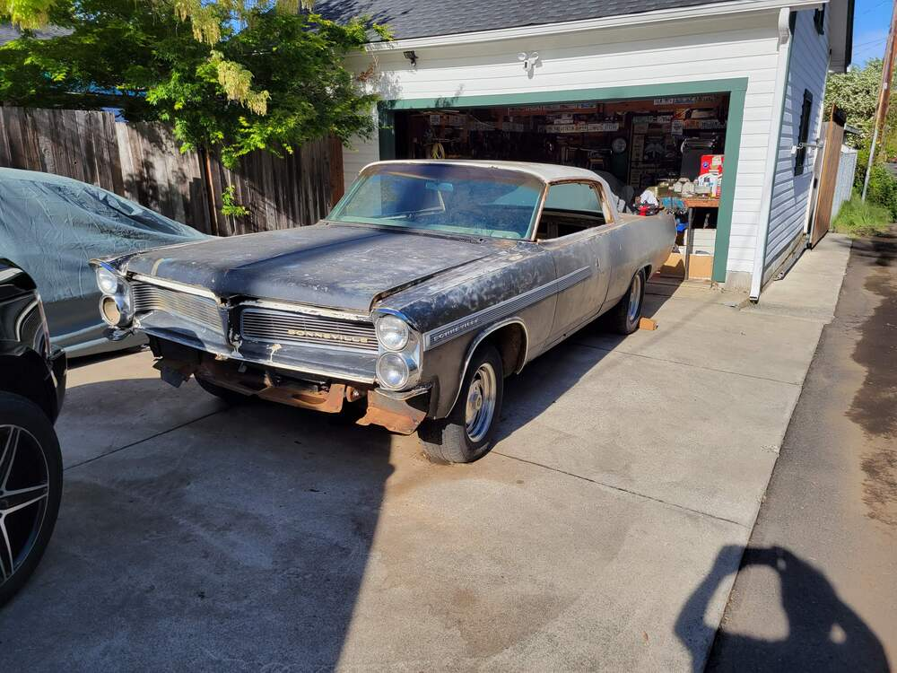

not really Brian, Tony has a whole bonniville for sale..
i am not quiet sure how to show you the post, but its in the for sale forum :dancingpontiac:

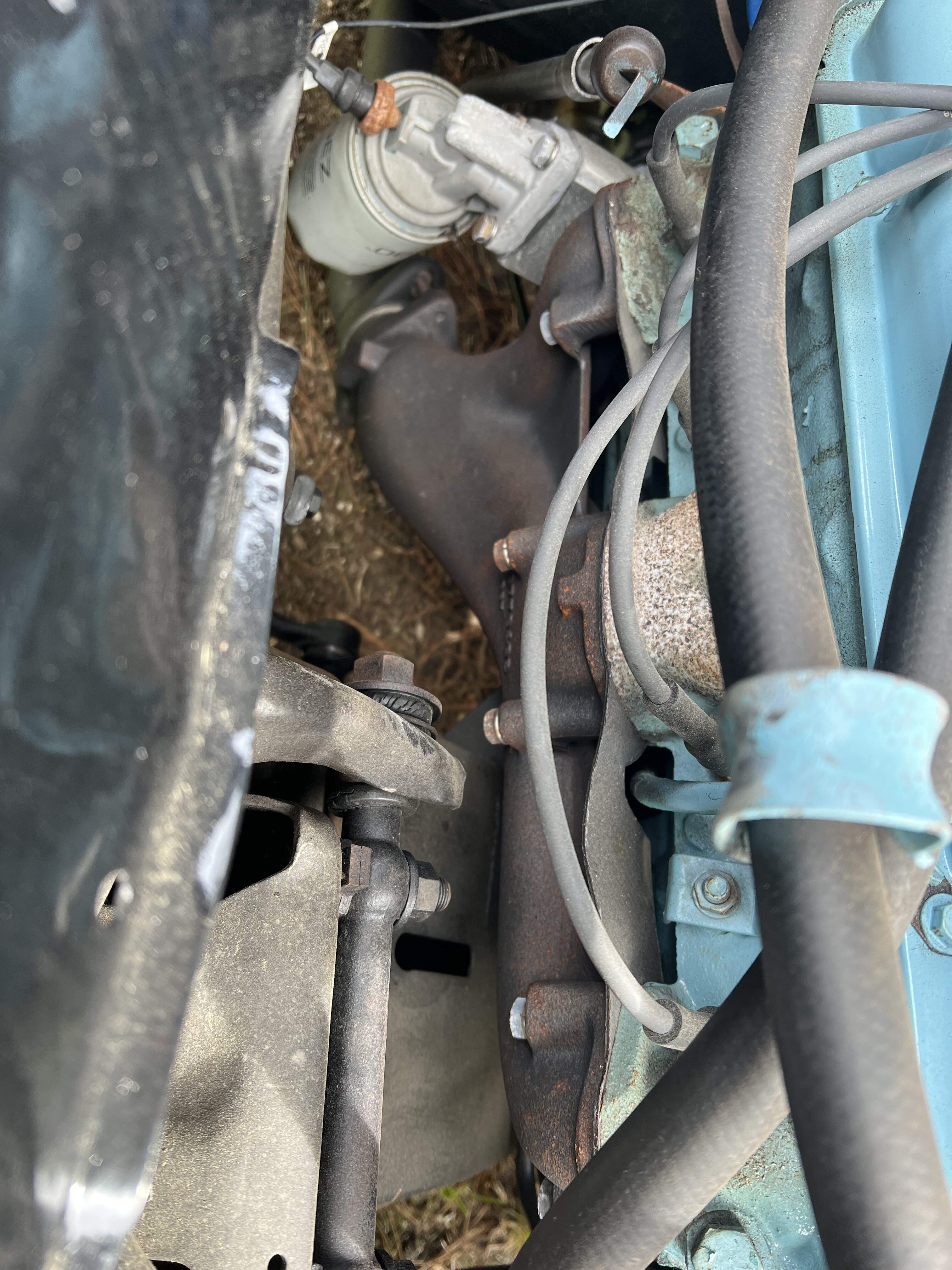

My pictures aren’t too flash ! It would be better if I had the car on the hoist and took some pics from under side !
you can see i have heaps of room on the passengerside, and the mainfolds come with a oil filter spacer that moves it out for better clearance, and it has 2 1/2 inch outlets.

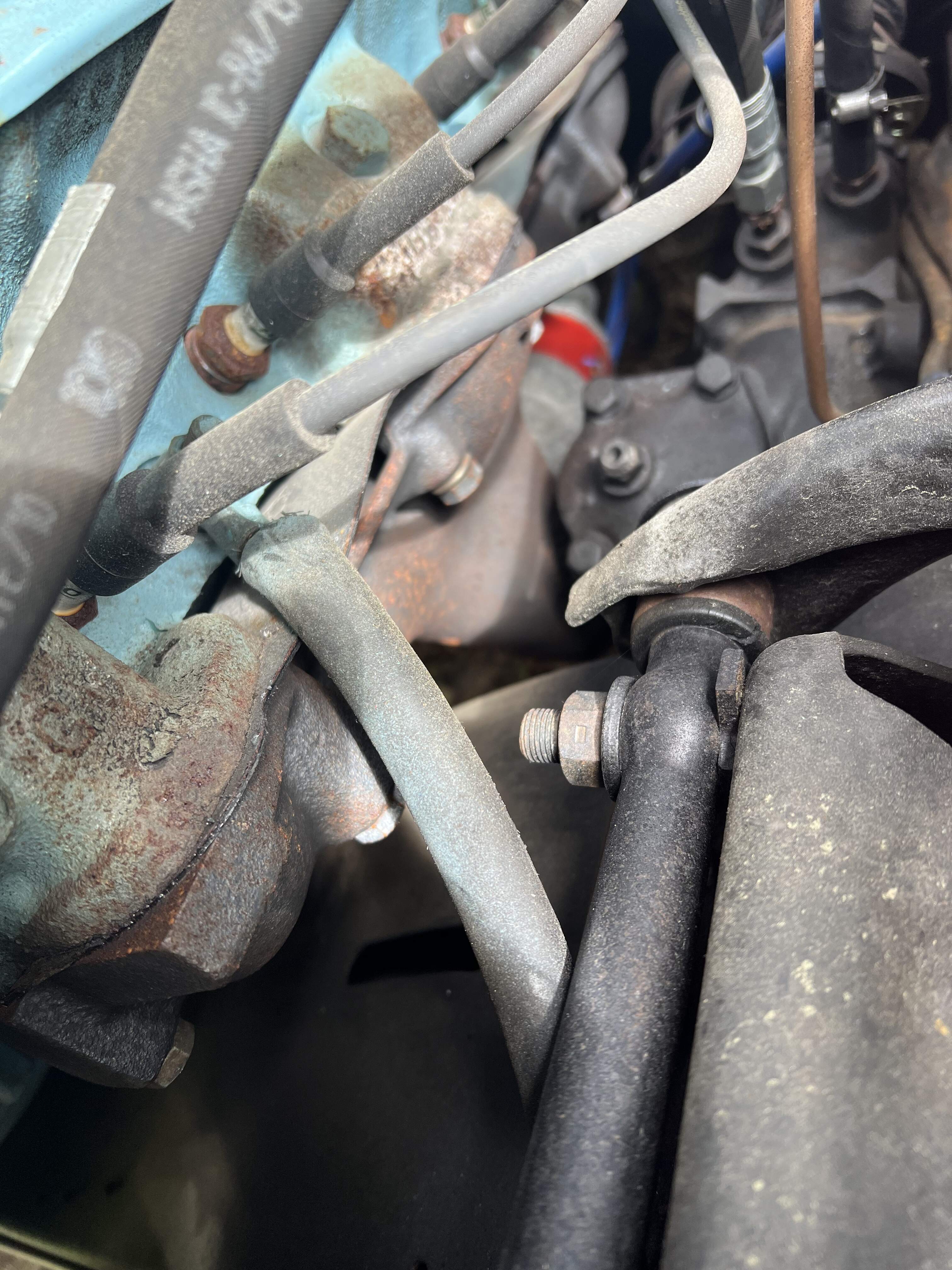

drives side i have nice clearance around both the steering box and my starter motor
Thanks it looks to be the only option in less I have some custom made so I will have to save some coin to get them once again thanks for the info and pics
