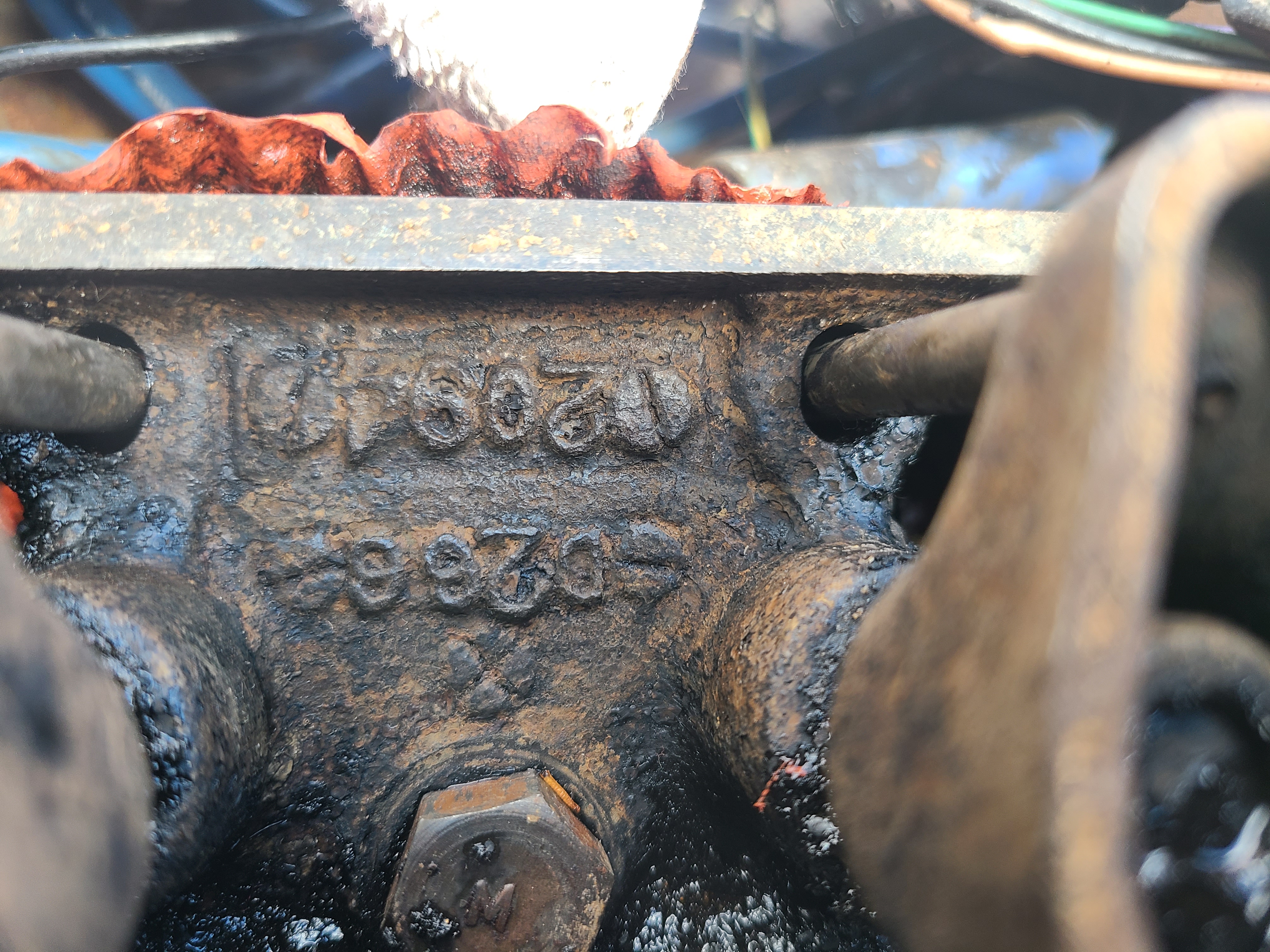

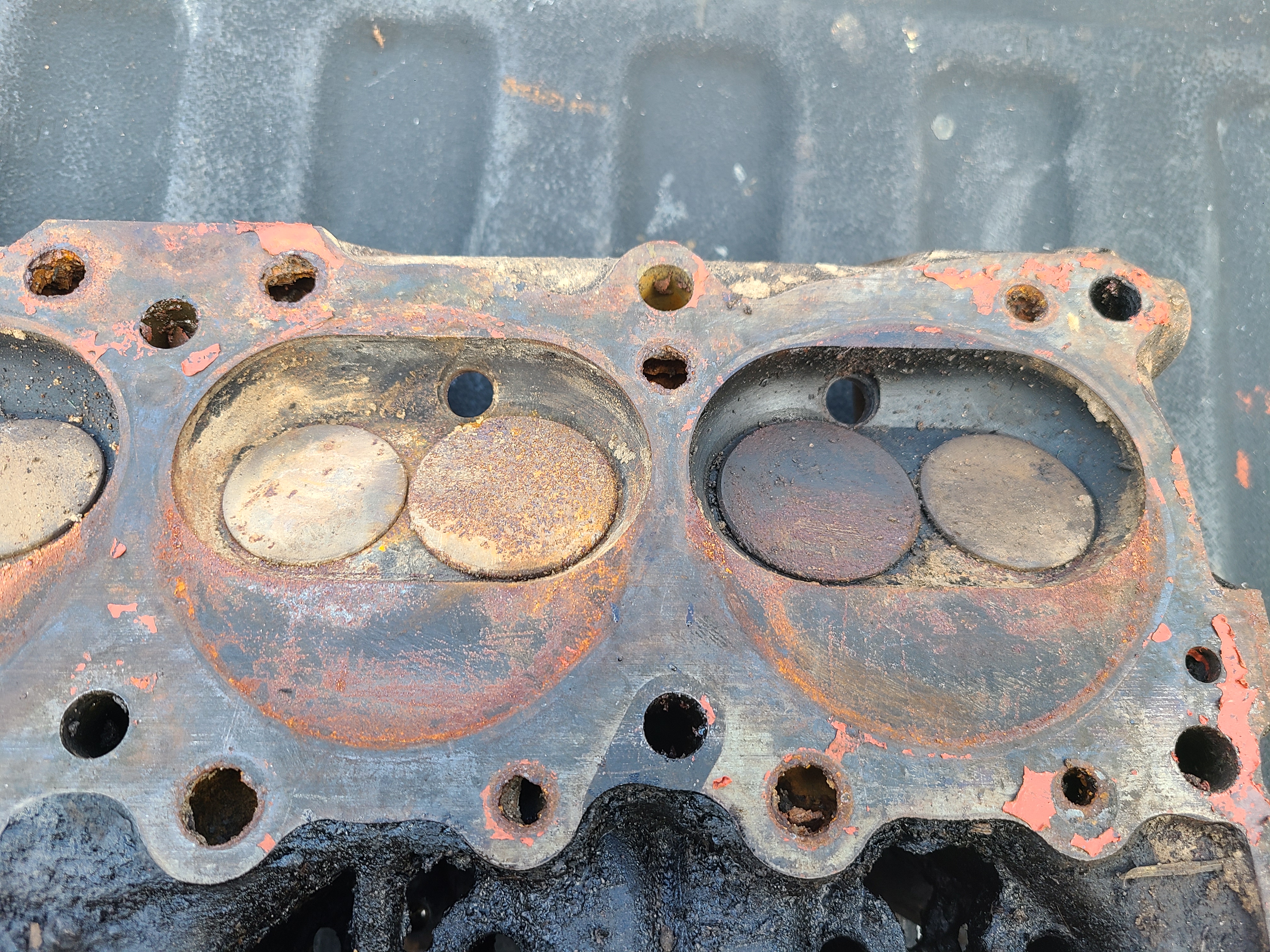

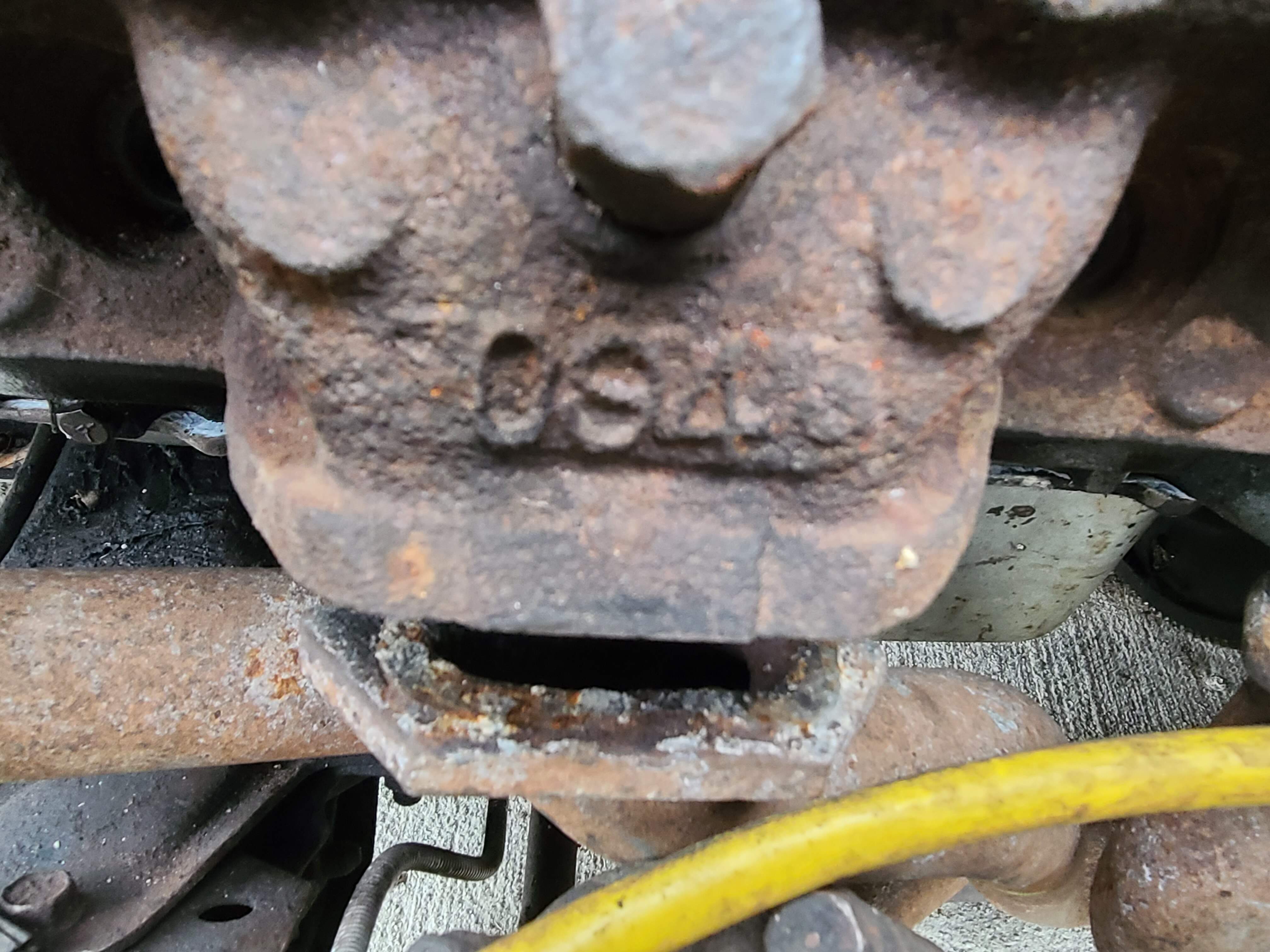

I just recently bought a 1974 ventura. Factory 350 car. I was told by the last owner the car had a bad rebuild from the owner before him. I took the top end of the engine apart to check everything. I actually found at some time in the past, someone put a 4 barrel carb on it. Also the heads are 094 1966 326 heads on a 1973 350 engine.  And the pistons are flattop pistons but they have some kind of dimple in the center of the pistons. My main question is, can these heads be a competitive set up? I do plan on drag racing the car. And I do want to use the 350 I have. But would I be better off finding the 71 350 heads? Any advice is greatly appreciated.  Use the 326 heads or change them?

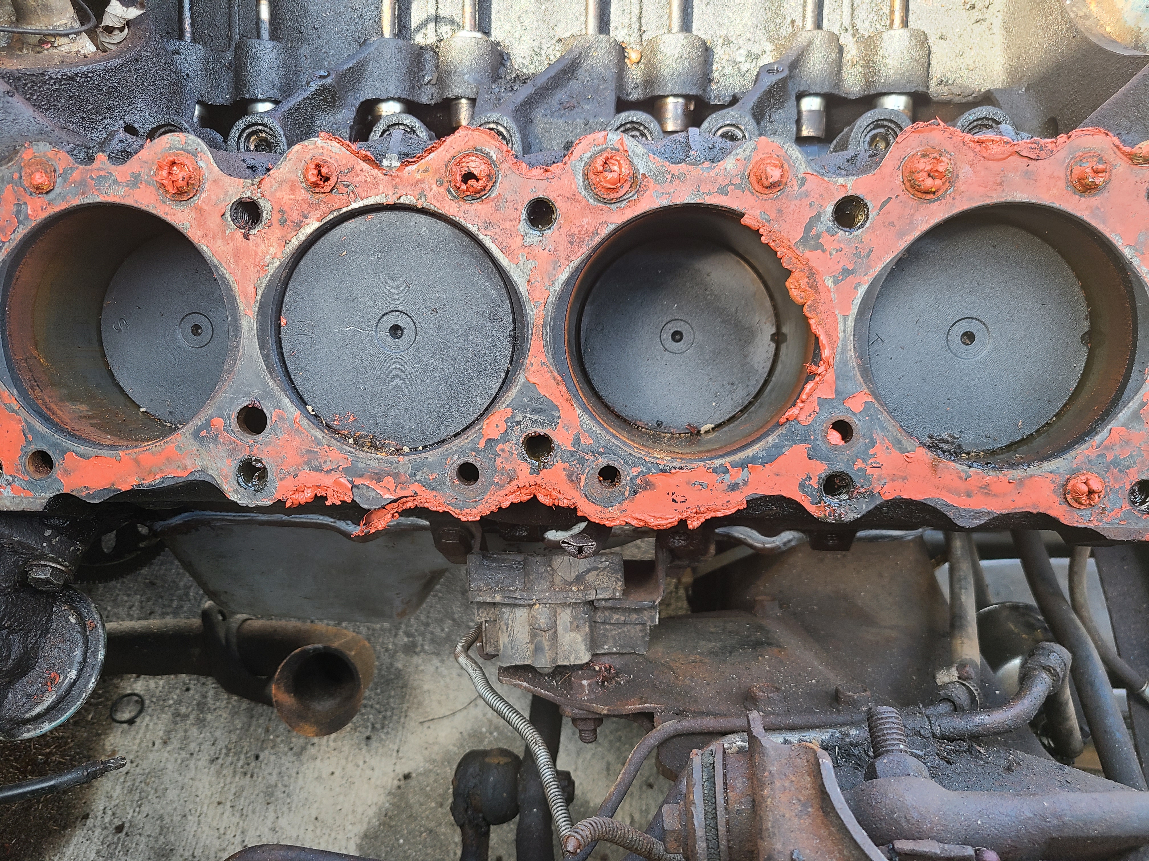

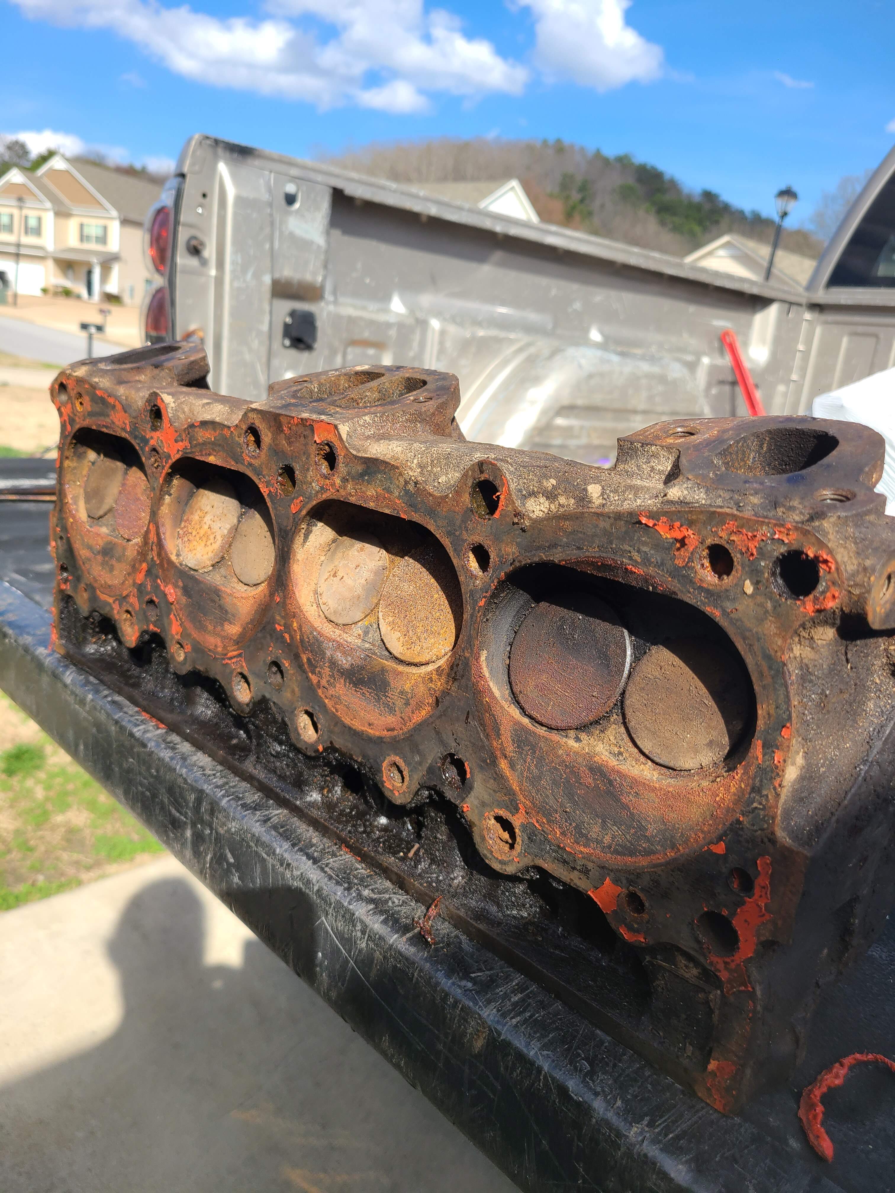

MY gawd.... NOWHERE does it say on the tube that you must use the Permatex all at one time.  :slap:  Water jacket holes, pushrod tubes completely filled.....IT's even oozed into the cylinder. If that car was running, it would have burned that off.  The pic of the head.... how do you get it to squirt out of the freeze plug? :willy_nilly:   You had better plan on pulling the block outta there.  Who knows what your gonna find in the lower end.  Your pan N pickup are probably plugged with Permatex that made it to the oil pan.  Would contact Butler for rebuilding advise for racing.

Trust me I know. When I started goin further and further my mind was blown. I am pulling the engine out to go further. I Do have video of the engine running from the 2 owners ago who actually owned the car before the kid I bought it from. He was just as confused why the guy I got it from as to what he did because the guy who found me drove the car as a daily. So all of that was done by the kid I got it from. But I am going threw it and make it what it should.  I'm still hung up on the heads set up.
Best advice,  clean up lower end and check bearing tolerance. I would replace the oil pump, pull the timing cover and replace timing chain if needed, but expect to clean up a Permatex mess there too.  Then contact Butler for a price on heads, valvetrain needed, matching camshaft.  You have a 4bbl intake.  Butler might be your best bet on headers as well.  Build it basic, but bulletproof and enjoy many years of bracket racing.  Good Luck bro.   Please keep us up with picks on your project. Including some pics of both cars you have.

Here is a list from Wallace Racing of all the 350 heads Pontiac produced. You can bolt 326-455 heads on your 350. They will work but some of the more popular 389-421-400-455 (Ram Air and HO) heads are more desirable and than means the price goes up. 350 Pontiacs have sort of become the red headed step children of the Pontiac world. So I hope that means some of these heads are cheaper (assuming you can find them since 350s tend to get scrapped / ignored).
I would try to find the #18 or #48 heads first since they are the most HP per stock head. Then I might look for a set of 5c, 6X-4, or 6S heads since they have the larger intake and exhaust valves.
You can search for any of these heads, but your dealing with 50yrs + equipment. Unless they are sold knowing they are already magnafluxed, crackfree base to work from.  You will still have to have the used heads done.  To deck, valve seals/guides, 3 angle cut and spring rates checked still has my jaw on the ground at what it cost me for the V6!!  That's why I'm suggesting he uses a Pontiac engine builder  (Butler)  You can have new heads set up anyway you want.  Hydraulic or roller and they can advise you about rockers/pushrods and cam for what he plans to do.  He can mention entry level set up (mild mods minimal cost to get you started)  with plans to up grade the go fast parts as you go along. They can recommend a valvetrain that could take a next size cam ect . Saving alot of $$ down the road.  Now you have a bulletproof setup to have fun with for years bracket racing.  He can learn alot justa talkin to the reps about different parts.
