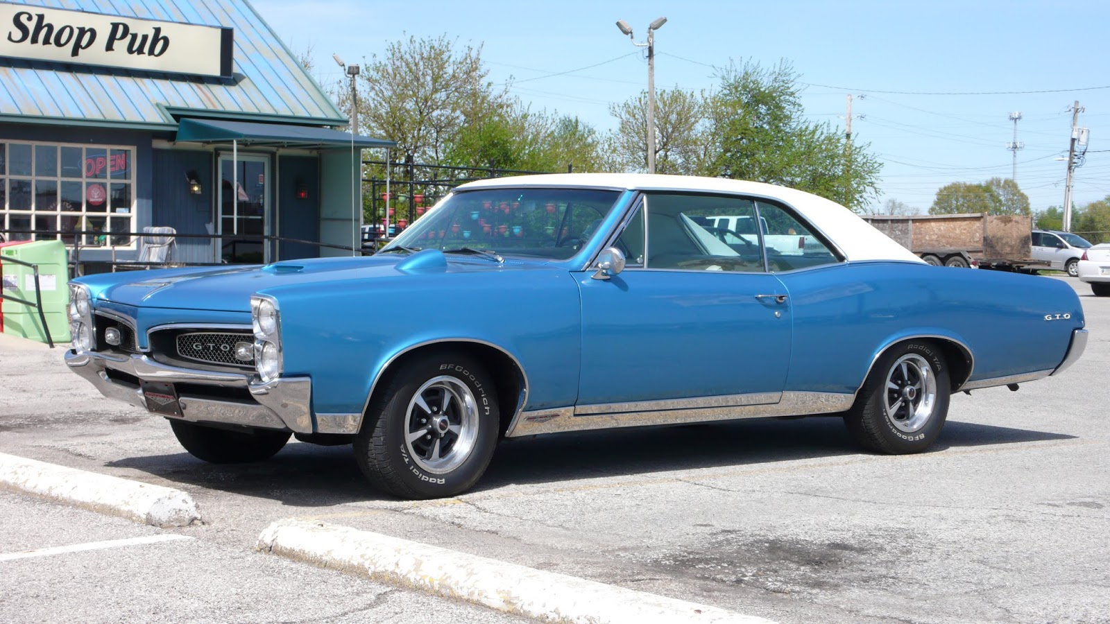

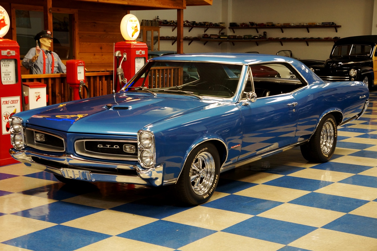

Can anyone tell me besides the grill color, what distinguishes or what are differences in 66 and 67 goats?
Solved by viper691989
Chrome rocker trim from the side view.  66/back is under the door, 67 trim is wider and is on the door bottom.  Tail lights  66 has 3 long slots, 67 has 4 rectangles.

67 was the 1st year to offer the hood tach as well.  Interior wise, 67 also offered the His/Hers HURST console shifter. With Walnut trim, 66 had a lighter wood trim.   Stiching in the seats makes them year unique as well.
