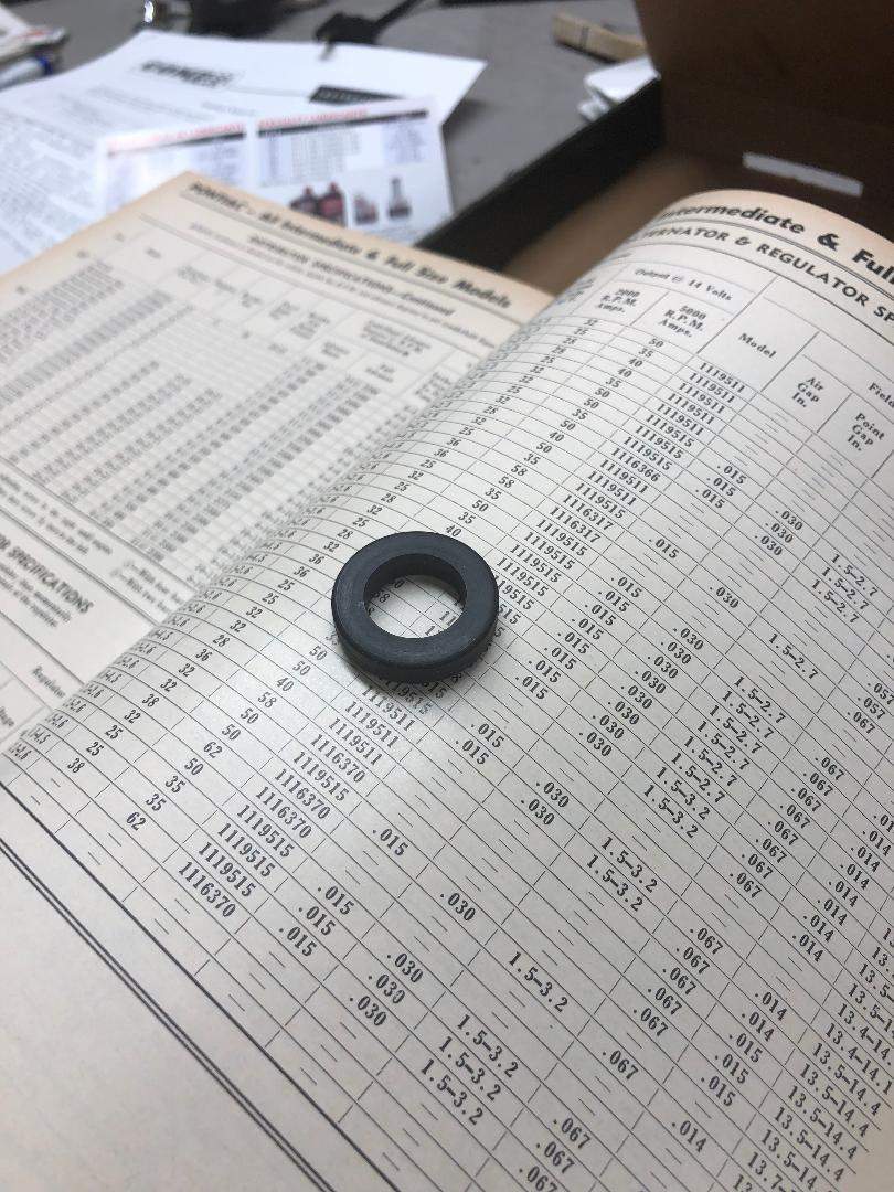

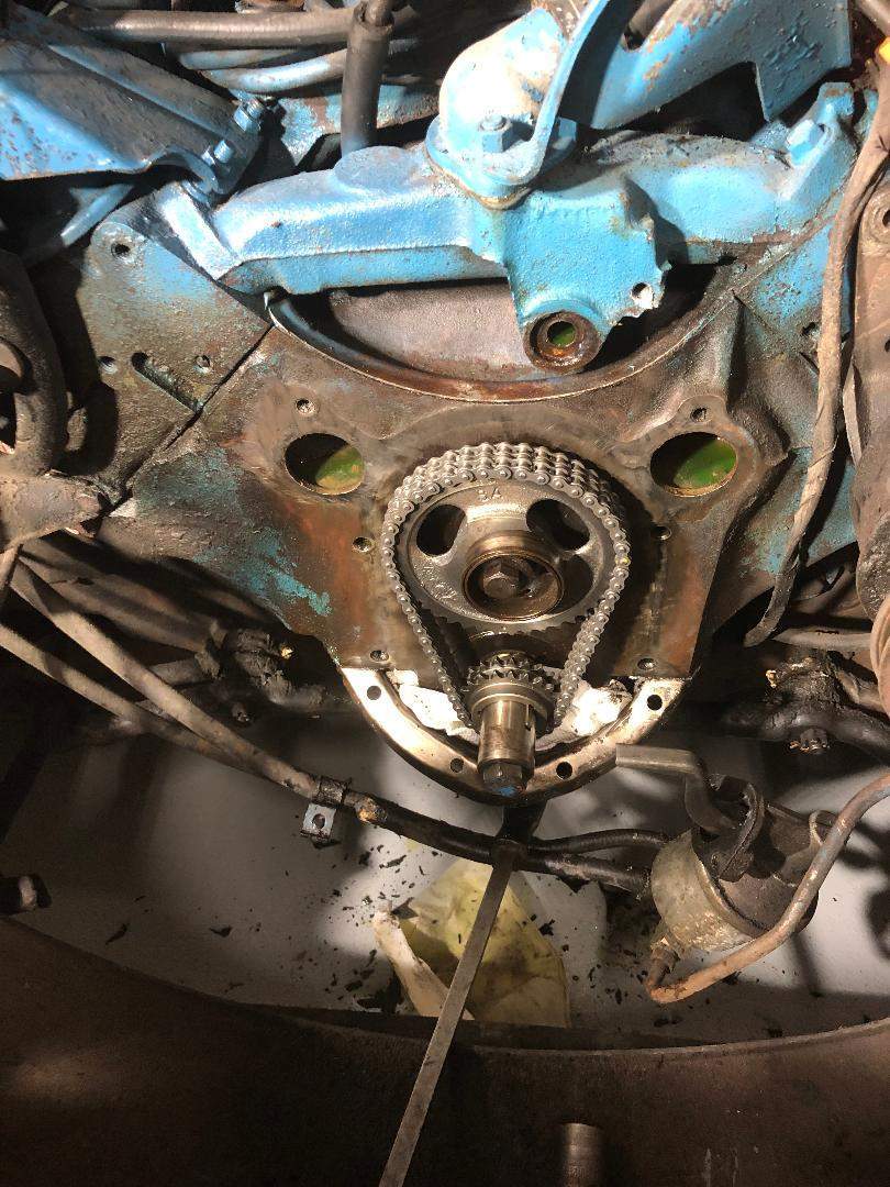

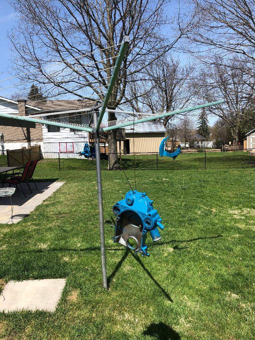

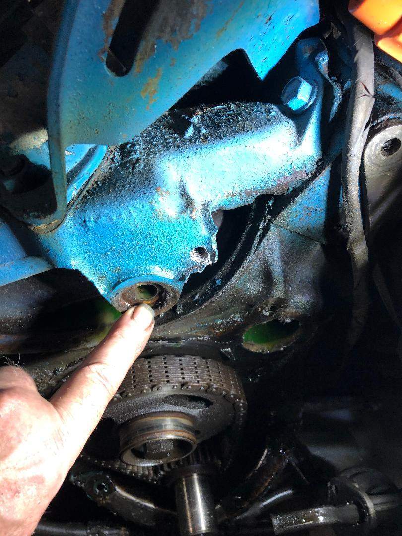

On my first drive in Grandville it sprung a leak!! Previous owner had put new water pump on before I bought it BUT that wasn't the problem. leaking at intake to t/cover by-pass!!  After stripping it down, no grommet in by-pass just a "load of silicone" timing chain was a little "sloppy so new gears & chain while I'm in there! Hung my
Pontiac laundry" out to dry on Saturday, & have new parts installed [ Comp Cam double roller] and all surfaces cleaned up and ready to put cover back on "with new grommet" Wasn't expecting to do a tear down but $hit happens !!!!!!

Nice work dualquad👍👍
Pete - Great work bud!

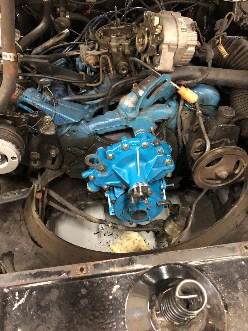

On the way back together!!!  Just a little each day as "back" not holding out and daily headaches don't help either!!!
It's Alive!!!!  Fired it up yesterday, so far no leaks !!!  Still ran rough on idle and acceleration, checked ignition  components, all seemed OK then the 2 watt light bulb came on, S/plugs were "white" when out last week, so thinking previous owner ran regular even though I had put some premium in, dumped a full can of Sea-Foam into 1/4 tank of fuel, another test run "pounding the PI%
$$" out of it, Backfires galore for awhile then smoothed right out. It even "PEELED" out at stoplight, so I think my "didling" with cam timing "perked" it up some?? 4600Lb tank that will lay rubber!!!  Took Sharon for her 1st.  ride when she arrived from Toronto and she was impressed how smooth it ran and rode. After all that work that I wasn't expecting to do, I'm now pleased with outcome, on to getting A/C working next week as my parts came from Texas, started out at $ 158 US and ended up over $300 Cdn. by time exchange, shipping to border, then broker fees, Cdn. Tax then more shipping fees from border to here !!!!!!
