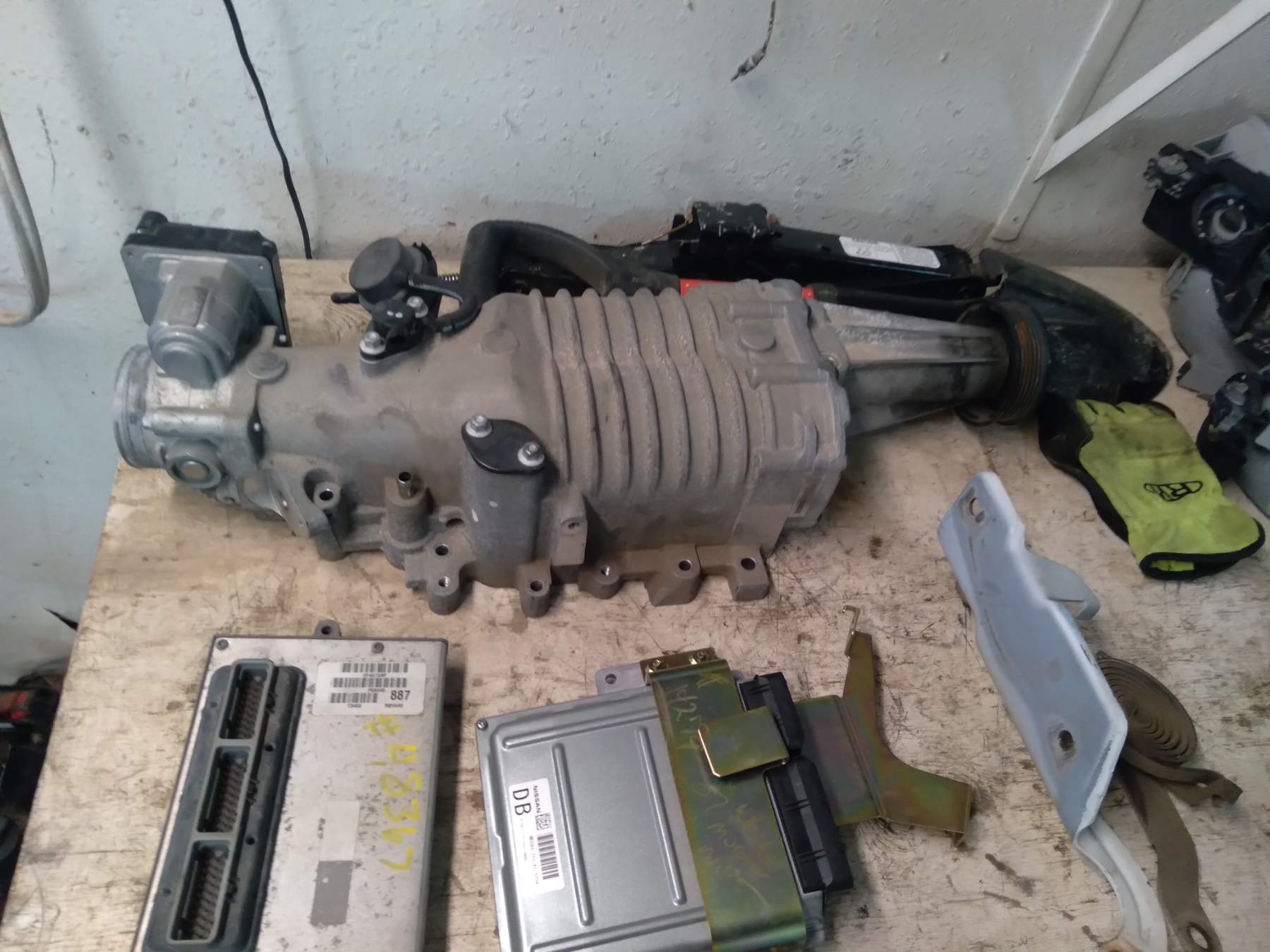

Hey has anyone supercharged a 3.4 engine? I want to do a project by doing something new that no one else did. I have a 2002 Pontiac Montana, it has the 3.4 and I wanted to Supercharge it. Would it be possible if I got the ecm and exchanged them. I have a rebuilt supercharger from a junkyard, rebuilt. I wanted to know what else I would need for it to work. If anyone has done this before let me know what you used. I have the intake manifold and fuel rails for it along with the ecm & a couple of other things.

It came off of a 3.8, 2002 Pontiac Grand Prix GTP, exactly the same engine as my Pontiac Montana if it wasn't supercharged. I have room for the Supercharger, but I have a custom aftermarket cowl induction hood for it.

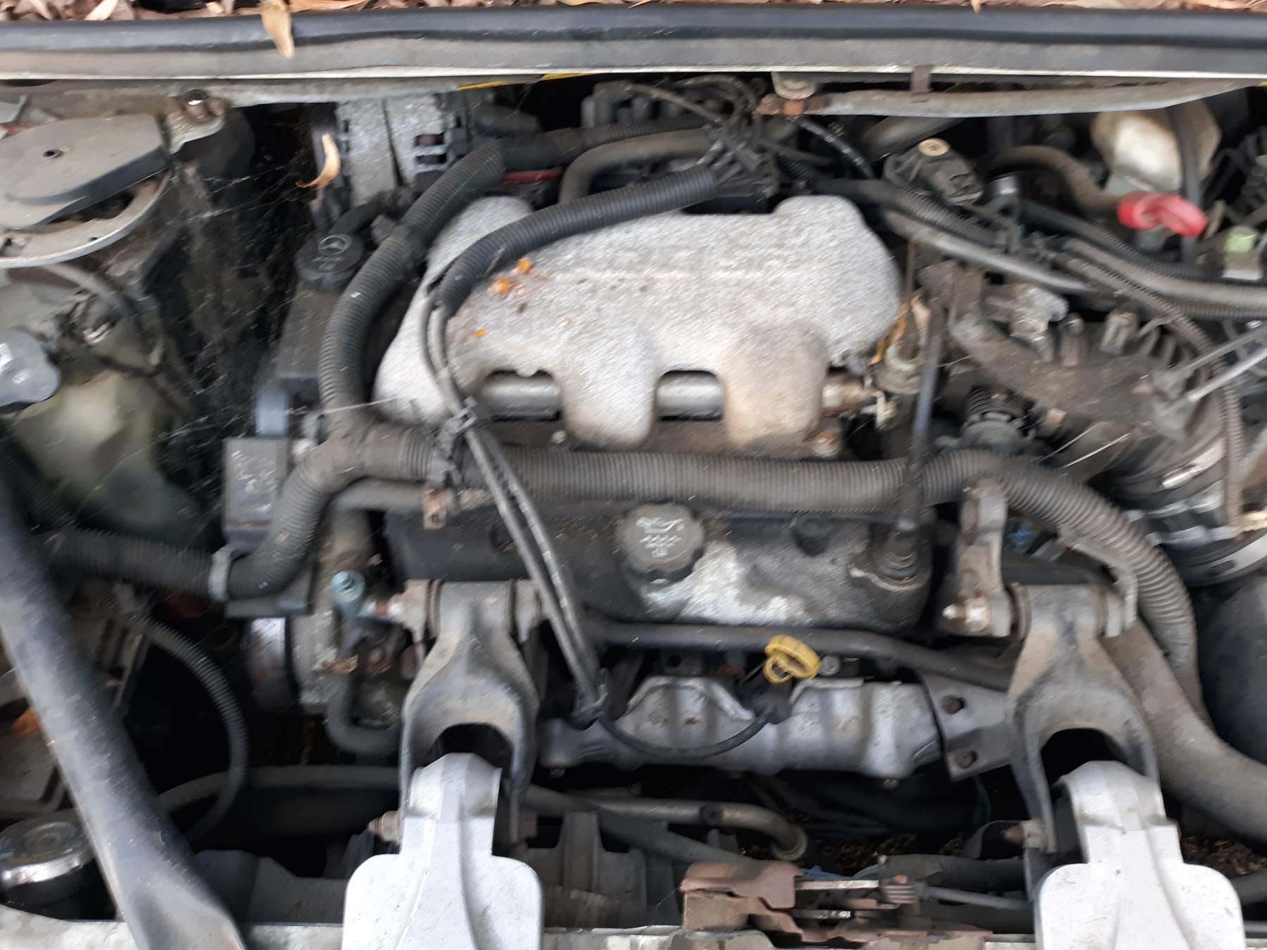

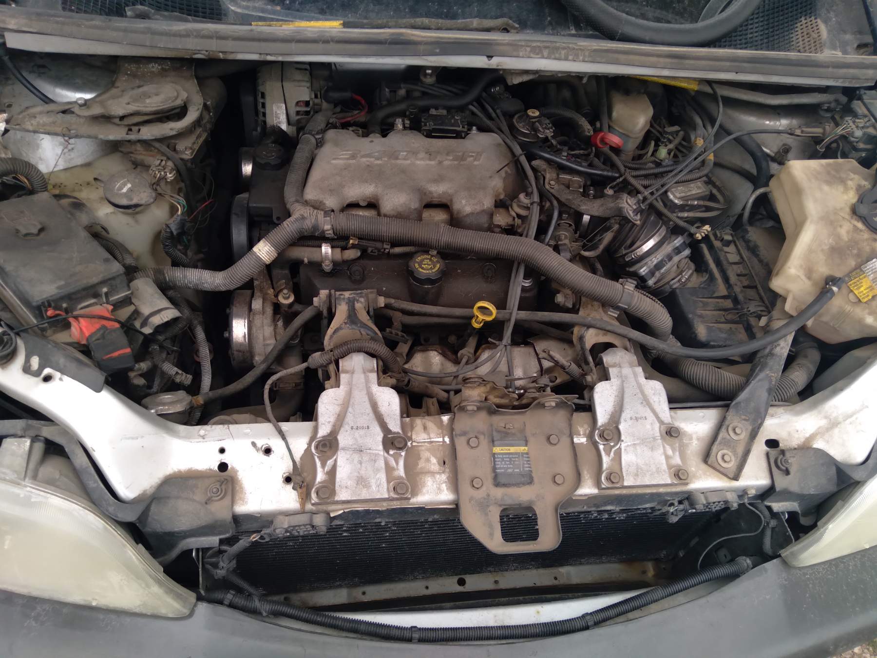

It's in storage, but I have pictures when I first got it to give you an idea of how the engine compartment looks. The engine is cleaner and has rebuilt. These photos are old.

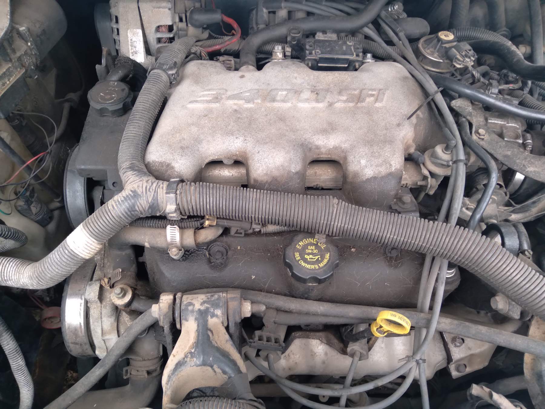

The 2002 3.8 Supercharged Buick engine used in the Grand Prix... Is a completely different From the 3.4/3400 V6 engine used in the Montana...And Don't really share any common parts..So the short answer is No..The 3.8 Super Charger will Not work with the 3.4..
3.4/3400 montana engine

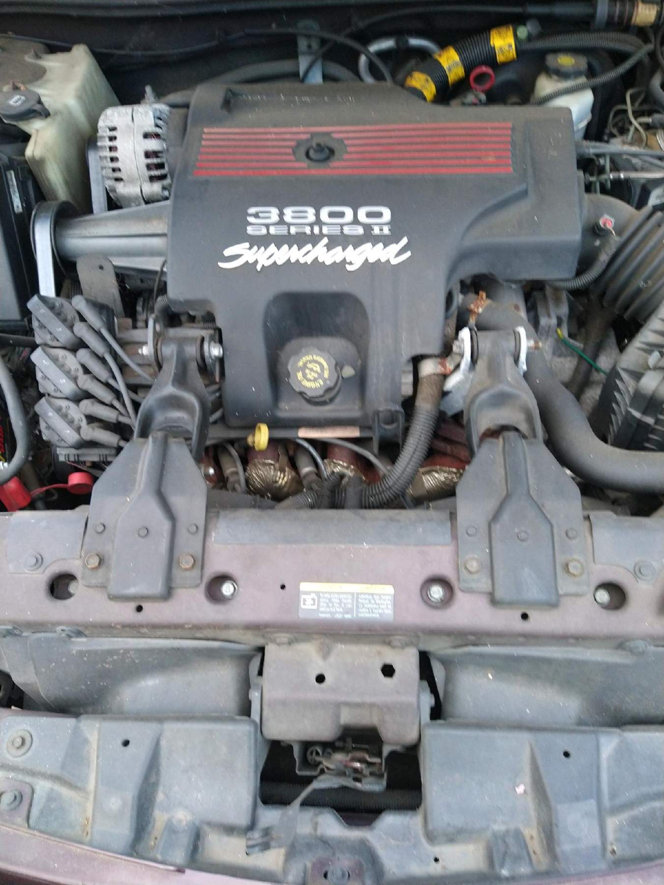

2002 40th Anniversary Grand Prix GTP...The Supercharged 3.8/231 Also uses different cylinder heads..Than the naturally  aspirated version  of the same engine.. Among several other things...IMG_20211204_163420658.thumb.jpg.edba60b1a30be5a719429dbaddec9ba6.jpg
