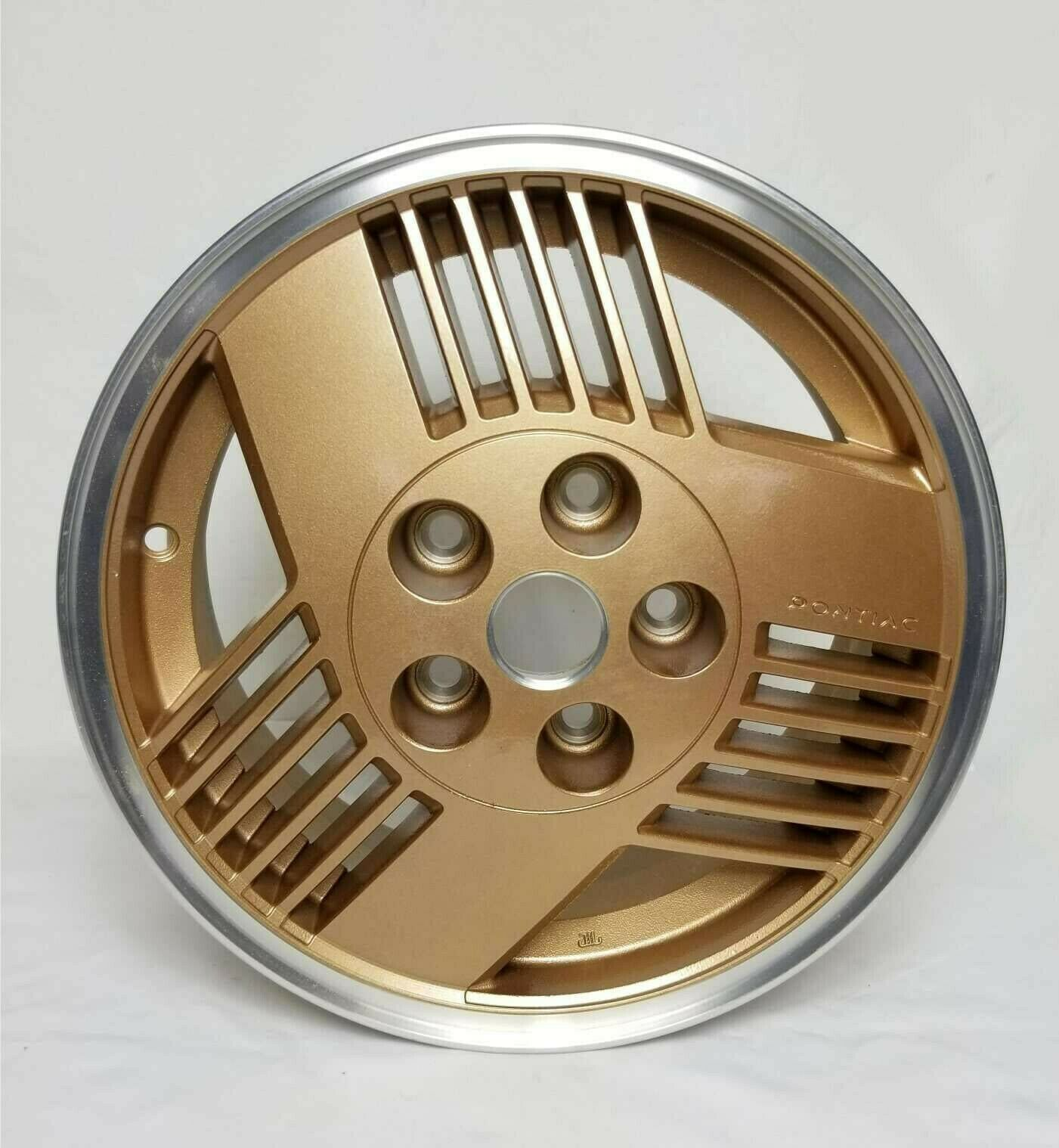

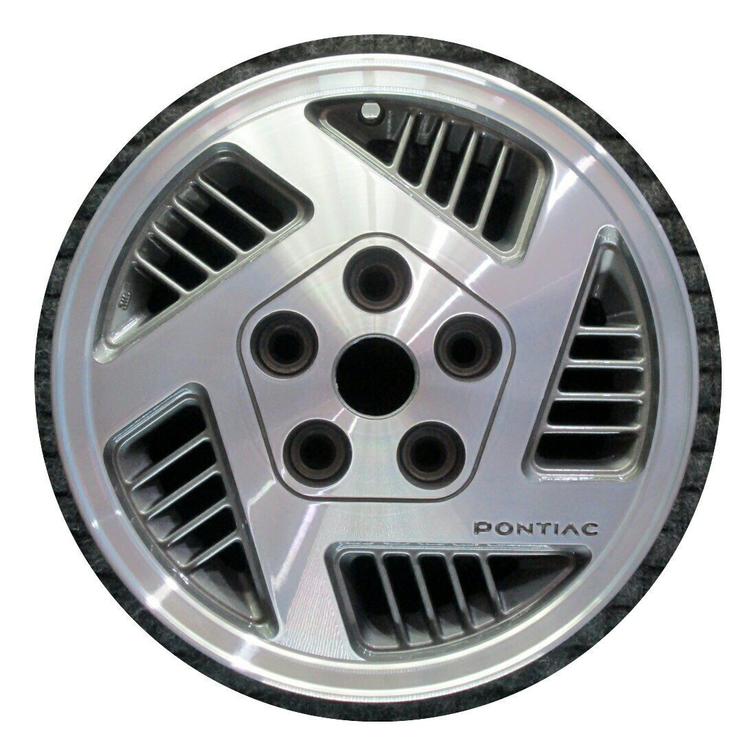

There are some photos of the stock rims that were available on the Pontiac 6000 back in the day. These photos are from eBay.
Now that you know you have a 5 x 115mm pattern, you can go to the aftermarket and select any wheel that you like that fits your bolt patterm
