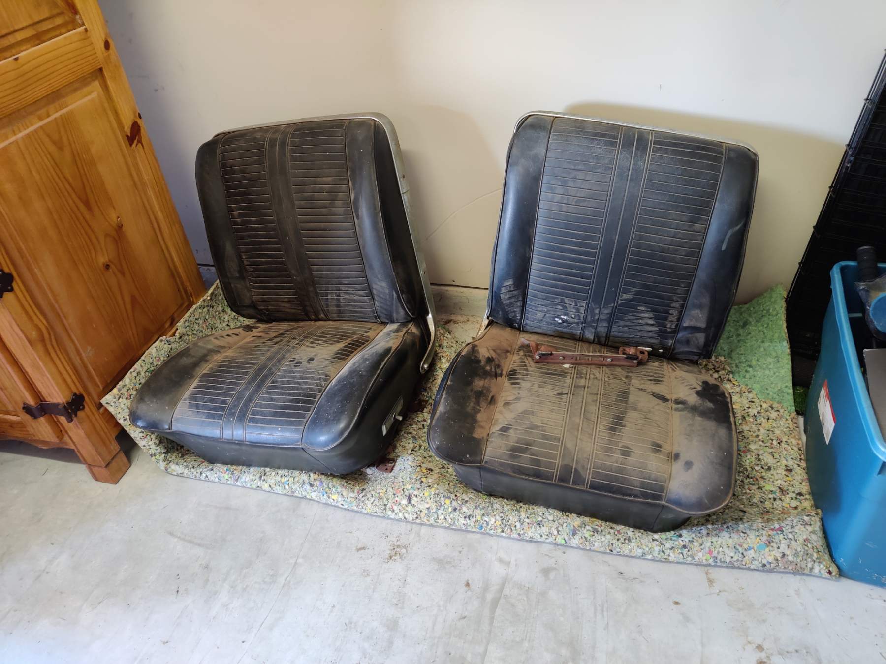

But I do have a question. Lucky (62 Bonneville) currently has a bench seat, managed to find a pair 63 Grand Prix buckets for a good price, so took a leap. So question is will they fit, they look the same but as the Bonneville buckets I have found pictures of but with bigger trans tunnel am I going to struggle?

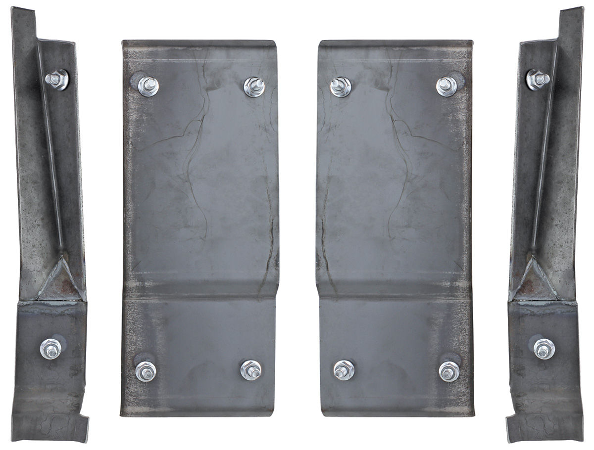

OPGI has the brackets that you need to convert from a bench seat to bucket seats. For $100, these fit 61-64 Catalina, Bonneville and Grand Prix. So to answer your question, they will fit with these bench-to-bucket conversion brackets.
https://www.opgi.com/interior-accessories/seat-accessories/bucket-seat-conversion-brackets/brackets-61-64-bonn-cat-gp-bucket-seat-mounting-gbc1830.html

Electric seats as well.  Have you tried to move them?  They look in really good shape.  Great find!  Thankz for the pic's of OL Lucky
Driver's is power, no not yet, found a local upholstery guy, who is gonna strip them down paint the frame and recover them and the rear bench. Then I will tackle the motor and see if it works. Yeah I was really pleased I found them.
Guy is going to sell me the matching material so I can try my hand at the door cards and a custom centre console.
