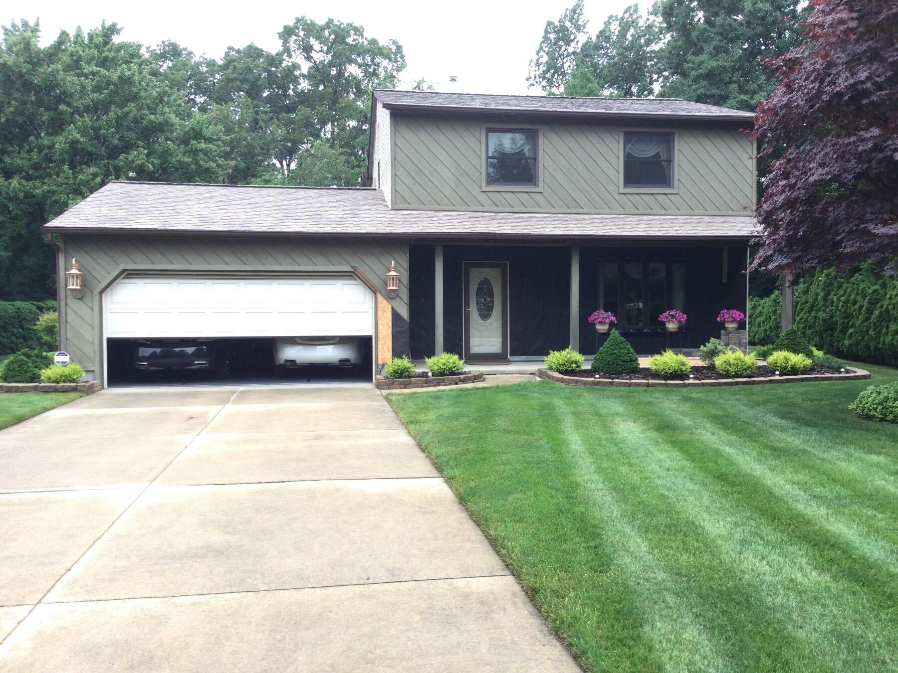

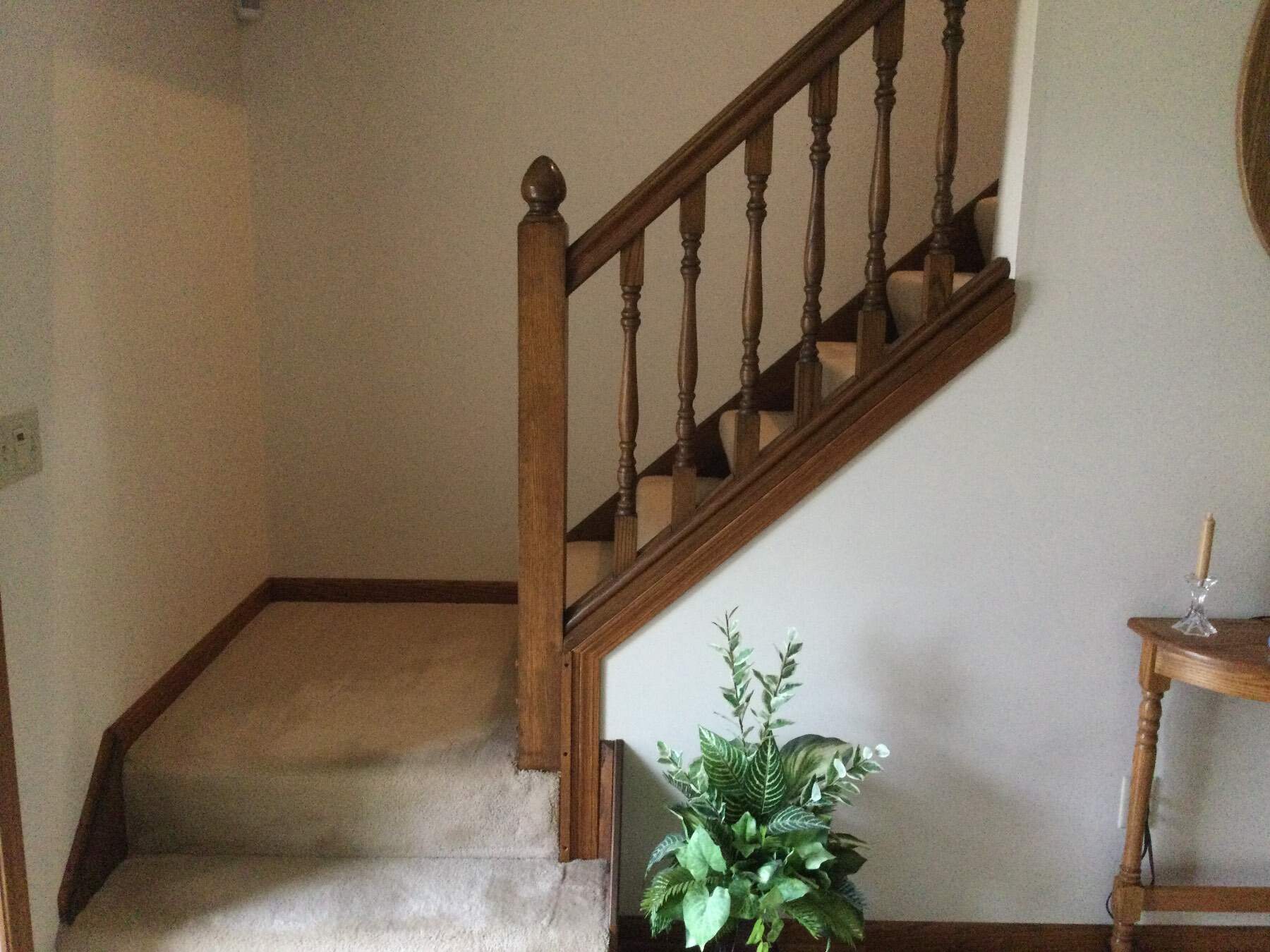

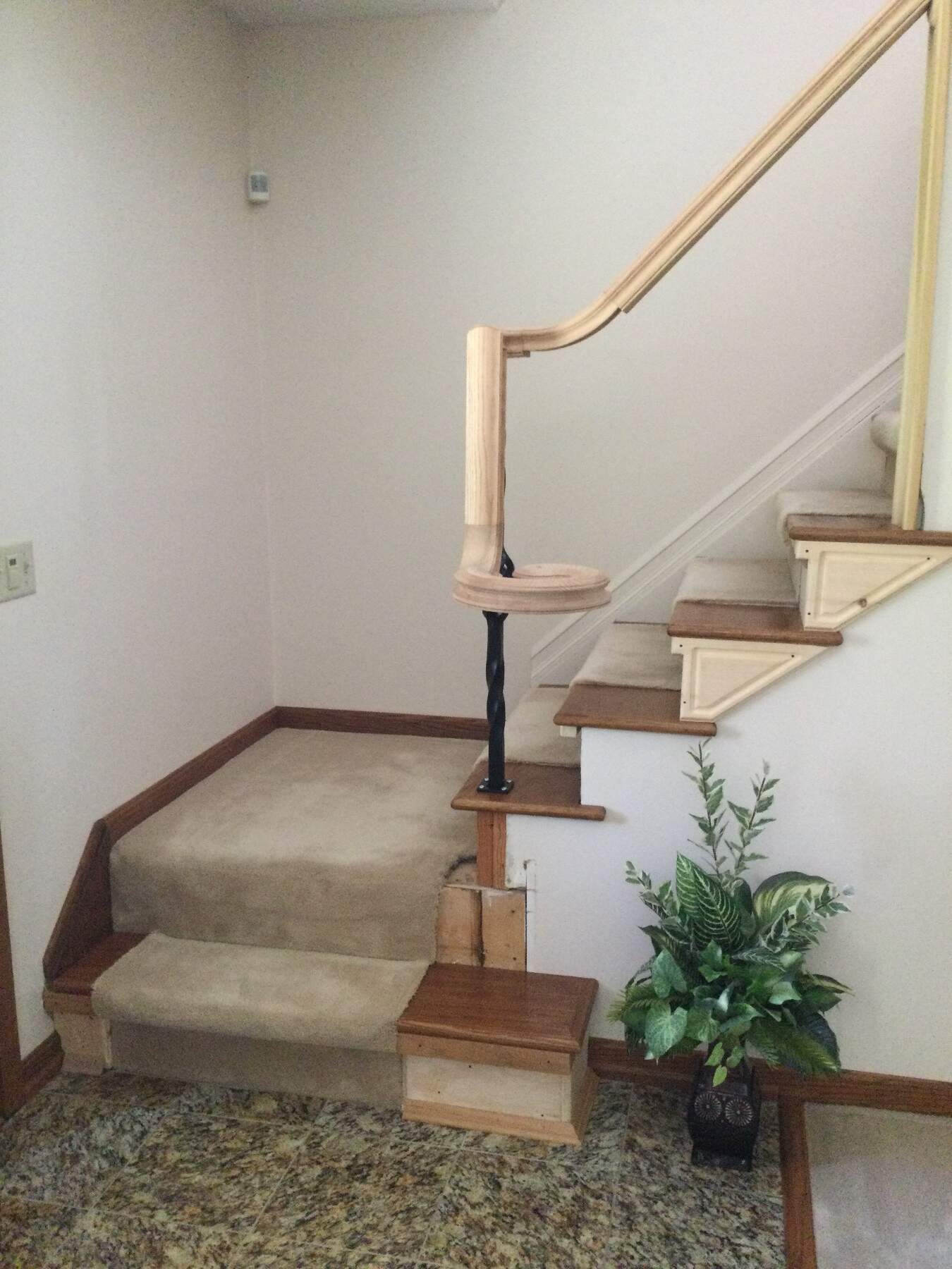

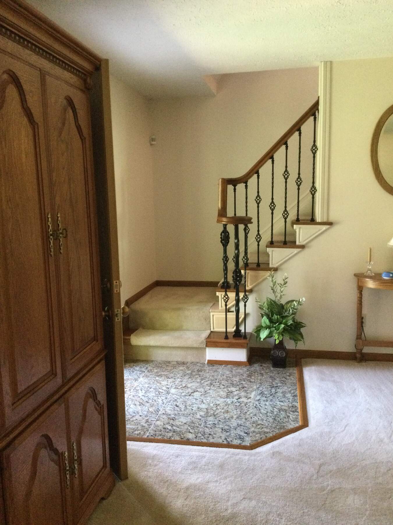

Who would have thought that remodeling a staircase could be so much work? Add in remodeling the outside of the house and maintenance of over 300 trees, shrubs & bushes would fill one old mans retirement time.
Had to hand make about 50% of all the star parts plus remove the knee wall and rebuild a different one.

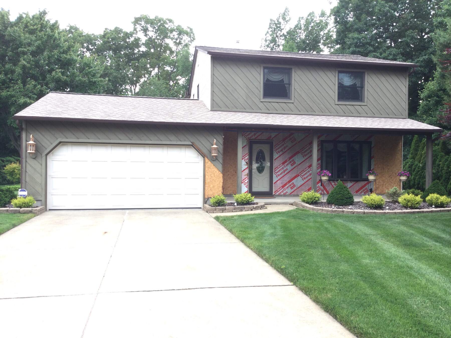

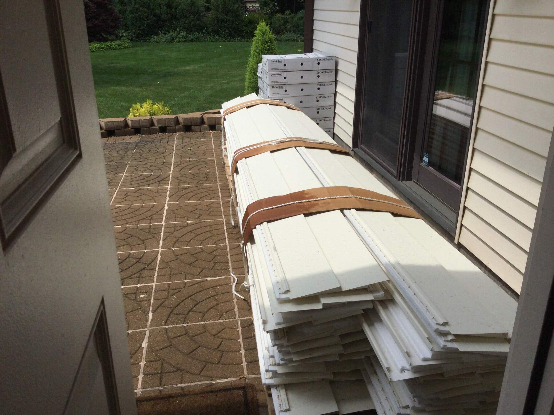

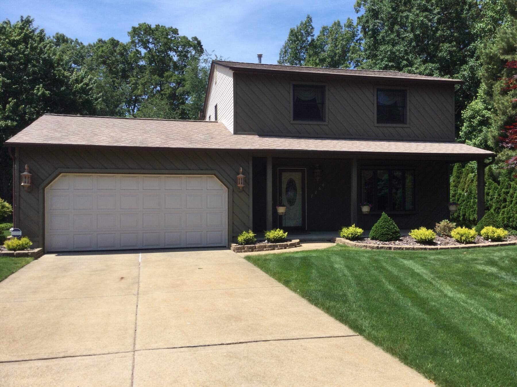

finally got my outside materials! What a pain that was! Ever peel cedar siding of a house? You have to remove every nail! I knew that, but there must have been a sale on nails the week they put mine on!
That staircase is awesome! Great work 👍
Dont even want to know the work involved either siding. Glad we have stucco here in FL. Ugly but last forever and just need to paint it.
That stair case is amazing! Awesome job
Nice work Last Indian 👍 clearly some very detailed work in the stair case, it looks much better mate:cheers:
And the cladding job, well what do you say? .... at least you only have to do it once!!! :).... having said that, it gives you peace of mind that when you put it back together that you have made it better and more water tight than it was!!

last indian, i see your pulling the cedar off that's mounted diagonally , it must have been a pain in the arse to water proof it around the windows!
what are you reinstalling ?
Well the cedar was ship plank. Ship plank has a undercut lip that the one above overlaps so it worked ok, but at the end of the day the crew the built it were real incompetent! I went to the house nearly every day & did most of the interior work, but I missed the transition of shell to siding because I was traveling during that time! Now I find in taking all this front siding off that they didn’t even use tar paper! Idiots!

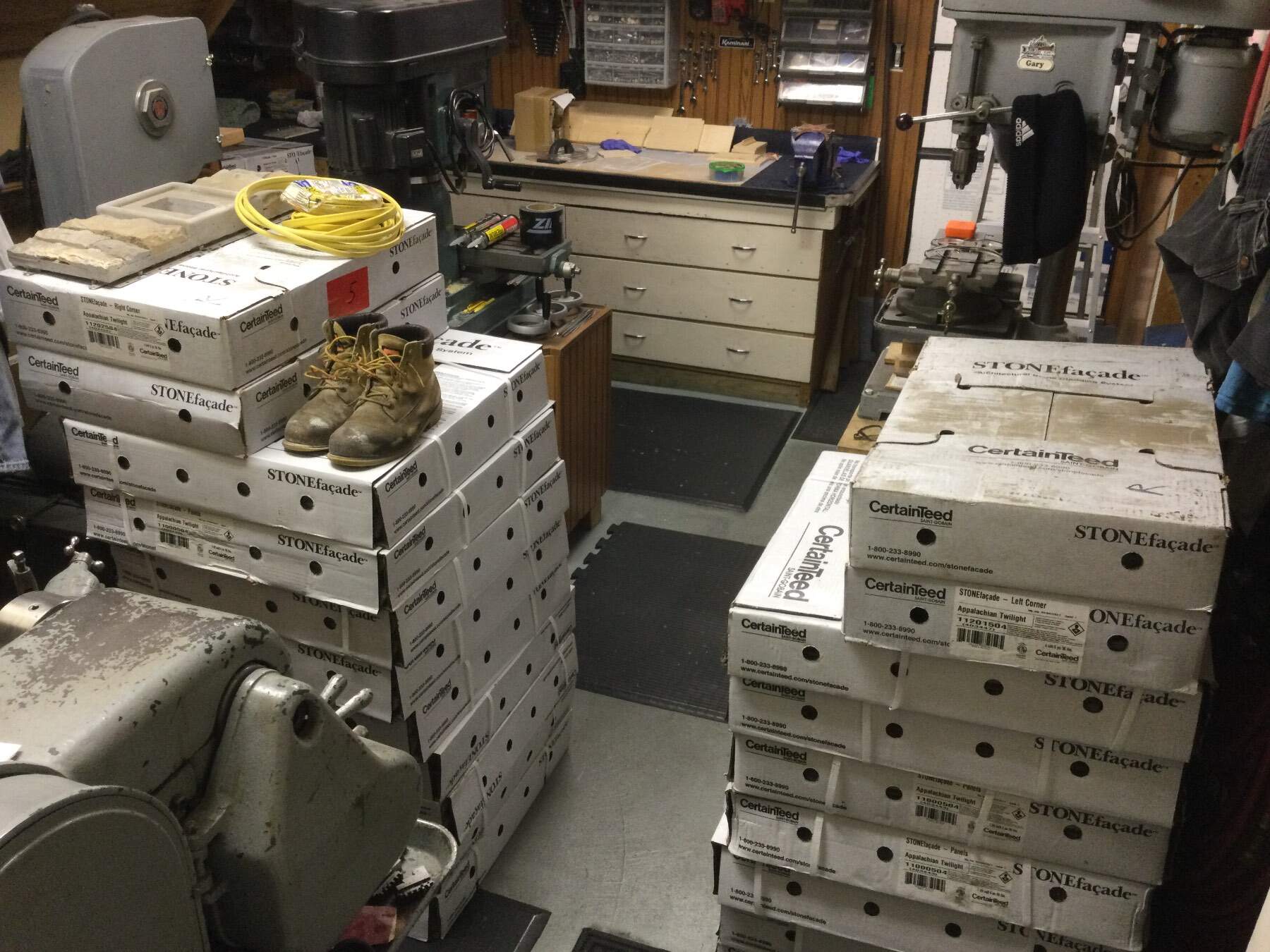

I’m using Stone Facade by Certainteed on the bottom, but just 32” high than transitioning to dimensional vinyl cedar board. Than in the back there is a fireplace chimney with cedar that will get stripped as well and finished in the stone facade!

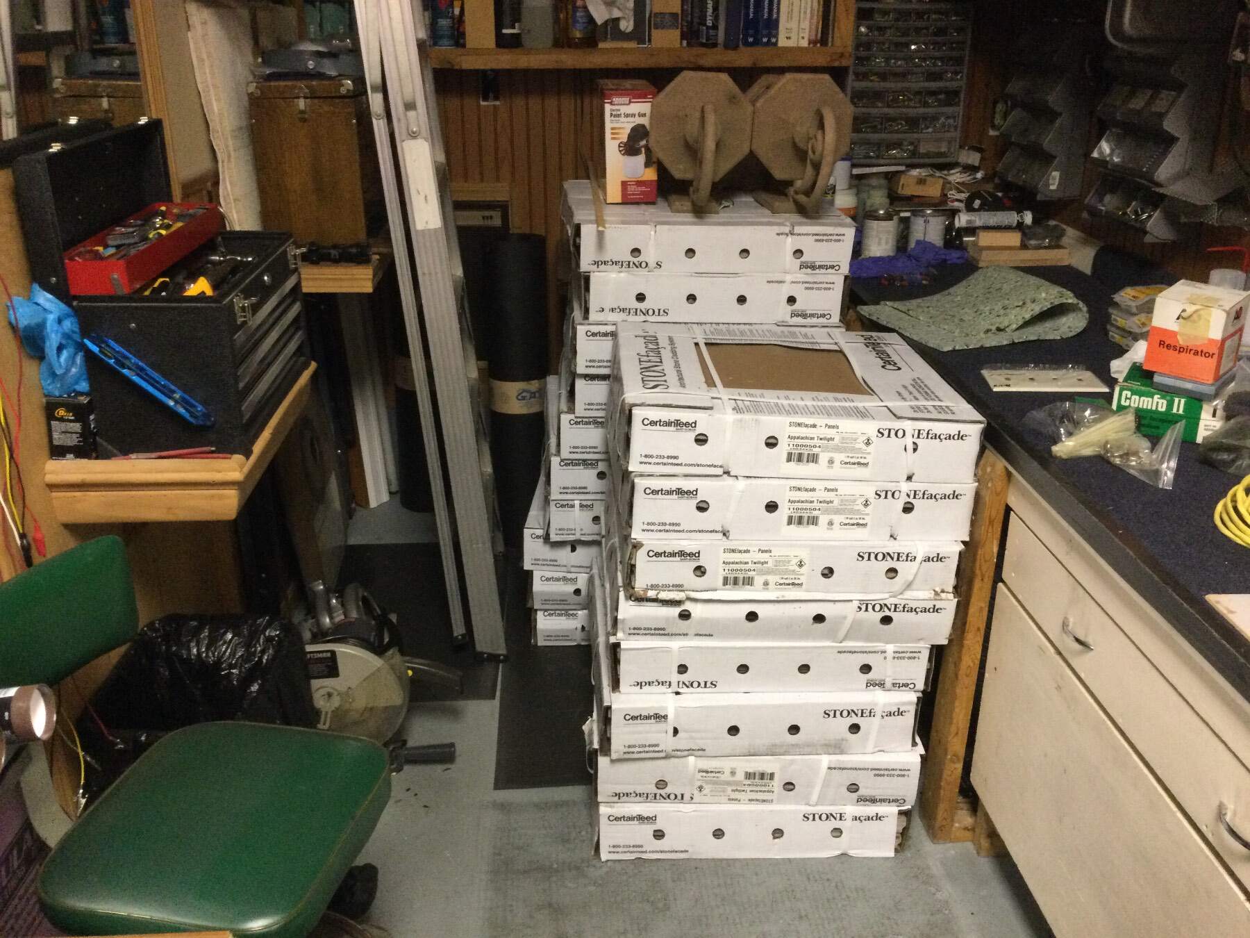

My shop is a mess!
and that’s not all of it!
Edited by Last Indian
No happy, happy, joy, joy projects for Last Indian for awhile. He has to work his butt of this summer just to get his shop back..

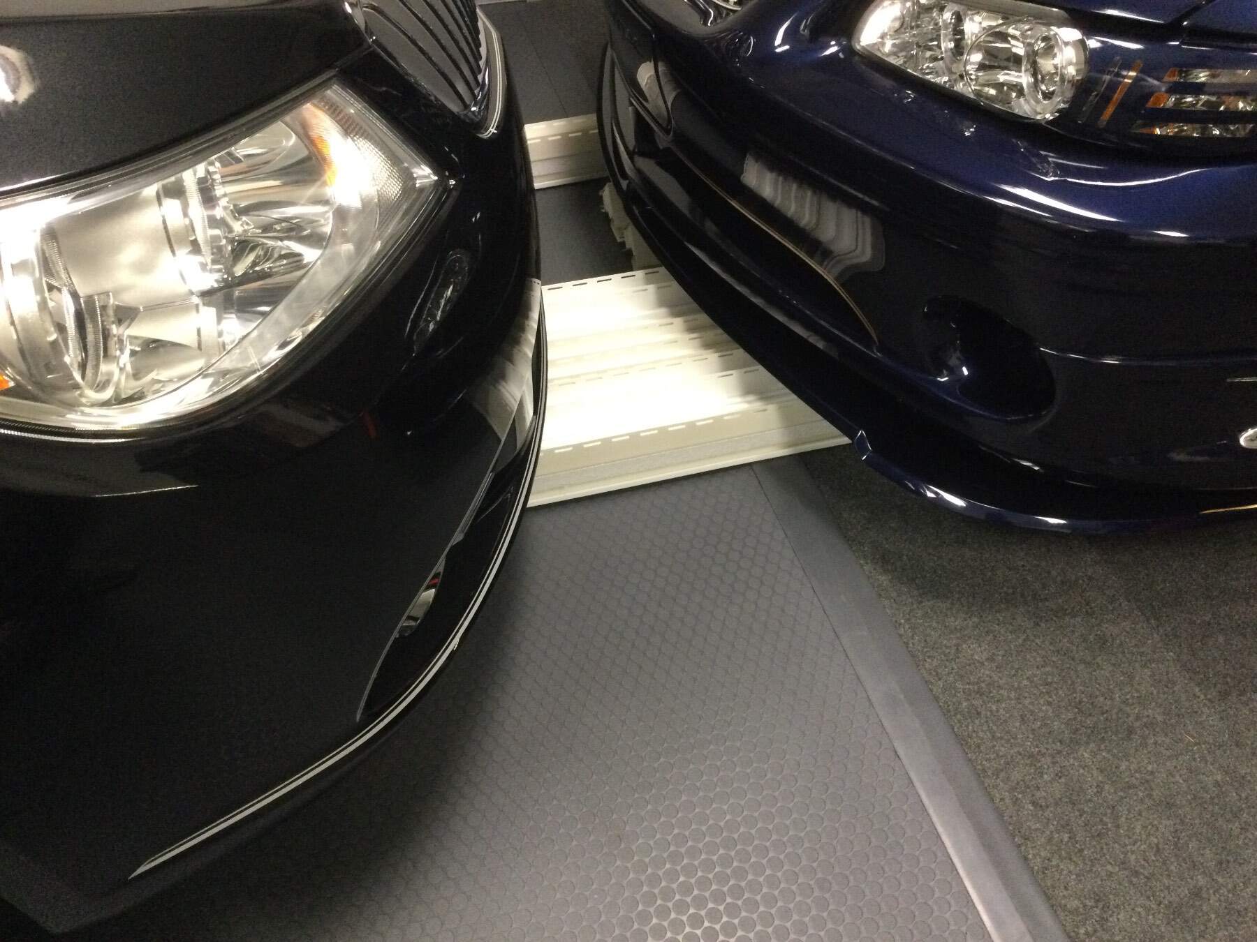

wow!!! there is  a name i have not heard for a very long time !!! certainteed !!
i worked with a building company back in the late 80's that was the local agent for certainteed! then it justA disappeared for some reason, i think back then they made cladding and sash windows ...
i recall there being a trick with the fixing... breather paper on the walls, then 20mm vertical battens and fix the certainteed to that, but not nailing right home, so that the planks could expand back and forth i think it was... oh and nail in center of the slot .... dont quote me on this as it was over 30 years ago !! :rofl:
good trick tucking the long lengths under the cars!!! i have had to do that myself  👍
Back then i was employed as the building companies plumber and when plumbing was quiet they would send me out with the builders doing cladding and roof installations 🙄

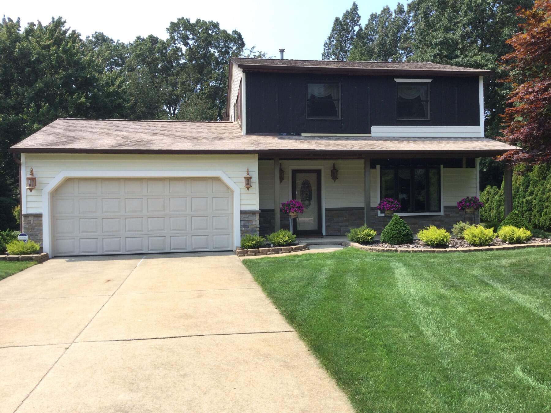

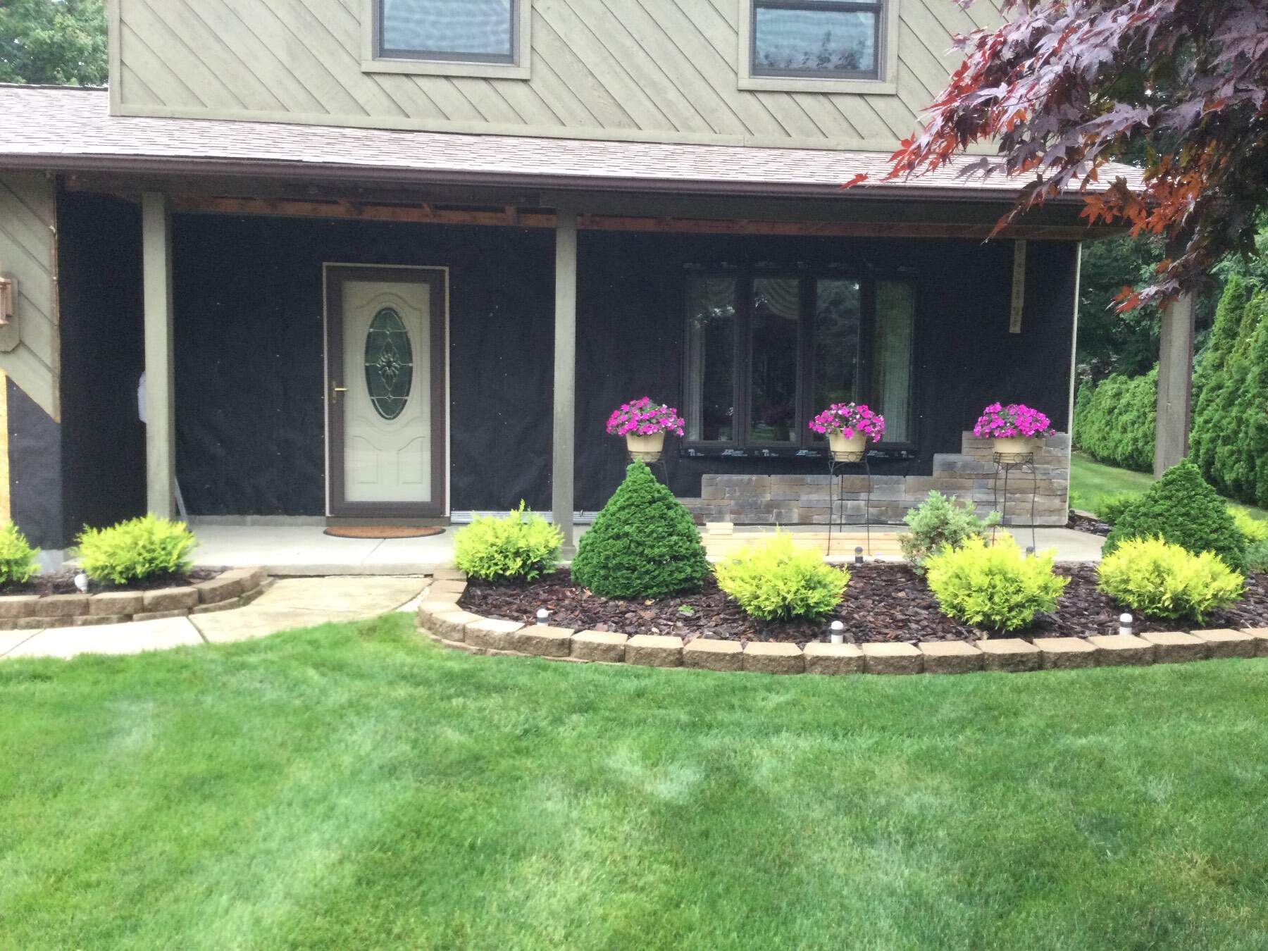

Well it to raise my head for 5 minutes! Thought I’ld let you know I didn’t fall of the roof yet, although I haven’t made it that far yet!😫
It’s unbelievable to me that anyone could e so incompetent at a job! Yet I should know better! What a mess! I spent two weeks fixing our bow window that they really never installed right! It would have been easier to have pulled it out and started over, but when all you have is me myself and I and you don’t want a 5x7 hole for a couple days in the front of your house; you do things that take a lot longer! Had to replace all of the foam board with plywood! Than tar paper, which they never used. When I got to the front of the garage! Surprise these morons not only didn’t use tar paper they never heard of flashing! I can’t wait to get to the second story! Oh happy days!
I didn’t think it would be possible to drive the Indian less than last year! Guess what?; it is! 50 miles so far!
Lotta work, but lookin good Ol Buddy.
Great work last Indian ! I like the stone work 👍👍👍
i know what you mean about flashings !!
there  is nothing worse than a half pie job, and finding one some didn’t do there job correctly !
Now I think you should be taking a break. And give the Indian some attention 😀
last indian... when you do get too the second level, i certainly recommend some good scaffolding, either hired or buy it , but with the amount of times  you will need to go up and down, you really need to make it easy.
 the days of using ladders is well and truly gone!
proper scaffolding with a walk way, ladder and guard rails make life soooo much easier and safer!

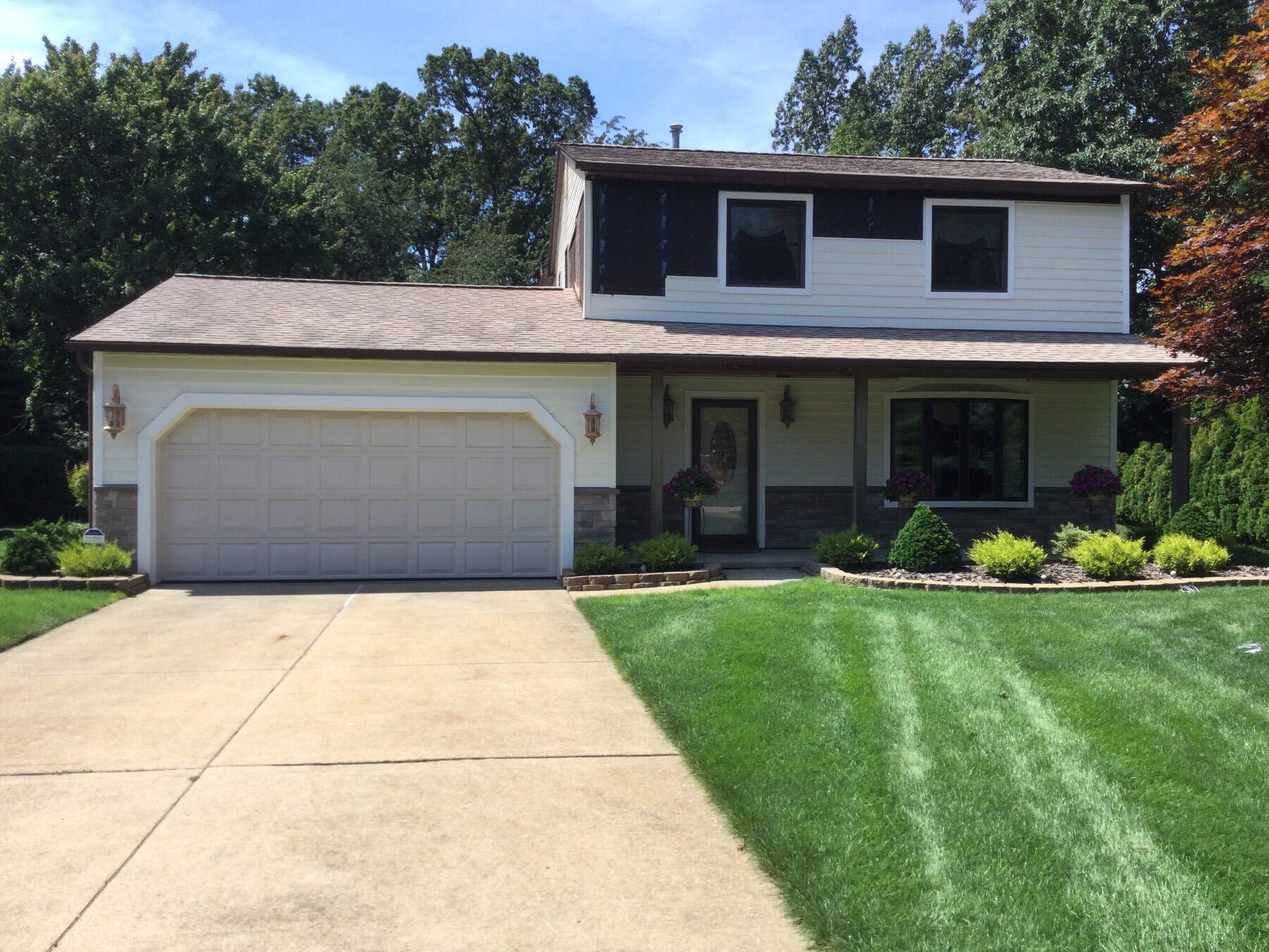

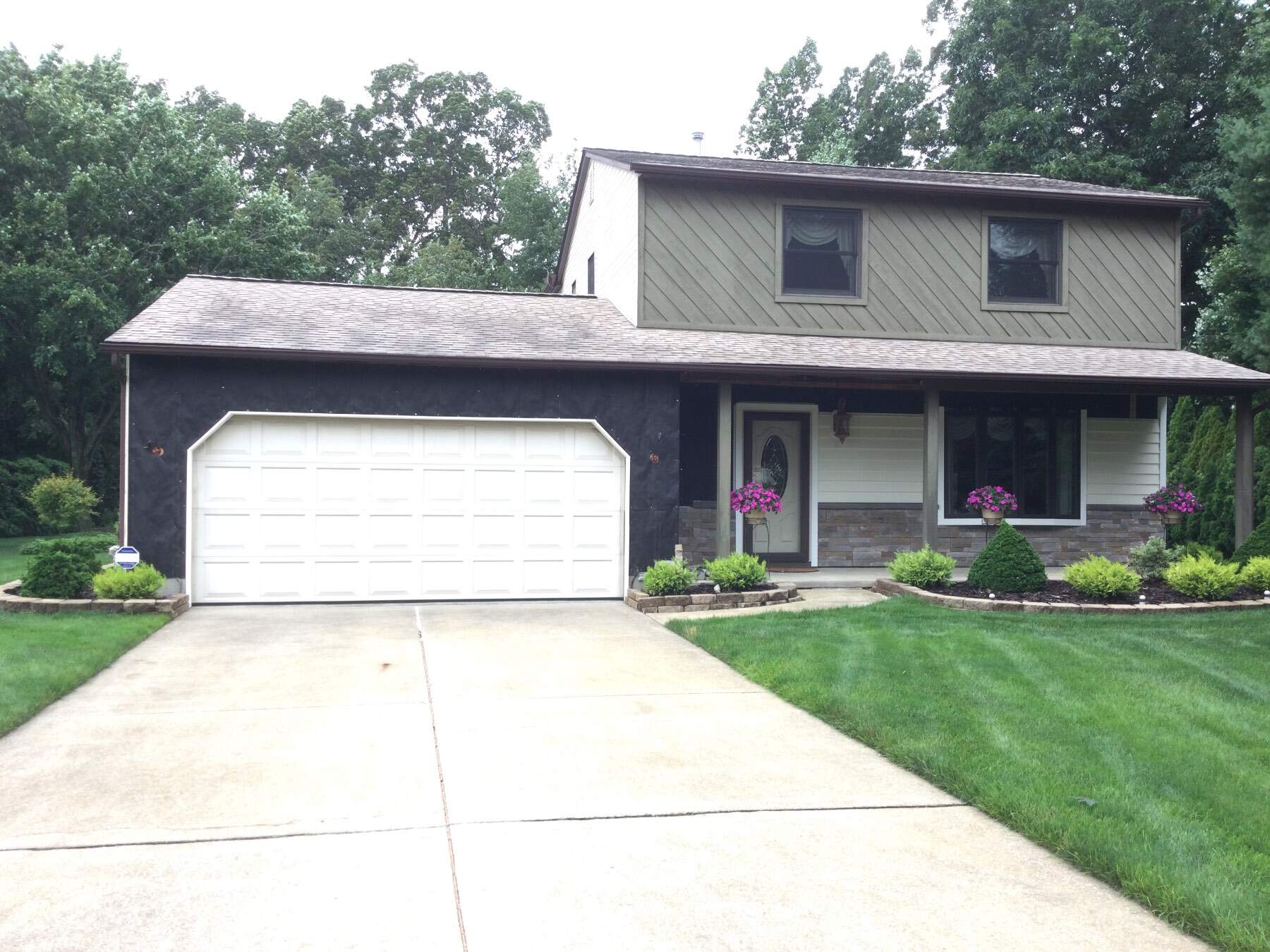

Well I finally found a sandal, little dangerous on the second story though! But no shoe yet!
Now that is looking very smart last Indian 👍
well done and I like the colour too 👍

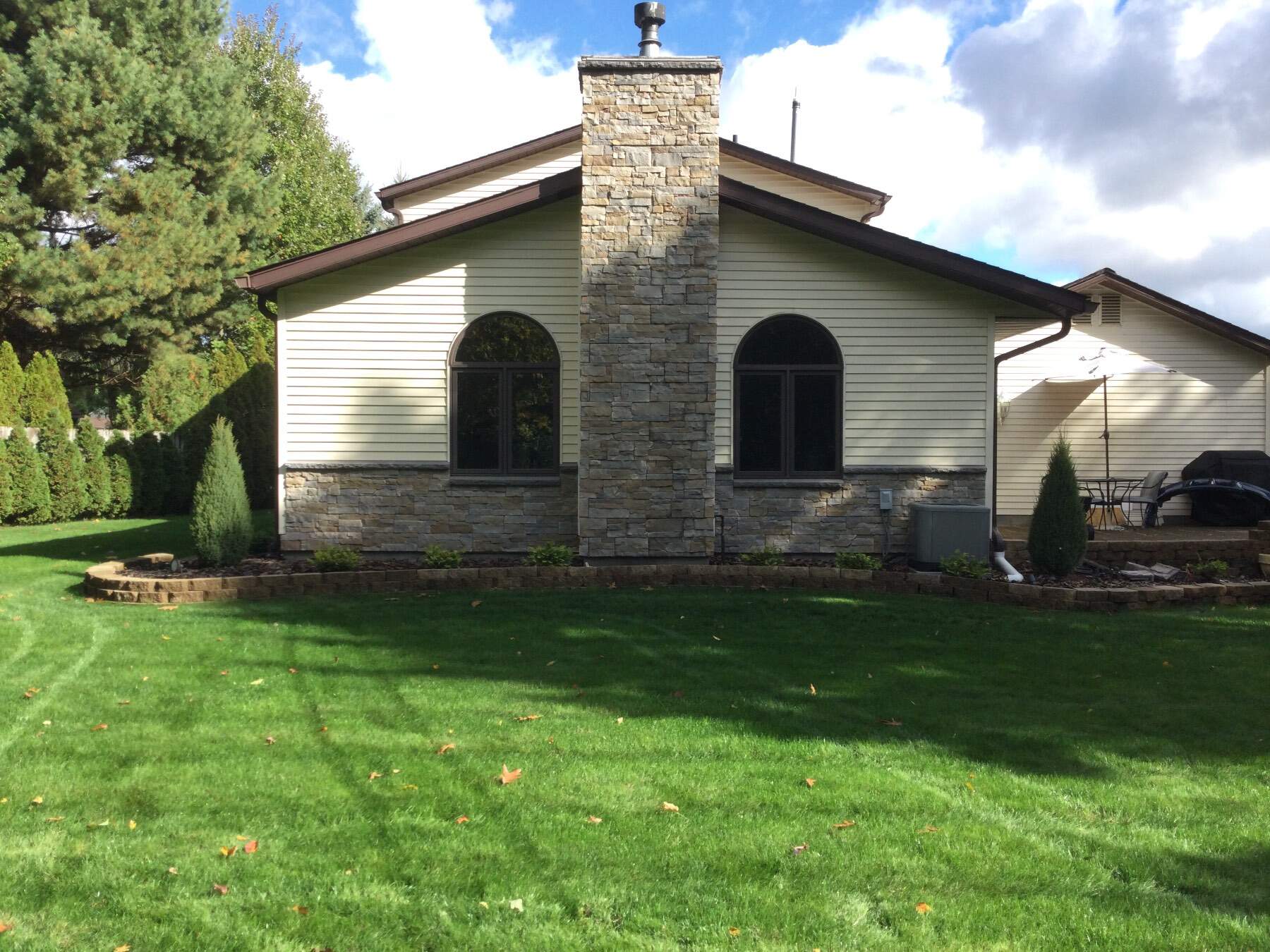

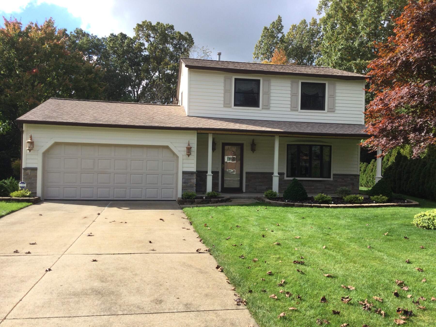

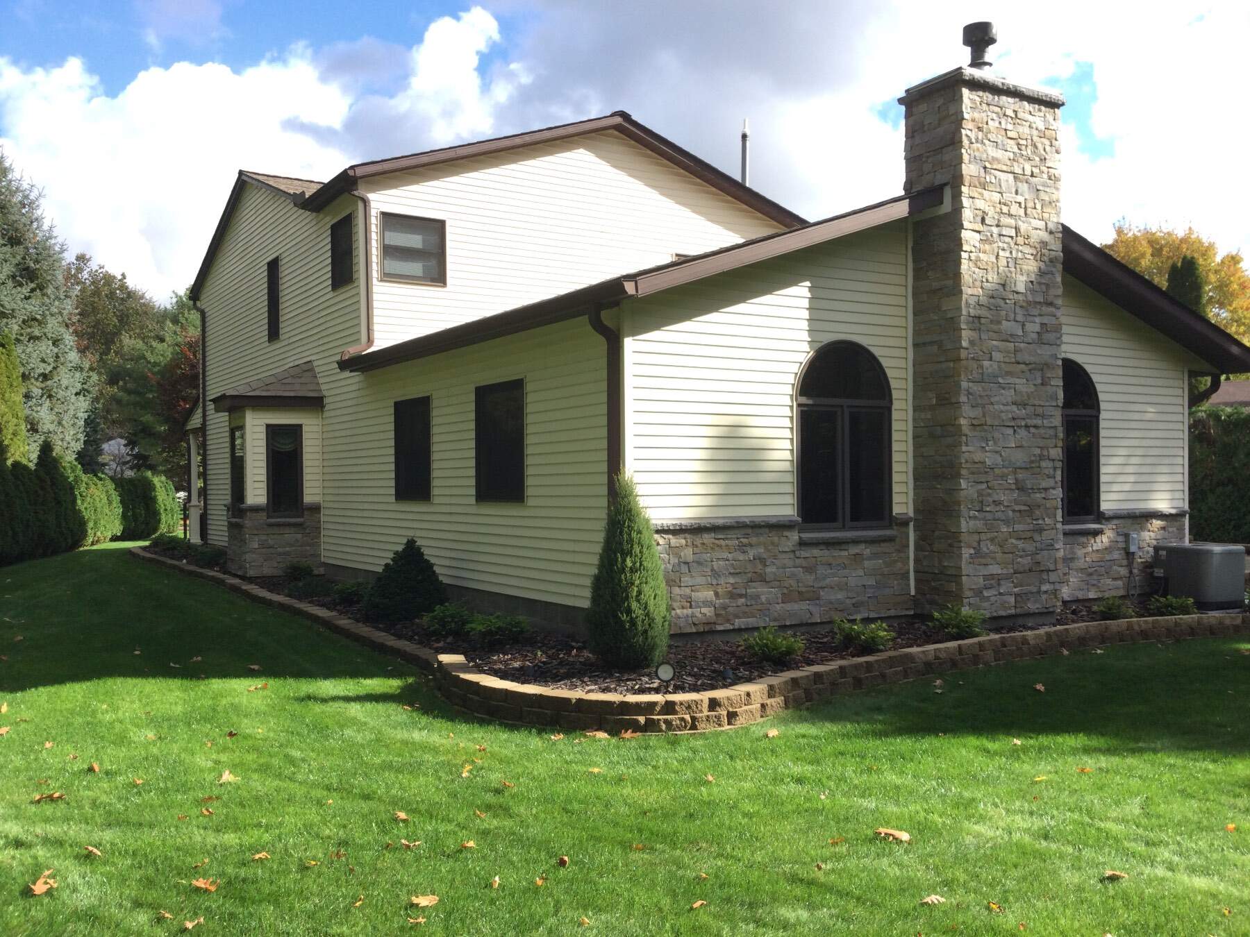

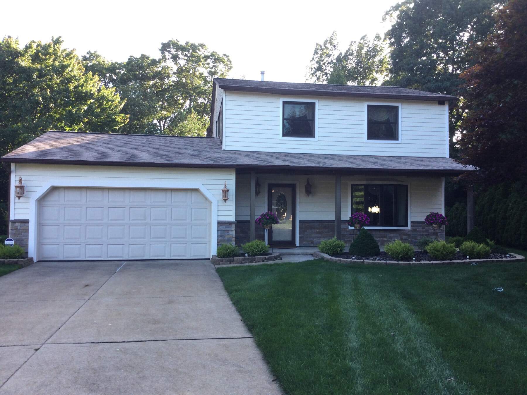

Well we got a little sun this past week. So other than some trim between the chimney and vinyl siding, soffits & gutters it’s done! Finally!  Notice in the last pic the old front cover on the patio. Had to cut that all up to throw it out, taken up to much attic space.
 mate!!! i bet there was a lot of work in those curved window headers!!!! well done :cheers:, the stone work breaks it up nicely too !!
