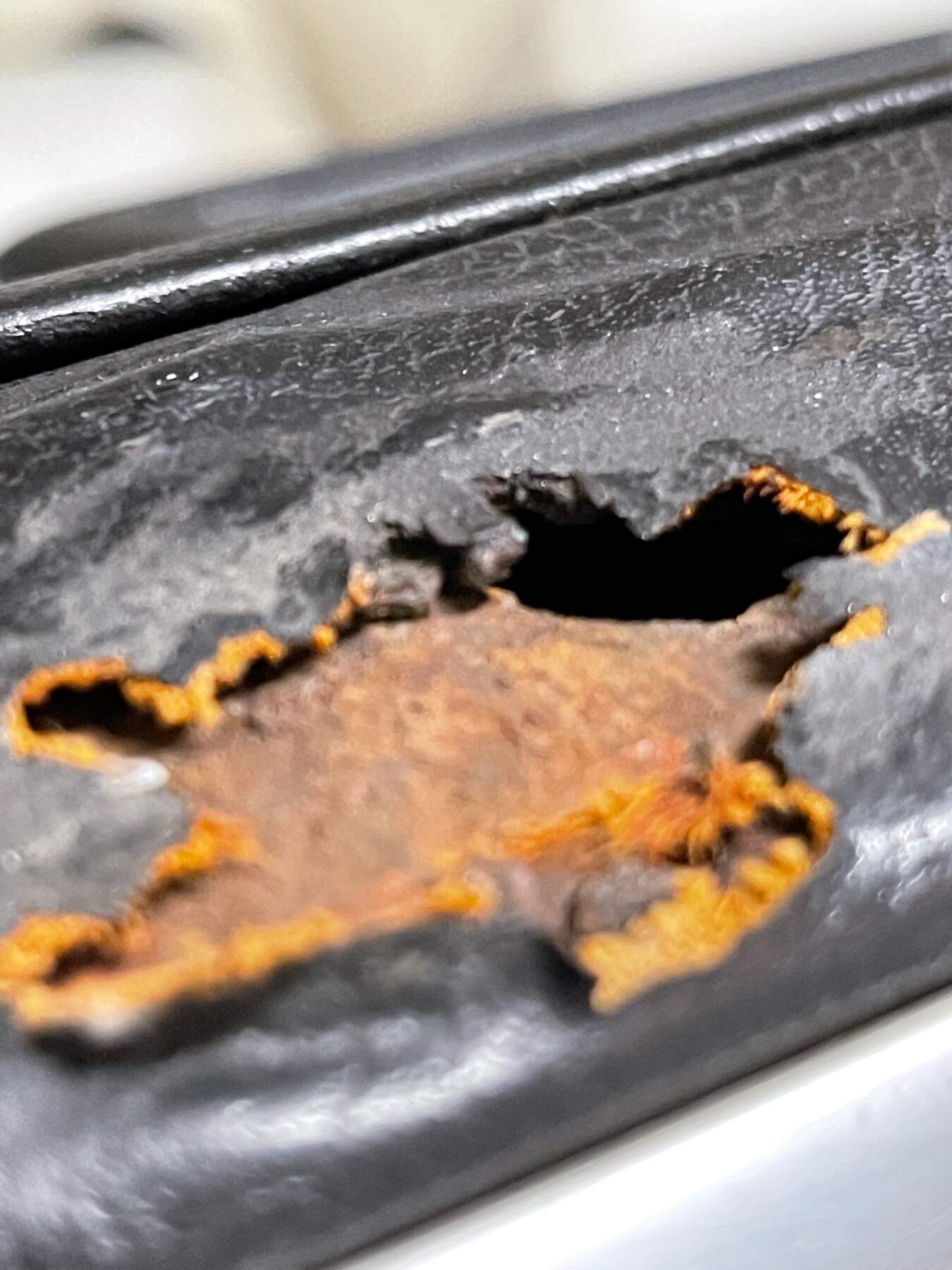

Hey people, I just found out my convertible windshield header on a 72 GTO / Lemans is rusted so bad I put my thumb through checking. Question: repair or replace or I was told there was a product made to inject through the hole that expands and fills the void. Kind of like the can spray insullation foam. Anyway and help would be greatly appreciated. THX

Do you have a picture of where your hole is? I have a '72 Lemans Sport convertible as well. So I am curious to see where it is and how bad it is.

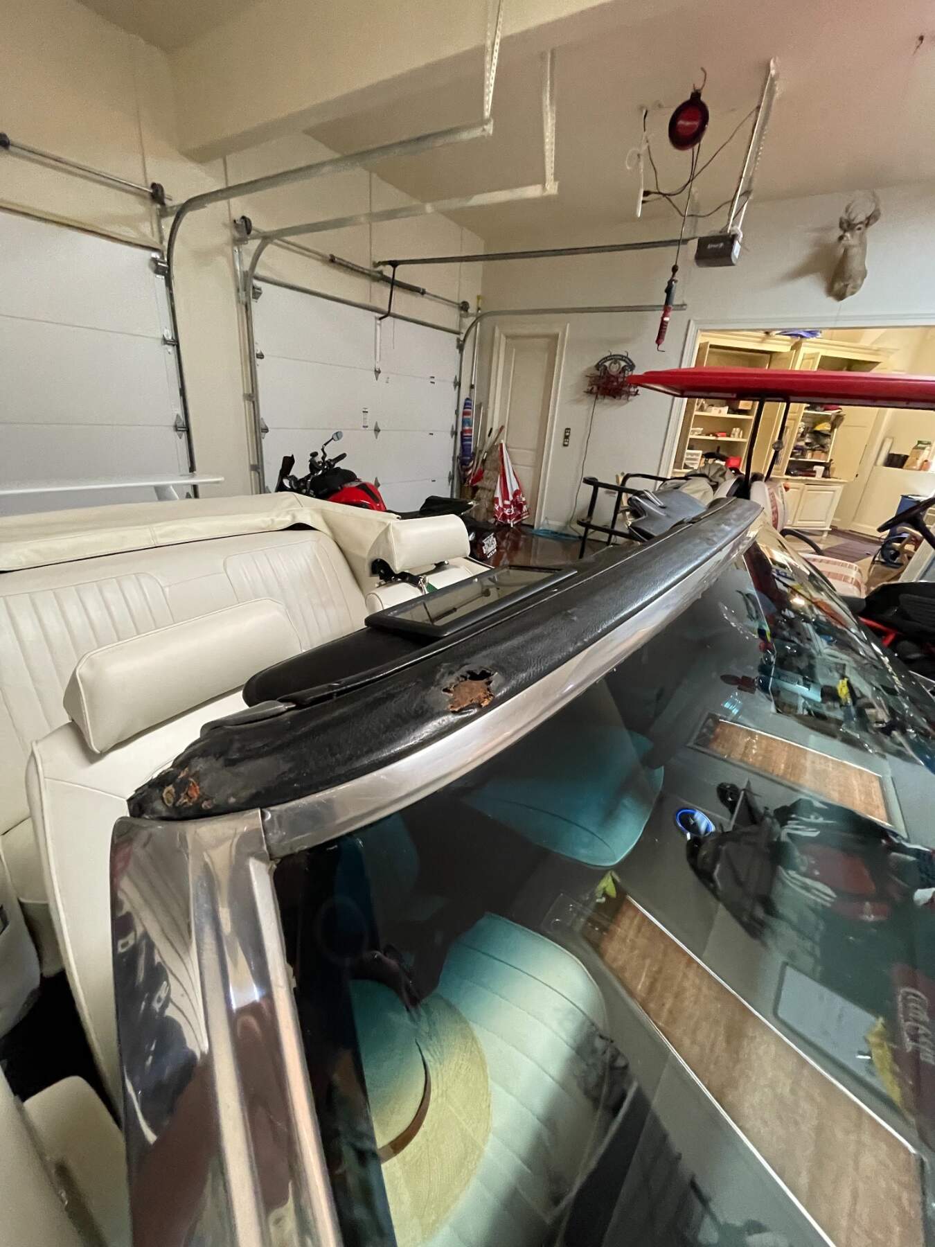

Mine is a 72 Lemans Sport as well. The GTO conversion took place before me and it was only a few decals and rear spoiler. The spot is about 1/2 way between the center and the right side, directly in front of passenger. I will get a picture and post this weekend. The size is now about the size of a quarter but I know the whole thing must be in the same shape, didn't show up until a spot came through the black vinyl strip covering it.

Yikes. This sort of repair is a new one on me. This definitely looks bad. I will have to research this one for sure.
Seems like there should be some injectable product, foam or flowable epoxy, that I can fill the void with. So far I've not found anything about a remedy.
Foam fill will not stop rust.  You would be making a much bigger mess of it when you go to fix it right.  Looks like you need to remove the piller and windshield chrome to see how bad it really is.  Junkyards, when ya find out how much you need to replace.  If you can find a good one.

I could be waaaay wrong on this but this is my first shot. So tell me what you think. I am not 100% certain that the brace is what is rusting or is it the windshield frame itself. The vinyl is definitely what you want once you've repaired the rust hole.
True, and something like POR-15 will stop the rust.
As I said before, it is the brace or is it the windshield frame itself.
JustA has a point. Junkyards are an excellent source of replacement metal, especially in the Southwest. You want a 70-72 GM A-body convertible - Chevy, Pontiac, Olds, or Buick are all interchangeable for this purpose.

I just finished welding up a header for a friend of mines chevelle convertible. It was rusted out in similar locations. I cut out the bad and replaced it with same thickness of metal. His just happened to be 12 guage.
You can fix this pretty easy if you have some fabrication and welding skills.

Thank you, the header replacement finally came in after a 6 month wait and now trying to get motivated to get my butt in gear and do it.
