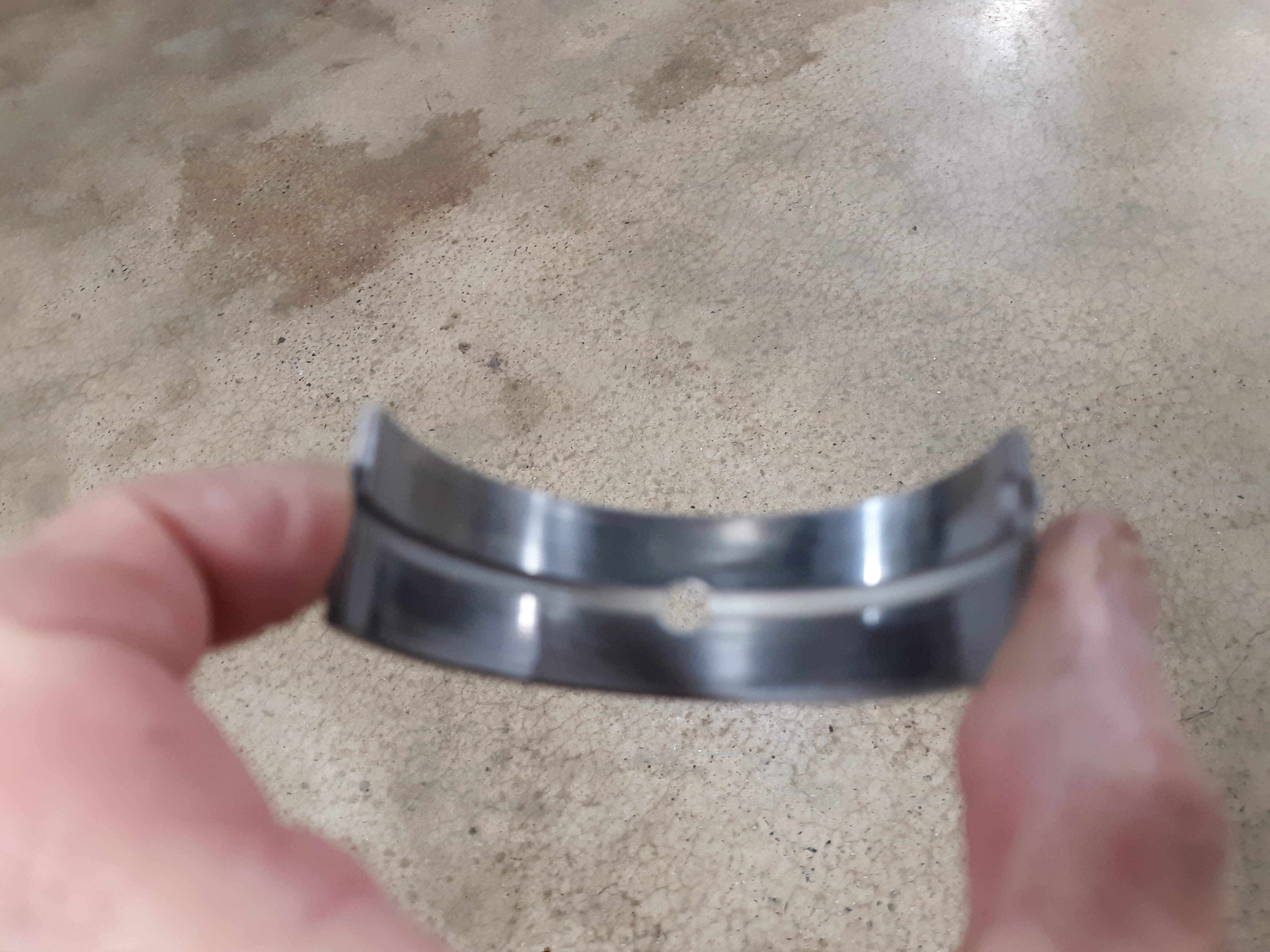

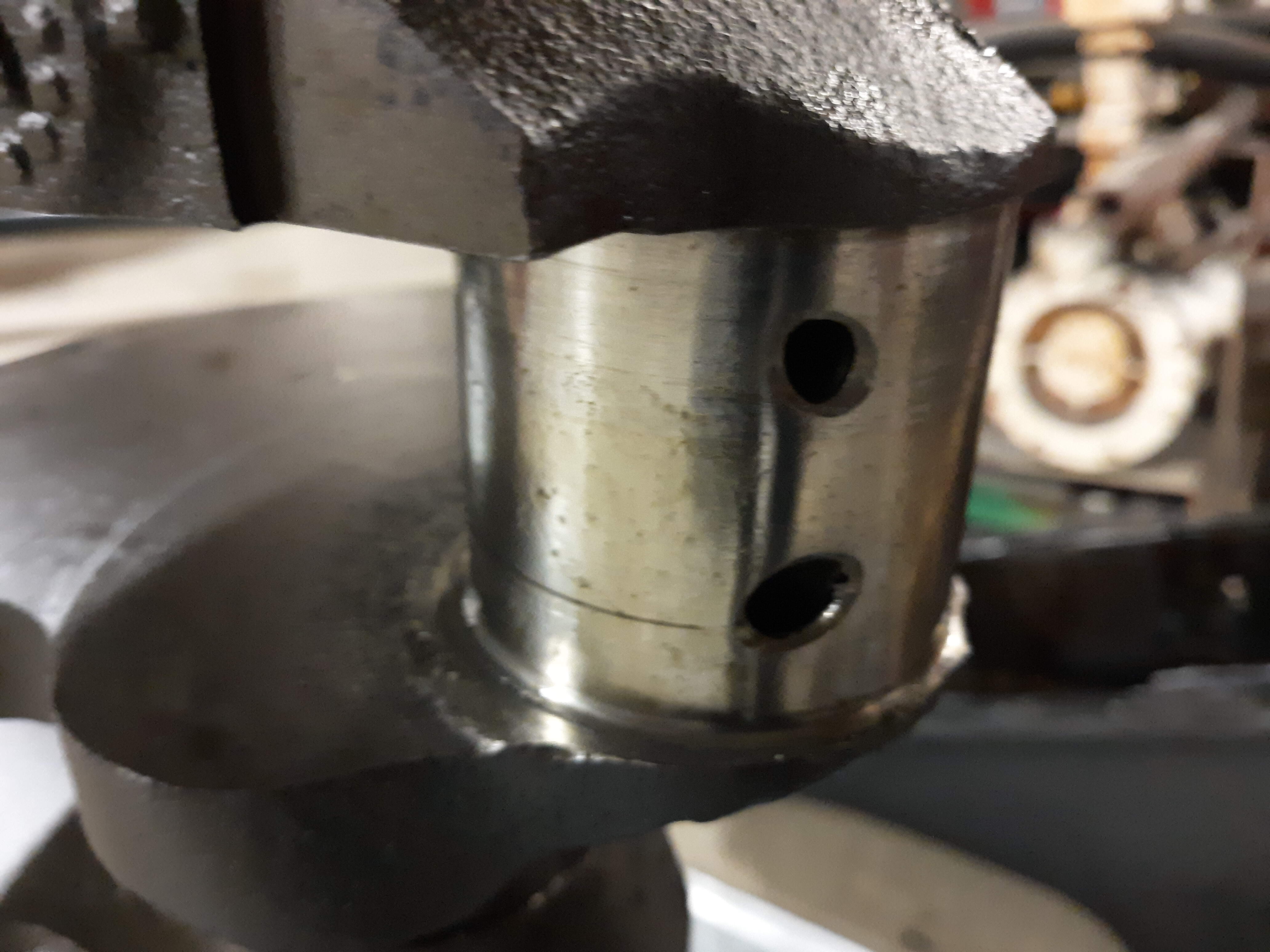

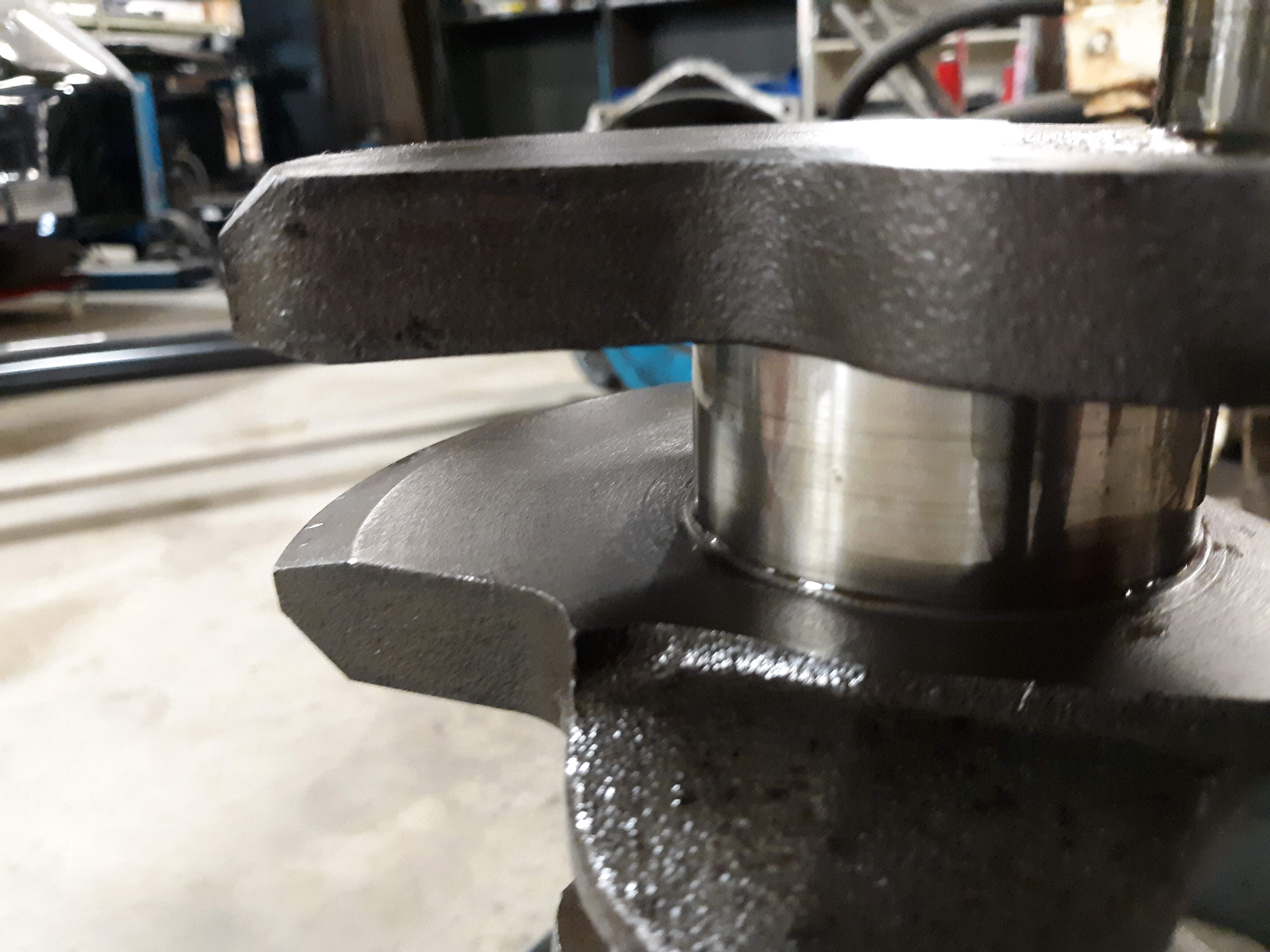

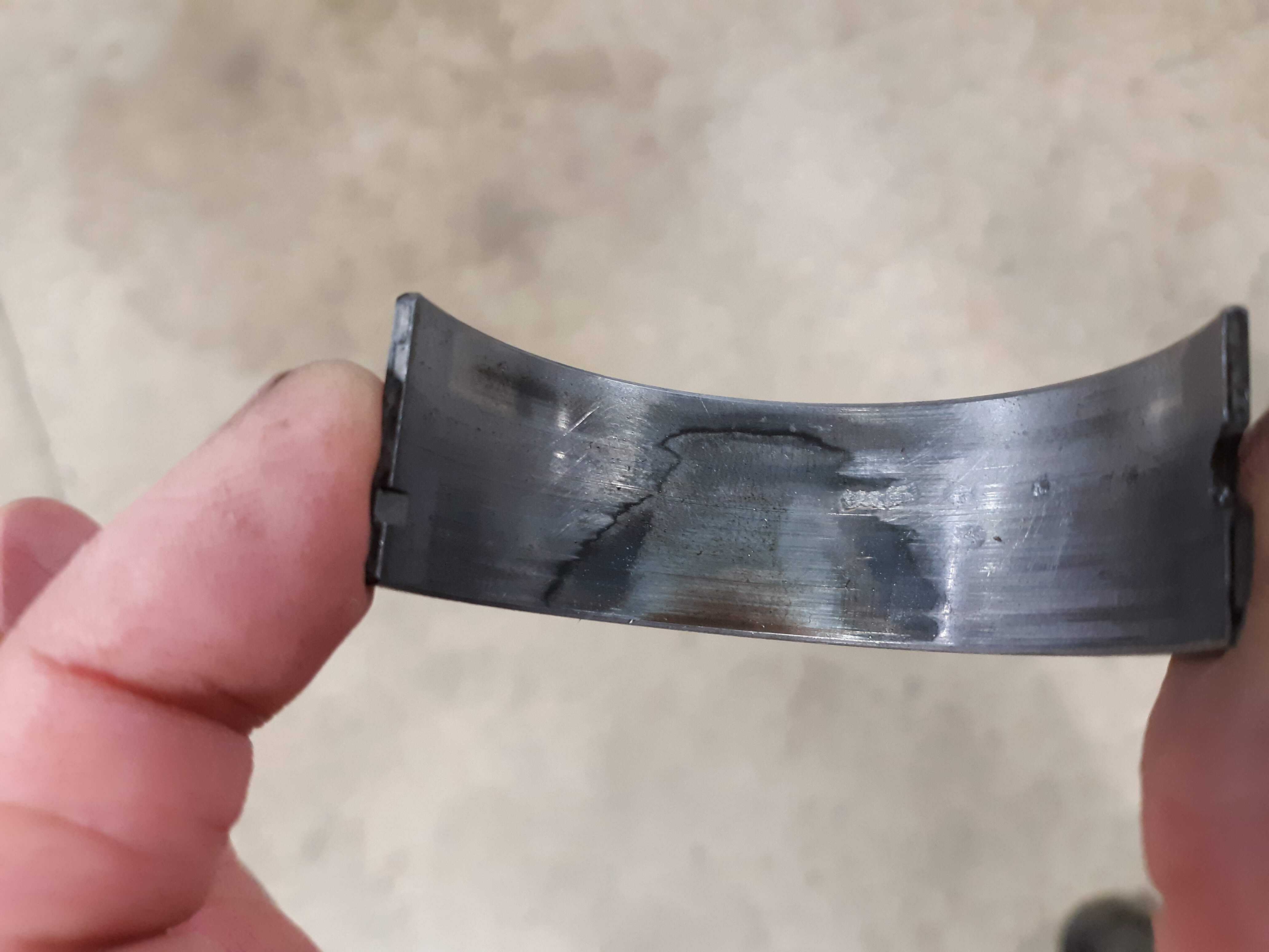

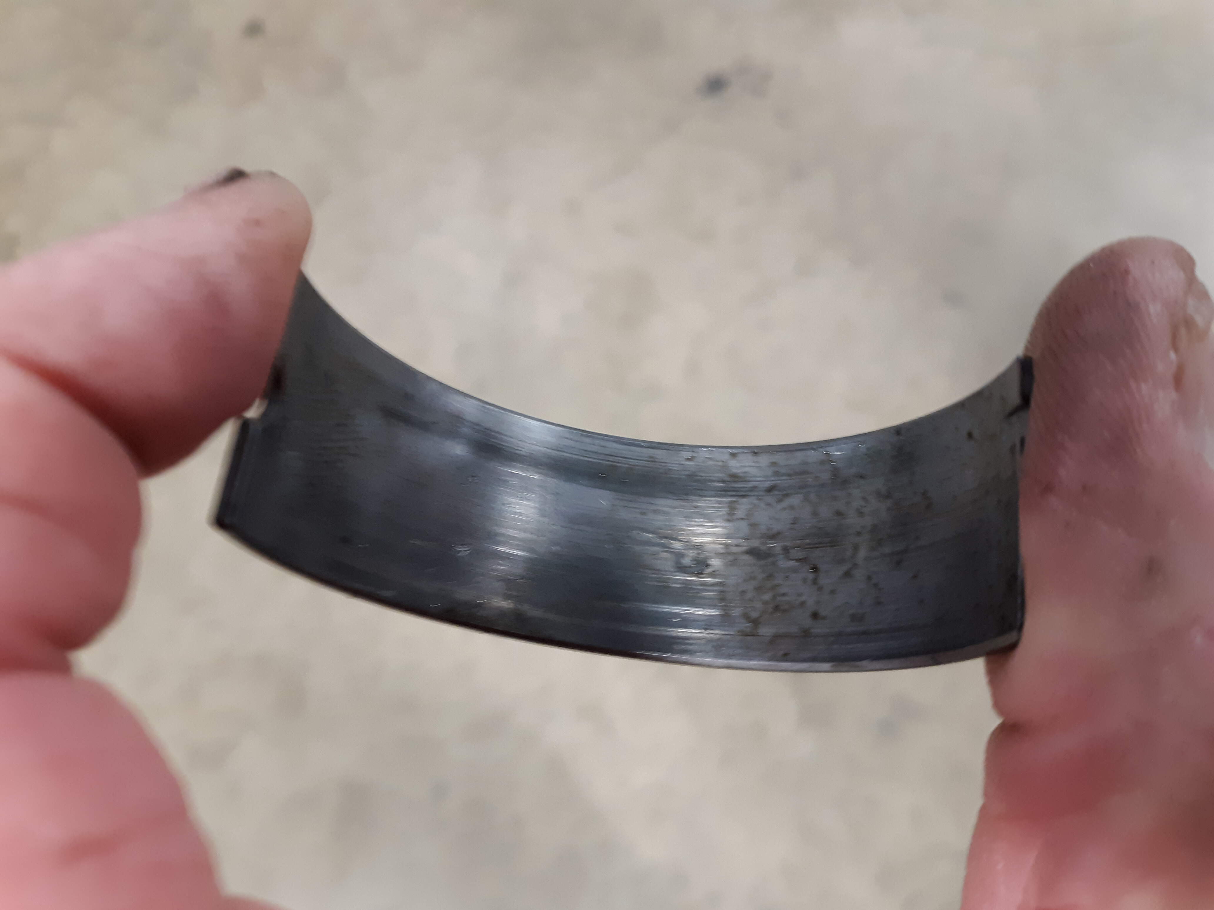

During the teardown I discovered the engine had excessive end play in the bottom end and the rod and main bearings were damaged by not having the proper clearances and grit that was left in the engine during the previous build..So I will be turning the forged crankshaft to .010 under and using the appropriate rod and main bearings..

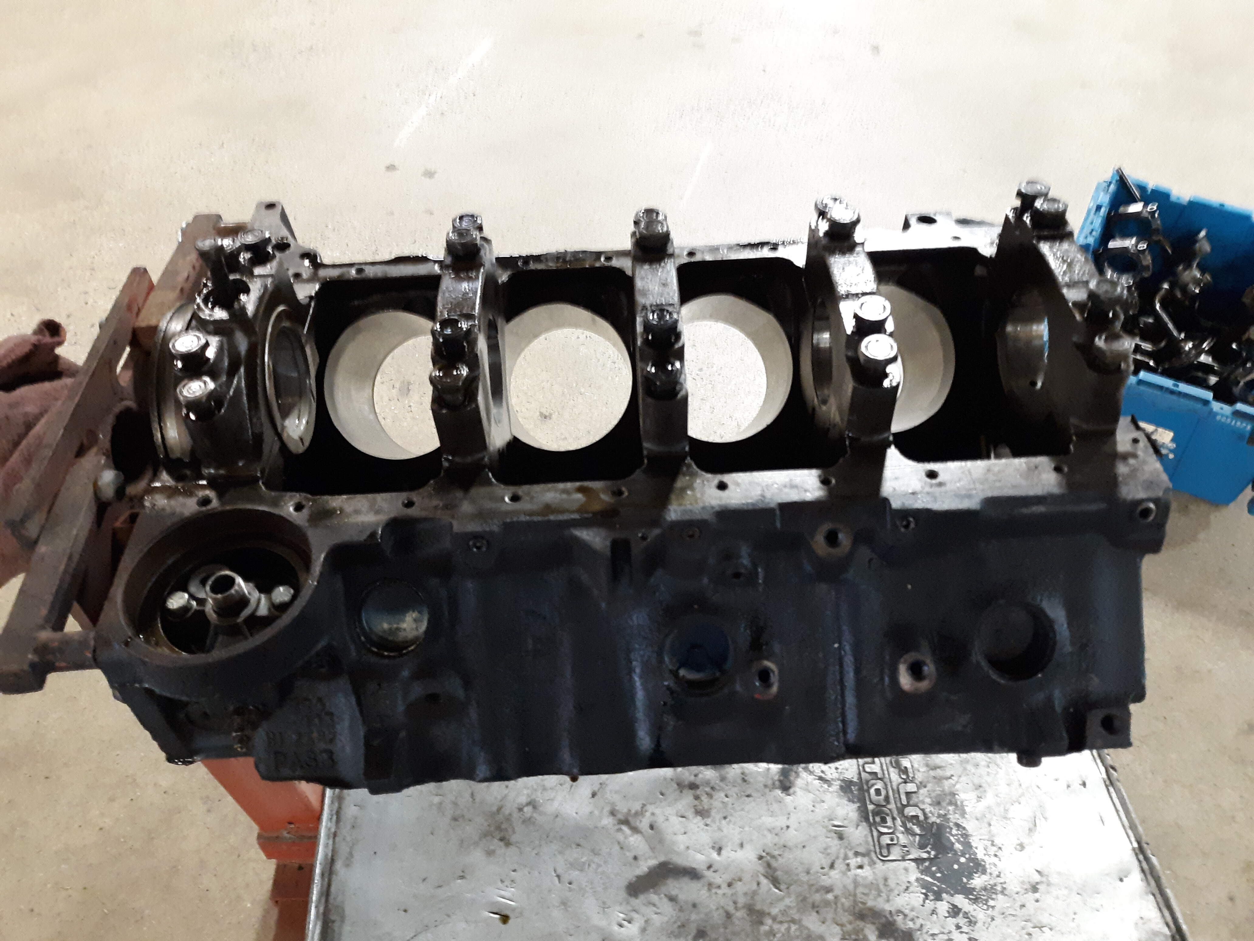

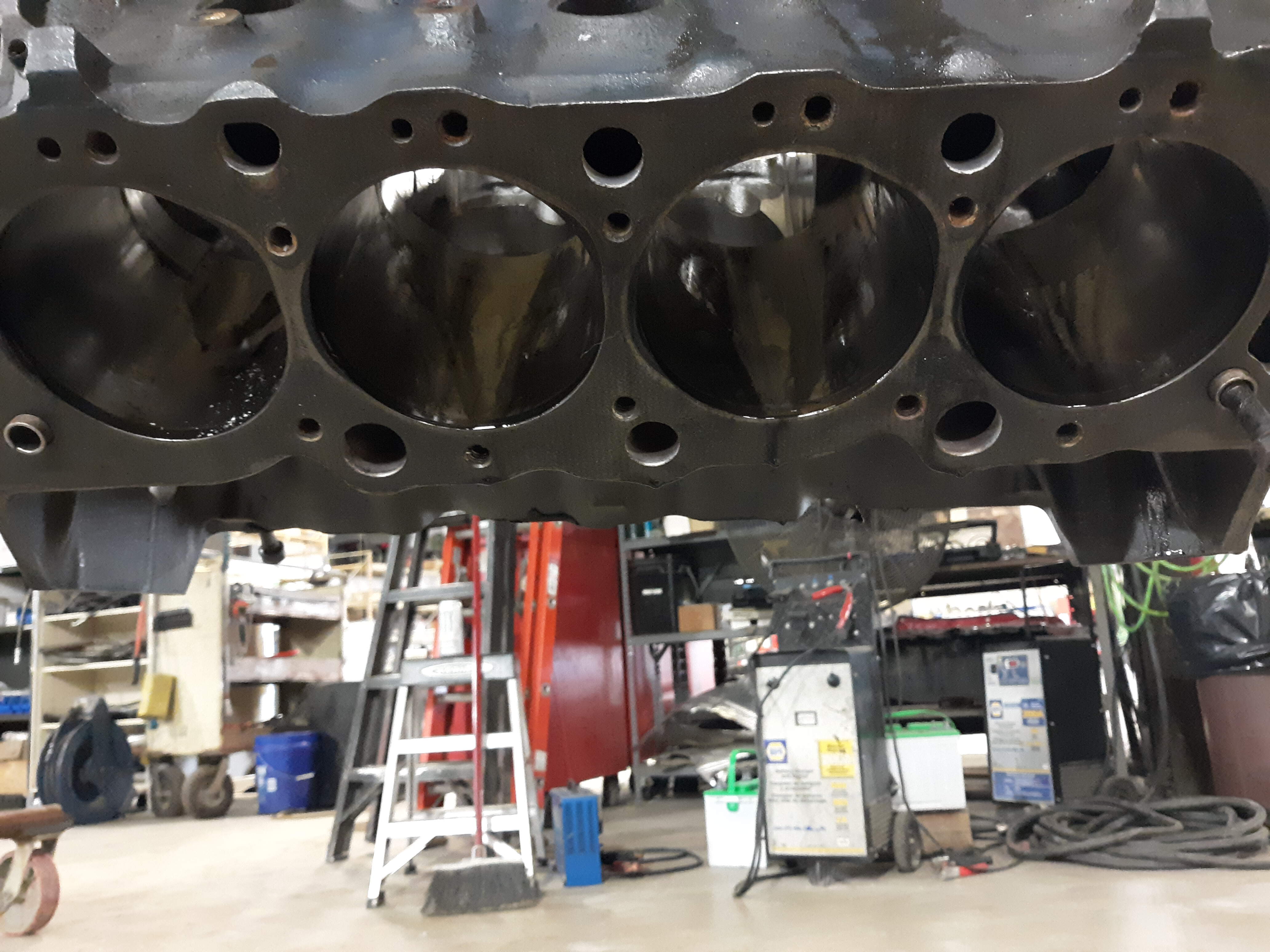

The bores surprisingly look good and still have a nice crosshatch pattern to them and they are straight ..No taper or ridge in the top and are nice and round and will not require any machining and only a good cleaning...

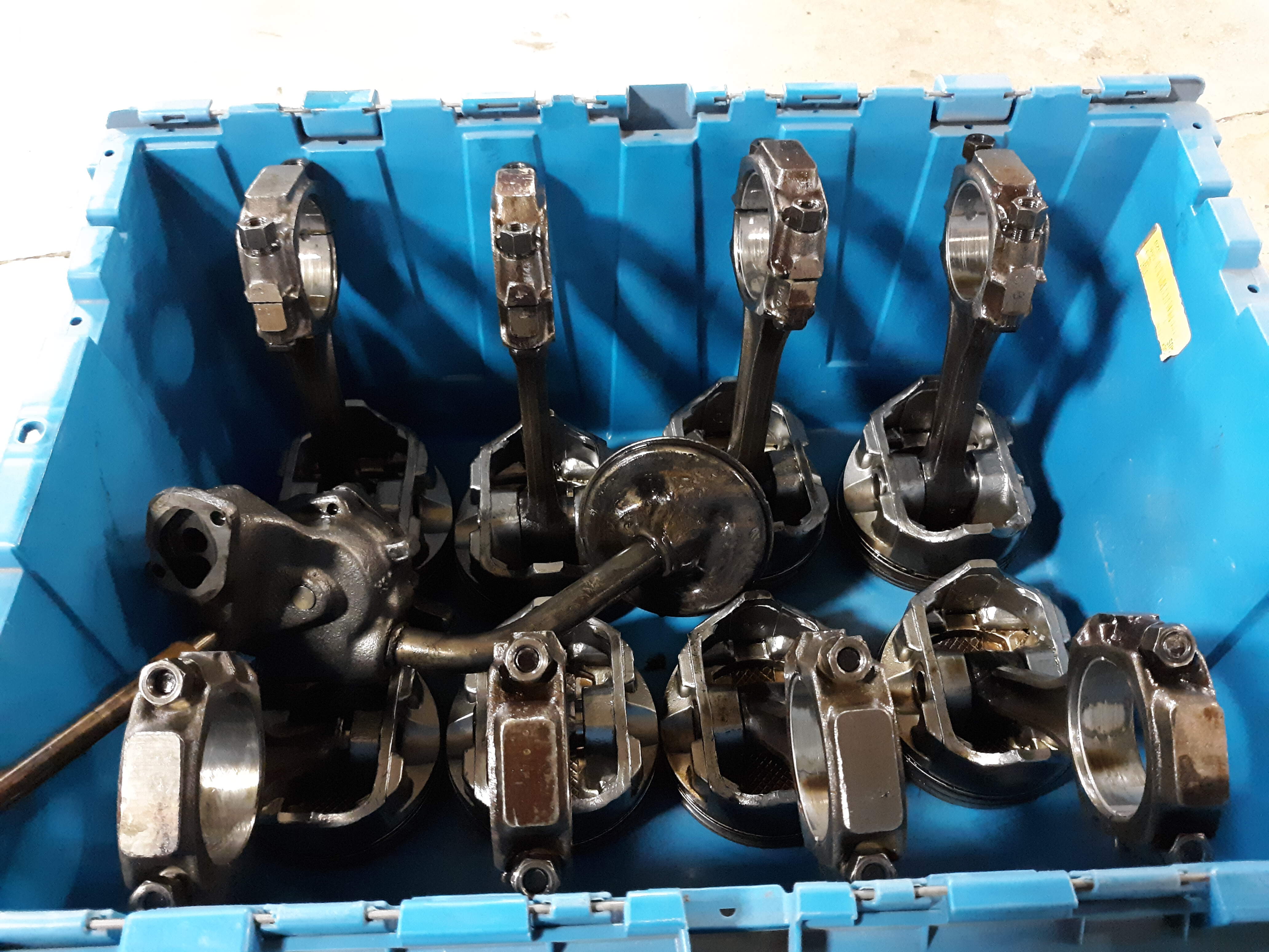

The forged rods and pistons are in really good shape and I will be reusing them after a good cleaning  will be using new rings so I can set the end gaps to coincide with the blower that will be installed..

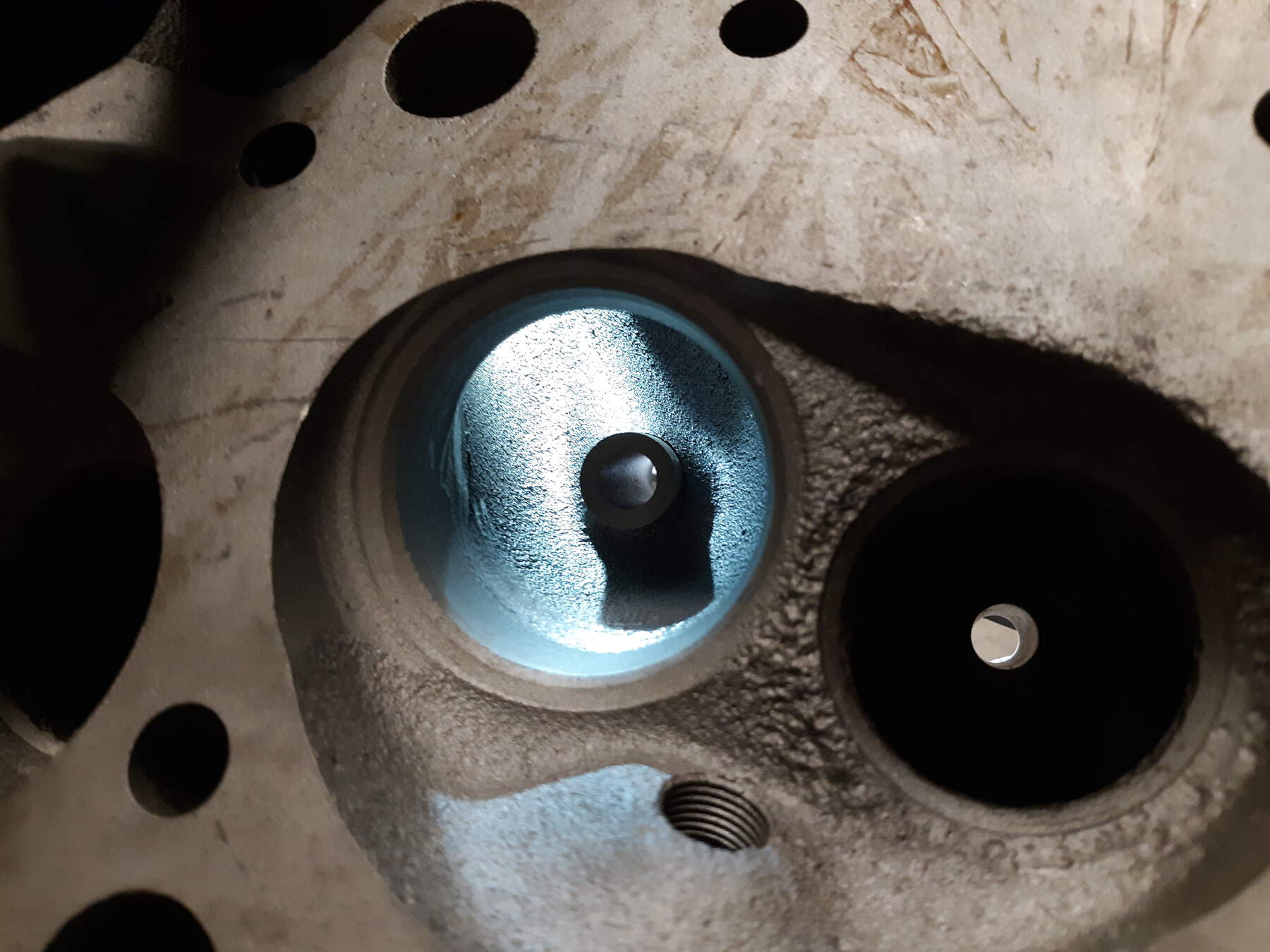

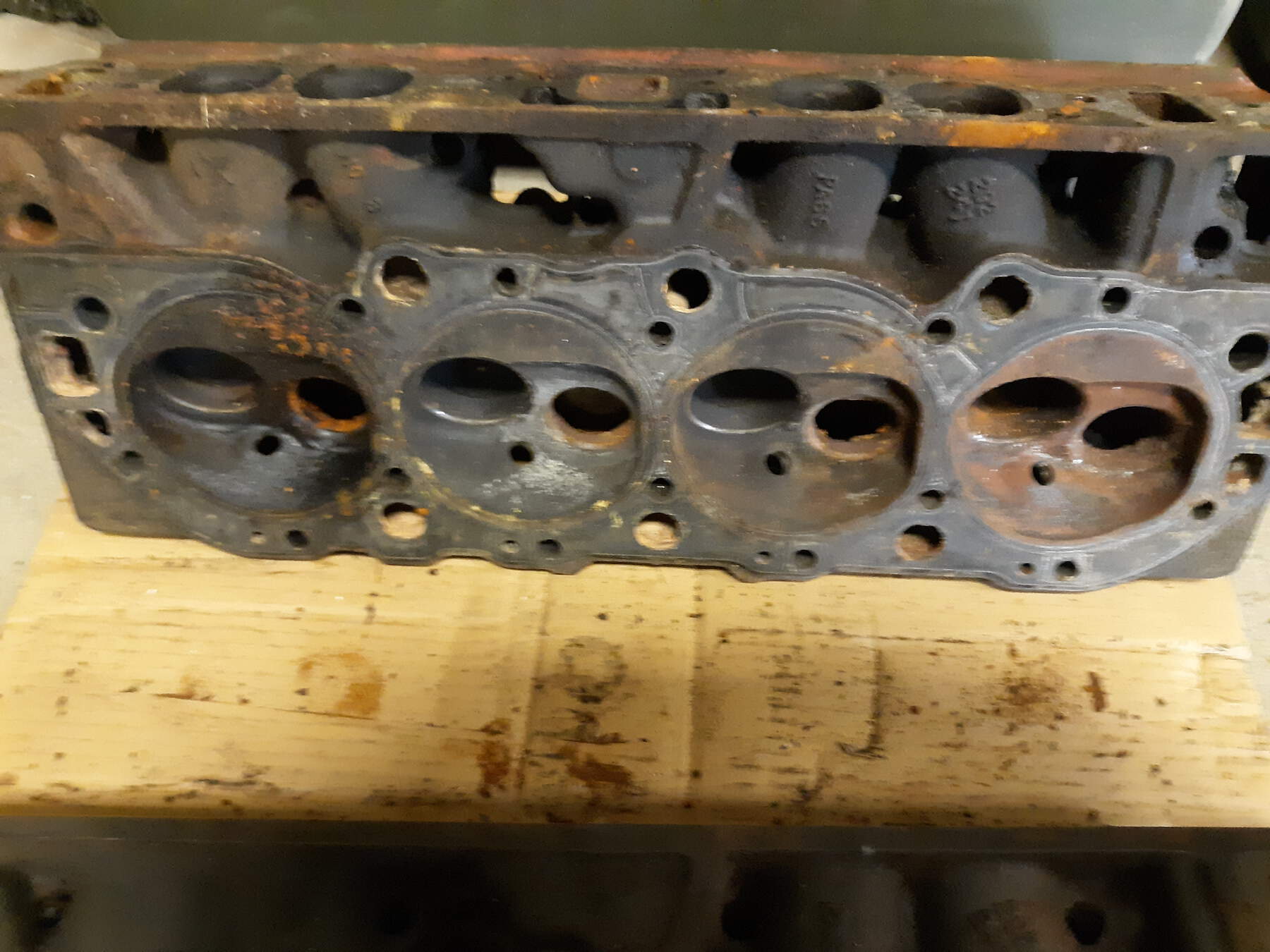

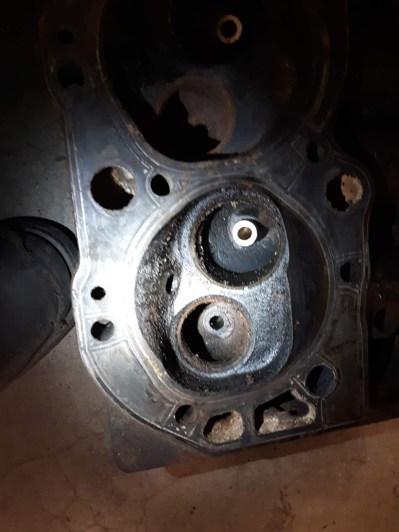

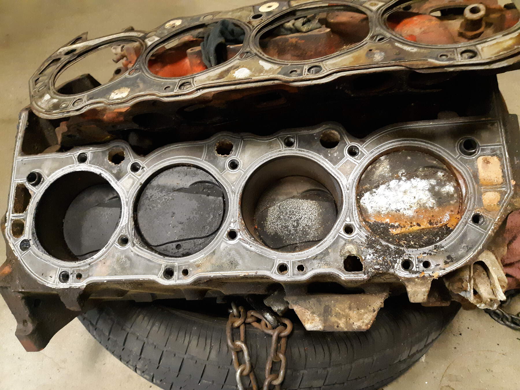

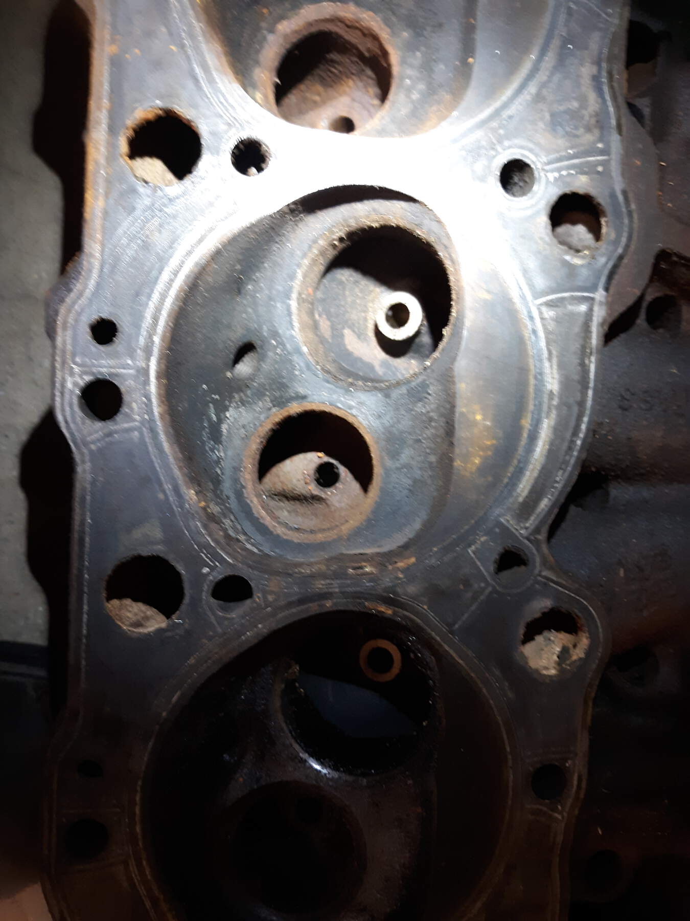

Upon further inspection the cylinder heads that the owner wanted to use are pretty much garbage...The combustion chambers are horribly pitted and can not be cleaned up enough to use in a blower motor without fear of detonation....As you can see the area between the valves (1st pic )...So I came up with another engine (454)..that is donating the heads and maybe the bottom end too...Over the next week or so..I will install hardened valve seats (the heads are 1971 LS-5 non EGR casting # 672292.... 113 cc combustion chambers)..New valve guides and a 3 angle valve job and stainless steel valves..Will provide more details and photos detailing the process as I move along....

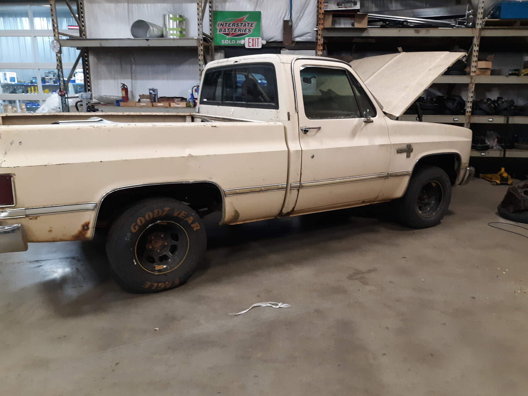

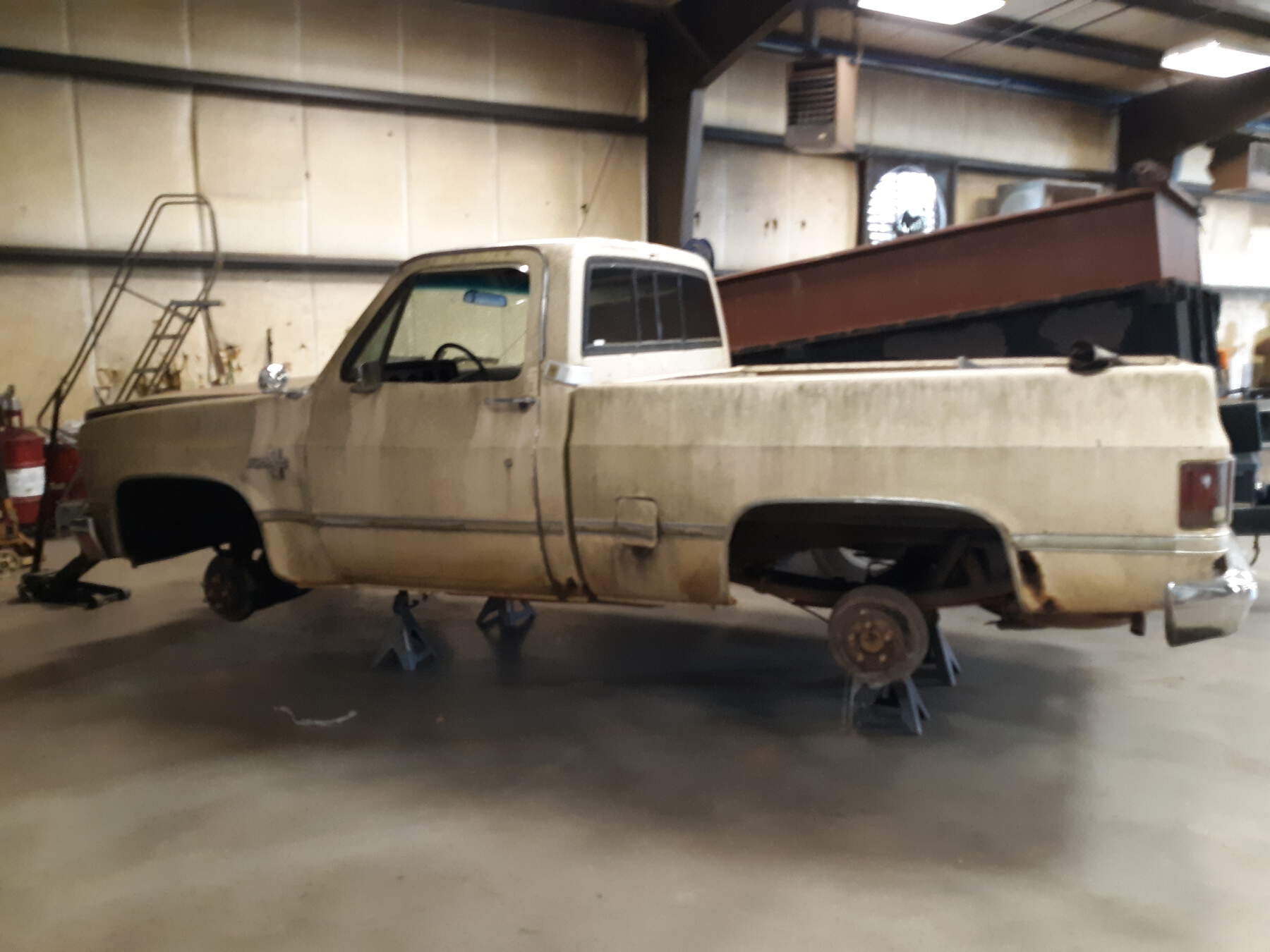

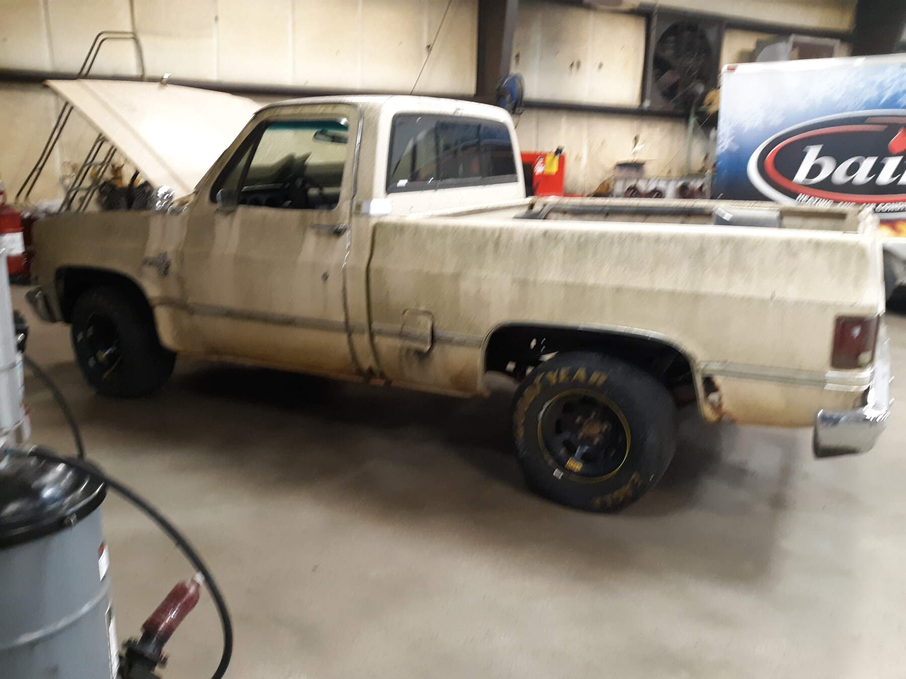

The owner has also come up the vehicle the engine will be installed in.....The plan is to leave the truck cosmetically the same on the outside and camouflage it as much as possible on the inside...Although a supercharger might be kind of hard to hide..LOL..

Not Orange enough to be a Farmtruck.   :lol:
