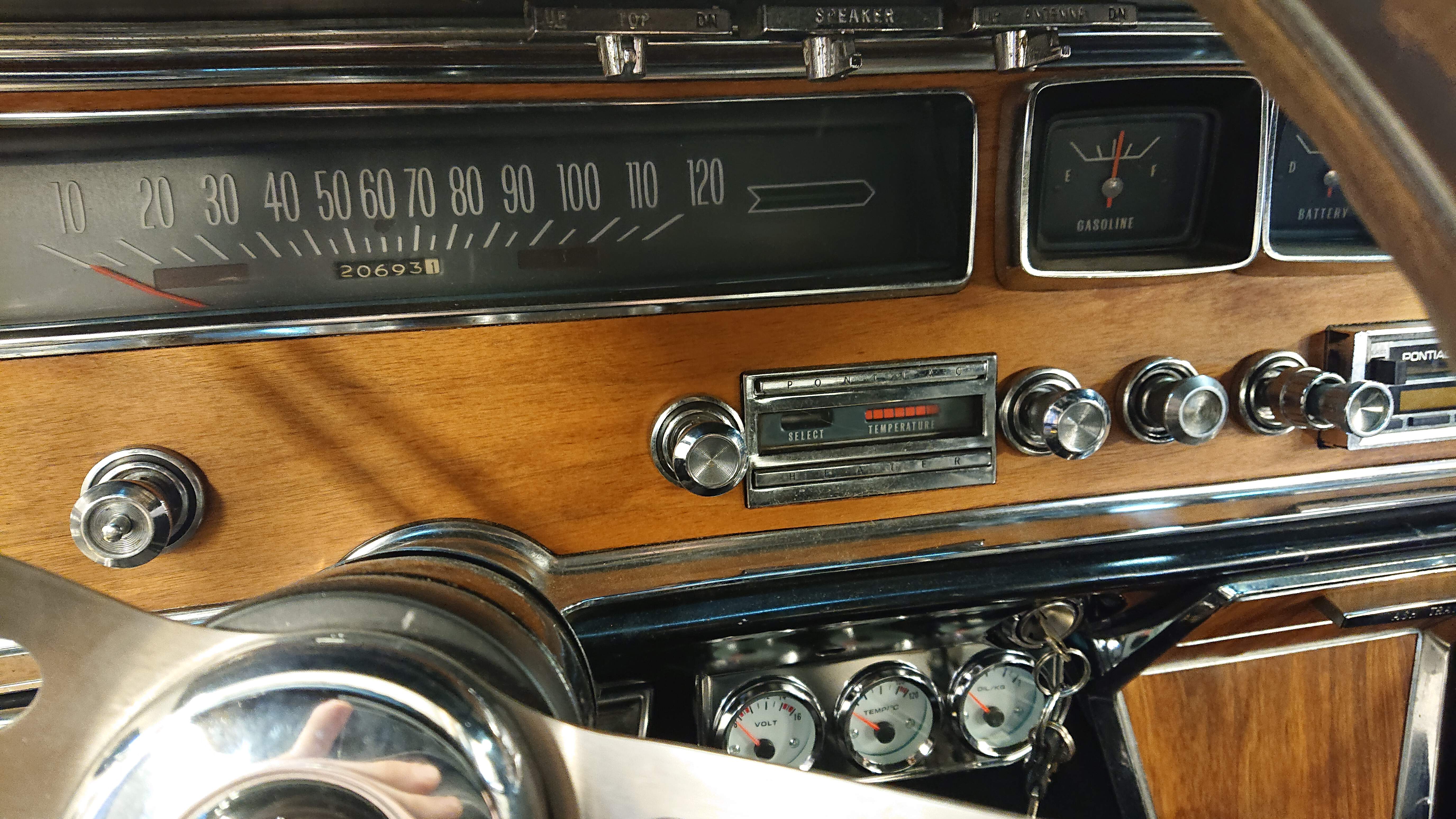

Hello
Does anyone know how I do to fix the text in the left window where it says select.
Seems like there is something missing in my switch.
Gunnar

What is the problem? Does the "Select" controls themselves not work on the car or is the word "Select" faded or distorted in some way? It is hard to tell from the picture.
Hi Frosty
It is the text itself.
... Normal.... Rear..De-ice. .which is gone. Depending on the position of the switch, it is different text in the window

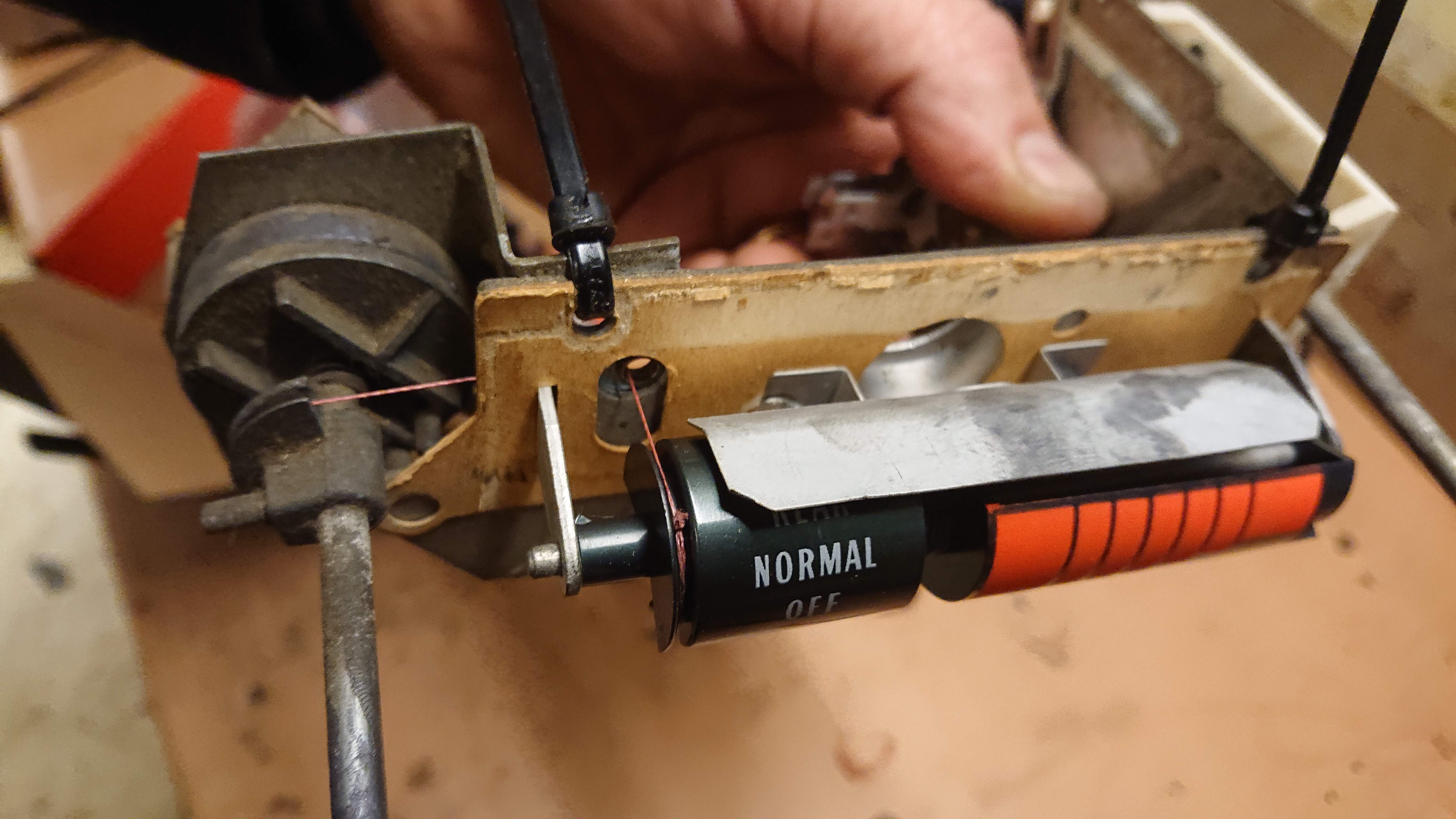

I took it apart and found a "sewing thread" that was off. I mounted a twisted fishing line instead and now it works perfectly 😃
