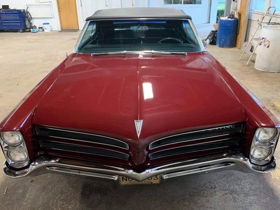

I am thinking about changing the 2 barrel carburetor to a 4 barrel carburetor on my 1966 389 Catalina.  I think I would like to use an original Pontiac 4 barrel intake, if I can get one that will work.  What problems with this change will I find, with its current setup, if any? What suggestions do you have?
