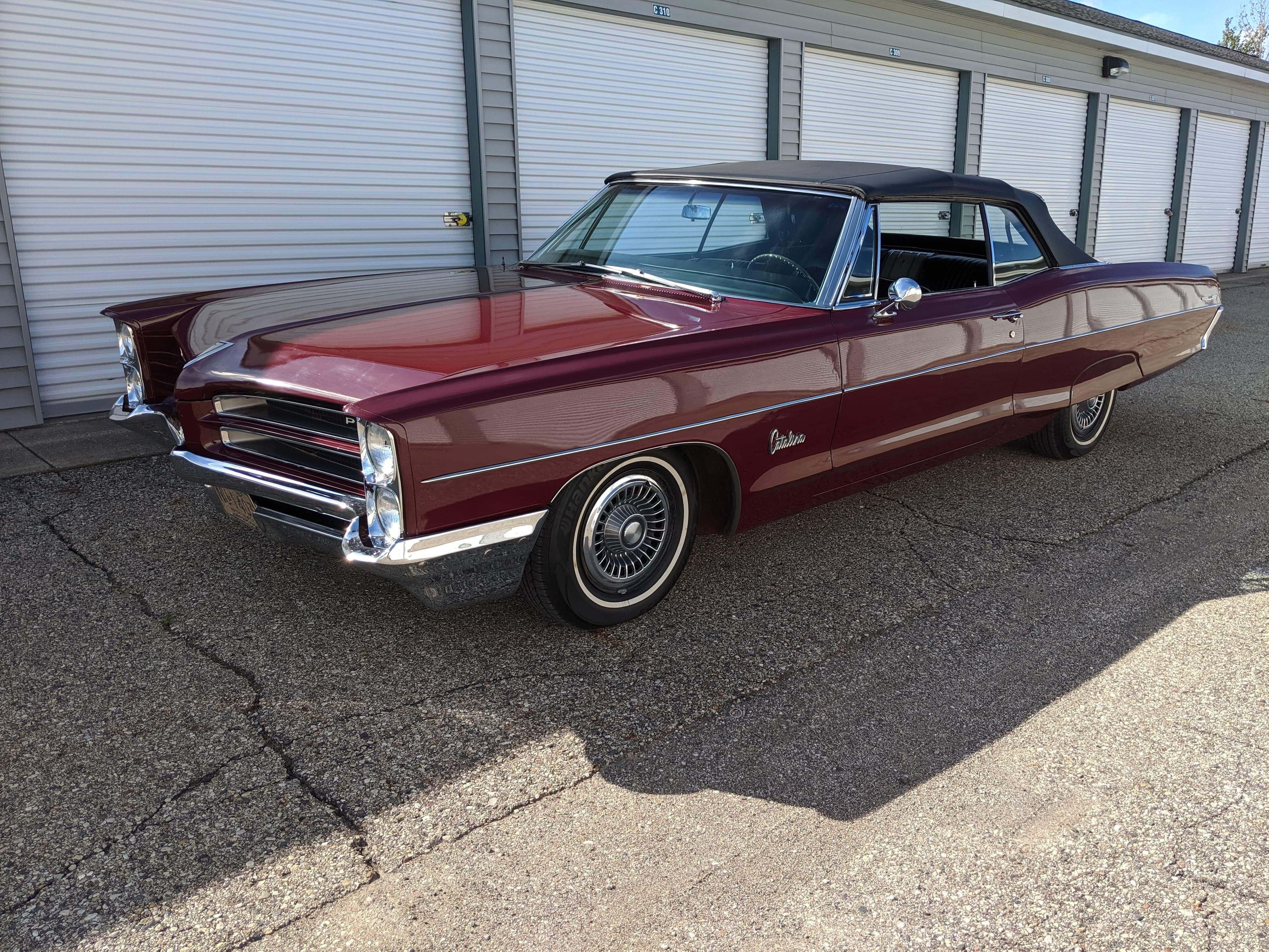

I picked the car up last night and drove it 75 Miles to a pole barn that will be its home until spring.
It did give me trouble with the engine. It looks like the previous owner, a friend that died and gave me first rights to buy it, never knew much about engines. 2 barrel carburetor, tappet covers and oil breather all leaked. I think the gas was 10 years old and I could not hardly keep it running at a stop without taking it out of gear. If I had known I would have came up and worked on it for him. With that said it road like riding on a cloud!
Now I think I will start looking for a 4 barrel intake, put an electronic Demon 4 barrel carburetor on it, put, electronic points and duel exhausts.
I would like your thoughts on that good or bad. I am pretty open. I own several old Corvettes and want to treat this beauty right.
I do not think the car has been driven over 35 miles per hour and 1,000 miles in the last 15 years.

It's amazing what a proper tune up and timing will do to these old cars. So treat it to all the proper tune-up parts: plugs, plug wires, cap and rotor, etc. By all means add the 4-bbl intake, carb and air cleaner. Obviously you have to drain / get rid of the old funky gas. Fresh gas and Stabil 360 or Stabil Storage is a must.
I run a breaker-less Pertronix Igniter II kit (Igniter IIIs are on the market now) in my stock distributor to get away from points/condenser and dwell meters. Or you can get a brand new distributor. I also have a spring kit in my to bring the timing in sooner.
The valve covers are probably over tightened (which is why is leaks) and may need new gaskets. That maybe the excuse you need for some shiny chrome or billet valve covers too. Add some cheap bling. Dual exhaust is good.
What are your plans for the car? If you plan to keep it a cruiser, I would not worry about a performance exhaust. I'd get a quiet exhaust and spend money on some sort of sound system down the road.
In time (and money) I would also inspect the suspension, replace worn out bushings and ball joints, body mounts, drag link, etc. If the car doesn't have one, install a rear sway bar. Install front disc brakes for better stopping. Clean up the interior or top as needed.
Since you own Corvettes and may not have worked on Pontiacs before, remember that on Pontiacs the distributor rotates counter clockwise. Chevys rotate clockwise. So when you are setting and check your firing order, keep that in mind.
