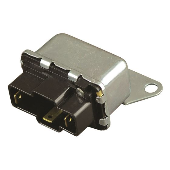

Is this what you are looking for ?

That's the relay and I am good with that.  Need the resistor that mounts on the housing by the fire wall.  I have tried old air, aames, opg and everyone else I could think to ask.  But thank you for responding to help.
