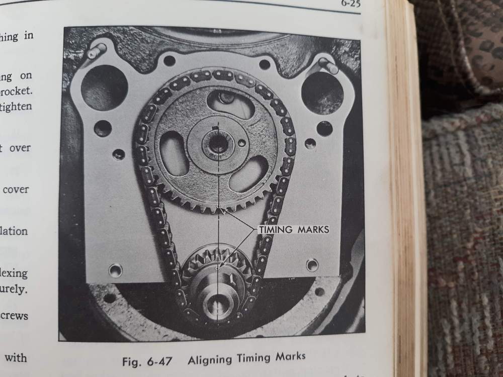

need help I have tried timing my 400 / 6.6 engine crank & cam shaft timing gears ⚙️ by having the timing marks at the top of each gear and changing the cam gear so the dot is at the bottom and the crank dot is at the top closest to each other number one piston on TDC distributor pointing at number one no luck I need a clear picture hope you can help

Sorry you’re have trouble, just double checking here! Standing in front of the engine, # 1 is the first cylinder on the right. Also a Pontiac distributor runs counterclockwise, just as a check for you!
Always position the TDC timing dot on the crankshaft gear at the 12-o’clock position during timing set installation. However, the camshaft gear timing dot can be installed at 6 or 12 o’clock. Either position has no effect on camshaft timing and positions the camshaft in same relation to the crankshaft. It does, however, affect ignition timing. When the timing dots are aligned at 12 o’clock, the engine is at the number-1 firing position. With the cam gear at 6 o’clock, the engine is placed at the number-6 firing position. Since the crank rotates twice as fast as the camshaft, either position can be used as long as the distributor is installed accordingly. I routinely rotate the crankshaft several times, stopping the cam gear at the 6-o’clock position just to verify that the timing dots are exactly aligned with that position too. The crankshaft is then rotated one more revolution so the cam gear returns to 12 o’clock for the remainder of engine assembly.
What exactly is the engine doing or not doing..?? When you installed the balancer on the engine did you have to move it to get the the timing mark to line up with the zero mark on the timing tab...?? If that is the case...The outer ring on old dampers tend to move around rendering the timing mark on it completely inaccurate....
