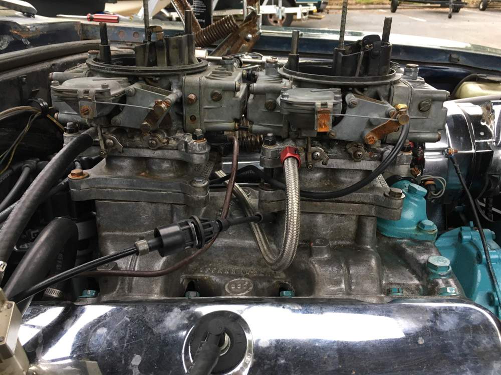

I’m having an issue where my GTO runs great in park. But when I put it in drive it idles much lower and stumbles like it’s going to stall and if I give it any gas it stalls out. This is my first classic and I’ve never worked with carbs until this car. So I’m assuming it’s a tuning issue. But I might have something hooked up wrong or possible vacuum issue but I sprayed the engine down with throttle cleaner and found no vacuum leaks. If you can see anything hooked up wrong or tell me what I should mess with it would be much appreciated

In the picture you’ve taken I see more questions than answers. It doesn’t look like the secondary’s are connected to port vacuum. Also wow, all the adaptors connecting the carbs to the tunnel ram present a challenge! Are there vacuum leaks? Quite possible, that needs check at each gasket interface with ether. Any leaks at those will cause precisely what you describe. Are the gaskets at each interface the correct ones? If not that can change vacuum!
I assume the car came with that setup on it and you did not install it?
I don’t know what you mean by changing the vacuum secondary to ported vacuum I don’t believe I did how would I do that. I don’t see any kind of vaccine line going to the diaphram on the side of the carb and I sprayed down all of the adapters and intake and found no vacuum leaks. Yes this is the set up I bought it with
It’s been quite a few years since I worked on vacuum secondary Holleys, I always preferred mechanical ones, but it appears your vacuum secondary’s are fed internally. I still suspect they are the culprit. As you will see or hear, in this video.
Go to You tube select search and paste this link into it. http://... http://www.jegs.com/p/Holley/Holley-Vacuum-Secondary-Components/757289/10002/-1 ------... that should bring up Jegs tutorial. This will explain how they work how to check them and what some issues might be.
Additionally, you may still have a vacuum leak! Carb cleaner is not the best fluid to use for finding a vacuum leak, ether is.
When the engine is in an idle have you checked engine vacuum? What is the number. When you put it in gear what does the vacuum fall to? Have you checked compression? If it’s not vacuum There are a lot of things it could be! Spark plug wires, just bad carbs that need rebuilt, distributor issues, etc.

Why isn't your kick down cable connected. That has to be connected & adjusted correctly or your engine will stall as it controls the amount of vacuum & when your trans shifts. You need to have someone with the experience to help you or your going to burn up your trans if you haven't already.
