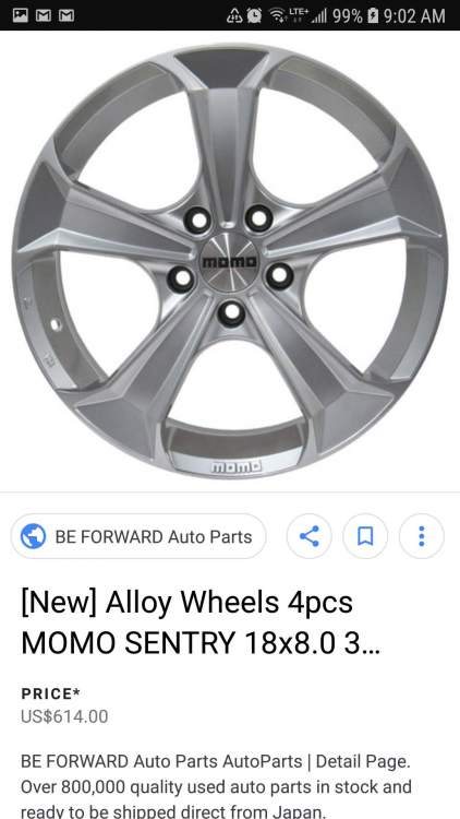

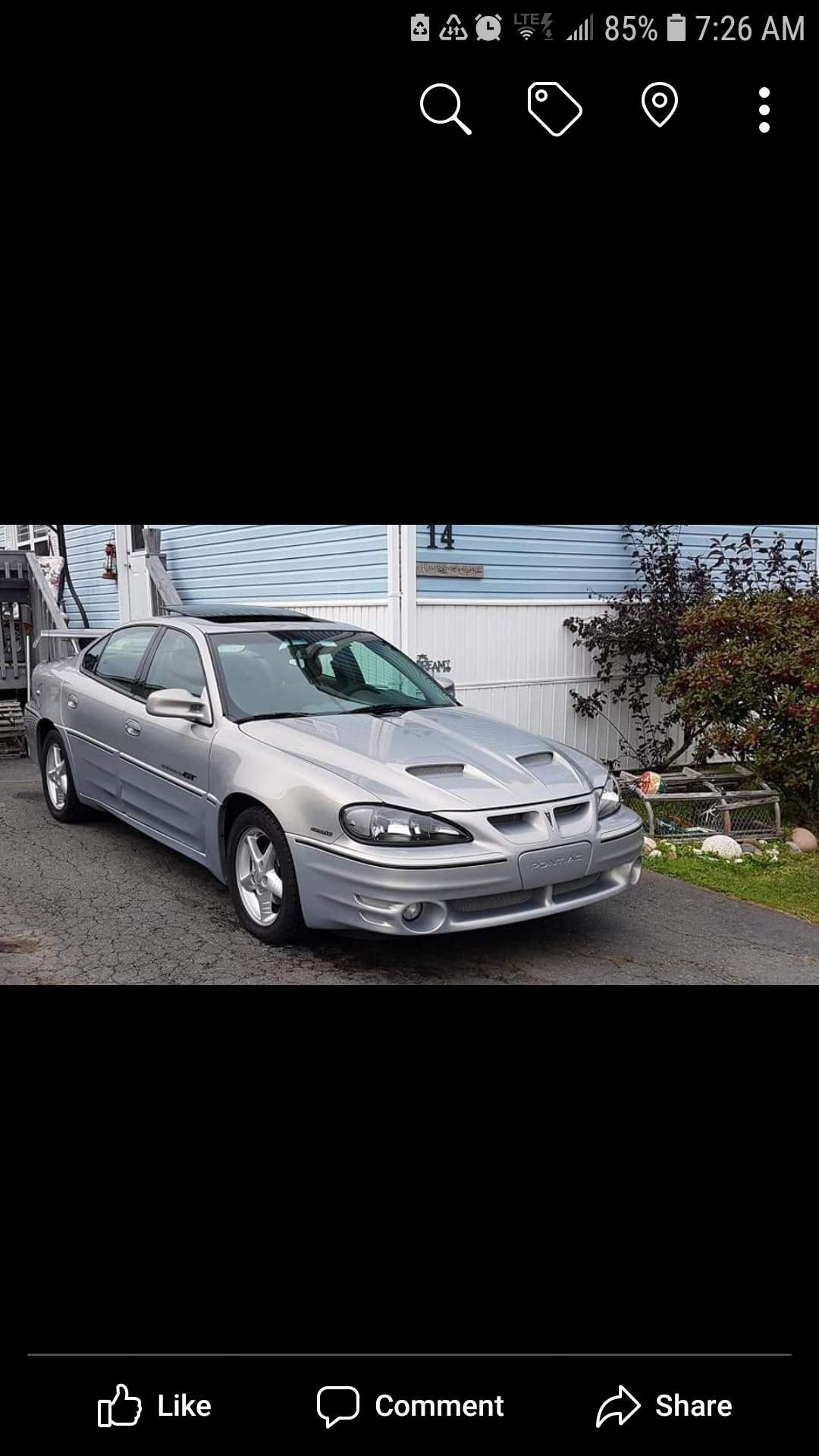

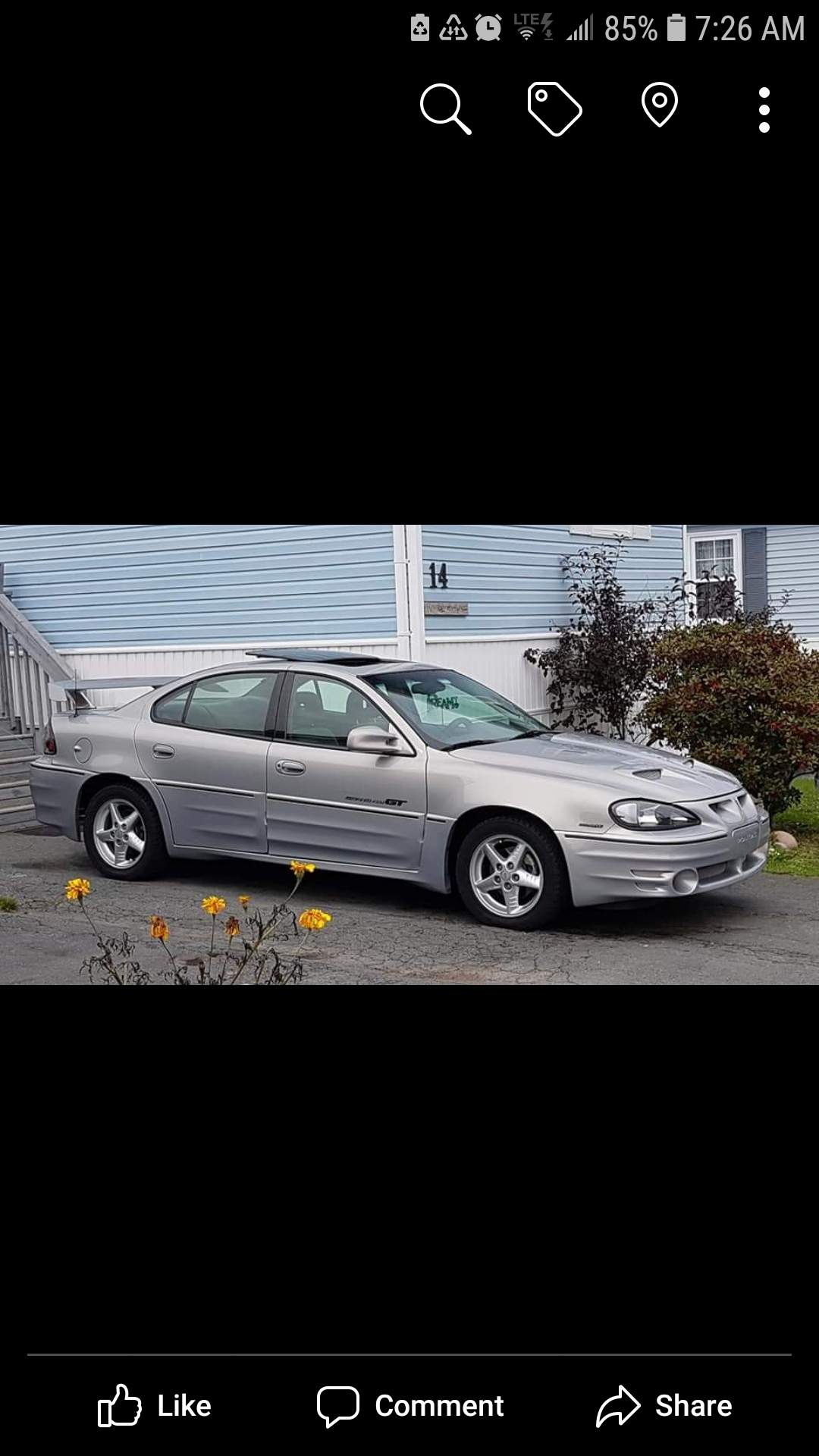

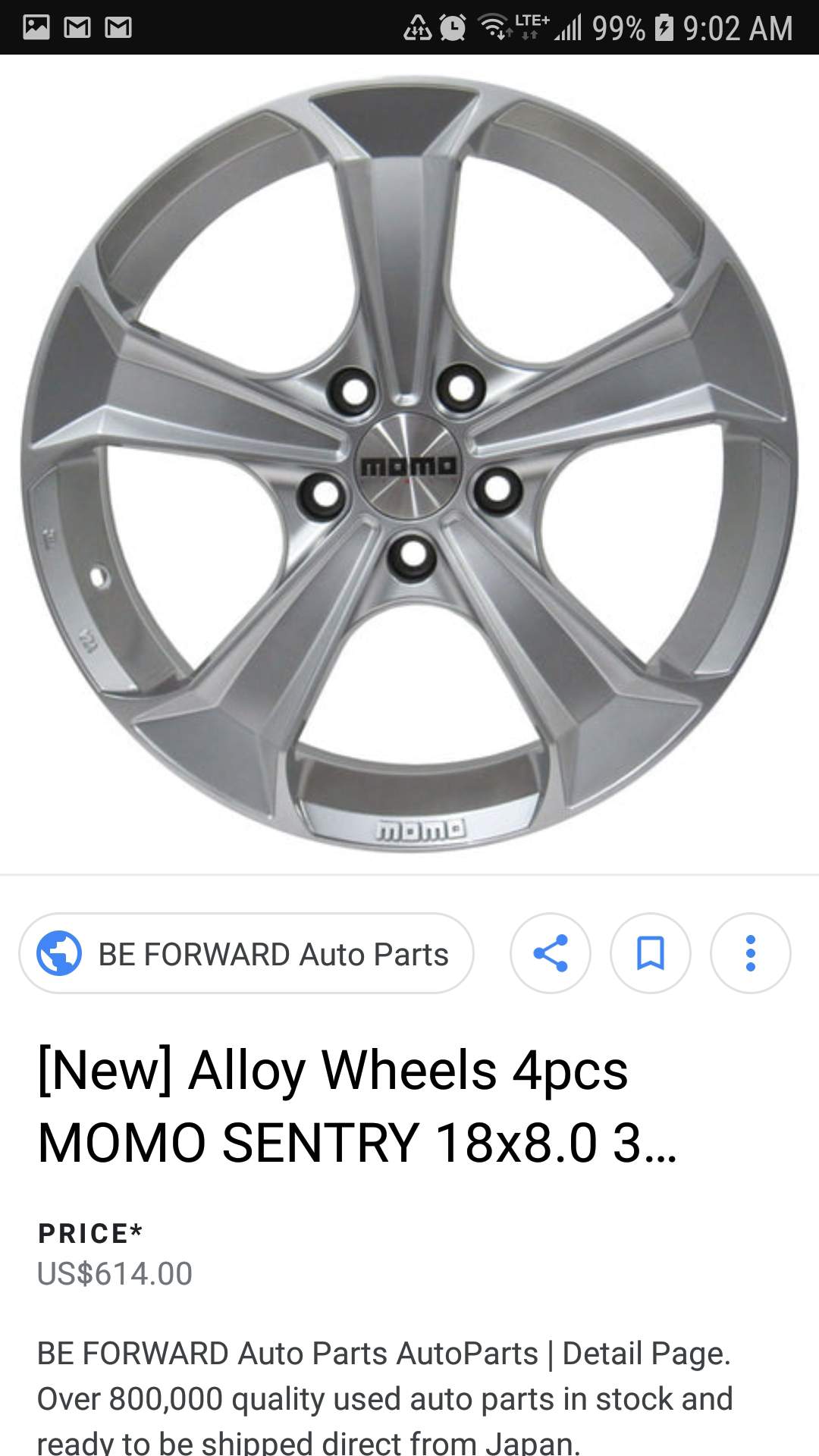

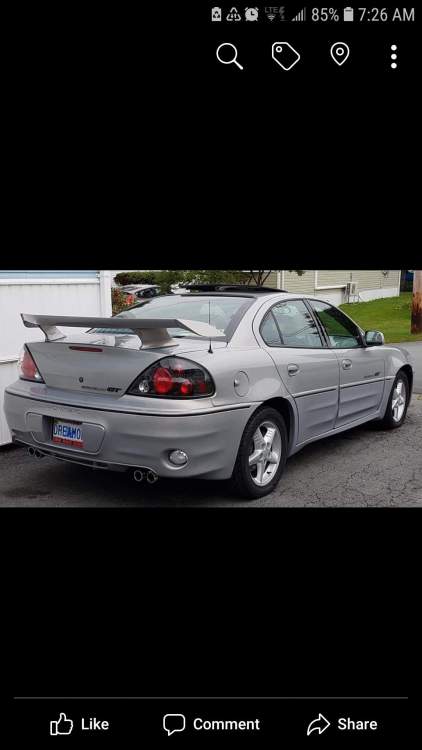

Who here can do a photo chop ??? I want to see a certain 18 x 8 wheel on my stock height car. I can supply a side photo of the car taken at start of this winter. But is shown with smaller 16 inch winter tires and rims and hib caps.
style colour of wheel. Not able to down winter car side shot nor this wheel in the gunmetal colour.
Welcome @DREAMON !
You may wish to share the full photo rather than a screenshot from Facebook. If you click the three dots in the top right of your phone, you should have an option to download/save the actual image to your phone then upload here :)
