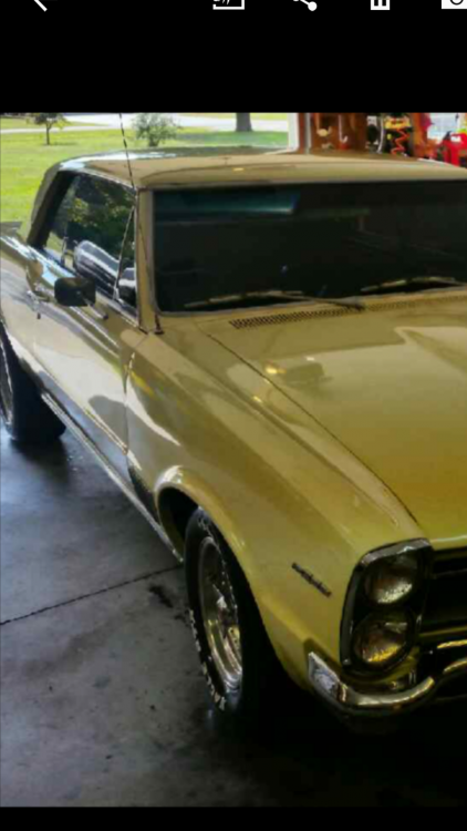

Needing to know what HEADERS(ceramic chrome.ones that will stay best show quality ) to put on a Pontiac 400 engine I'm building to go in my 1965 Pontiac Lemans
Any preference on custom exhaust would be appreciated as well.  Thank's in advance. ..tom
