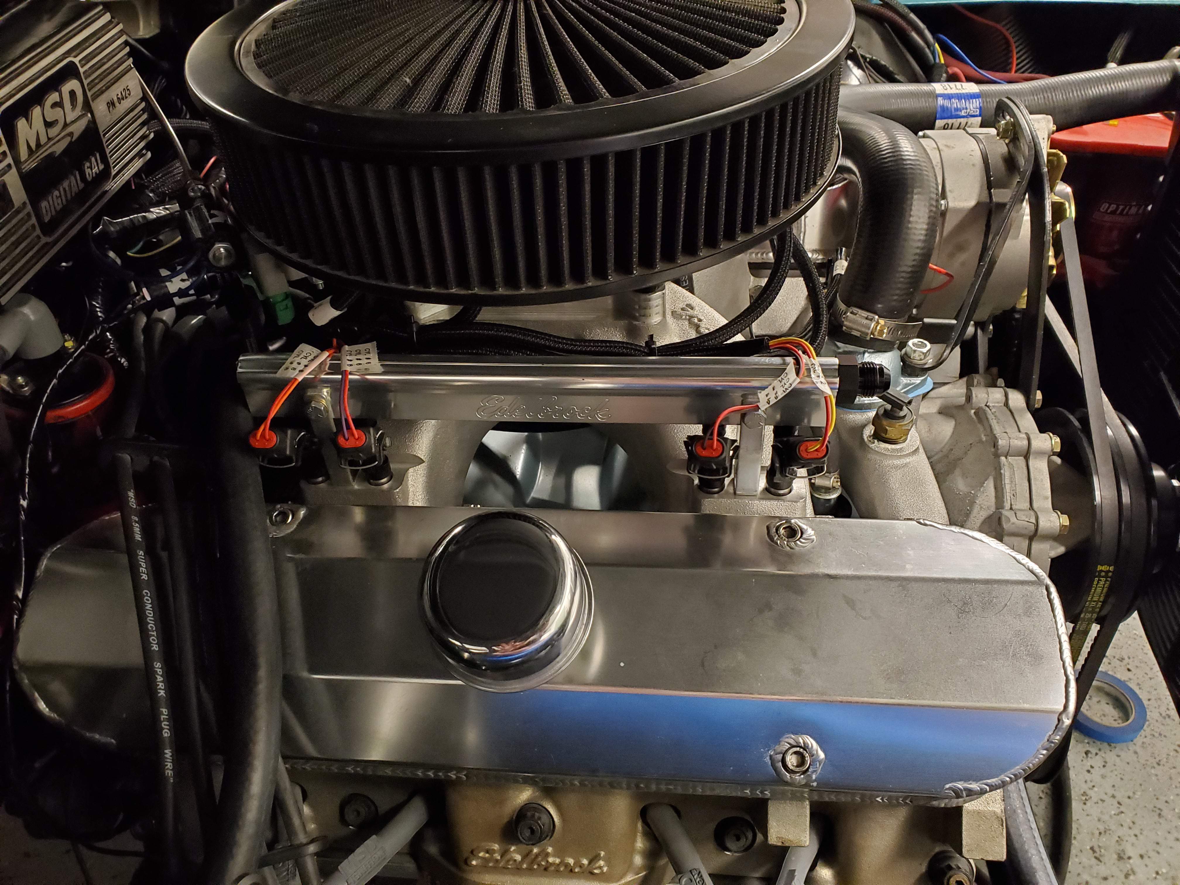

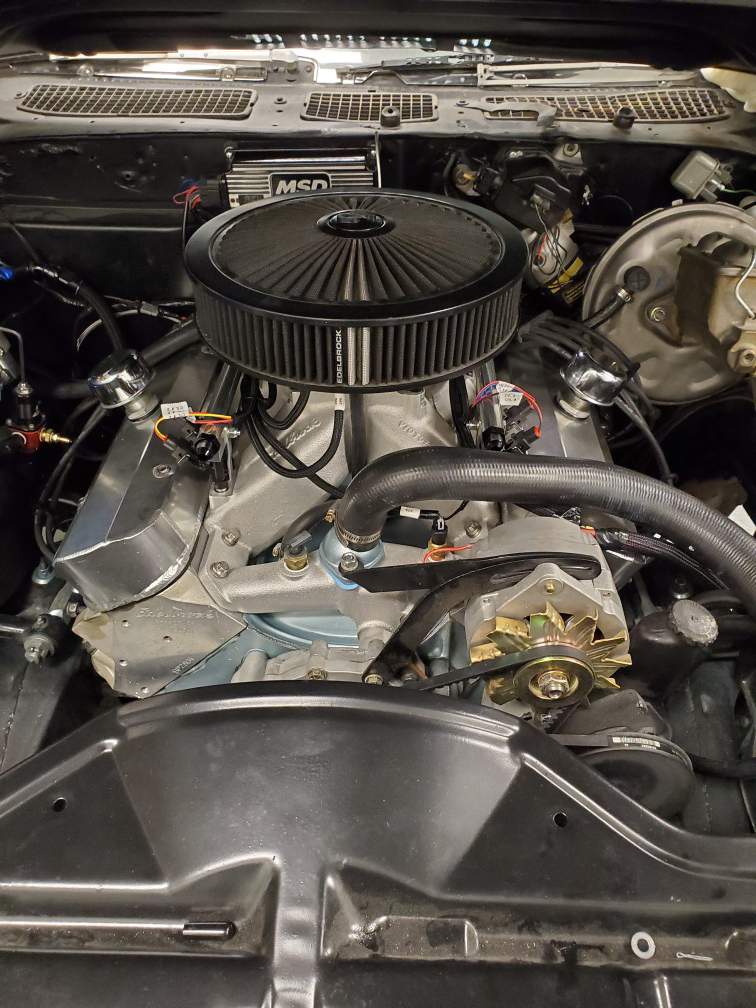

I finally got my Holley hp efi up and running and it's like a totally different car! I will never run a carb again ever! So much smoother under all driving conditions its unbelievable how much better it's running. I still have some tuning to do and I want to get it on a dyno to see what the power level is and also set up the nos properly.

Glad your happy, I spent a lot of time as SEMA talking to the guys at Fitech and they just didn't have the features I needed. My car makes a bit more power then some and I wanted the ability to really fine tune it and the Holley HP system controls my Nos system too.
Made 504hp and 540lbs to the ground on the dyno and 605hp and 650lbs on the nos to the ground.
