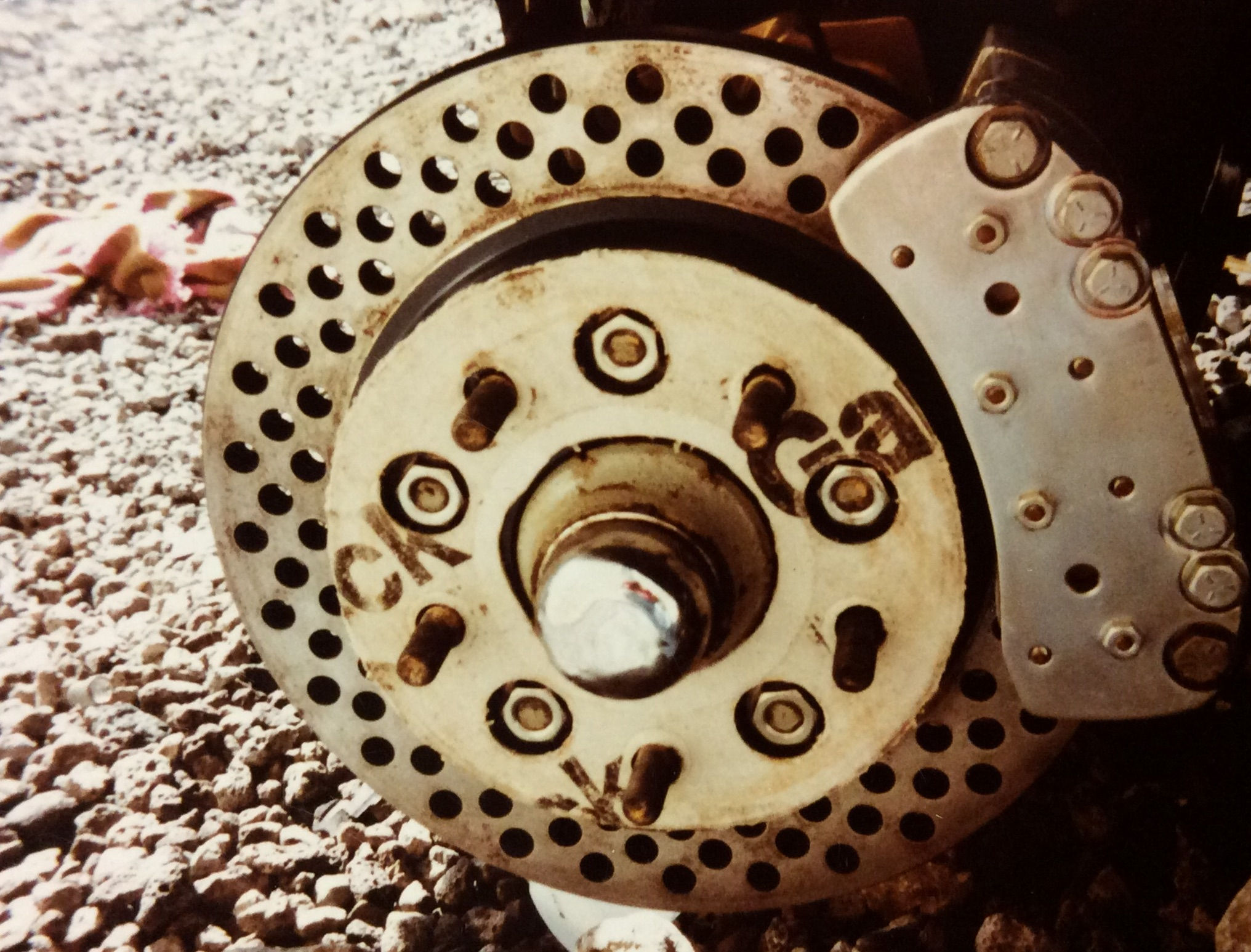

So what can be done? Ventilating the rotor in some manner helps with out gassing. Depending on how the rotors are ventilated can help both out gassing and aid cooling of the rotors and pads, which can minimize out gassing. Changing the rotor material to say C1018 hot roll steel with say FE pads will Change the coefficient, help stop better, run cooler and wear less. If they’re ventilated the system will be even better. The variables are endless.  My custom made set of brakes for my “69” Z were C1018 rotors that were cross drilled ventilated. The pads were .2 coefficient pads which I don’t think you can even get today. The calipers were three piston calipers set in double shear. This system was incredible! It was like throwing a boat anchor out. The car would just flat stop, no sliding, no skidding and the first time I took the car out to test them I stopped 100 feet short of the red light, no kidding! This system used special silicone fluid. These pads and rotors and fluid saw more than 110,000 miles with out a single maintenance need. This system was installed in 1979 and stayed on the car till it was sold in 2004 with half of the original pad material left and no real obvious wear on the rotors.

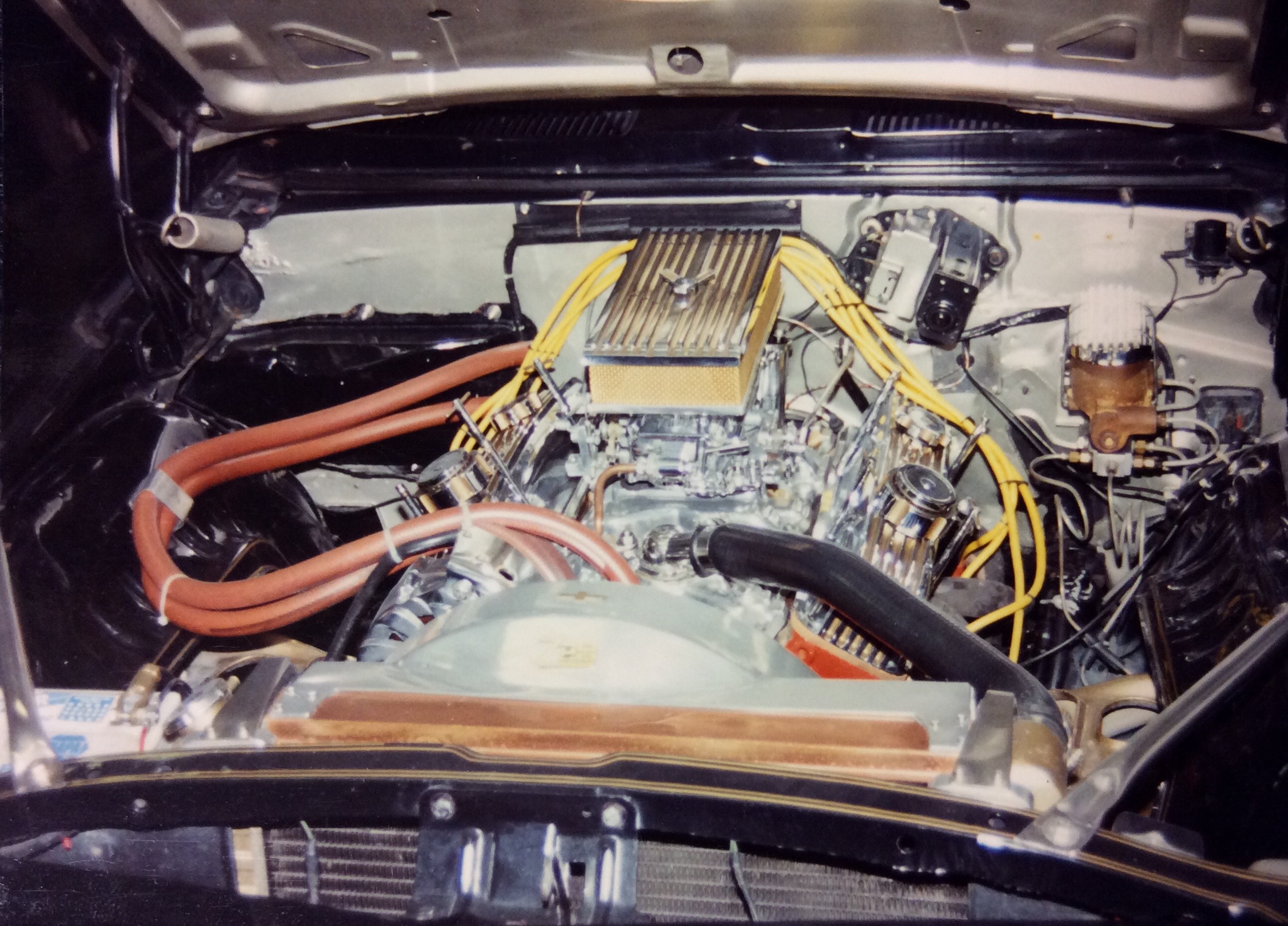

I ran no check valves in the master cylinder. I ran no proportioning valve and the junction block under the master cylinder that used a shuttle piston to alert you for front or rear brake loss was changed to just a aluminum junction block.
