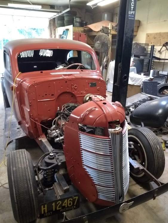

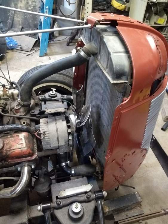

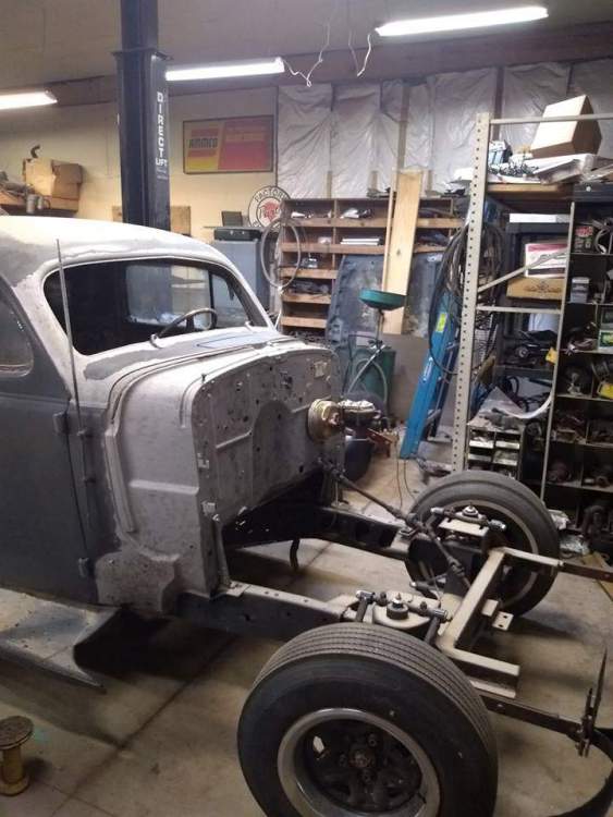

Stock 350/350 from a 79 van. Had to finagle the bottom radiator hose and trim the fan blades to keep the engine low in the chassis. I didn't want to cut the firewall or transmission tunnel.

Wouldn’t an electric fan have been easier? Or is there not enough real estate for one between the water pump pulley and the radiator ?
Link to comment
Share on other sites
I don't think it would have been easier, certainly take more time.  trying to get to the hold downs on the back of the radiator would be a BIG pain in the butt.  All I did was scribe the blades with the calipers, cut them on a bandsaw and bolt it on. no wiring or thermostatic switch. I didn't want to try and push the retainers through that 81 year old heater core style radiator either. If cooling becomes a problem or I decide to go with more performance, I might have to switch over to electric or go aluminum radiator.

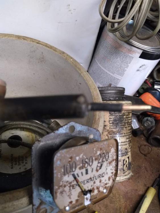

A can of starting fluid, free no needle syringe from a pharmacy, sending unit off a salvaged cheapo gauge and miscellaneous stuff laying around and now I have a working 81 year old gauge that was chopped out of a car and thrown into a box of dash parts!

That's great work. Truly hot rodding ingenuity at it's finest.
Now that the gauge works, do we know if it works correctly and/or reasonably accurately?
  • Like 1
Link to comment
works exactly as it should, and I only had to move it a few degrees to match my candy thermometer at 200. They used ether when it was built, so my using ether didn't change expansion rate or accuracy. And I could have suffered with a few degrees off knowing I spent $5 instead of $250! :)

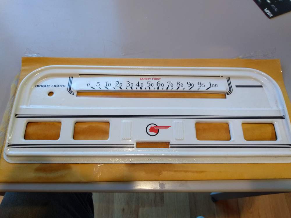

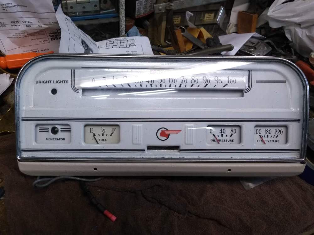

I have new cluster decals, so soon it will look completely restored and work!

Excellent work my friend. Gawd I love doing things on "the knew" and on the cheap.
So where did you come up with the new cluster decals? Does some one commericially self them or you know someone who could make them up special for you ?
Link to comment
I asked someone that I found on the internet. Turned out to be a really nice guy and told me who he bought his from on E-bay. I contacted the seller and he listed one for me. How or where he came up with them, I have no idea. Just happy to get them!

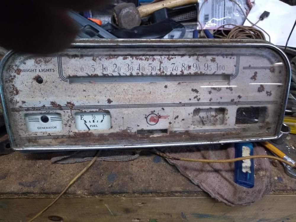

Hold onto that seller's contact info. You never know when someone else may need it. Got a picture of the completed gauges or cluster yet?
Link to comment

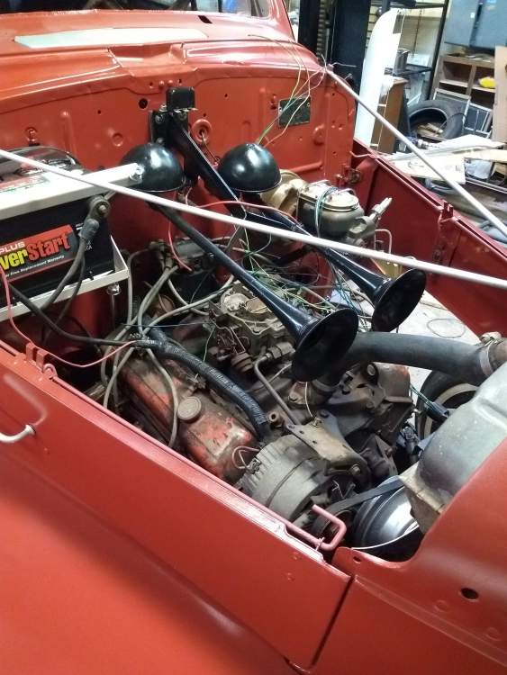

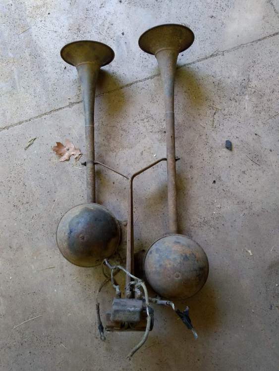

been working on the original horns. All fixed up and LOUD! back to the body panels now. Just needed some completion motivation!
Link to comment
That cluster restoration is amazing dude! That almost looks like porcelain in these pictures. The horn looks really neat.
Excellent job my friend.
