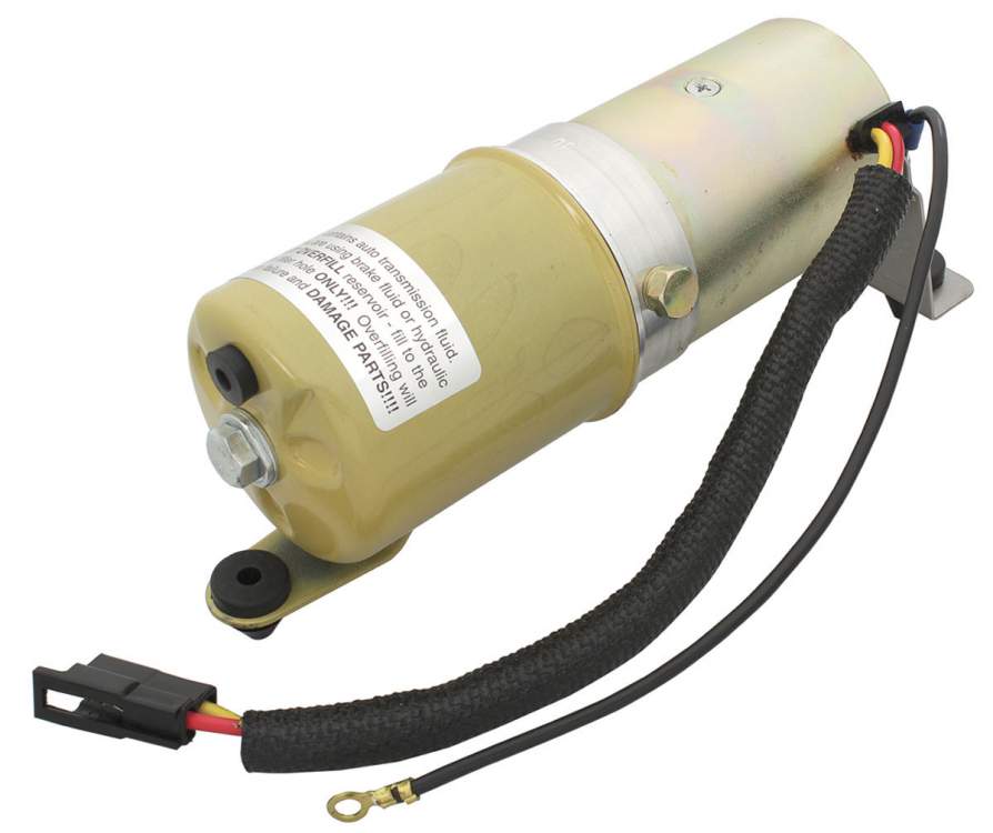

Changing the convertible motor is fairly easy but not cheap ($220-$350 depending on where you get it). Getting in and out of the trunk is a serious pain in the butt (for me at least). The motor is mounted by 3-4 screws on rubber isolation mounts at the back of the trunk. Crawling inside the trunk is the easiest way to get to it. There are two hydraulic line going to/from the pump. You will want to catch that fluid or it will leak all over.
Visually check your lines. If there is not a lot of fluid in the lines, you may have a leak, which you will have to fix once you know where it is leaking from.
On the picture below, note the rubber grommet at the left. This is what you remove to add transmission fluid / hydraulic fluid using the ketchup bottle method I mentioned earlier.
Be sure to test your switch too.

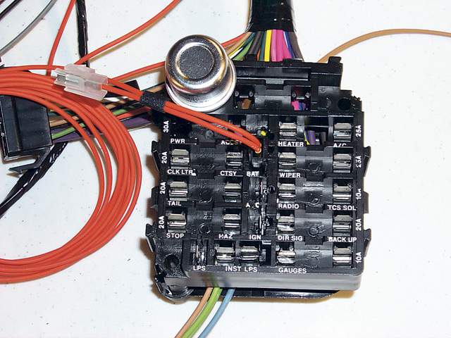

One last thing, check your fuses. The top runs off the Power Accessory 30A fuse. The top plugs into the fuse panel. Make sure it is plugged in. In the diagram below, the red wirie is plugged into one of three locations between the left and right bank of fuses. This is where your top's power wired should be plugged into.

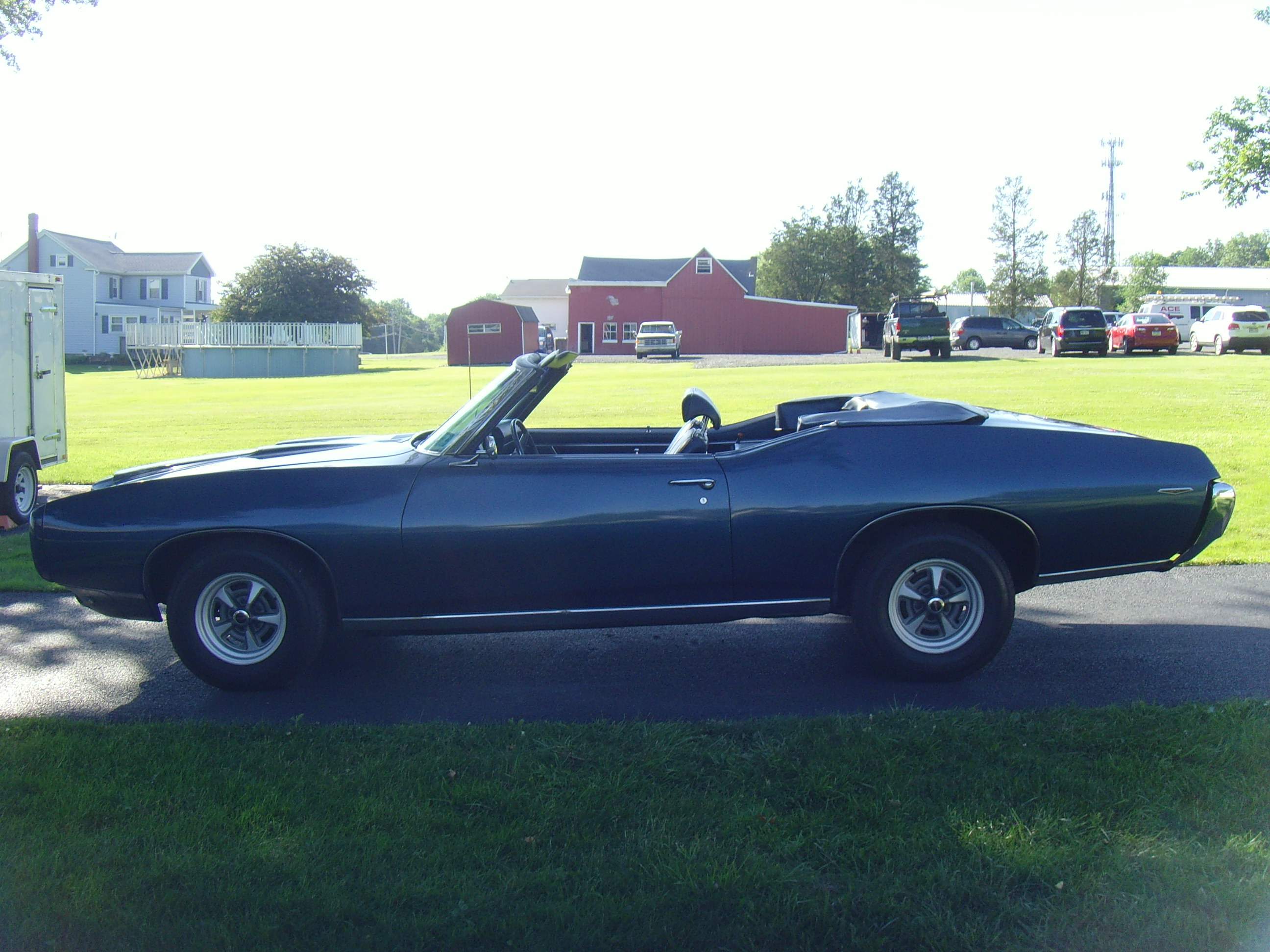

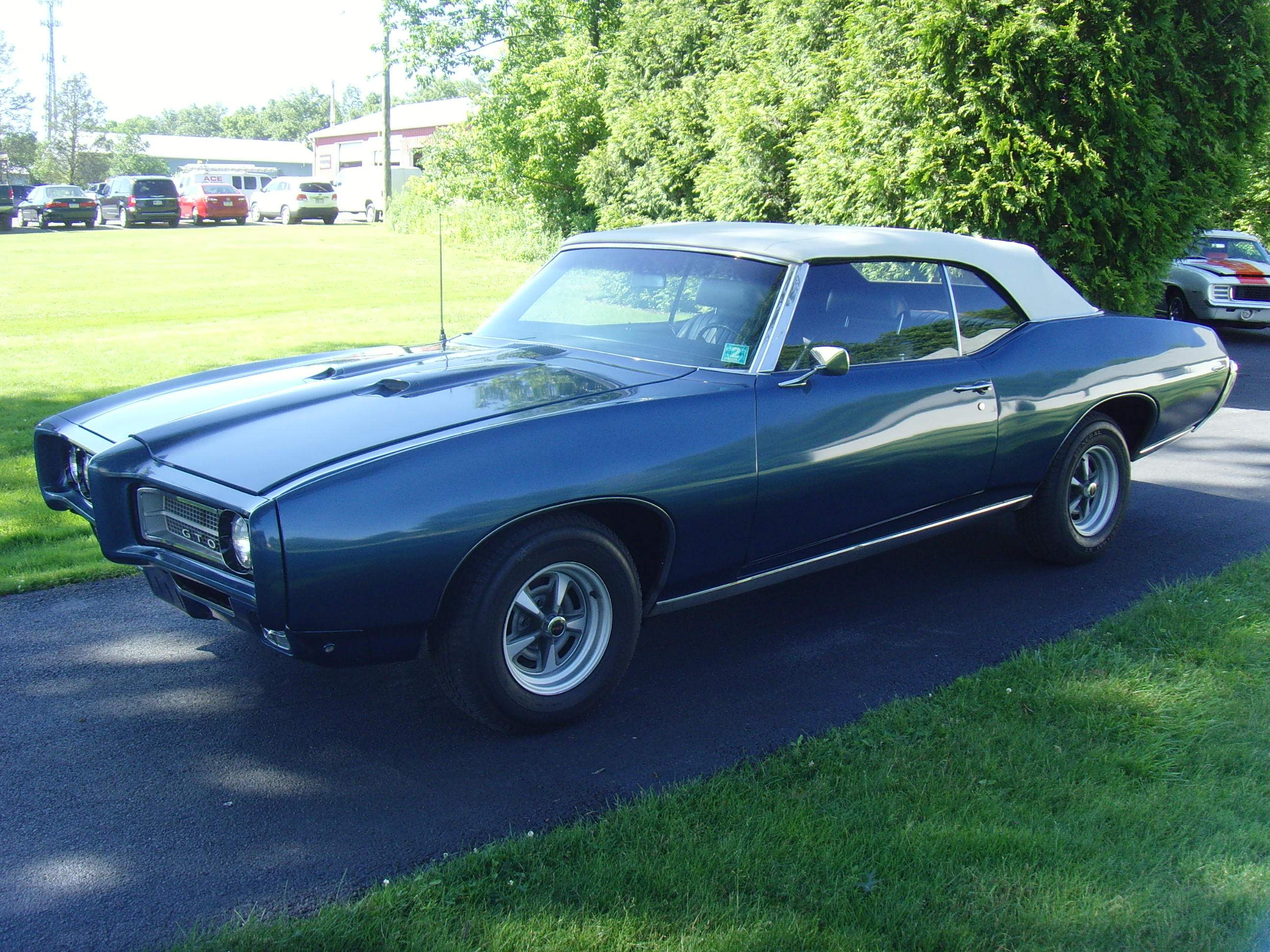

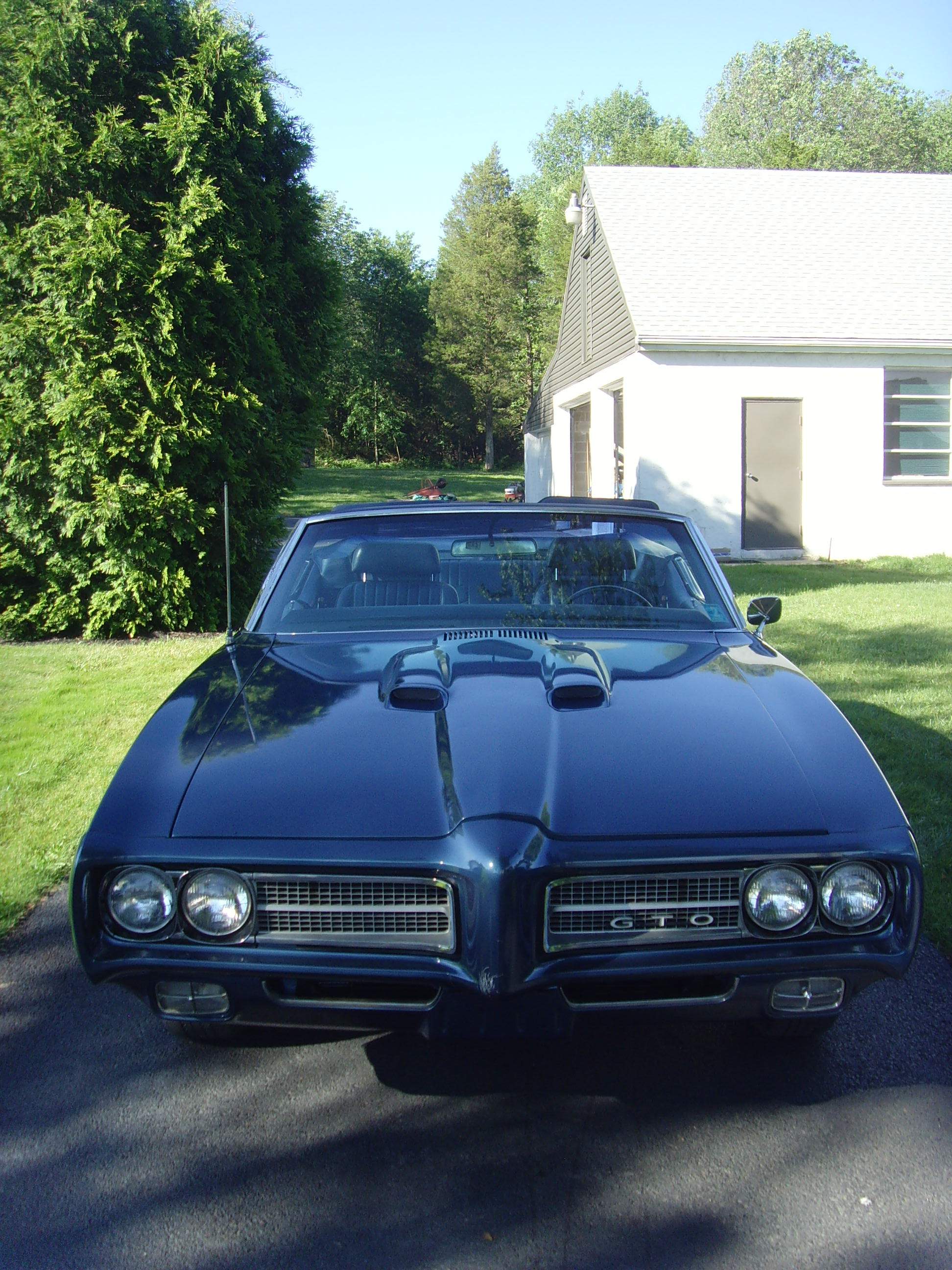

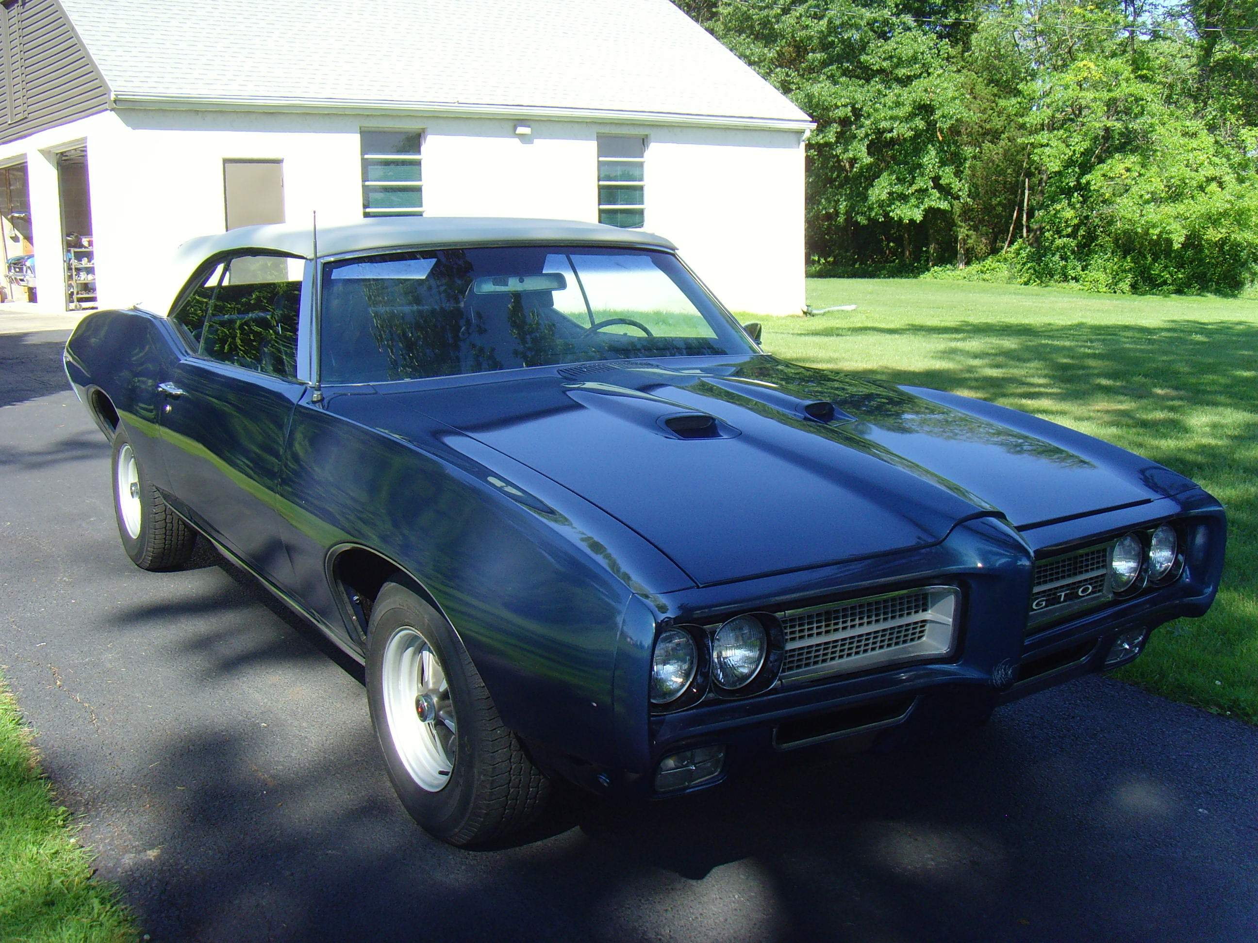

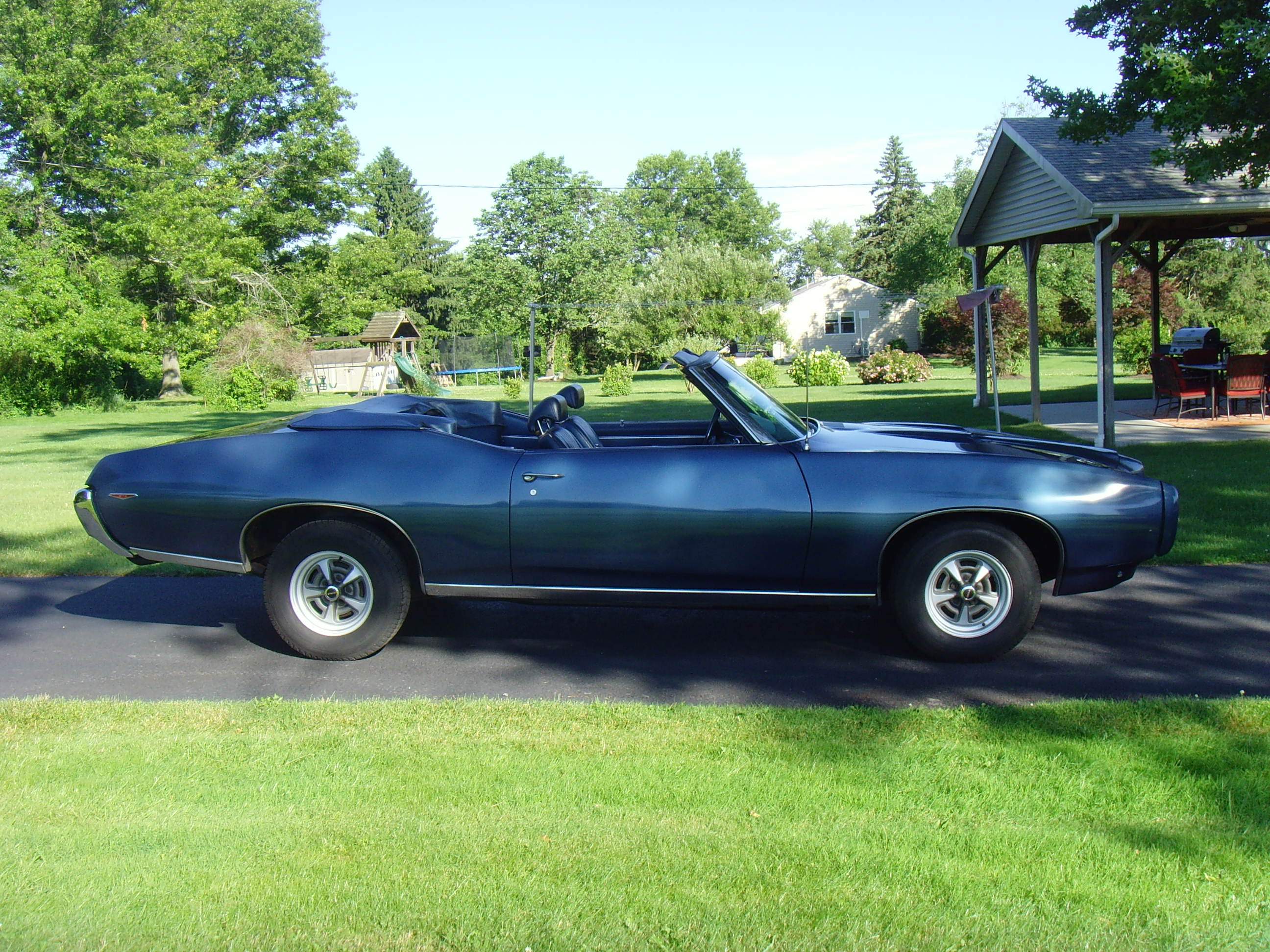

Thanks for sharing the pictures. She looks great!
Was the squealing from the tires or perhaps one of the engine belts?
Share this post
Link to post
Share on other sites
  • 0
Thank You.       Good question. It sounded like the tires, but could be a belt......I did put new belts on. Will have to check to see if they are tight.
Thanks for the heads up.

This is the fun part.

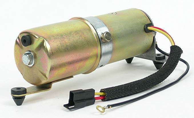

You need to remove the black plug at the top left of the picture. This typically takes a flat head screw driver, needle nose pliers, and your fingers. The pump is located in the trunk, on the trunk shelf behind the spare tire. It is usually hidden by your canvas top protector. You may have to empty the trunk and crawl inside to get to it.

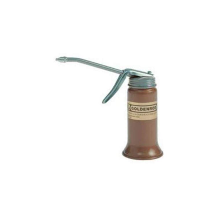

Use some sort of oil can squirter or small ketchup bottle filled with transmission fluid to fill the reservoir of the pump until its full and reinsert the plug. Run the top again. Check your hoses for air bubbles. Keep doing this until you eliminate most of the air bubbles or you can't fill it up anymore. Cycle the top several times up and down.
One last word of caution. I know this seems like a pain  (and it is). Pull the bottom of your back seat out and your trunk mat out before you doing anything else. See if you have any hydraulic fluid leaking. If you do, it will collect either in the trunk or under the rear seat. If it is leaking, you will need to fix the motor, lines, or rams (whatever is leaking) before you can bleed the system again.
I know this from personal experience since I am currently going thru this with Lucy. One of the new lines to the passenger side ram won't tighten up enough to seal properly. Right now I have removed the two bolts to the rams in order to open and close the top manually so I can still enjoy the car.
