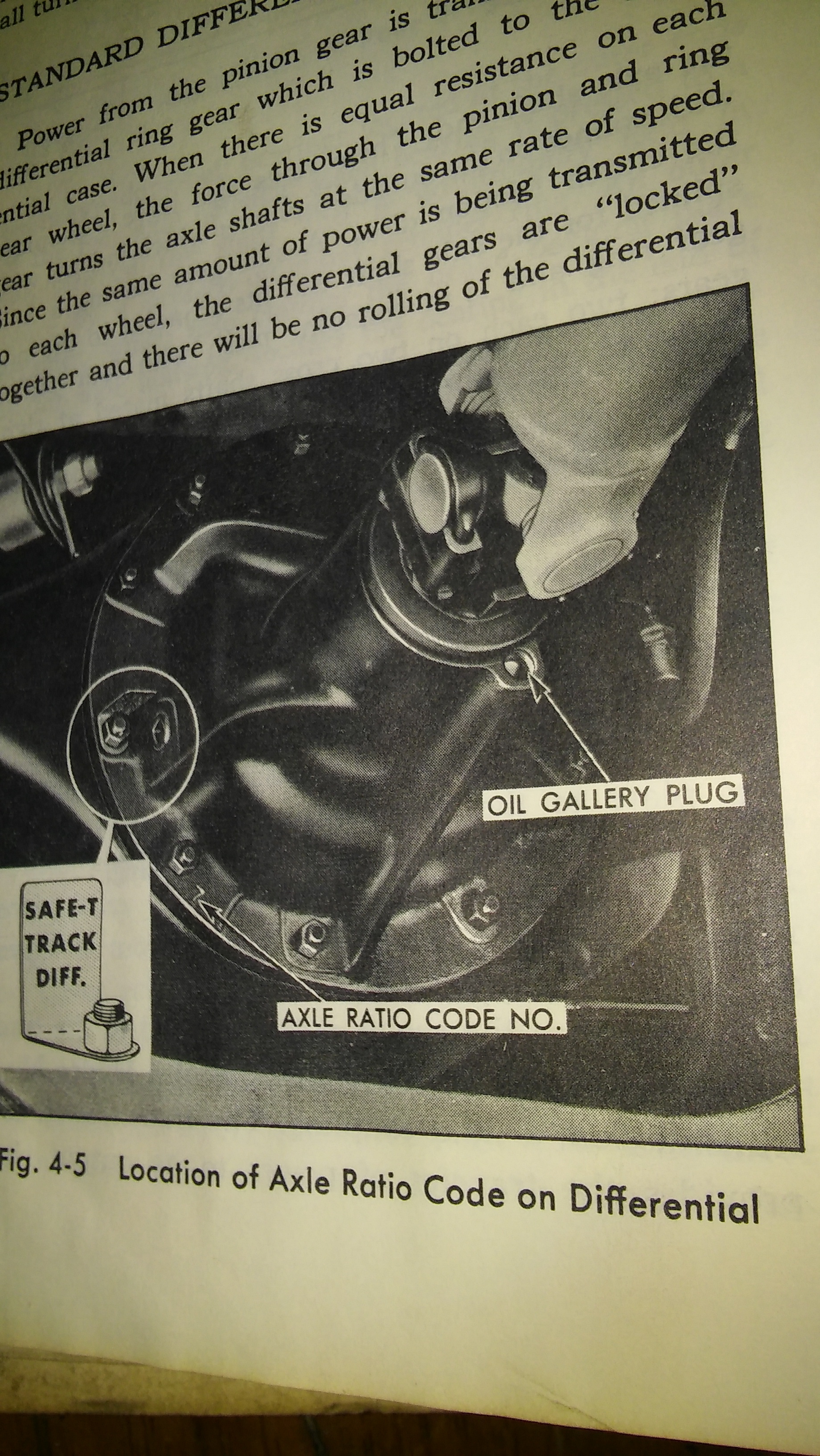

OK just rolled under there again and can find no numbers stamped on the housing. I do not think that it has been changed as it still has the lock tabs on the u joint u bolt nuts and no one ever put those things back on. While it is still up in the air I might soak it with cleaner and pressure wash it in case the stamping is faint and I missed it.

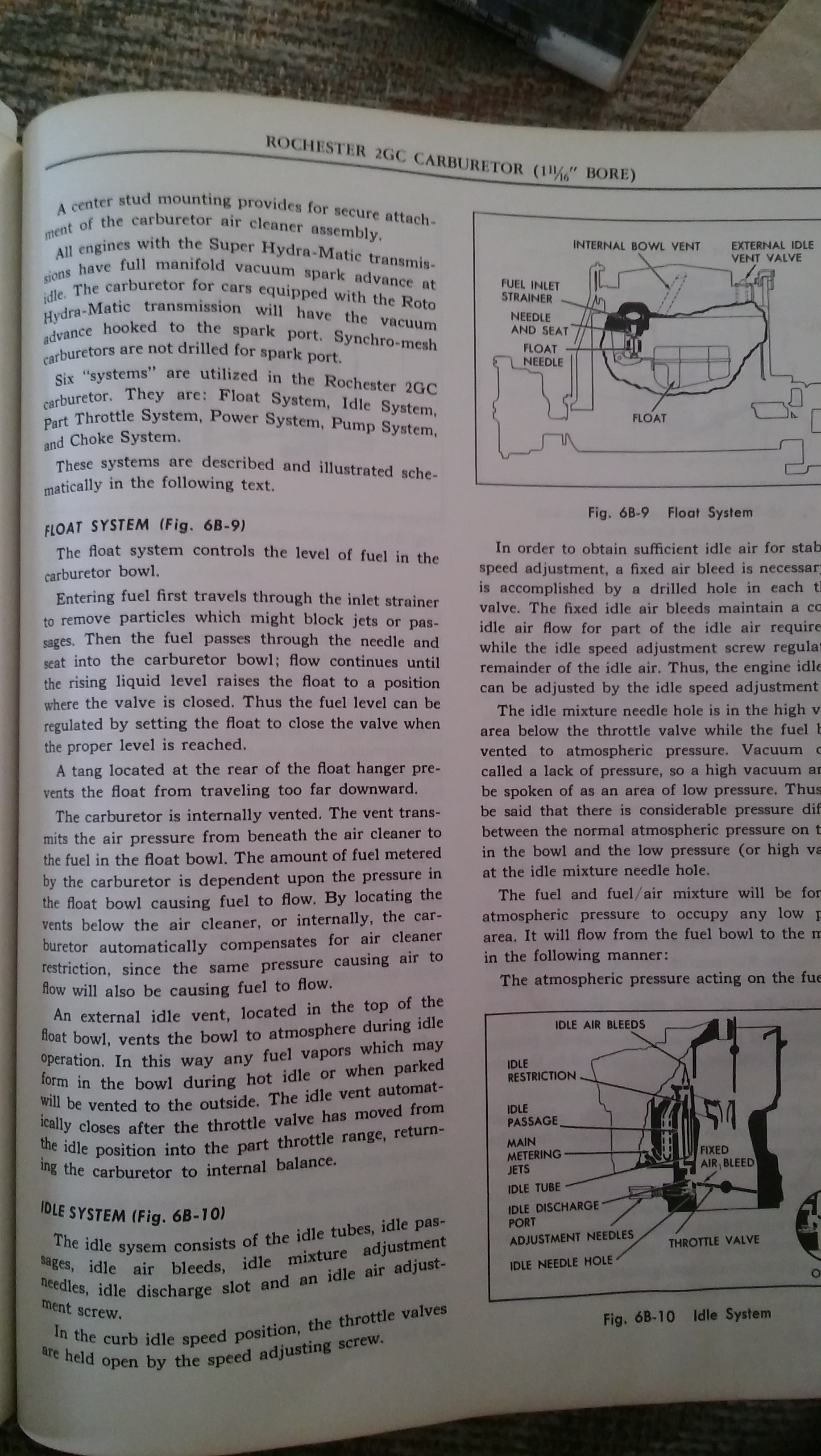

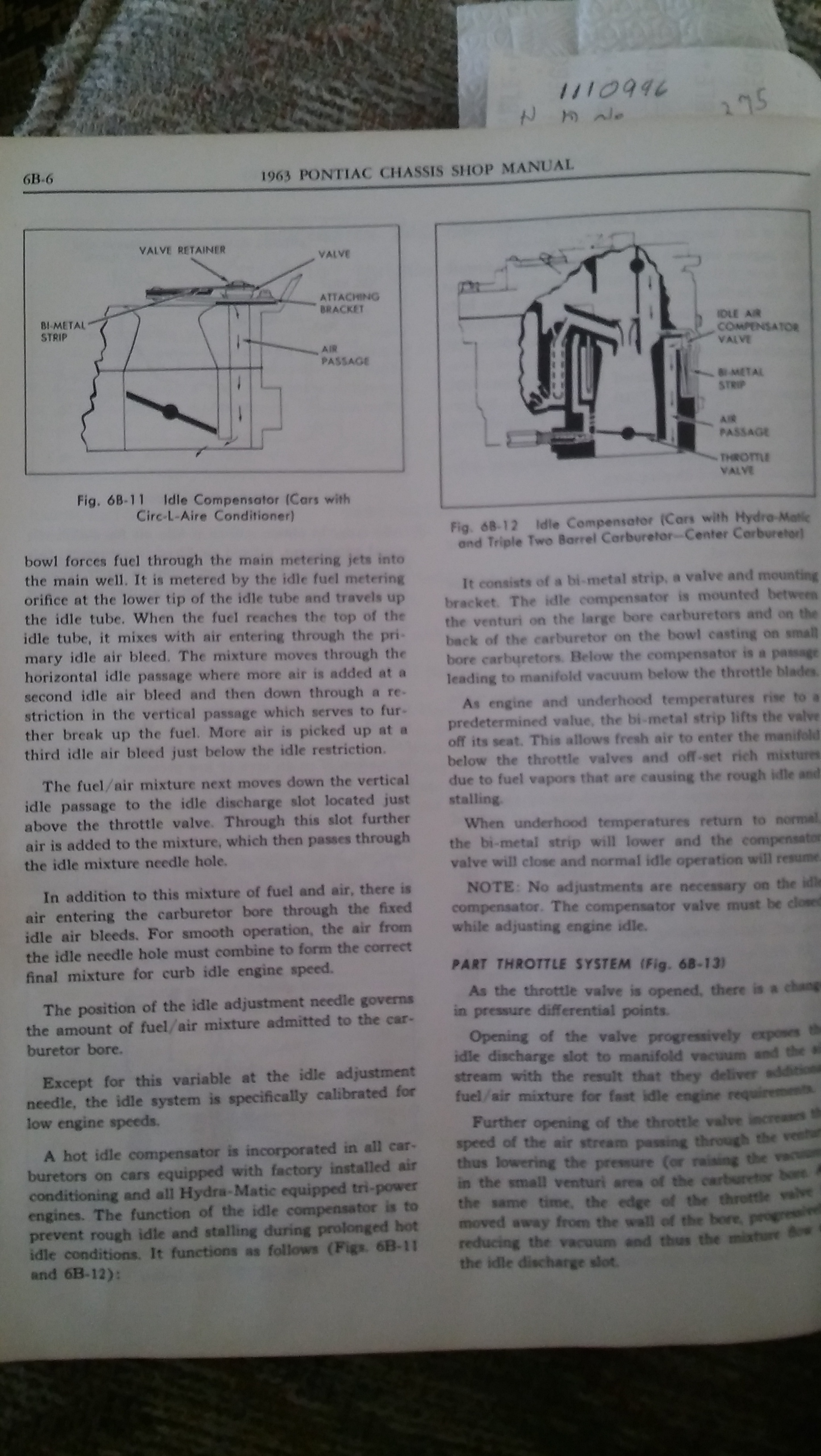

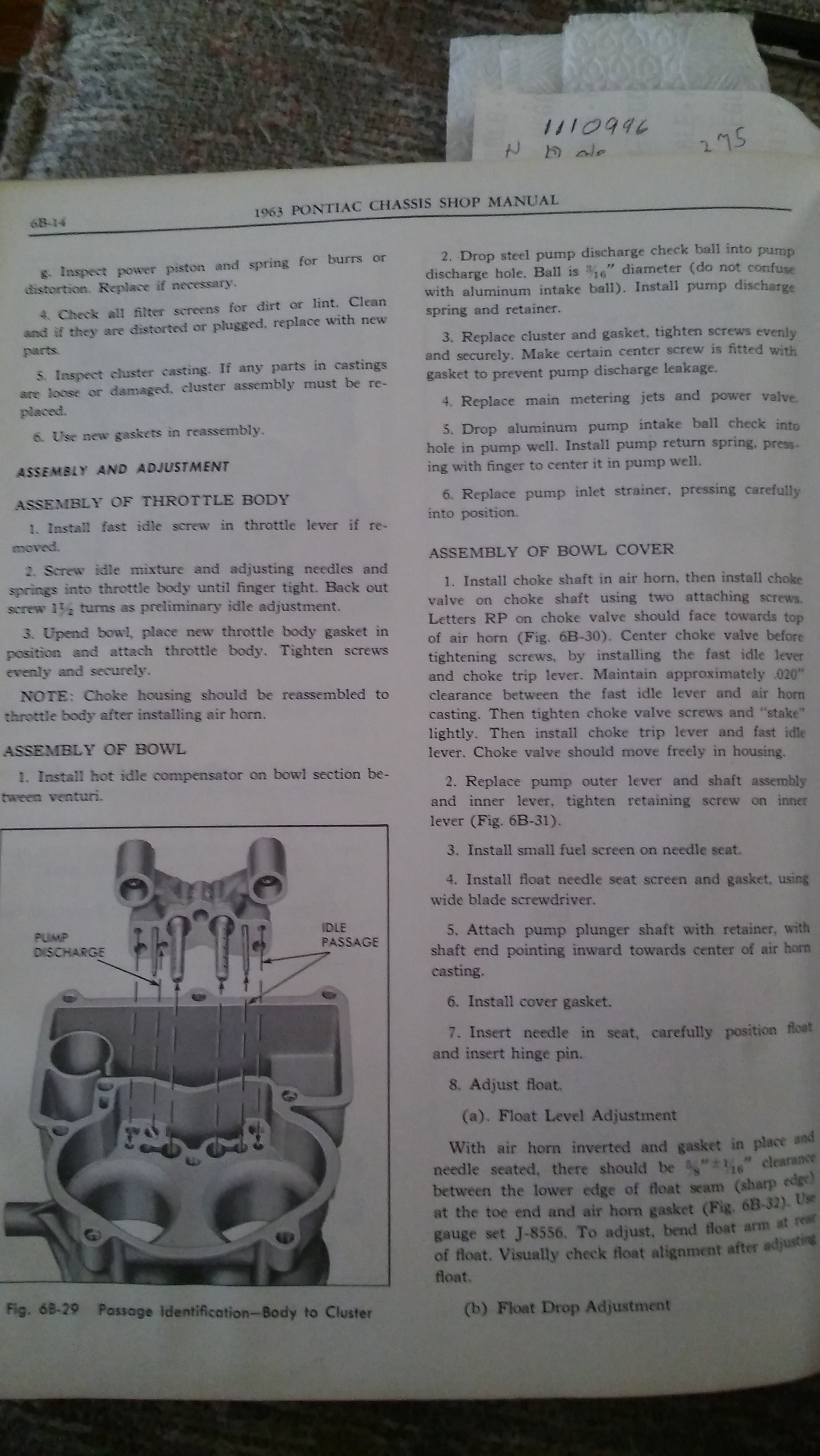

Old Guy,

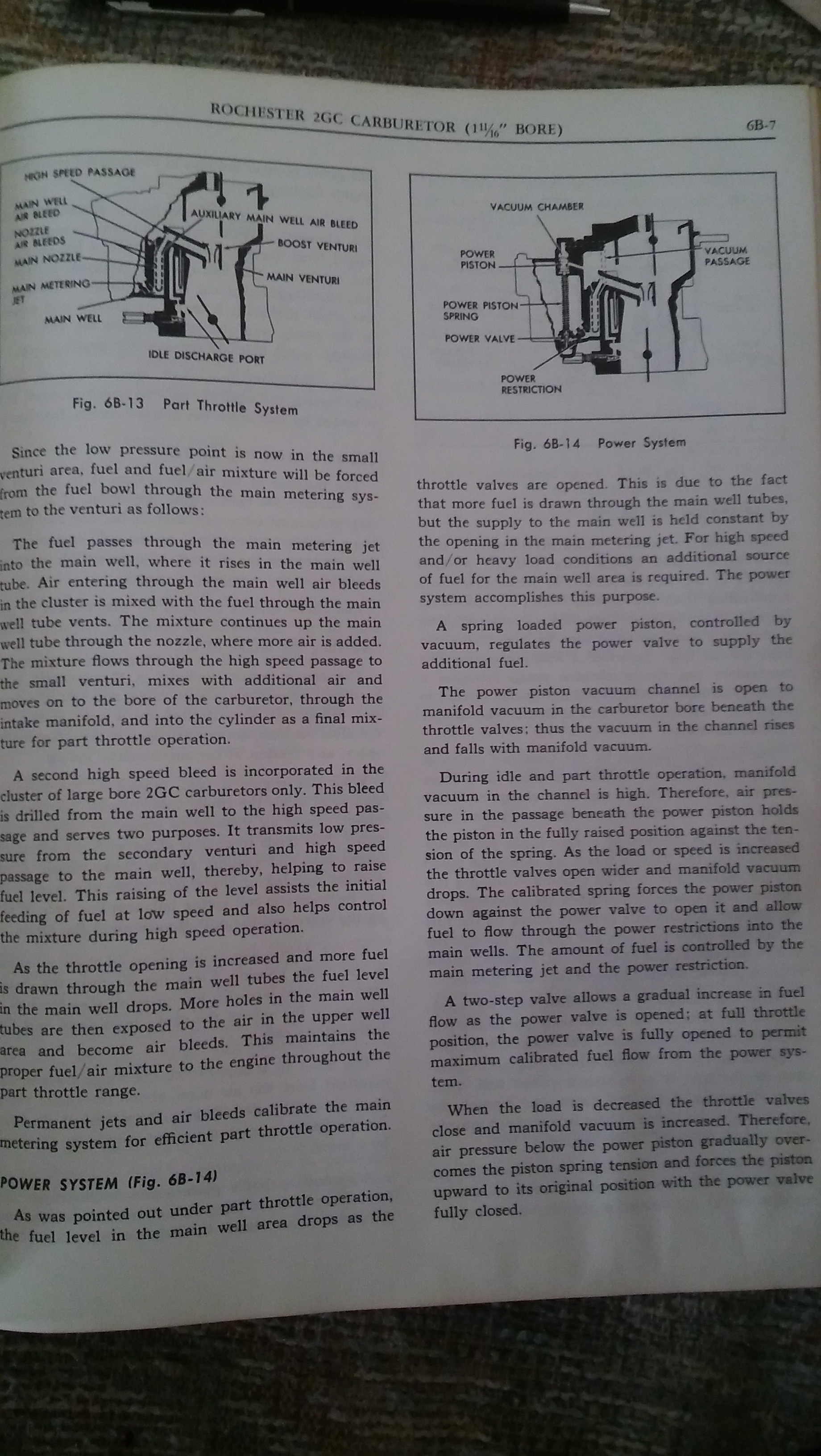

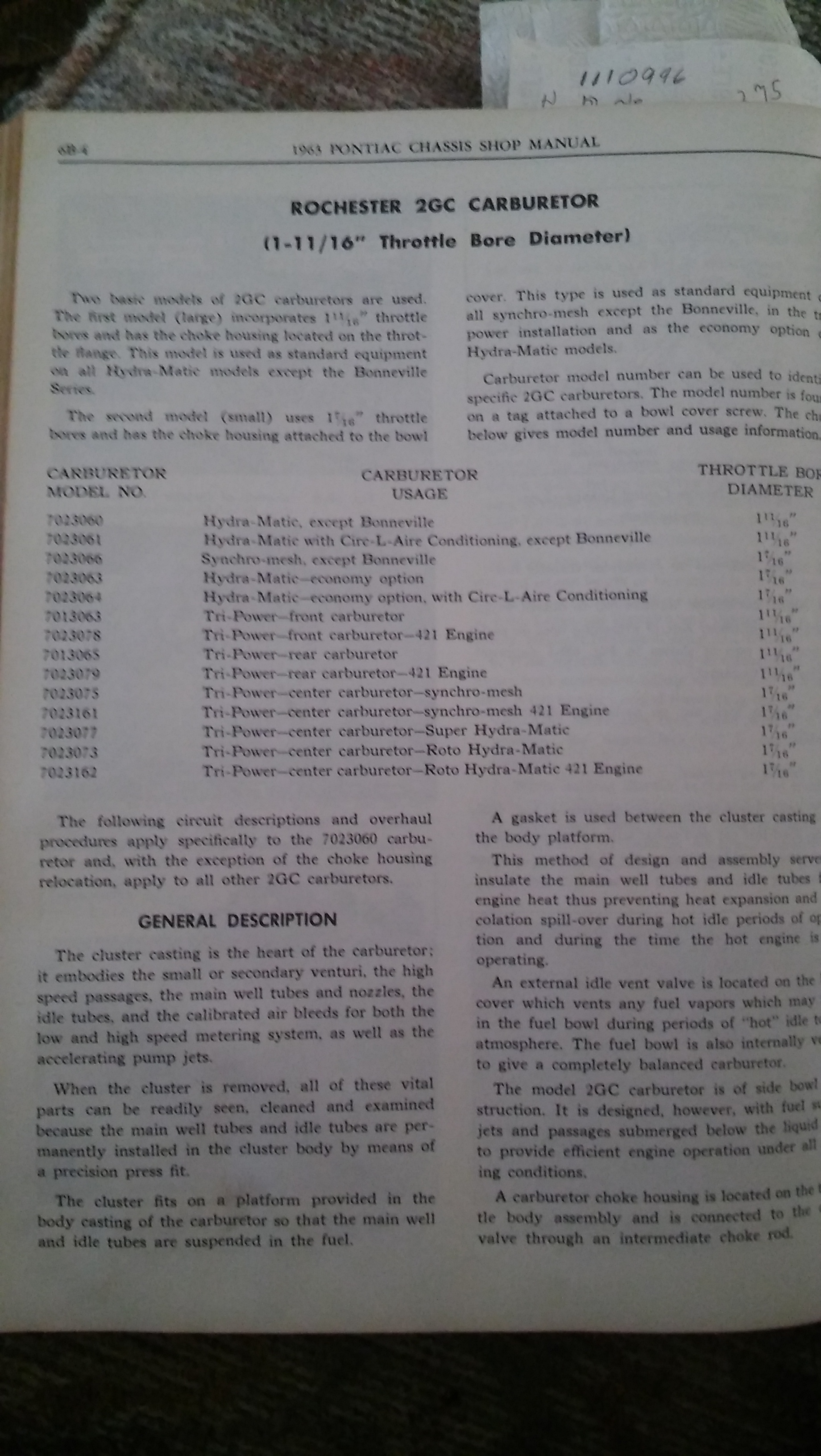

Hope you can see the details in these photos. Took them with my phone sometimes it doesn't do so well. This manual is the one actually put out by Pontiac Motor Division..So I'm 100% sure it is accurate. Got it from my dads immense automotive library 40 some years ago.
Edited by TWO LANE BLACK TOP
Link to comment

Did not see anything in that location but will take a closer look tomorrow, right now I am putting my beat up body to bed.

OK crawled back under and took one of those tooth brush size wire brushes and cleaned the area. The stamping is pretty faint but looks like it could be a 2

#2= 2.69 gear ratio...Not having good day..Season opener at local race track tonight..( We are running in NASCAR Modified Division ) Had car out on track for final tuning..Early This morning was clicking off some really fast laps..Got mixed up with another car.. Went ass end into wall hard..Driver OK.... Car not so good...

2.69 is about what a 3.5 would be with a 700 R4 in overdrive. Sounds like it might all work out for cruising mileage. It should be ok in town also, the trans is geared low enough in 1st gear that even as sour as the engine was running it had good throttle response at stoplights. Frankly better than I ever expected for a two barrel single exhaust engine.

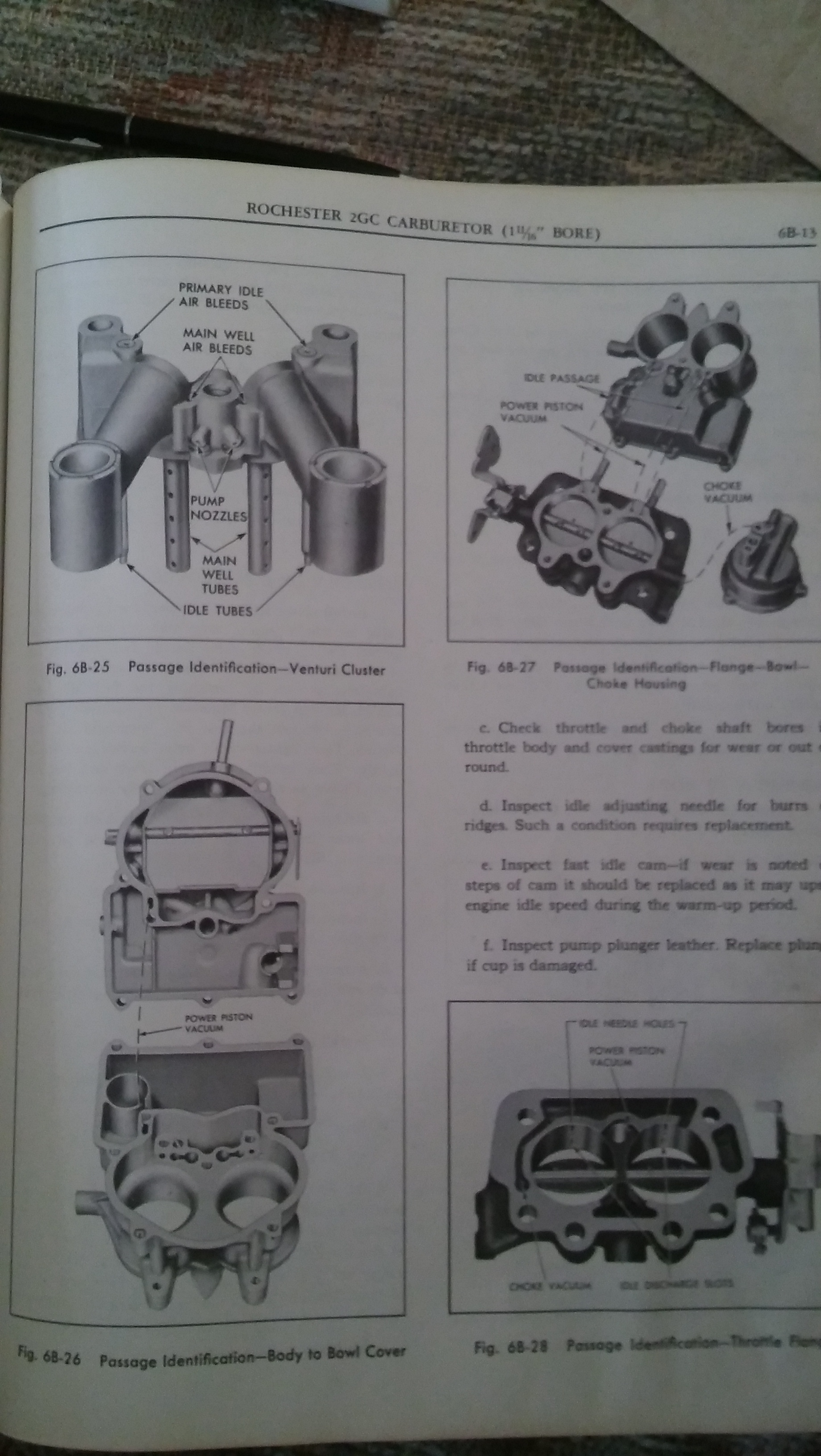

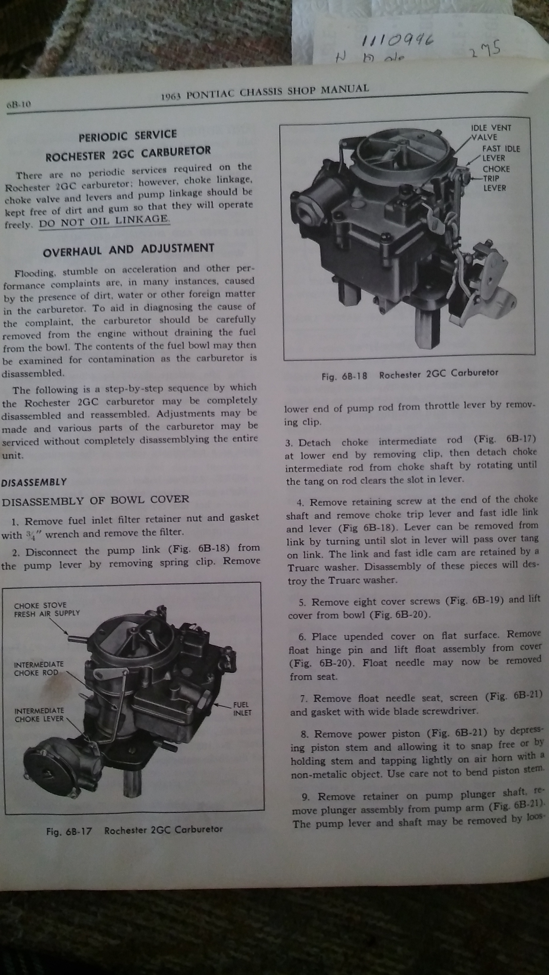

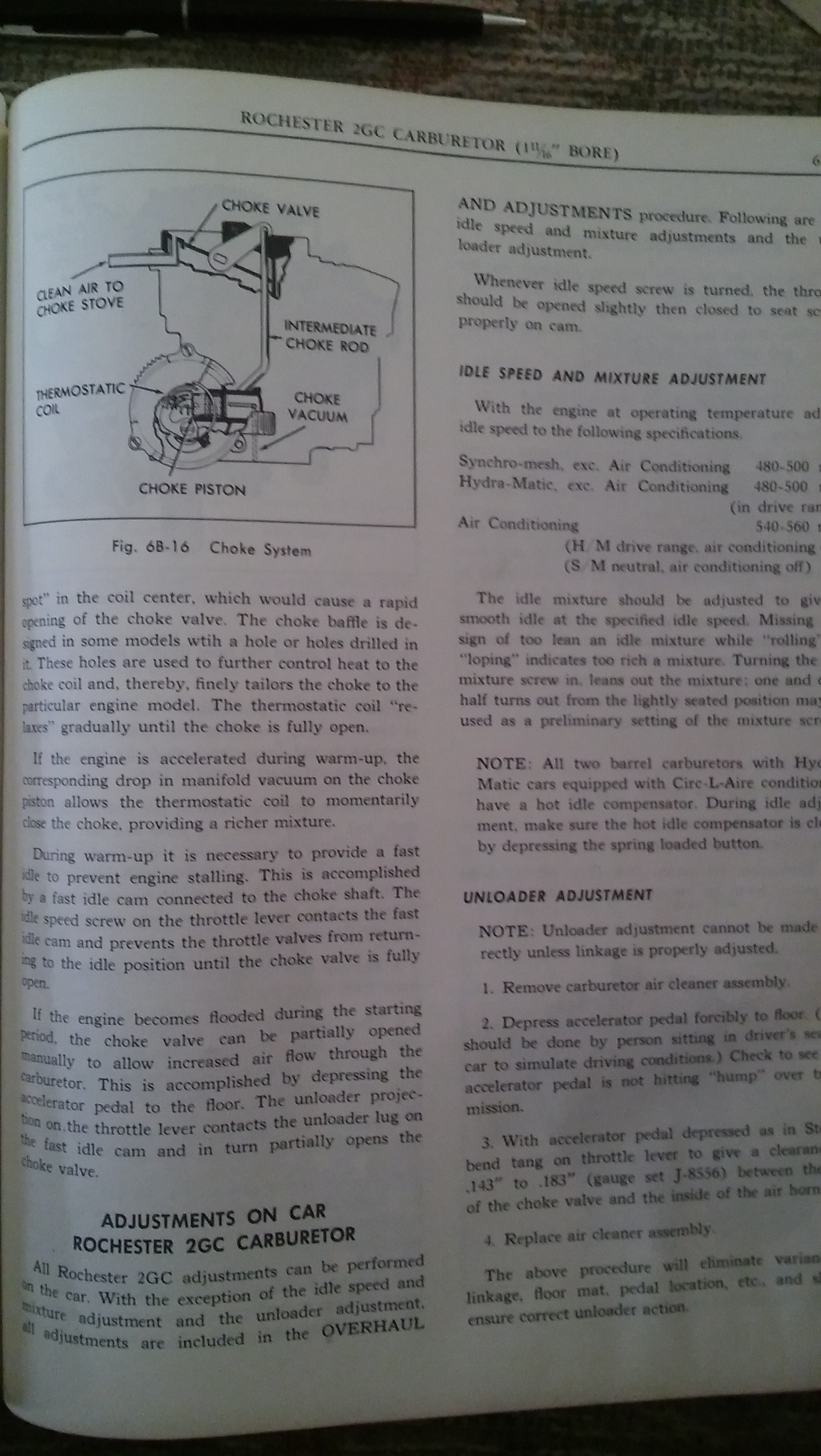

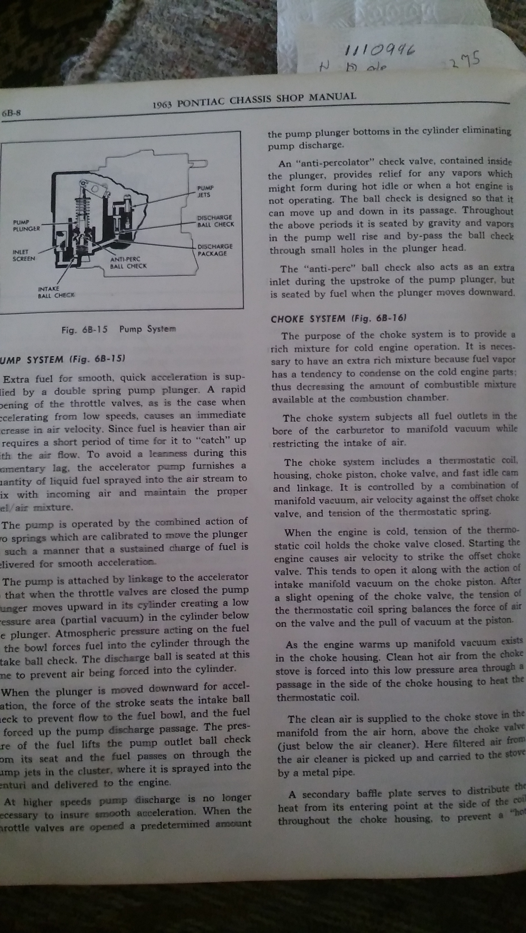

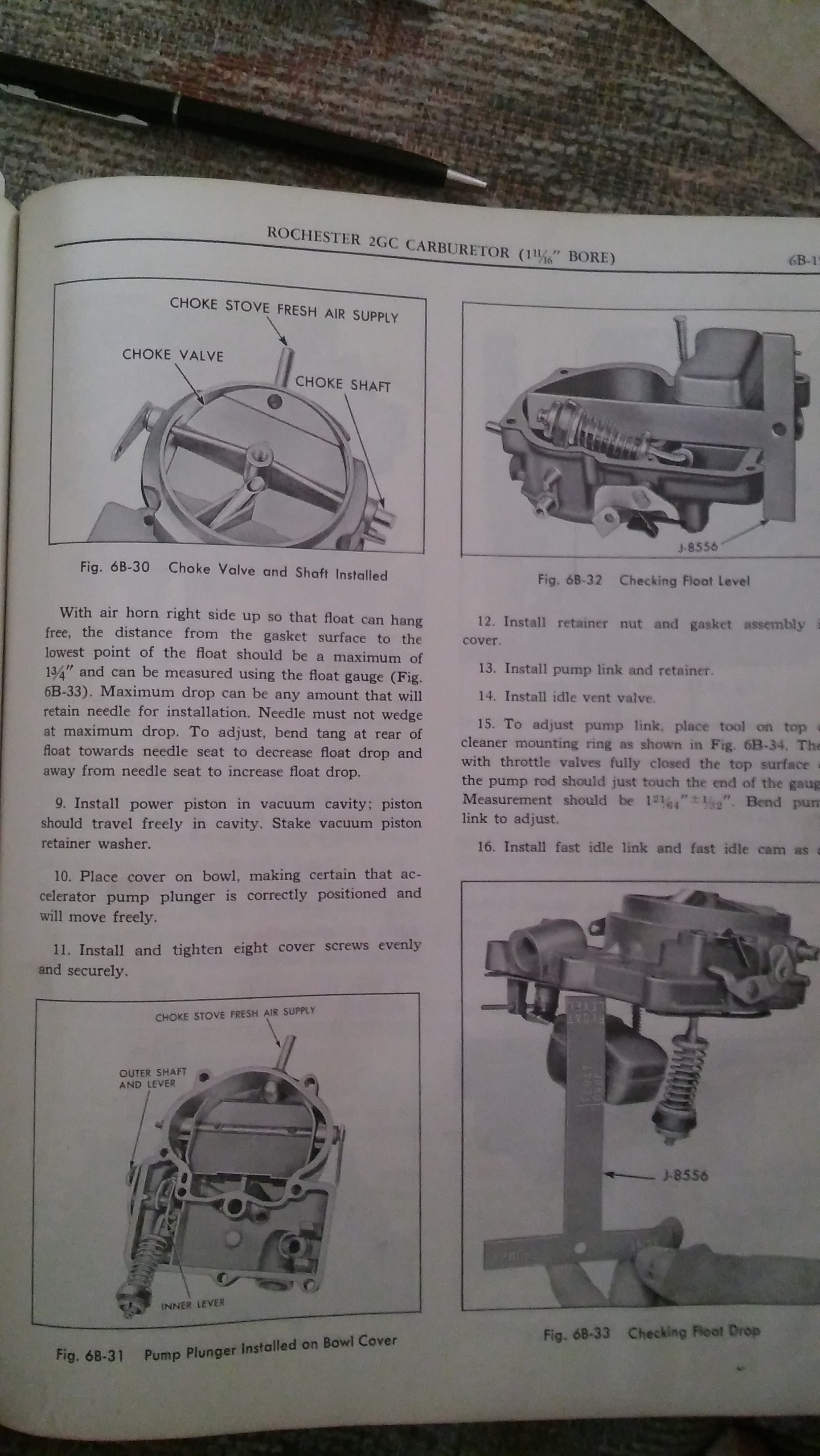

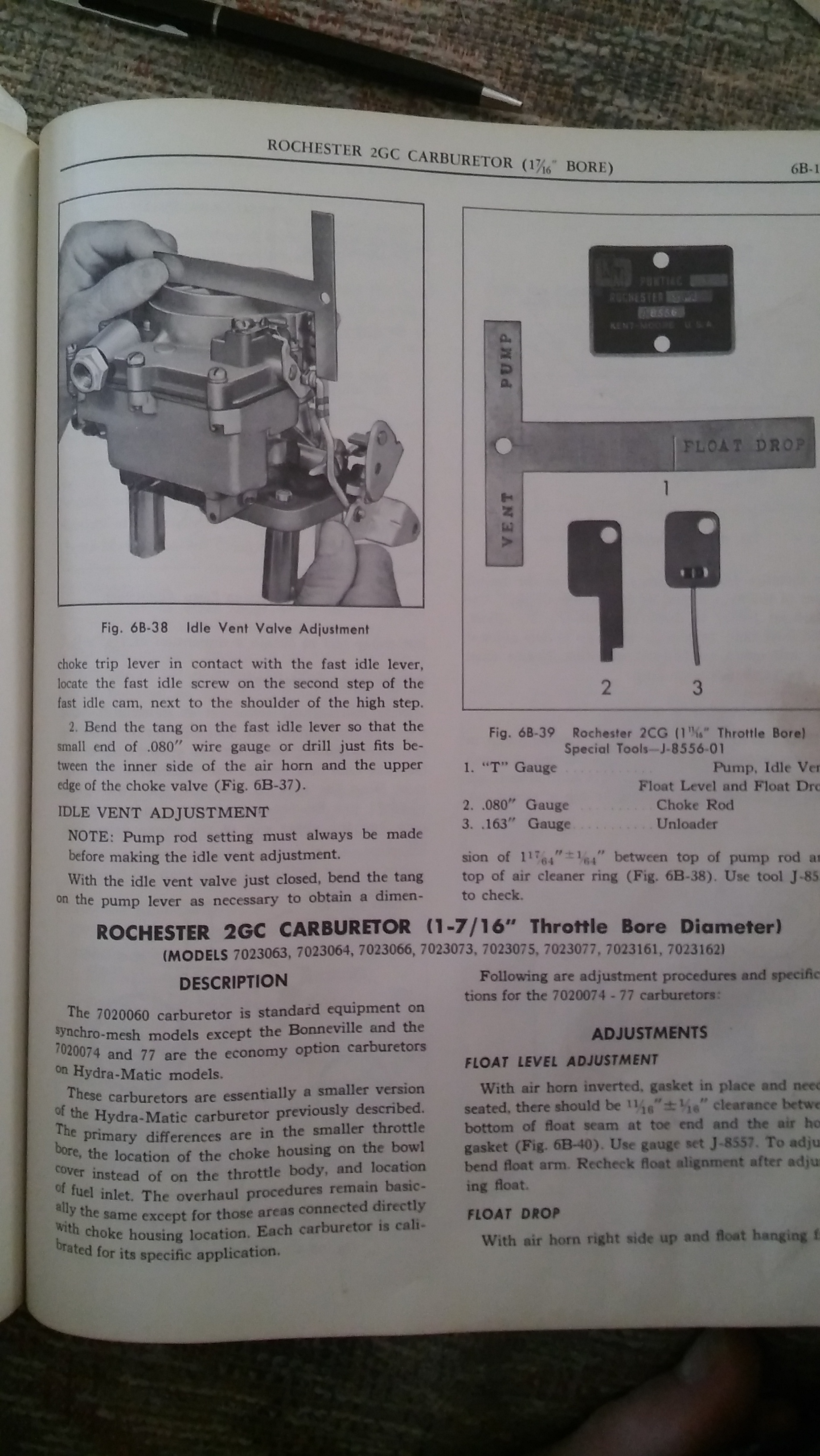

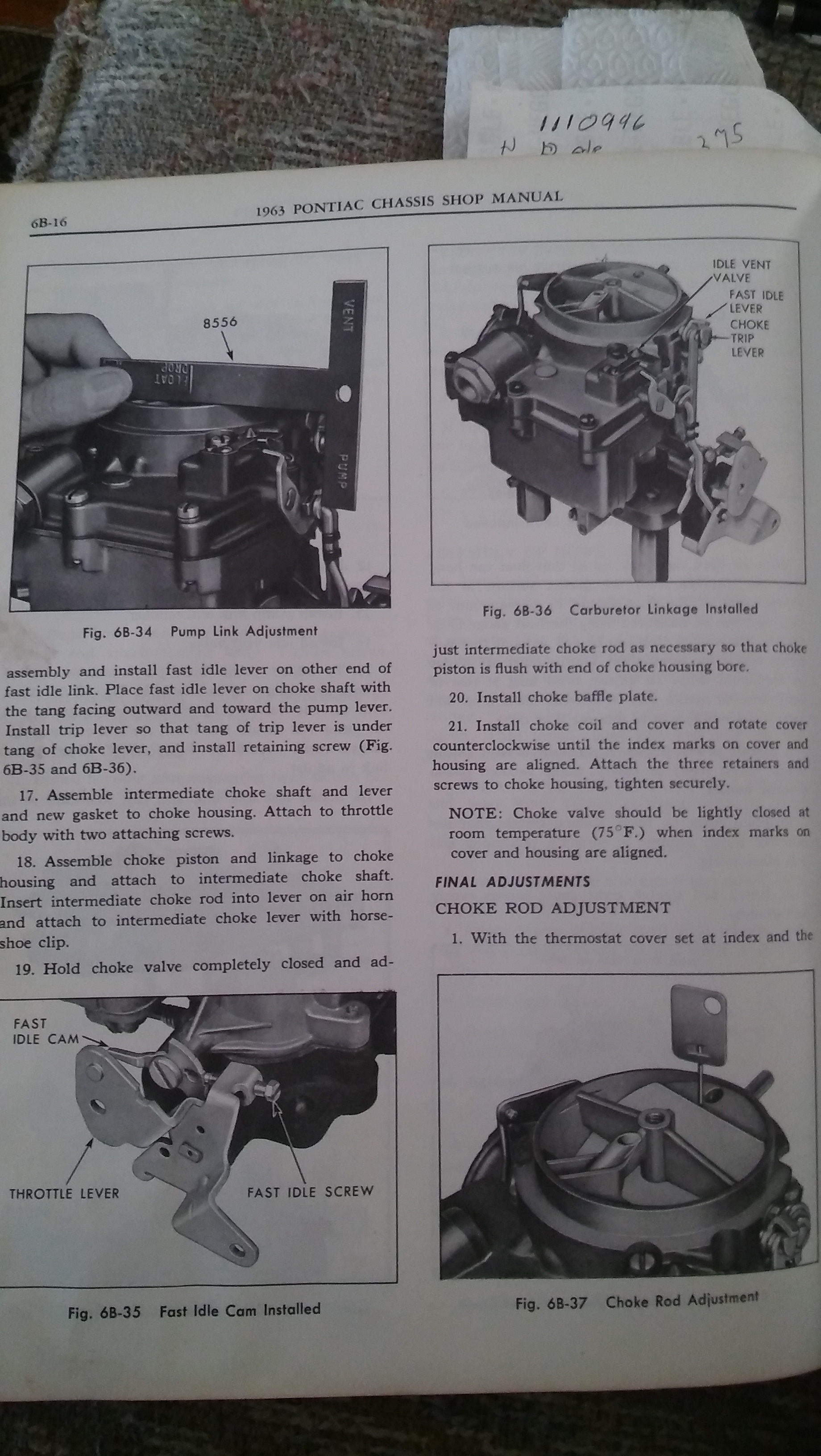

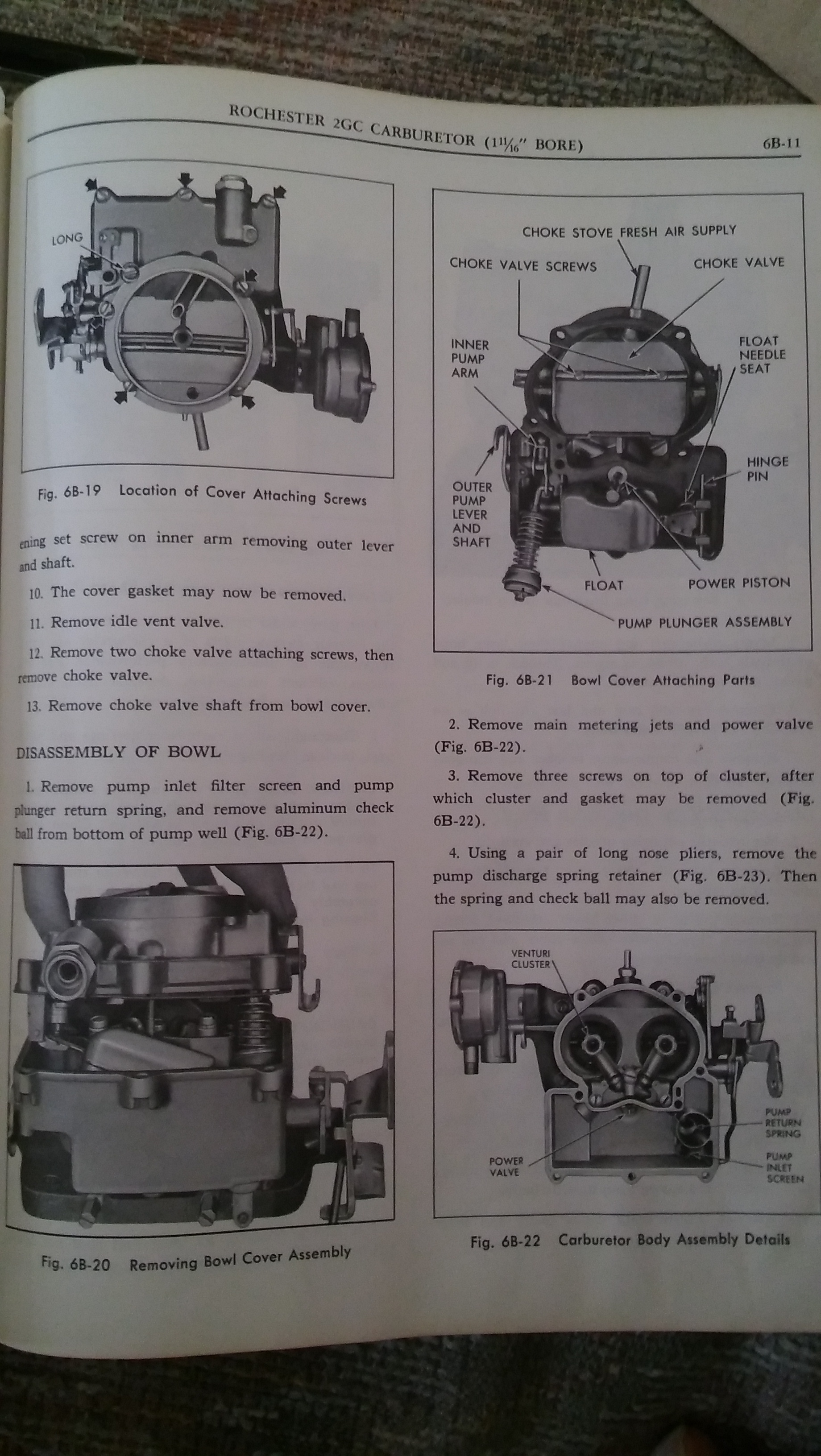

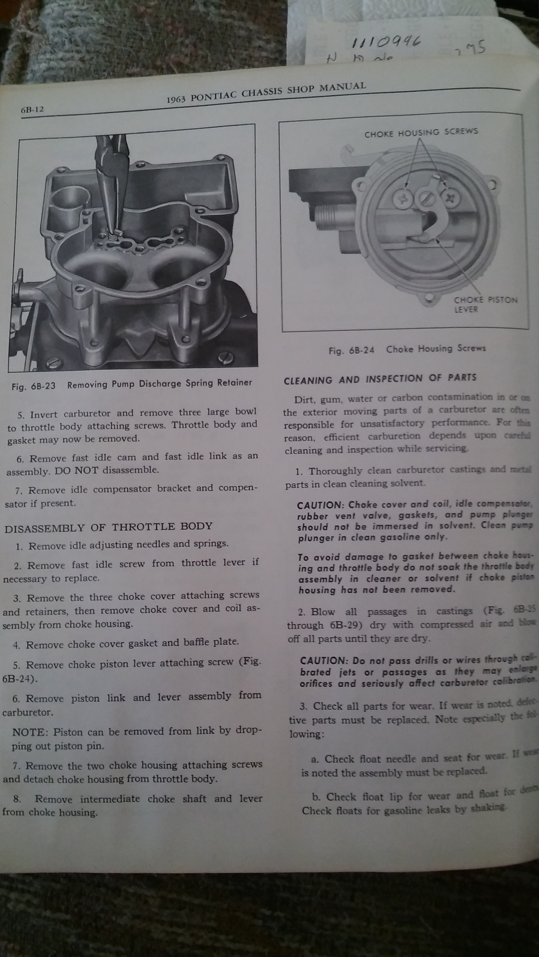

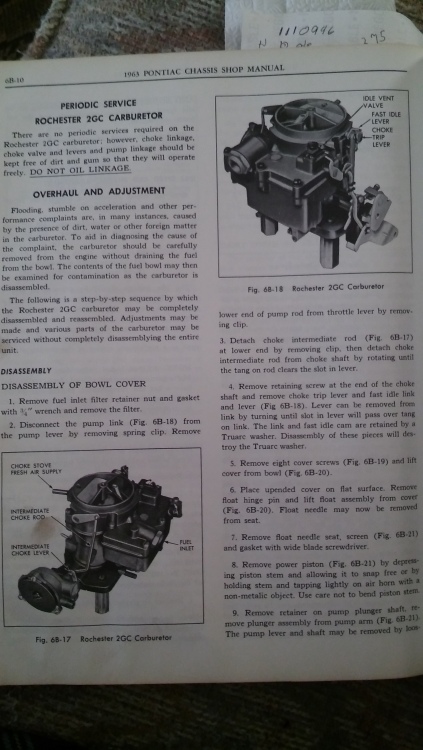

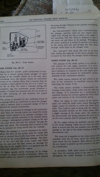

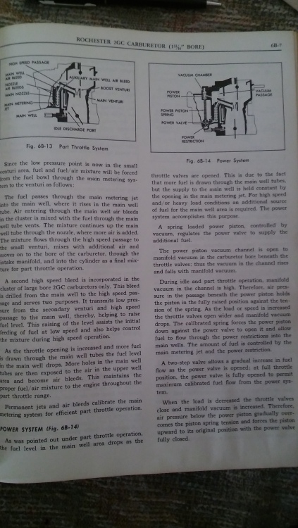

Hello Old Guy,
Hope you can see these photos..and that they actually help you. The special tool that measures the float level is unneccessary..there is a measurement that it is supposed to be..Will have to find out what that is. Will get back to you on that..Sorry I Haven't gotten back to you earlier. Rained out races Sat. night. Race car is going to have to have rear clip put on it. Probably going to be a few weeks before track ready again..We are just doing for fun this year anyway wasn't going to run full schedule anyway..Still sucks though...One major thing between present day gas and what was used in the good old days. When you could buy real gas besides the lead is the ethanol. Gas here in NC uses 10% ethonal..Don't know about Cal Fuel blends..Do know that they're different out there. Anyway ethonal laced gas doesn't get as good mileage because ethanol doesn't have as much energy in it..A gallon of ethanol will not have as much energy as a gallon of gas therefore you can travel farther a gallon of gas than you can with gallon of ethanol..with gas blended with it.  Will hurt gas mileage in the long run..Have a place here where can still buy nonethanol gas. Although more expensive..Can go almost 10 miles farther on a tank of it. Than Can with blended gas on my carburated motorcycle. They  did use throttle body fuel injection on Pontiac but it was the corporate (chevy) engine. In the 1980s..

Just signed in with my laptop instead of my phone. Was hoping the photos would be clearer. Don't know what if anything.I can do to remedy that..Any suggestions would be greatly appreciated. Think Mrs. Two Lane might have a way to scan them onto her work computer and then post them directly with out having to take pictures with my phone. Will ask her. As far as throttle body conversion I have never done one so I honestly don't know that much about it. I have always gone the other way from throttle body to 4 bbl carb especially in a performance build. Although I do have a HOT street combination that works really really well with tuned port injection..Hoping these photos will answer some of your carb questions. If you can not see these photos well enough for them to be of any use please let me know will do something different....Mrs. Two Lane just got home she says that she can scan them but will be a couple of days..before she can do it..

Two Lane,
I did take the carb apart and took another look at it. I had forgotten that the idle circuit on that design carburetor two and four barrel was fed through metered tubes in the main jet wells. Short story is that they are much better metered than the earlier end bowl holleys. It is my understanding that Holey has fixed all of its gremlins in the past few years but I digress. When I pulled the top off of the carburetor the fuel level looked high and with a float in it it would be even higher. I lowered the float about a quarter inch from the level shown in the instructions that came with the carb kit and went out to run a few errands. When I started it up I let it warm up and found that I needed to lean out the idle screws, a good sign, and driving it with the top down you get a lot more of the exhaust smell than you get top up and the nasty rich exhaust smell seemed to be gone. Something as simple as the float level? Anything is possible.
Re: cal gas. We have the winter and summer blend. More ethanol in the summer blend. We are still on winter blend.
At any rate I will drive it for a while and see what happens. I might drop one jet size and see what happens, It has 64's in it right now.

I can sort of make them out but lowering the float level about 1/4 inch lower than the instructions called for seems to have made a tremendous difference. If I need them possibly I can move them to another program that will allow me to manipulate them.

I am finally back to the Pontiac, life and leaking fuel tank issues. Several posts ago you said that the code 2 diff is a 2.69 ratio. Was that a misprint? finally got this thing on the road and running reliably, Other things had managed to find their way farther up on the to do list than the Pontiac. Plus it took almost 7 weeks to get a new gas tank and sending unit. The only people I found that supply them were out of stock and apparently it takes a long time to have them made. I need to jack up one rear wheel and mark wheel and driveshaft and spin the wheel to get an approximate gear ratio but the way the engine spins on the freeway I would bet the ratio is closer to 3.5 to 3.7.

Just for giggles I did jack up one rear wheel and spin it while counting driveshaft revolutions and it does appear that 2.69 is actually correct. The tires however are only 25 inches tall which is why the engine sounds like it is spinning faster than it should with that ratio.
